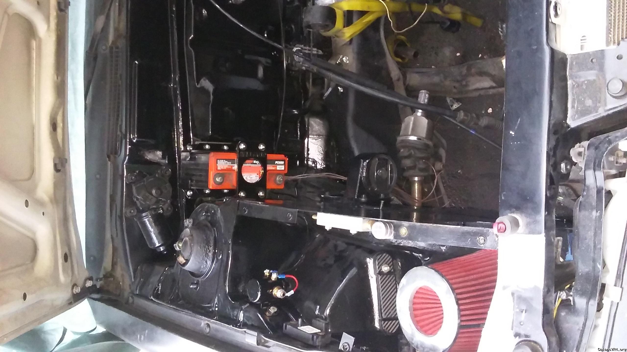

Today i realized that i hate the monstrosity that is our fuse boxes. Other that relocating to the glovebox or something what options do we have? Is there some sort of aftermarket option/replacement?

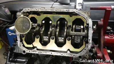

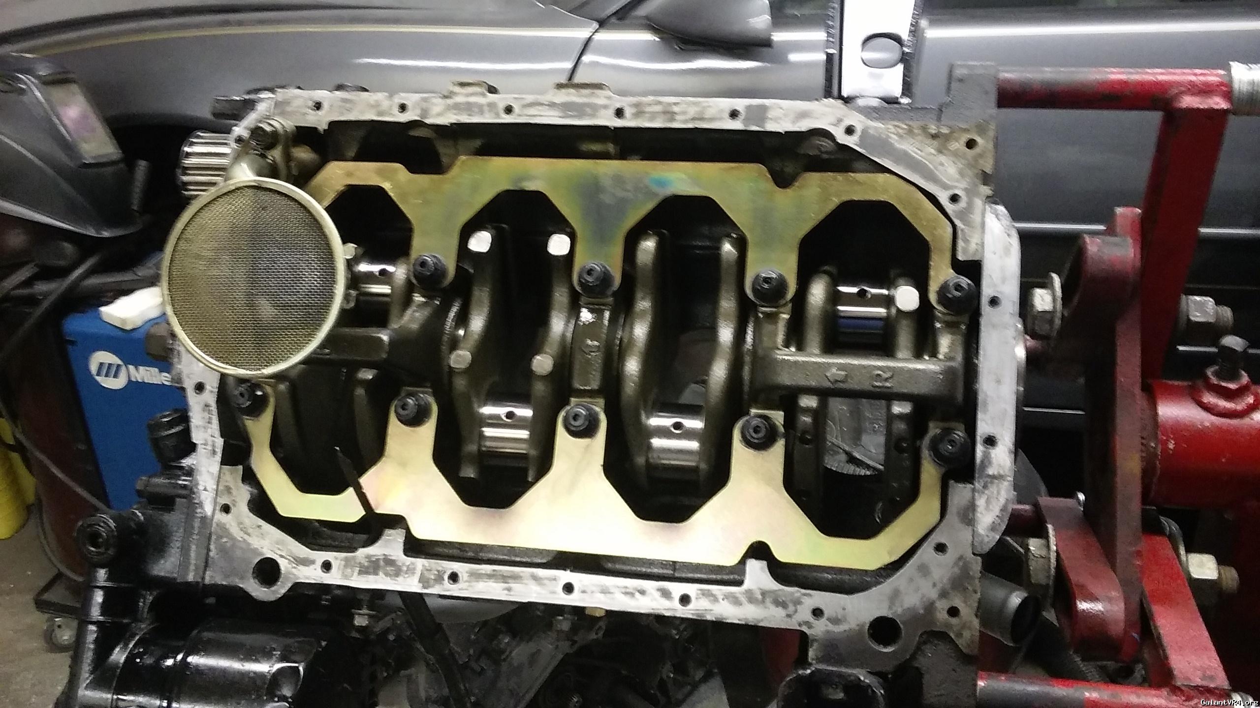

Made a little bit of progress today. Kiggly main girdle. On the arp main studs do i have to back them up half a turn before torqueing like with the head studs? Anybody know the torque specs or should i go figure out how to use google?
3,478
Did you have the block checked/machined with the ARP main studs torqued and girdle in place?

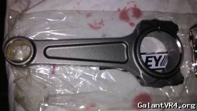

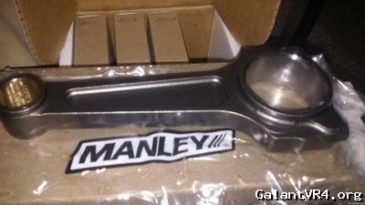

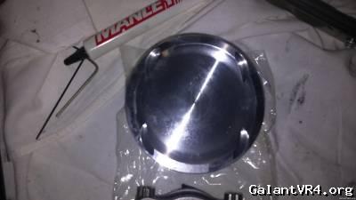

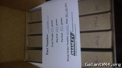

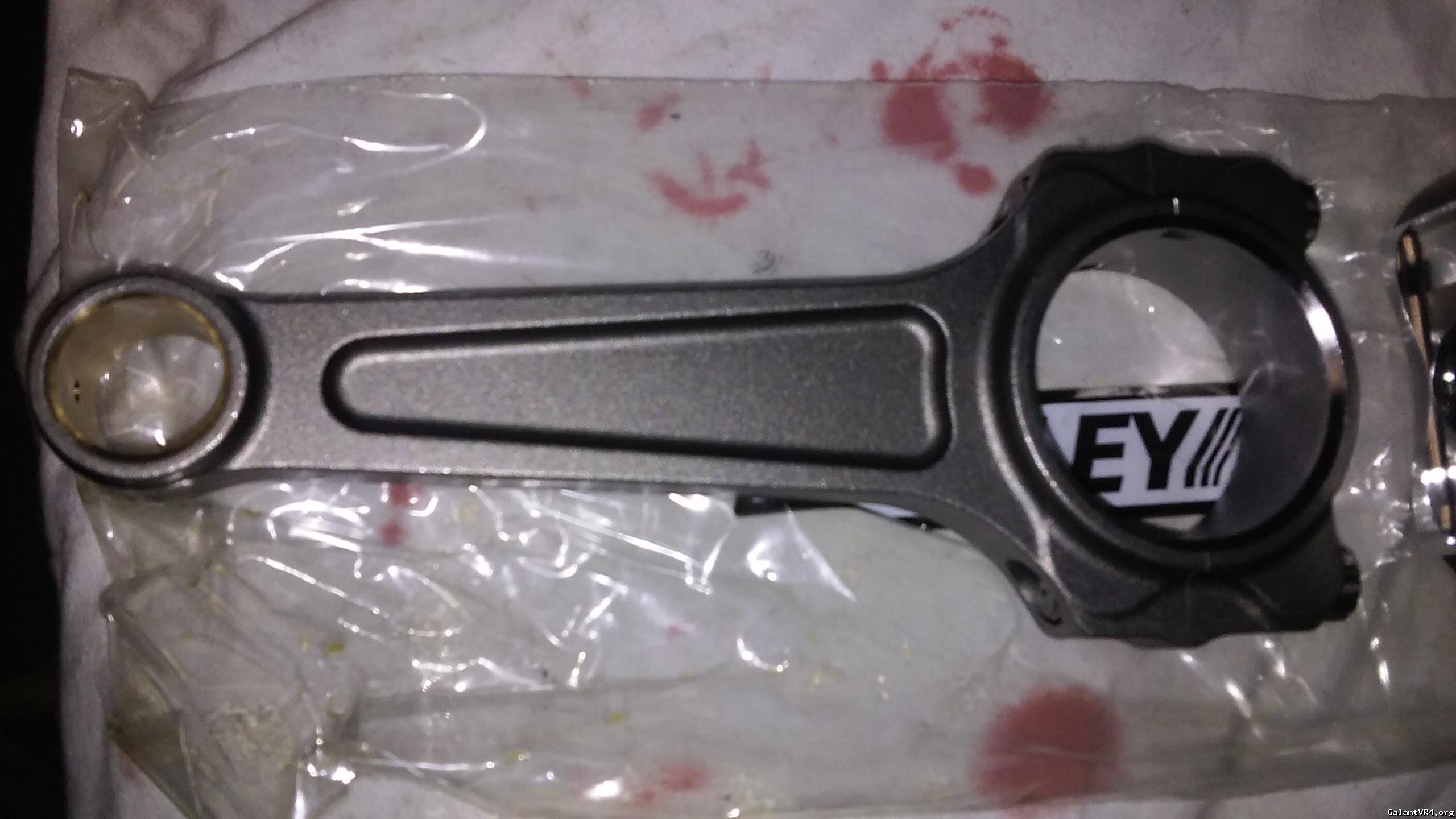

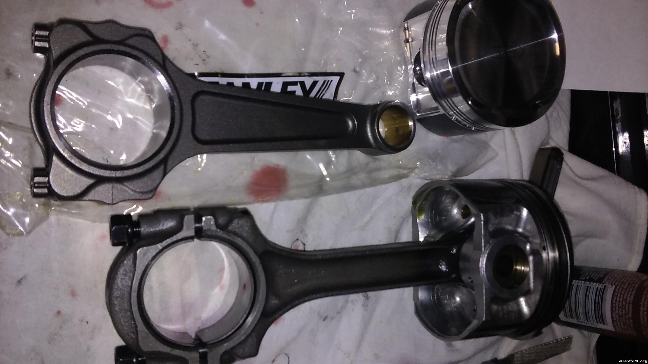

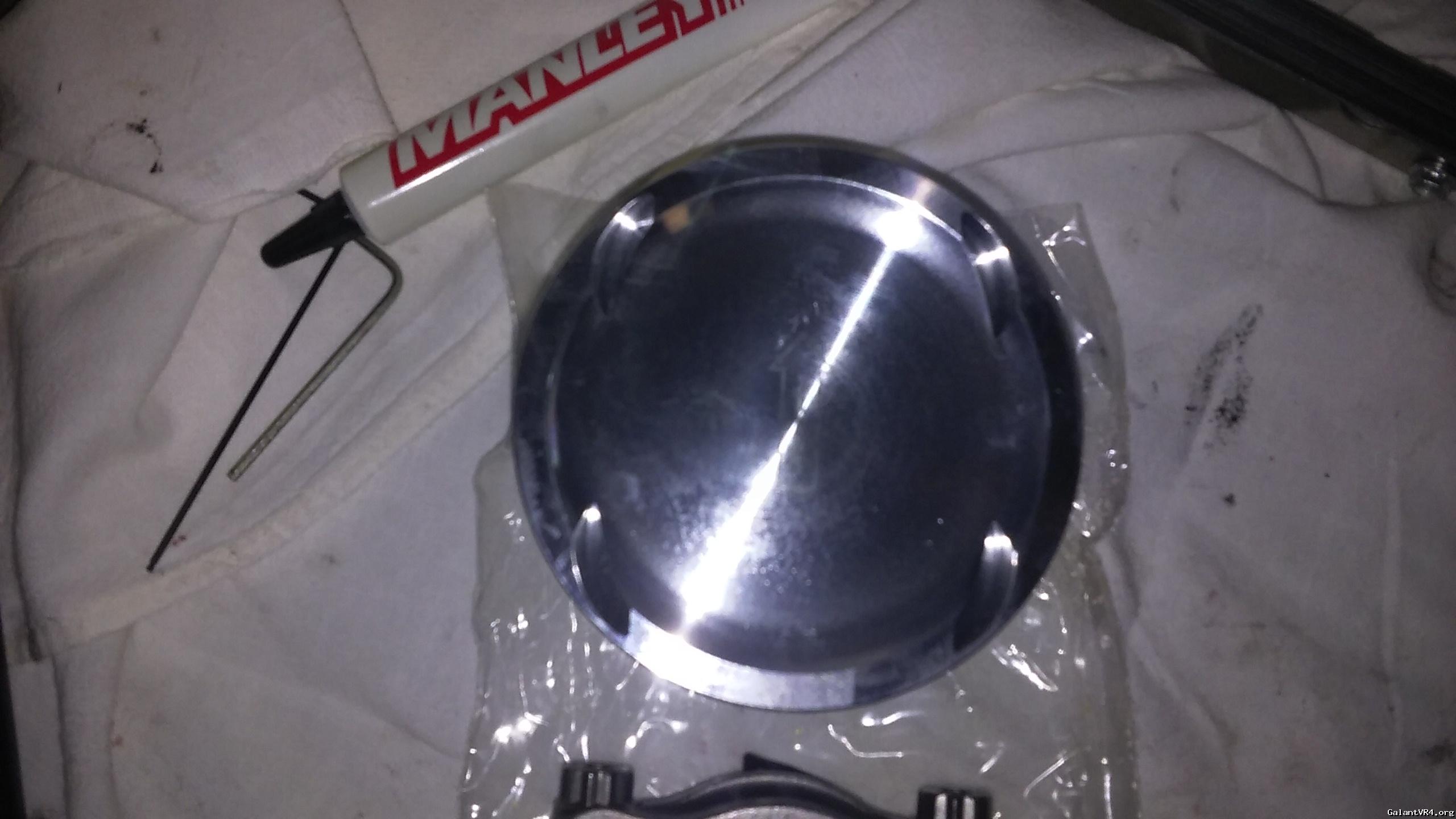

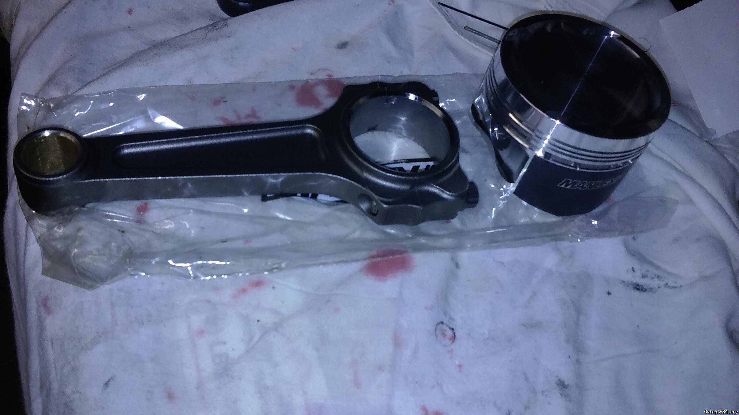

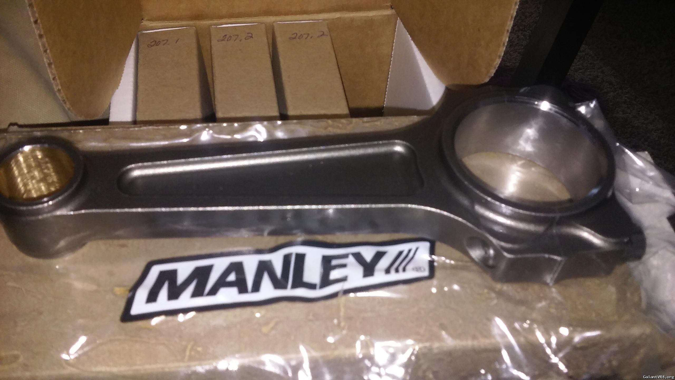

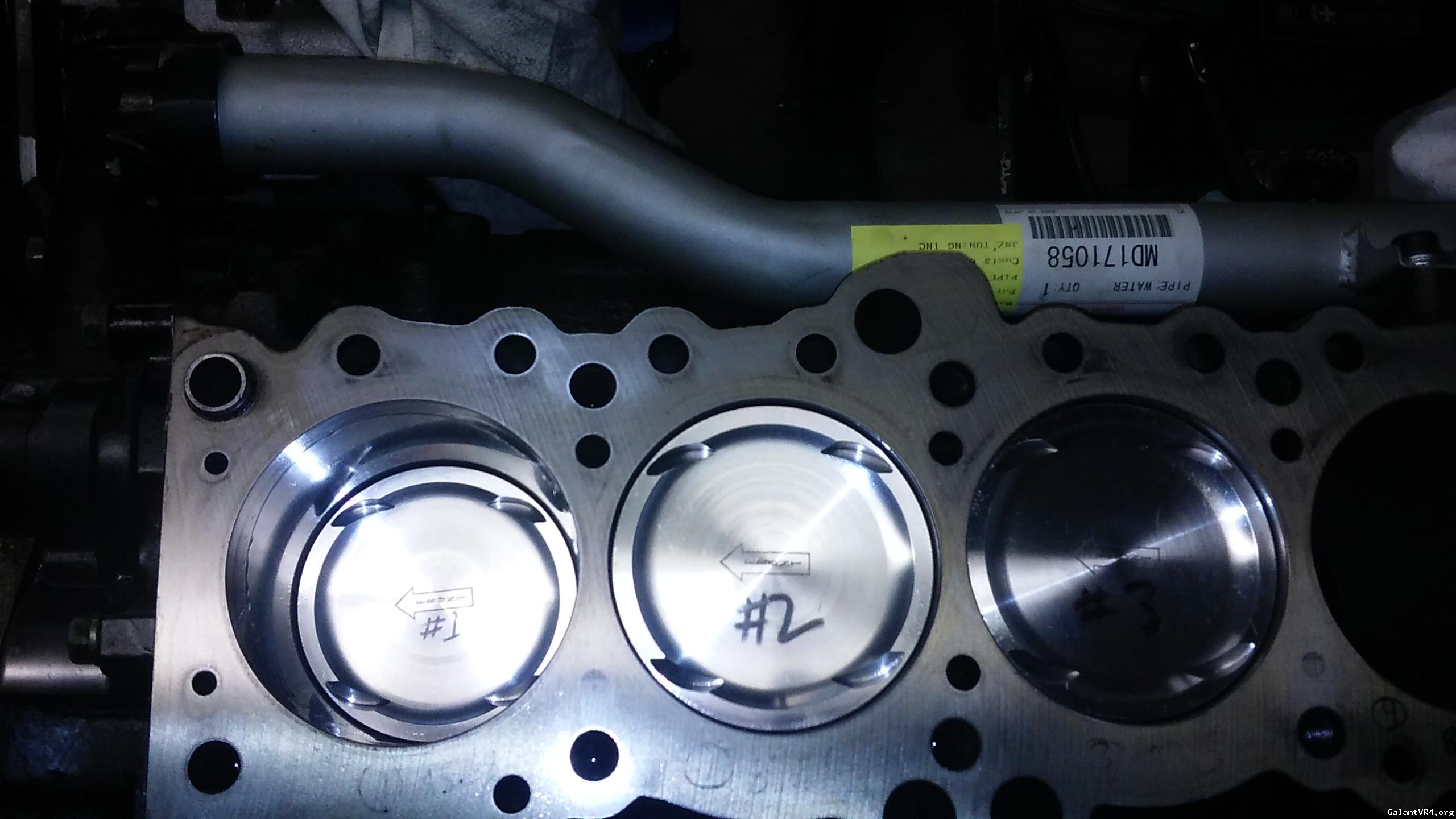

Ok. So i finally got my pistons and rods. Manley turbo tuff I beams and manley pro series dished 8.5:1. On gapping the rings (top and 2nd) they say for high boost application on the gap go bore size times .008 and with the oil rings a min of .015. Anybody have any personal experience with this? Should i just go with it?

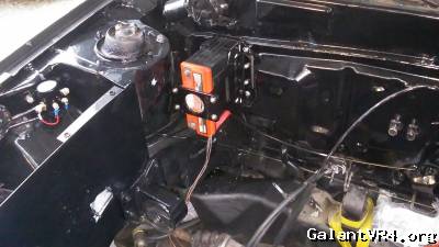

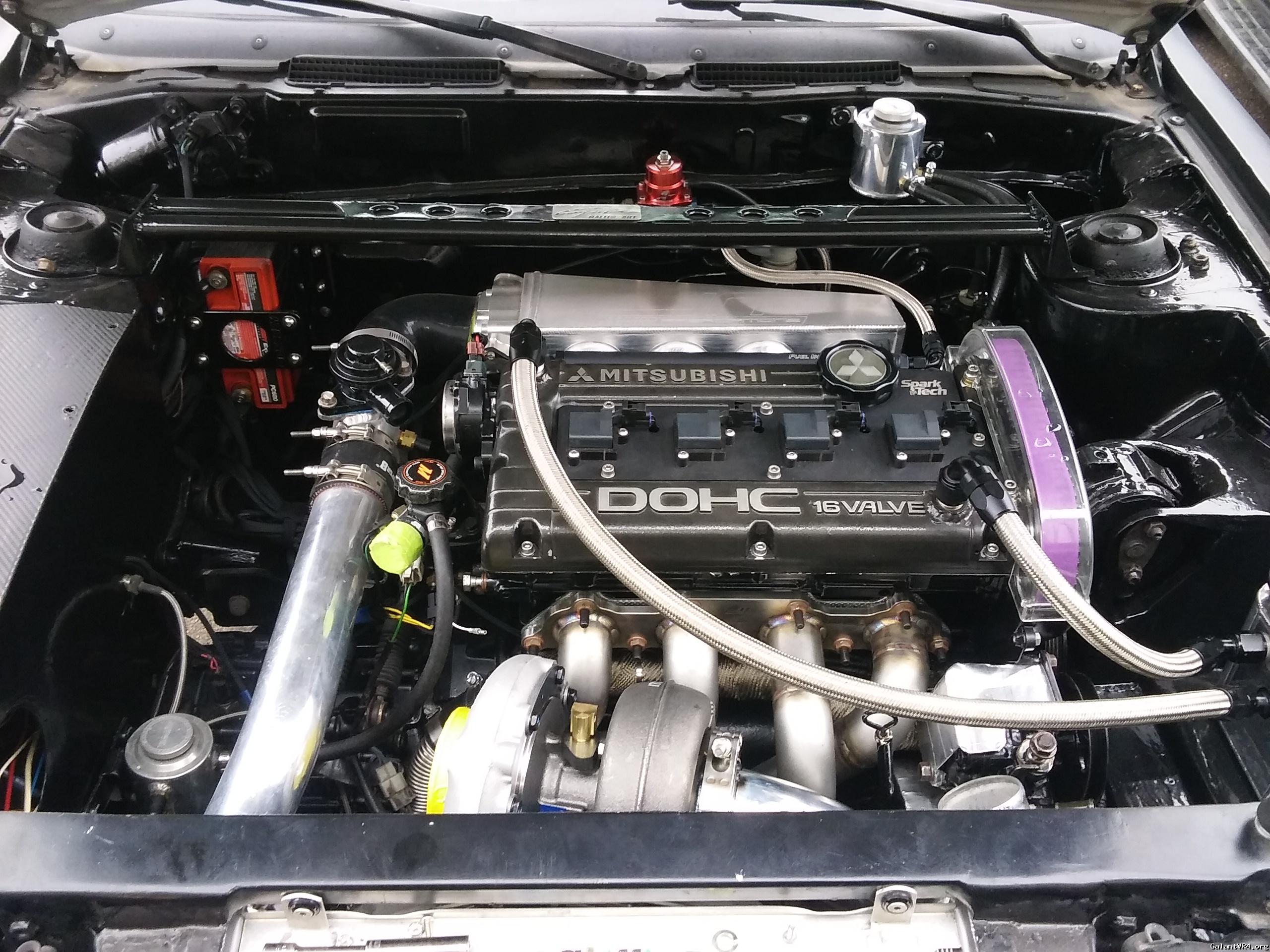

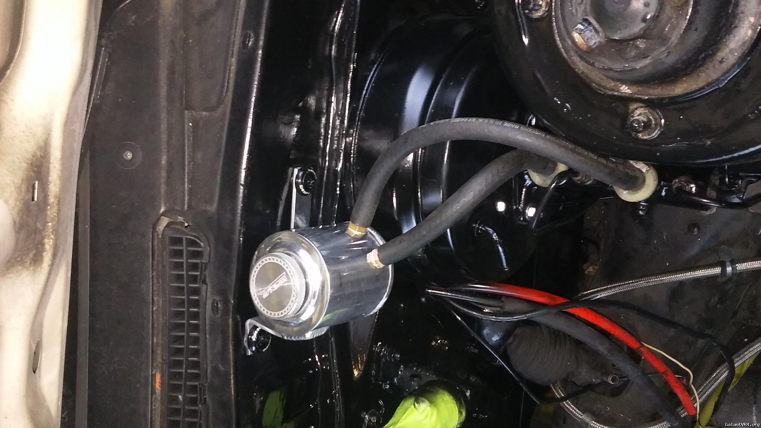

I found some time to take care of a couple little projects ive been wanting to do.

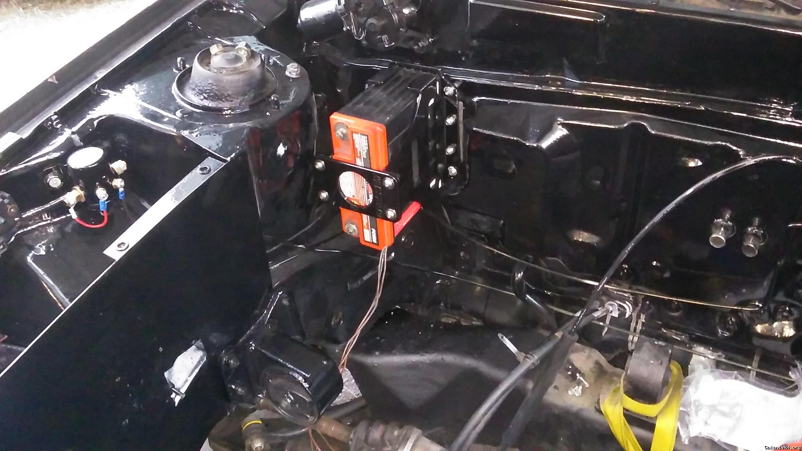

Mounted my battery. Odessy pc680 with the odessy bracket.

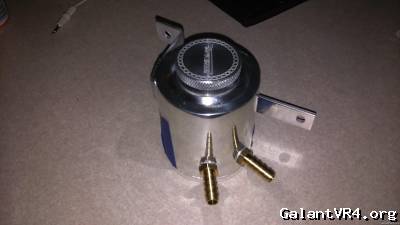

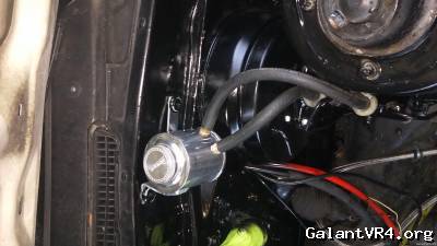

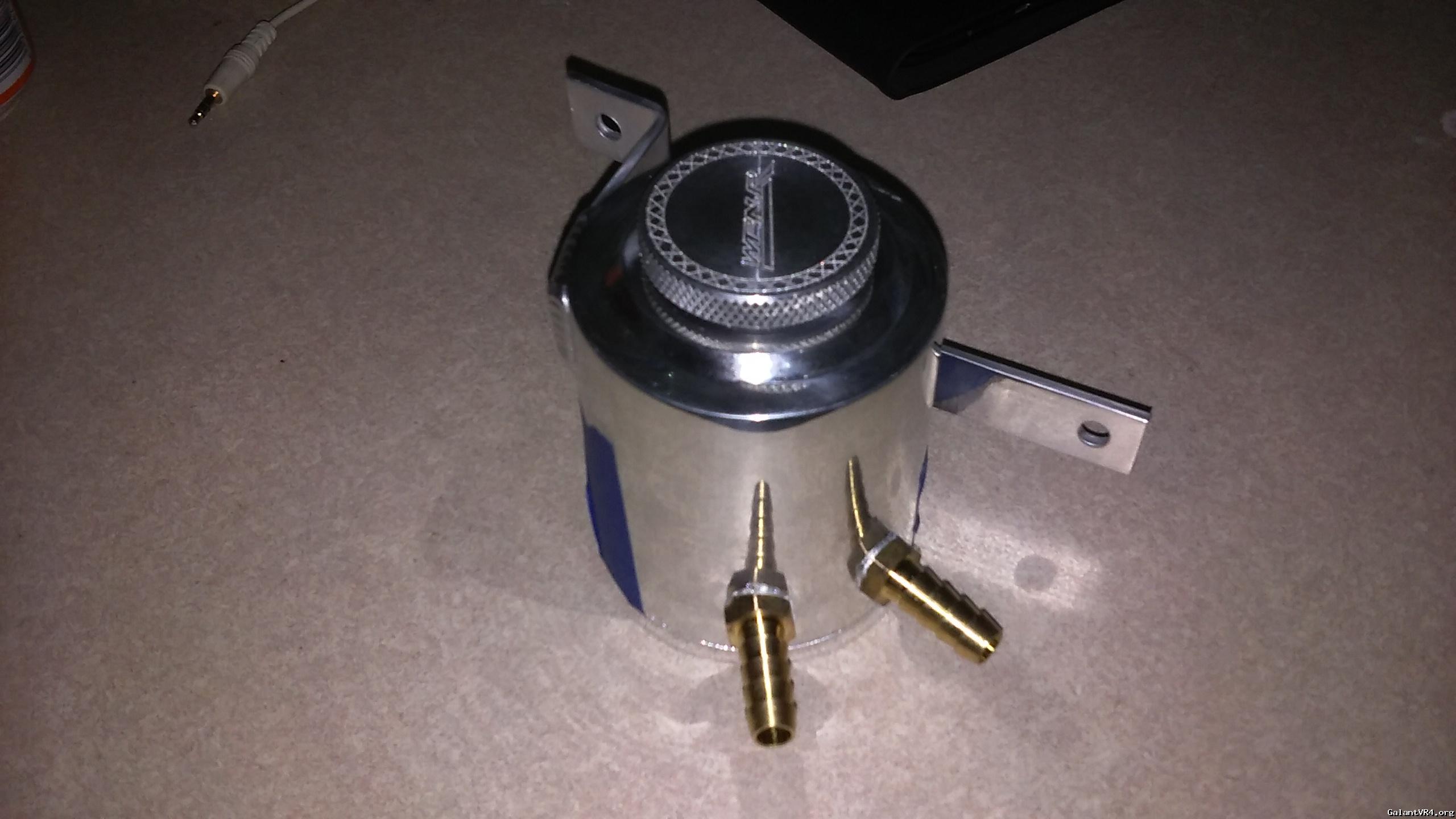

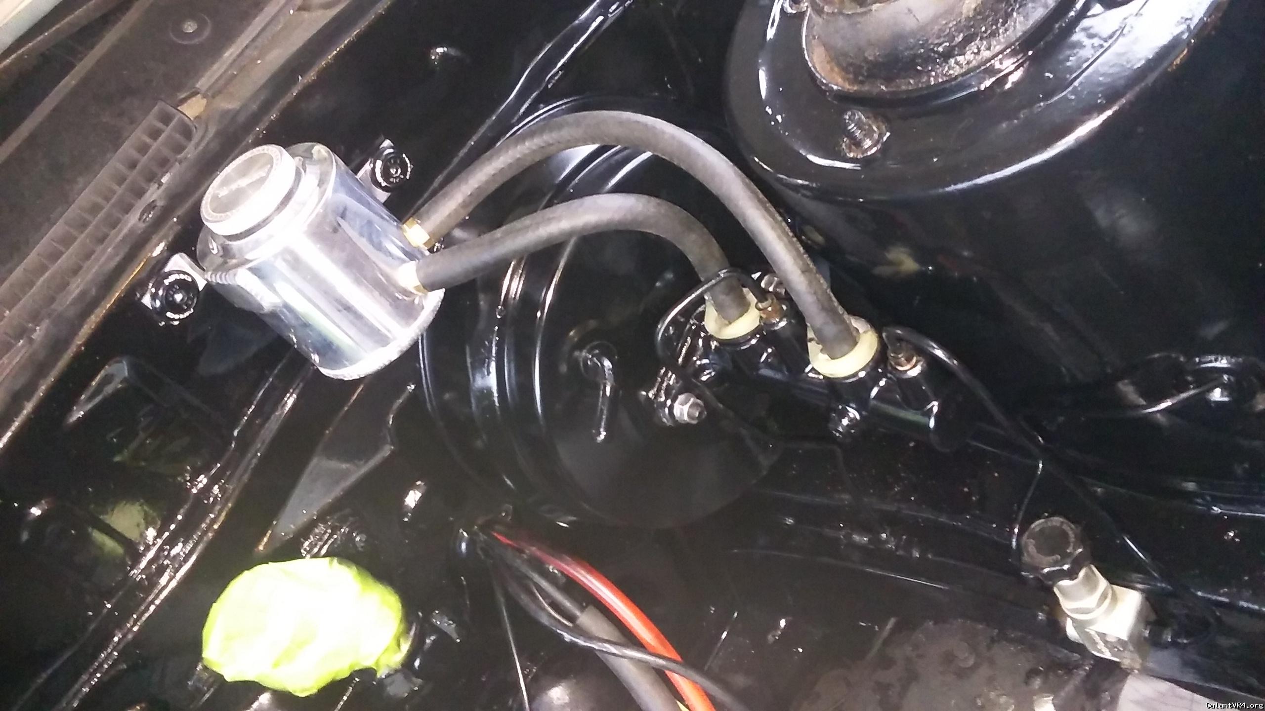

Ive never been fond of our brake fluid reservoir. It will mount in the stock location, just less of an eye sore.
I came up with this using a weapon-r can i had laying around.

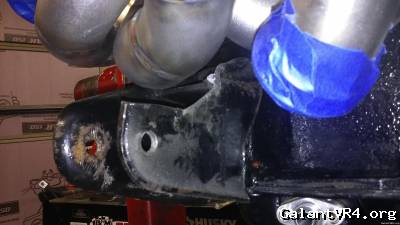

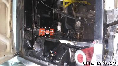

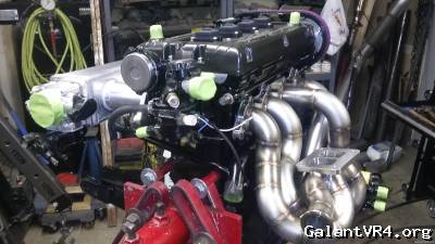

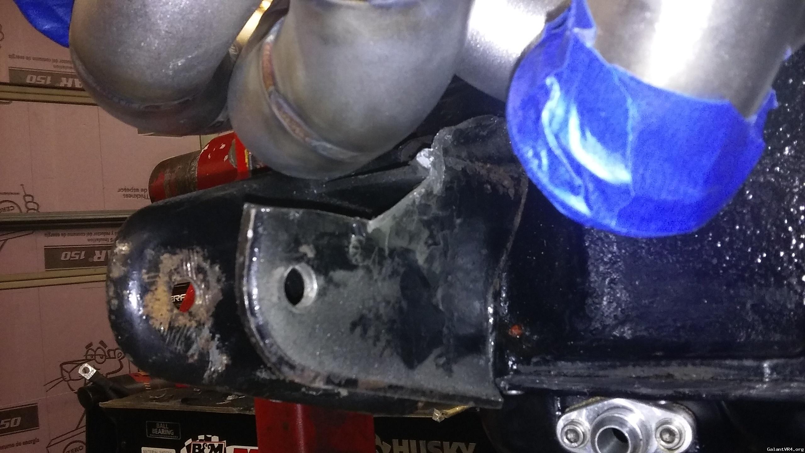

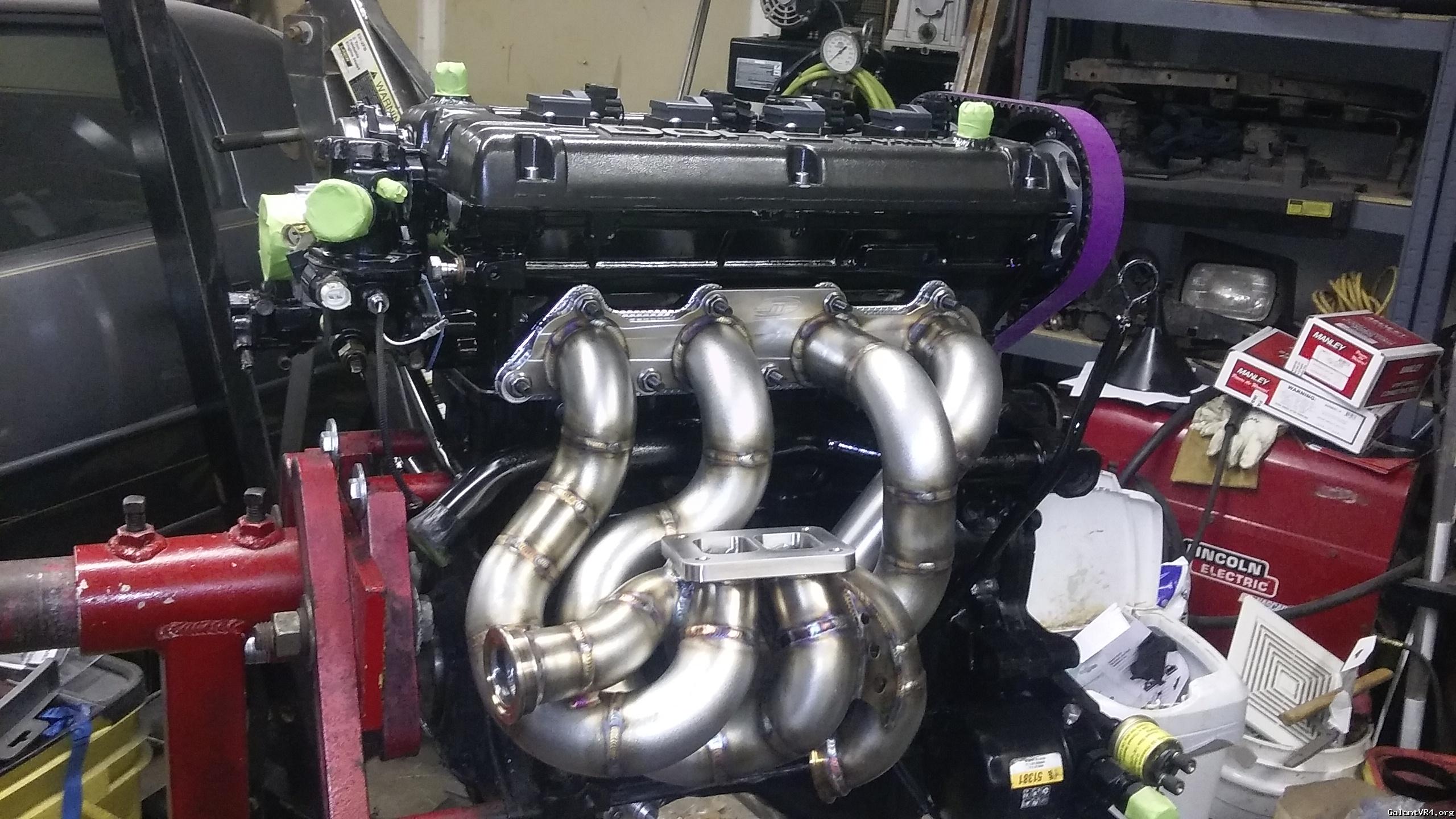

I do have one small fitment issue. The front motor mount needs to come down 1/8". Has anybody ran into an issue like this before? Would it cause the engine to sit to far out of wack if i weld and redrill the holes in the bracket? Thanks in advance.
Mn92gvr4
Jan 11, 2014
110
North branch mn

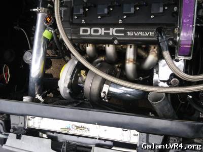

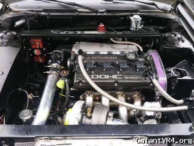

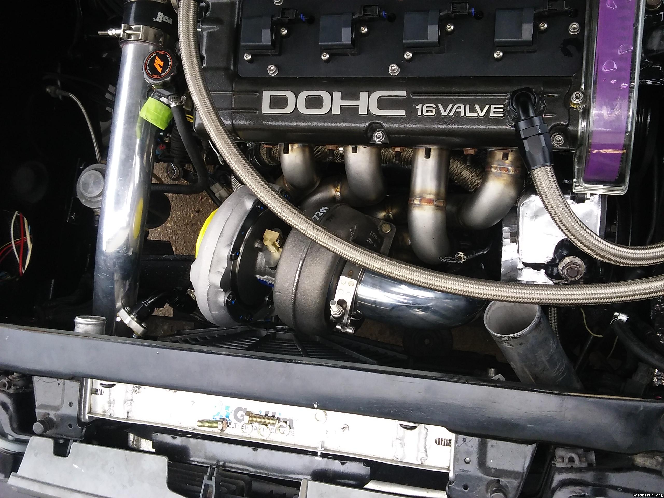

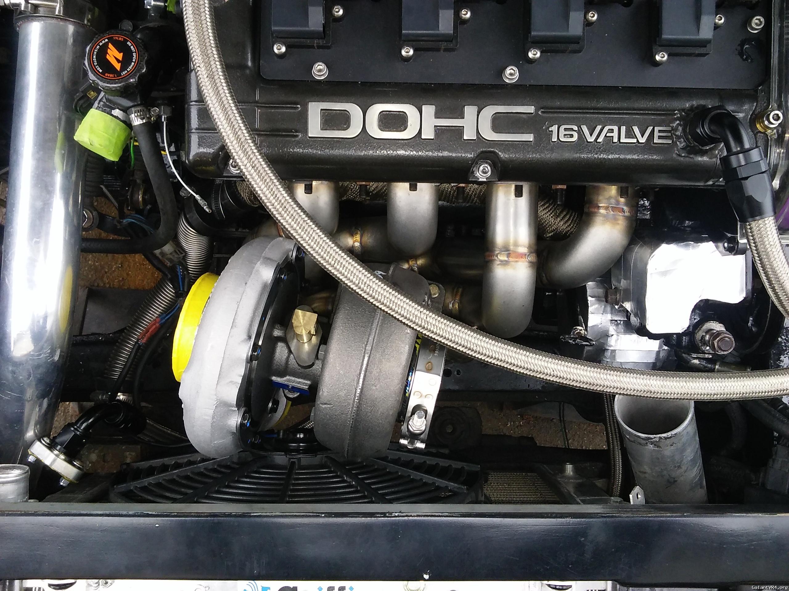

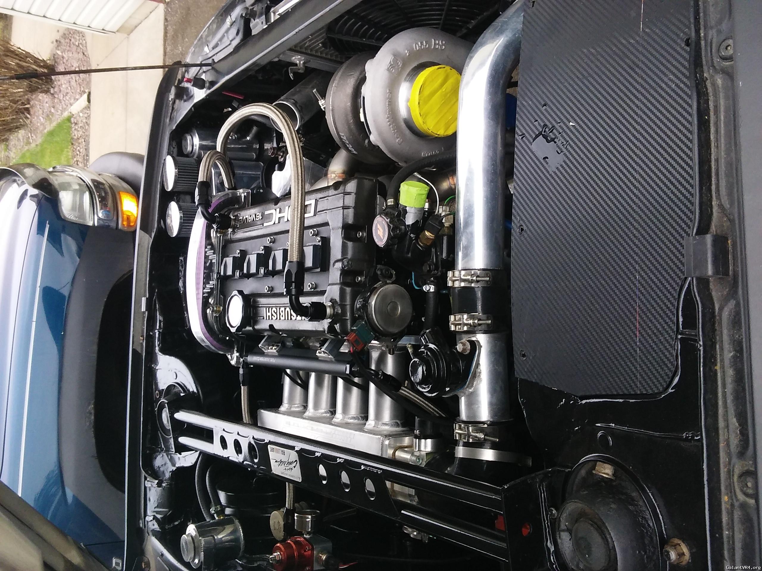

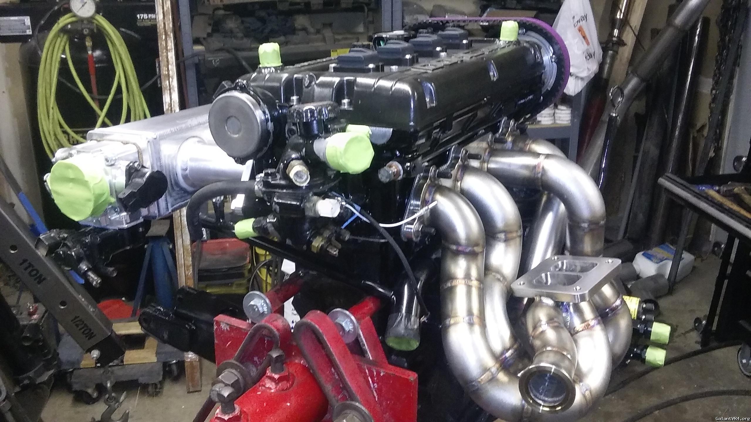

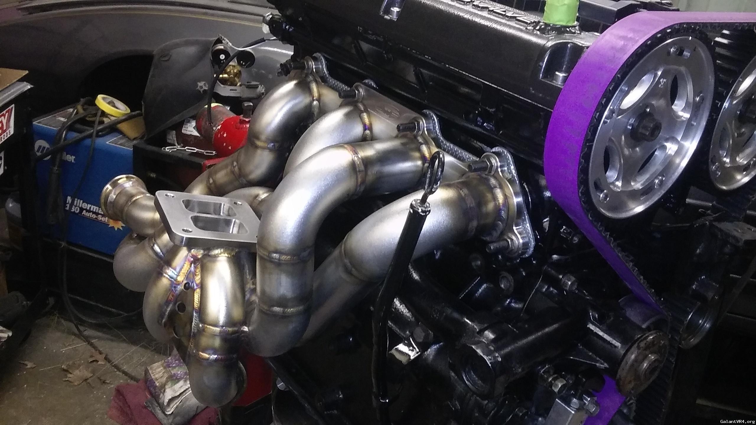

Why is that the first thing everybody notices? /ubbthreads/images/graemlins/rofl.gif I simply haven't gotten to it yet, its on the list. I put the ic pipe in there for mock-up proposes.
