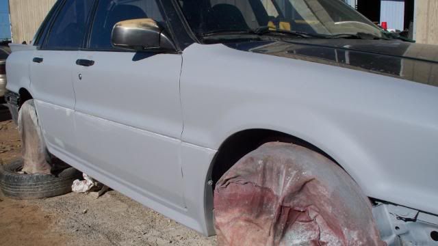

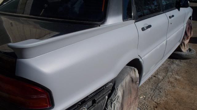

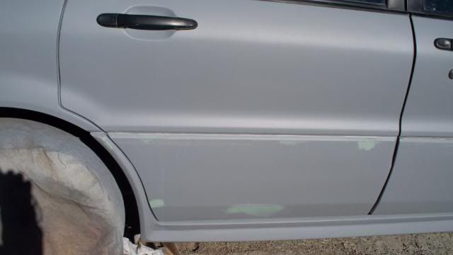

Hi guys its been a while since i posted i have received a few requests for pictures of the AMG sides installed, here they are in my car. im going to paint it all nile black.

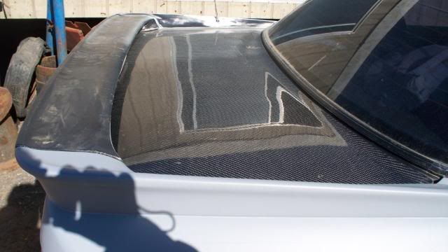

AMG wing:

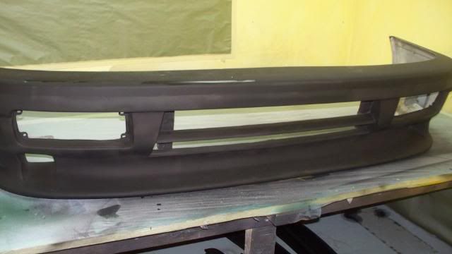

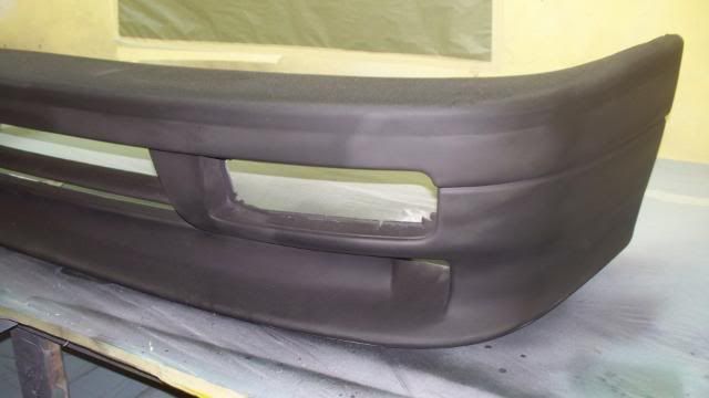

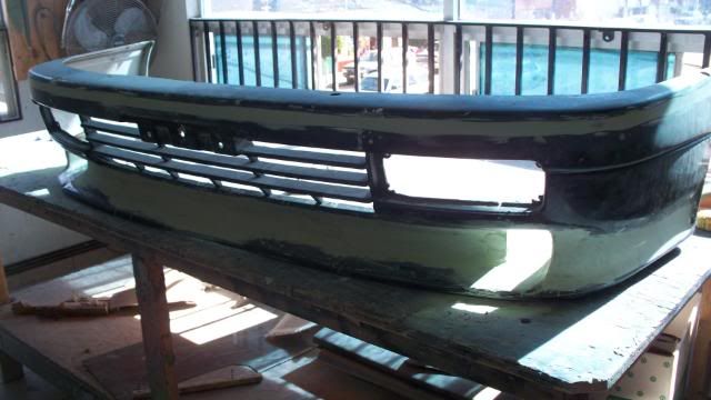

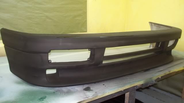

modified JDM front bumper, will be made in fiberglass

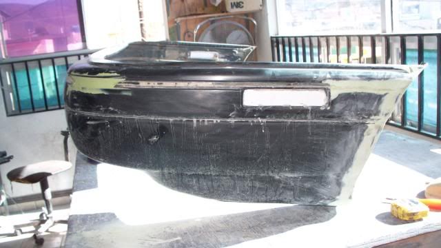

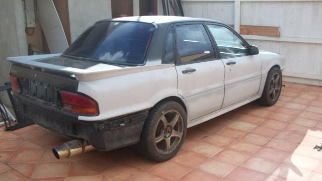

modified "short" USDM rear bumper, will be made in fiberglass:
let me know what you guys Think.
Paulo.
Those amg sides have allways owned in my book. Nile black is gonna be dope. Cant wait to see it all done.

Paulo word of advice the since I've cut my rear bumper and also Paul's. The marker lights on the side want line up in the body holes anymore but since your doing fiberglass the holes can be shifted to the normal location. If not you can remove the bulb holder and install LED's like I did.
Also the back corners of the trunk either have to be beat in or cut out and new metal welded in.
I did a how to under new aluminum rear bumper install or something like that a few years ago.
Curtis i might go with the leds, i went trough your aluminum core
install im searching for the right one to do it /ubbthreads/images/graemlins/applause.gif
Paulo.
Front bumper looks cool. I want a copy /ubbthreads/images/graemlins/smile.gif
thanks guys, the idea with the bumper is to lower the front
of the lip to get a flat floor and have bigger brake ducts,Paulo.

If you are molding the rear in glass, you can relocate the rear markers or remove them completely from the mold.

the front bumper looks very clean, if you were to make a couple I would be on the first time buyer list, very nice

Will these be available for others to purchase?
Yes i will be making molds for the front and back.
its just a cover though, since my car doesnt have the metal cores
(front is mounted with zseus)
i dont know how it would mount on a stock one.
if there is interest on them i might go the extra mile and
make brackets to mount on stock locations.
Thanks, Paulo.

Wow...I am really starting to like the smooth AMG sides more and more. I find it pretty sweet that yours just attach to the oem cladding.
Great work man!! /ubbthreads/images/graemlins/applause.gif

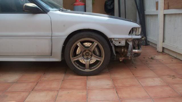

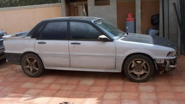

more updates the car now runs thanks to a Keydiver ECU (thanks jeff)
and drives on a 5 lug conversion and a tunersnation 3k kit.

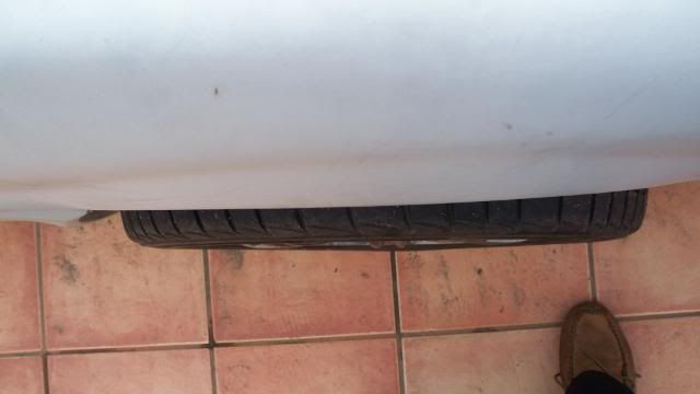

i also installed wheels and tires, they stick out a bit on the front
im looking into making flares for it.
let me know what you think, Paulo.
