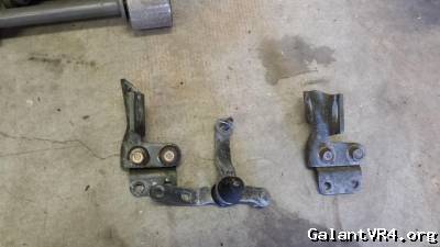

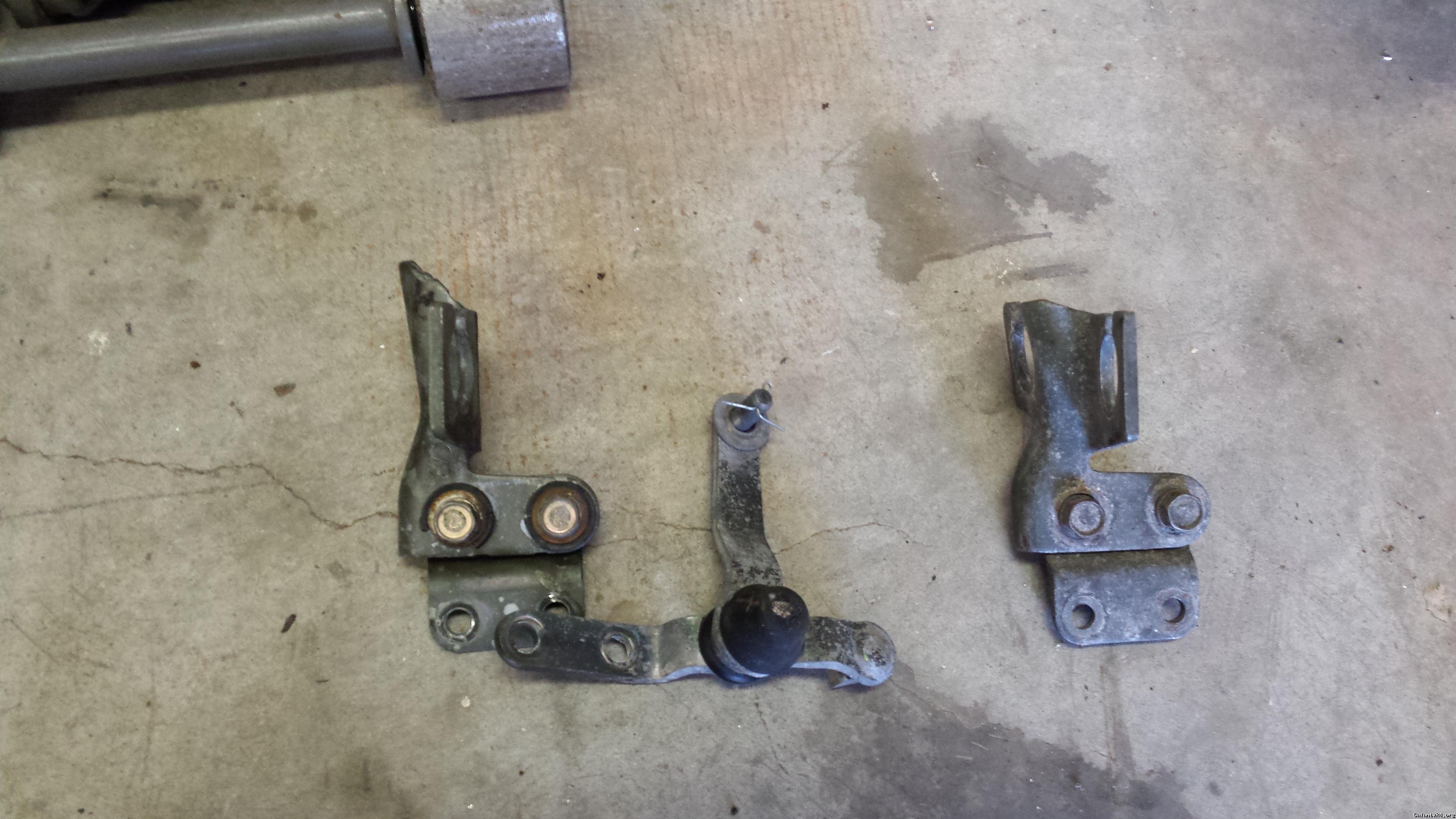

i can take pictures of my assembly later today when i go to my shop, but for dimensions i cant help. i'd need to take things apart to get proper measurements and im not looking to do that. do you not have a transmission in your car to take the brackets off of?

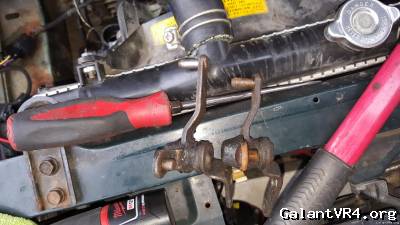

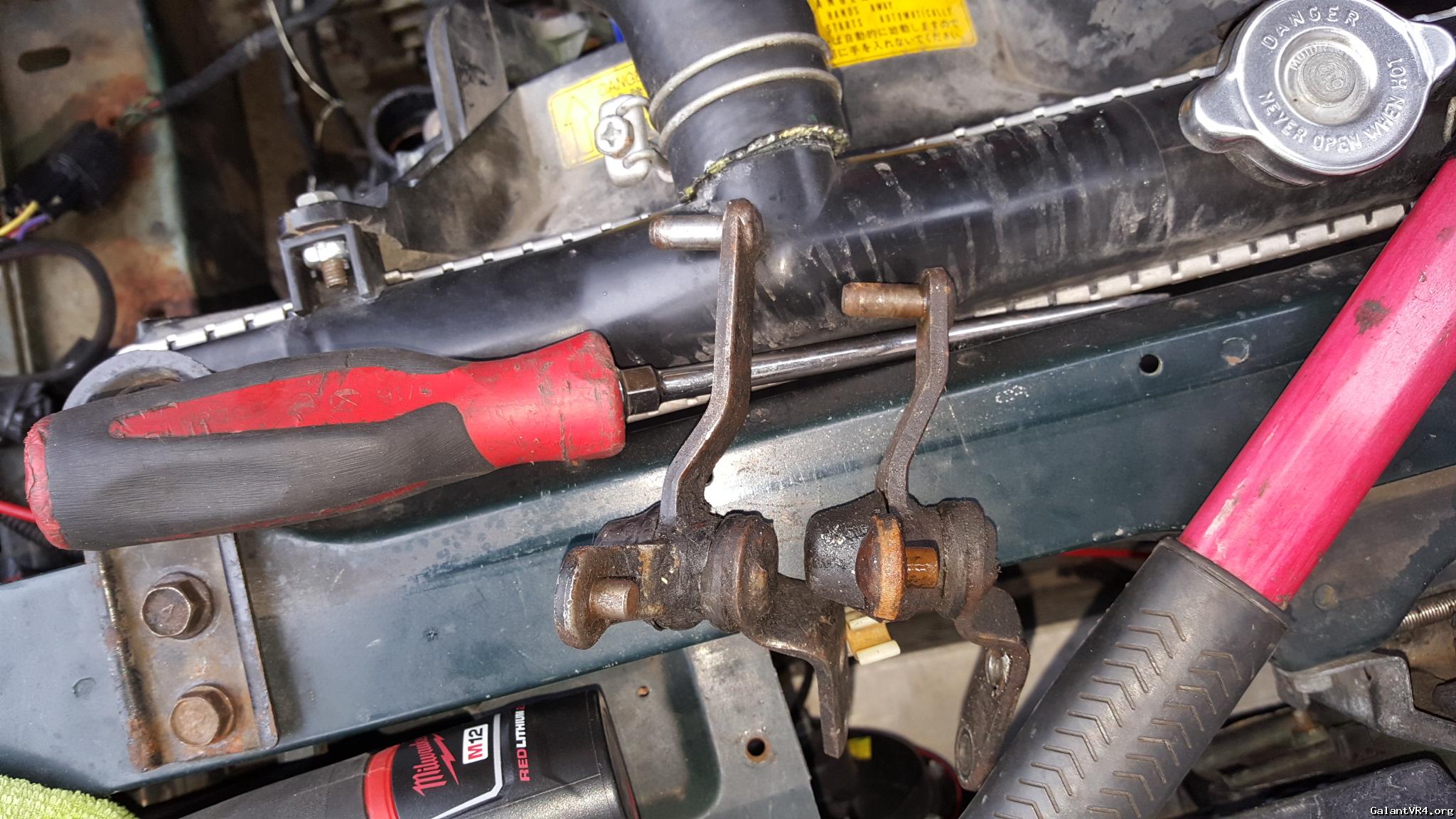

Here's what I have. The set on the left came on the '91 talon tranny, you'll notice they are taller. The one on the right was on the cables on the gvr4. So I'm thinking the shorter one is gvr4?
transparentdsm
Jul 27, 2011
3,690
Cherry Hill, NJ
Quoting kjbtsi6686:
also note the different bases on the shifter cable brackets/

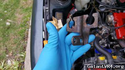

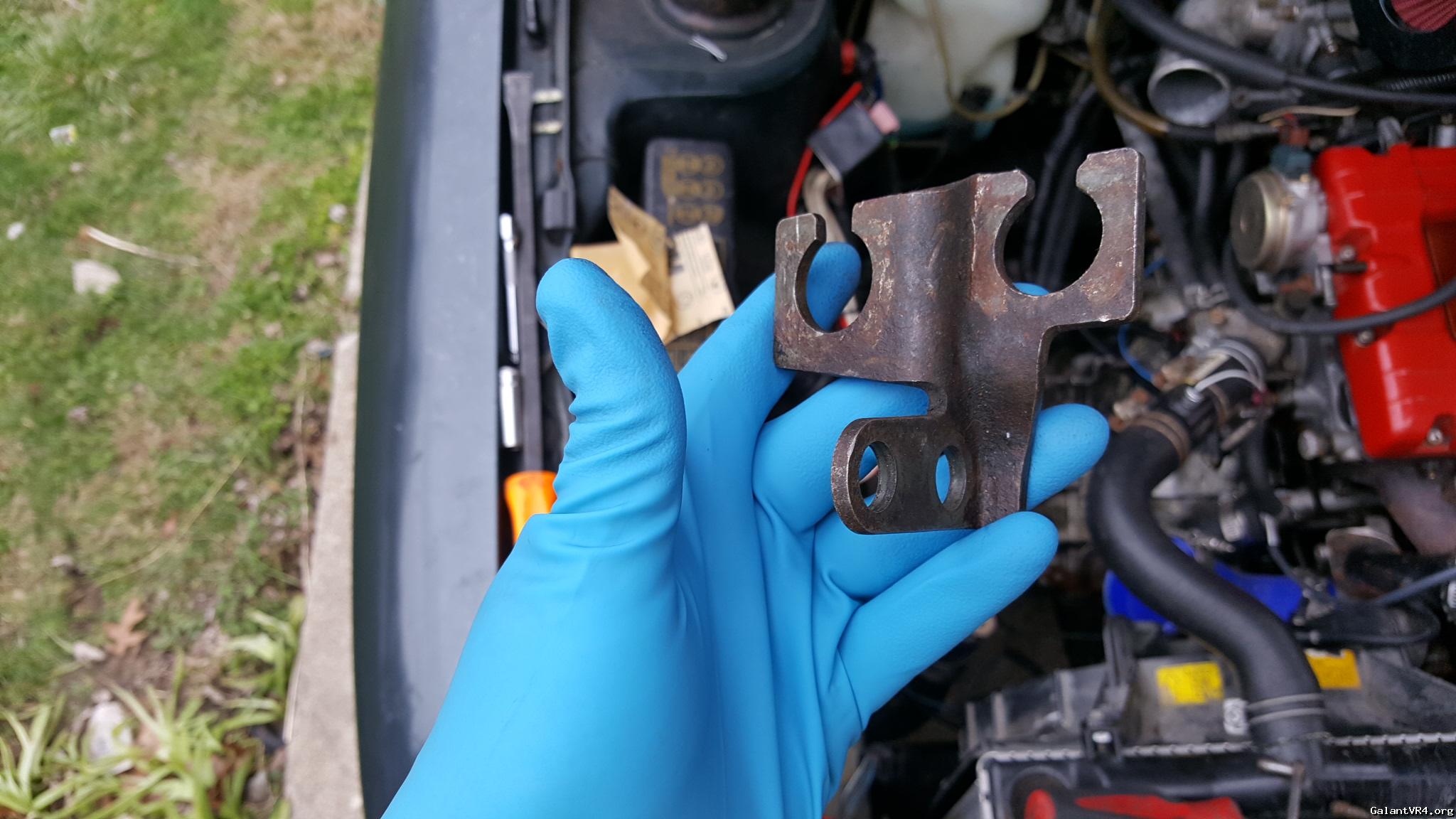

Here is the bracket I am using
Along with the shorter upper shift post.
