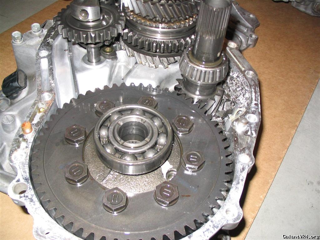

11,990
FWIW, Brian and I have both sheered the teeth off of first gear during a launch.

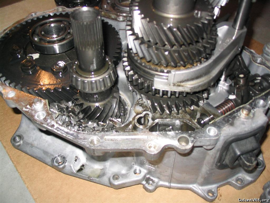

Here was mine. I did this back in '04:
I still have a GVR4 1st gear in 1051 which is part of the reason I haven't raced in so long. I know I'm gonna break it with this twin disk clutch and I don't really feel like dropping transmissions all summer long to fix broken parts. Next tranny I build will have the DSM 1st gear in it. The breakage is also the reason I stopped using Synchromesh. Not enough protection for the gears, so I run NEO RHD.

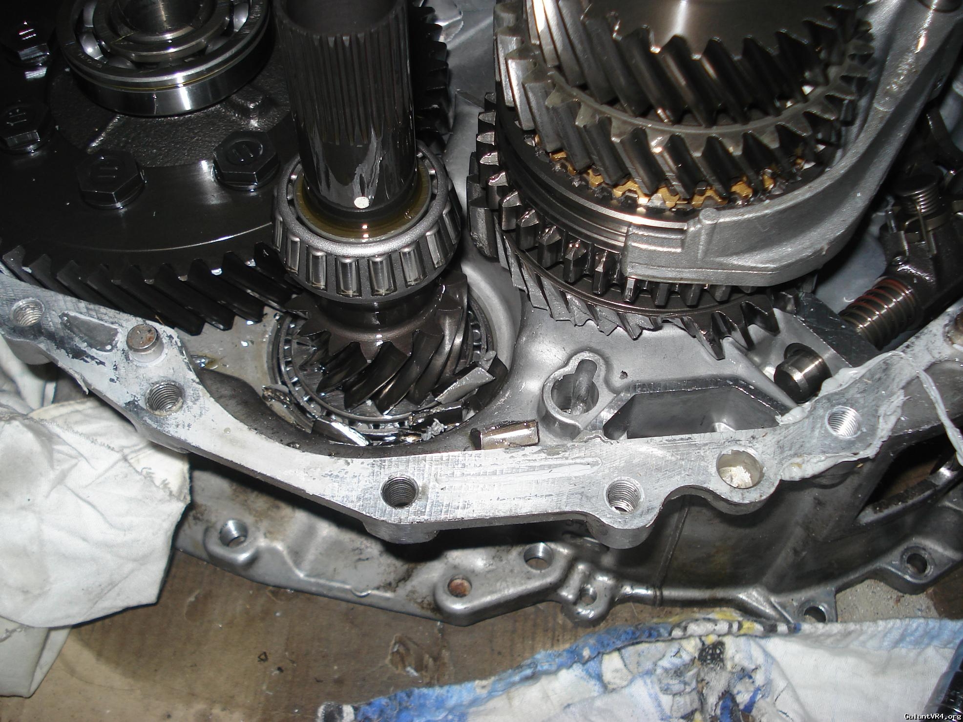

It's a bit OT but I have just pulled down a box that I broke a while ago and it looks pretty much exactly the same as Turbowops.
Mine wasn't done during a launch though, it seemed to happen right near the top of first gear while I was pulling away from a toll booth.
The box lasted almost 600km /ubbthreads/images/graemlins/banghead.gif
