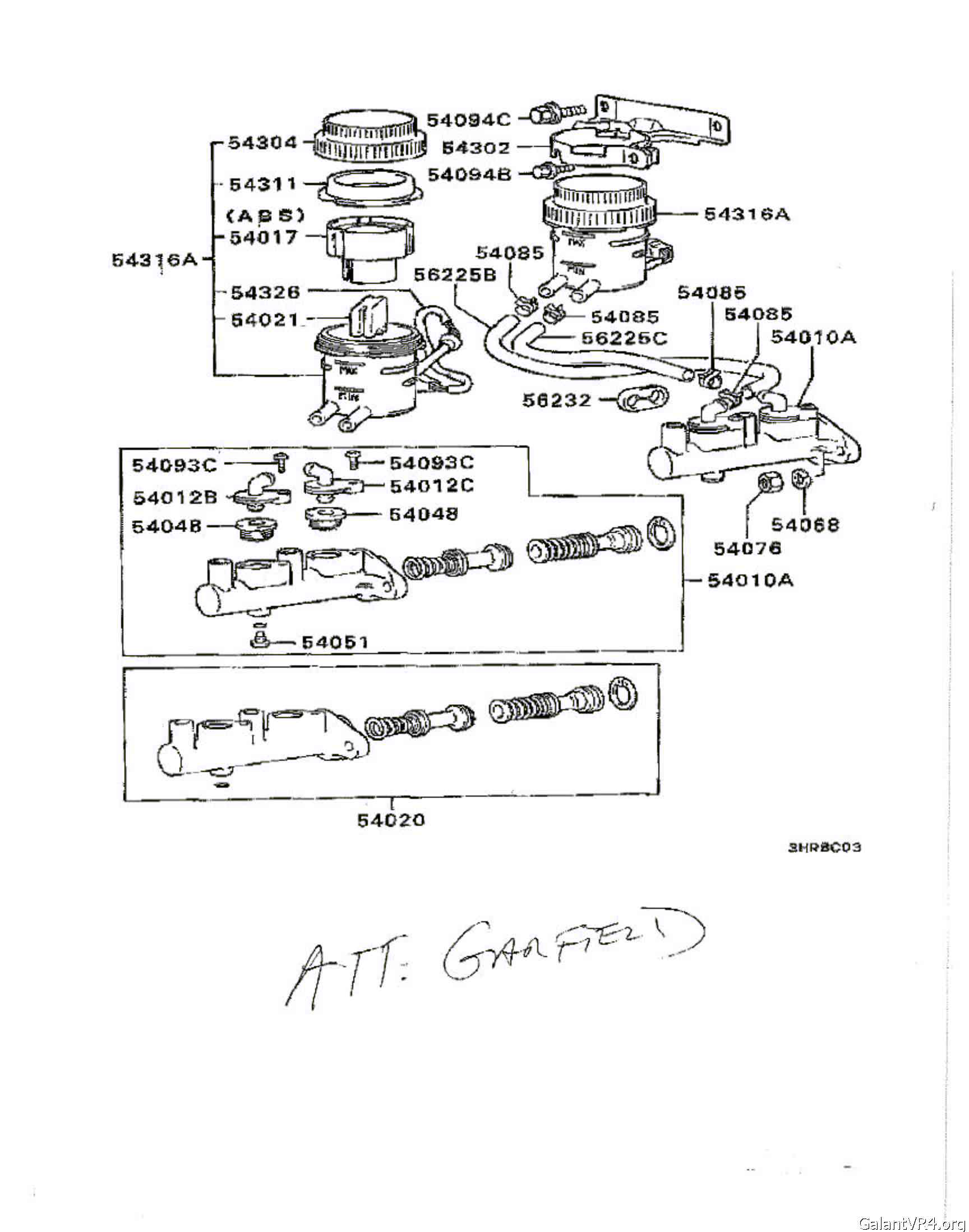

My brake master cyliner started leaking after one week of babying the brakes. Luckily the car was parked when this happened. So one more thing to keep in mind if you do decide to tackle this. My car has just over 214k miles on the clock when this happened. To avoid the downtime, you may as well replace this while upgrading. I believe the dealer cost is around $350, local auto store is around $70 after the core charge.

If I were to do this I would definitely look into getting a 17/16" master from a 3KGT or as someone else suggested an Evo 7. I'd guess that the 7 and 8 are the same one and may be a better option. If one of you with an 8 could take a few close up pic of the MC area so we can see how the lines are routed that'd be great.

I considered this upgrade, but 1st I need to get the car back on the road. Then source the 3kgt vr4 MC. Does it matter if it's 1st gen or 2nd?

I'm not sure. I'd look at whatever one fits the best. My guess would be that the Evo one would fit better as far as line location but that is just a guess. Check out car-part.com if you want to see if a junkyard has one for cheap. Edit: I just searched there and found 2 for under $100 /ubbthreads/images/graemlins/wink.gif.

I just got off the phone with Satan. Apparently Mitsu revised the MC over the years & moved the screw on the side to the bottom. At this point I'm leaning to believe that I have the correct replacement part. Not sure what the deal is with the screws not going all the way down. I'm gonna give it a shot again tonight. Maybe tackling it half-a-sleep @ 12 midnight presented some other challenges.

IMHO rebuilding or buying a rebuilt master cylinder is a bad idea. As Ken said, the aluminum just doesn't seem do well after a rebuild. I rebuilt my clutch and brake master cylinders (I honed them well) and neither has consistent feel. Now I have to do the same job again. I'm sure other people will disagree. YMMV. Keep us posted, Garfield.
