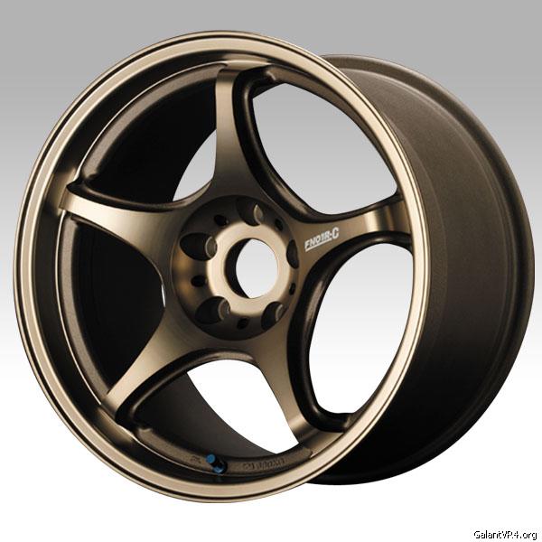

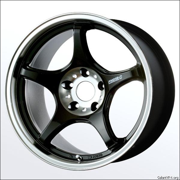

http://www.5zigenusa.com/w_fn01rc.html.[/url]
Can someone photoshop these on my car?
the car looks great and so do the brakes. I think the black/silver lip fno1rc's woudl look better on your car than the bronze because they'd match the two tone paint.

I know Mark & a few others are going to get royally pissed off very soon, but I'm planning on going with 5Ziggen FNO1R-C 17x8 35mm bronze or black with polished lip. I like the way the black w/polished lip looks but always wanted to go w/good quality bronze http://www.5zigenusa.com/w_fn01rc.html.
Jermaine told me the Evo 8 wheels clears these capilers also & are the same size & offset. He already test fitted the Evo 8's & will be running them until he can some TE37's.
Correction: The Evo 8 oe wheels are 17x8 +38mm offset. 3mm extra space should be a perfect fit.

I can get the 5 Zigen FNO1R-C pretty cheap.. let me know if you need a set.
