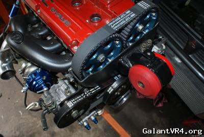

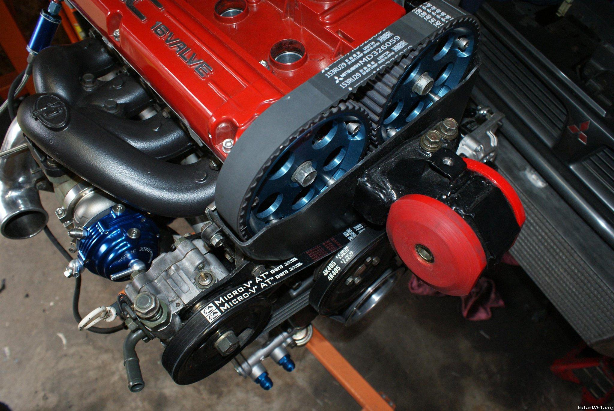

It's actually a 2g power steering pump.
Finding the right size belt was tricky. next step down from what's on there now is a big jump, and the next size up was fine at first but stretched to the point it would chirp even with the tension maxed out. The correct size was a bit of an odd-ball size that nobody really carries.

Quoting Turbo99:
2g dsm.. 7g galant. same thing, innit? I had no issue finding a belt that fit properly. I just took a chunk of wire and made it into something that fit well and went down to the parts store.
I'm running a Gates K040270.
strokin4dr
Aug 30, 2005
2,773
Savannah, GA
Quoting mitsuturbo:
Ah. I gotcha.
Are you also running a 7th gen PS pump with a 4 rib belt? Mine is the only other GVR4 i've seen with this...
Running 2g ps pumps on both of my cars. 2g mount bracket w/ a cut and welded drivers mount also. Cleans up the area nicely!
