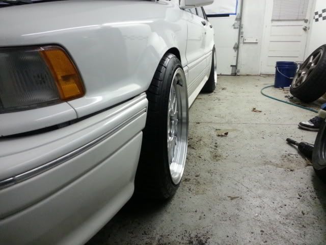

I am almost 100% positive the camber is the issue (just popped the wheel on the hub to see how it sits). In fact, it looks like it has a little positive camber up front /ubbthreads/images/graemlins/uhh.gif (yuck).
I'll crank the BC camber plate all the way in and see how it looks. If people can successfully cram 235 Star Specs on 17x8+35 I don't see why it wouldn't fit to be honest - those tires run wide and people are pretty low on that setup. Just looks scary to start /ubbthreads/images/graemlins/grin.gif
Rear spaced 5mm (17x9 +30)
Trailing arm clearance /ubbthreads/images/graemlins/ooo.gif
And what I have to work with up front.
Keep in mind, this was also spaced 5mm, so it will come in a little, but seeing that much barrel makes me cringe /ubbthreads/images/graemlins/rofl.gif
I have faith that I can make this work. The car will not be super low and between the BC's and Whiteline goodies I should be able to keep things in check.
It looks scary because the bottom of the fronts of the doors is the narrowest part, but it's not that far out from the bumper.
My guess is a 235/40 and 2.5 degrees of negative camber will leave me with enough room for the tires to just tuck in the guards for suspension travel.

Moved the camber plates in, I think we have a winner.
Will sit 5mm closer to the hub than this.
And so you can see how they'll look on the car /ubbthreads/images/graemlins/grin.gif
