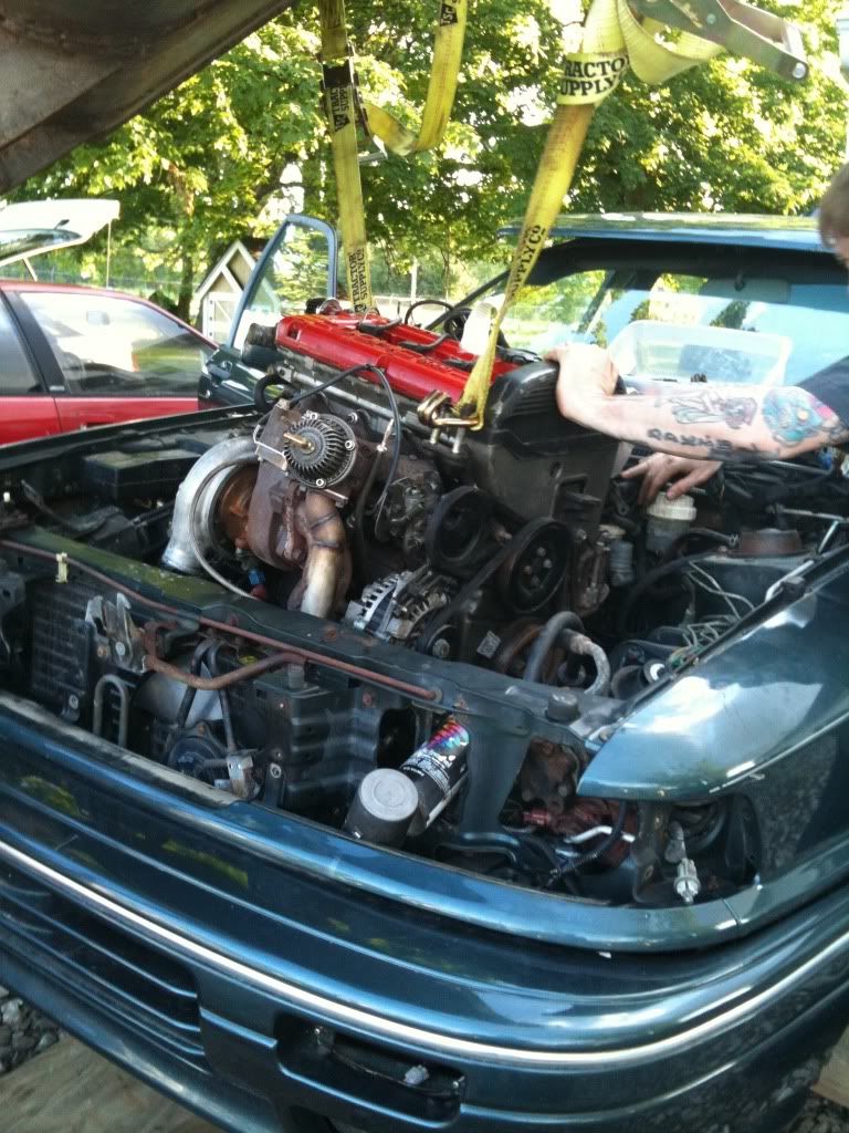

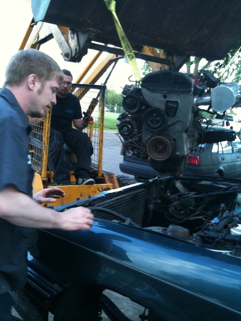

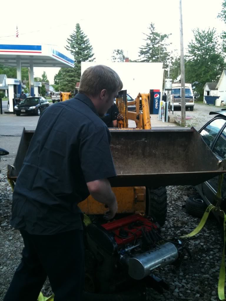

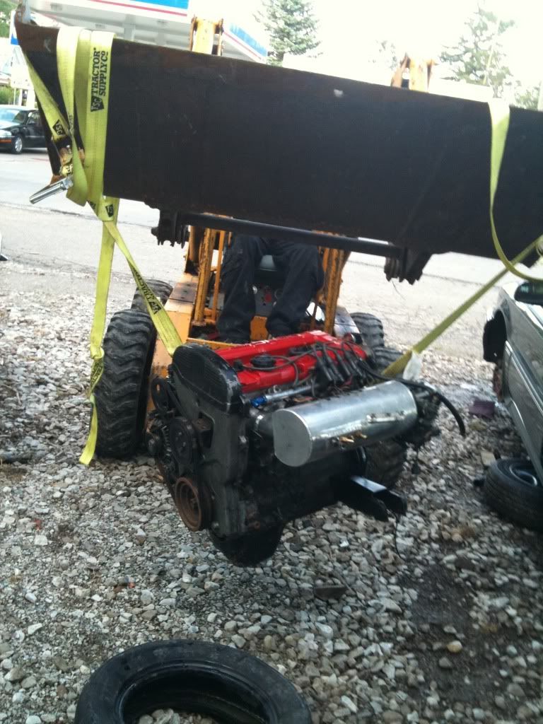

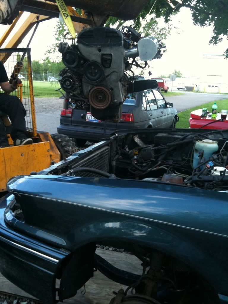

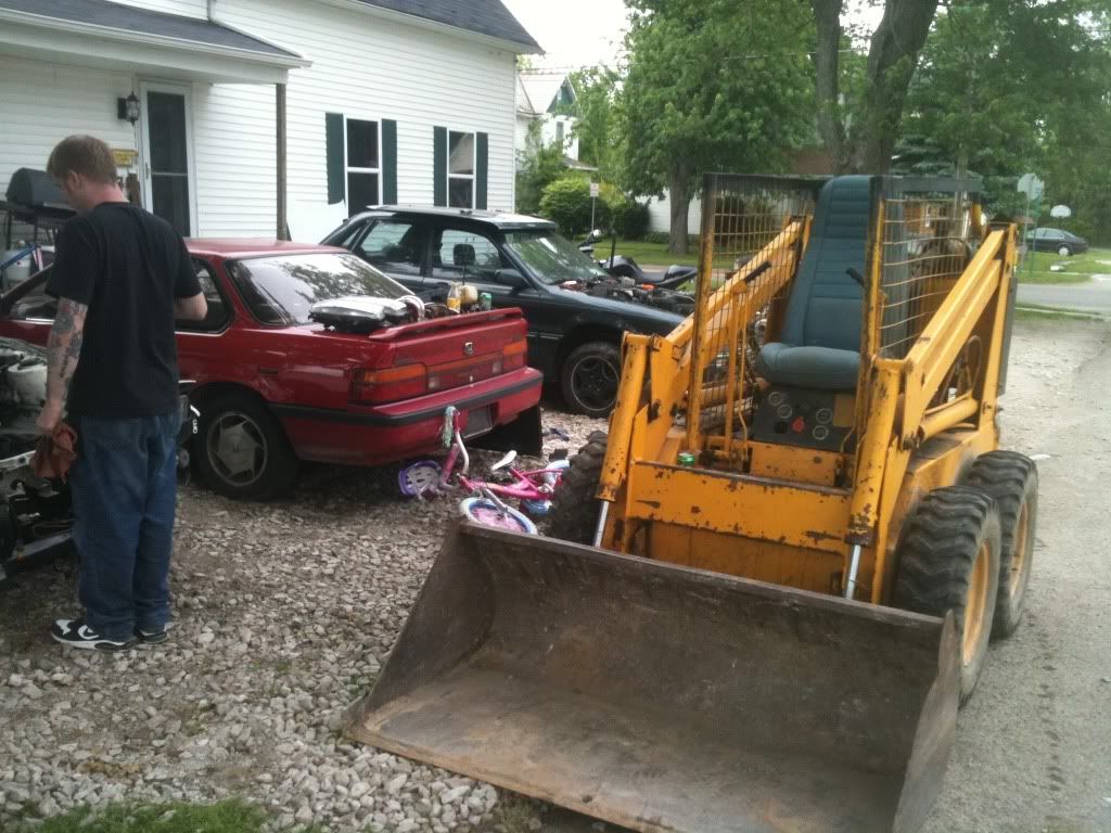

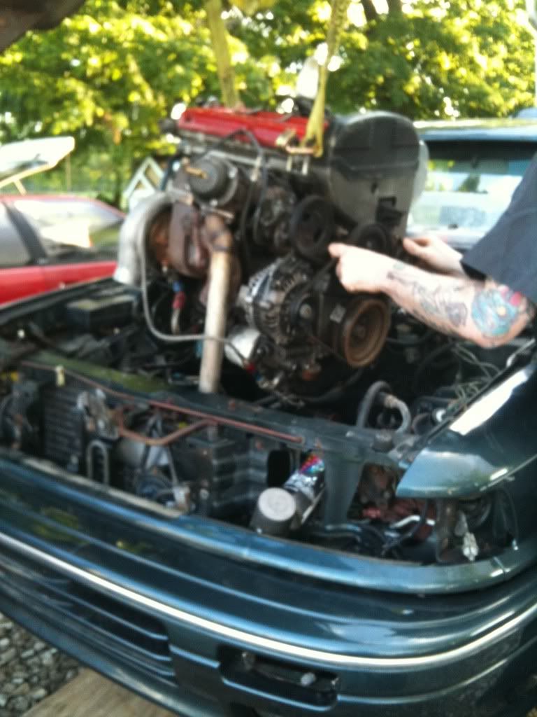

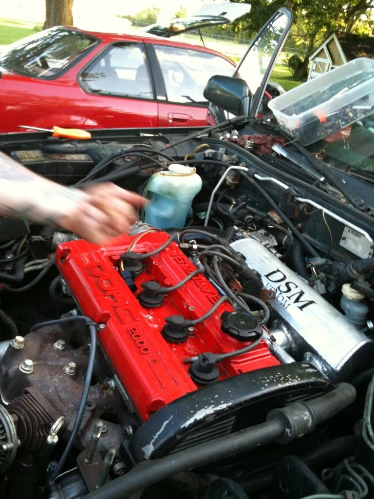

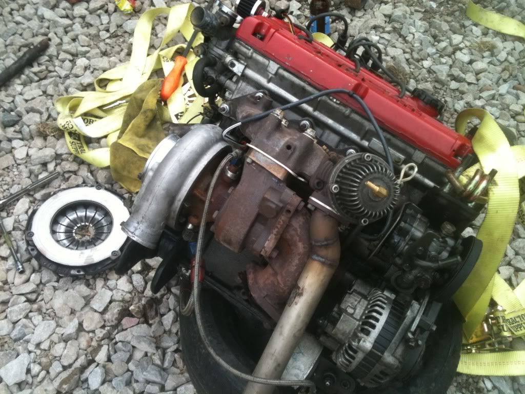

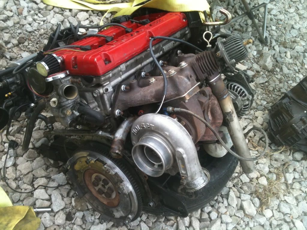

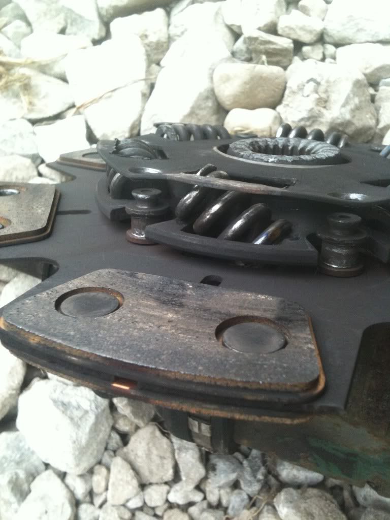

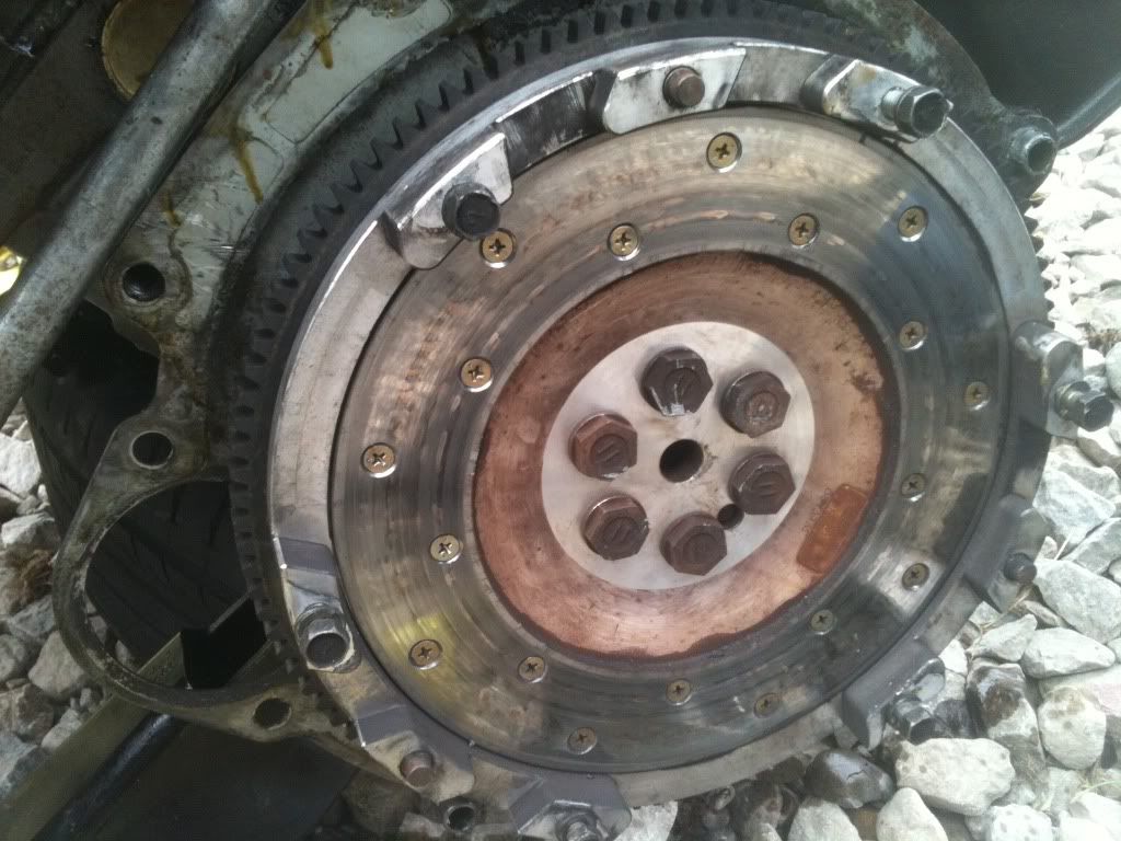

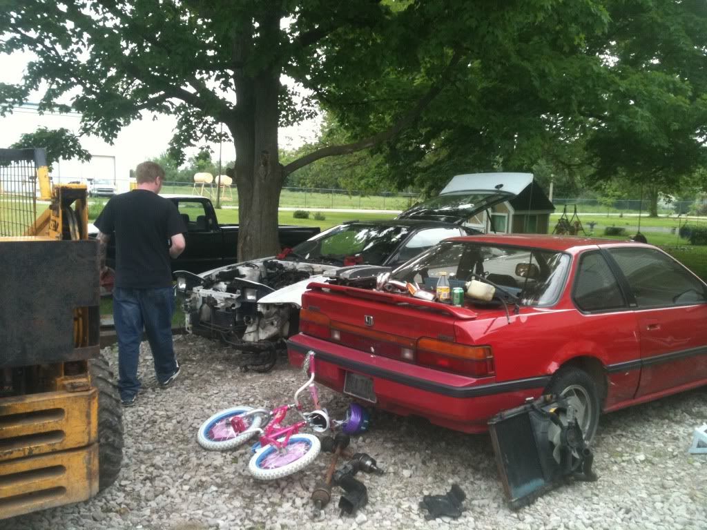

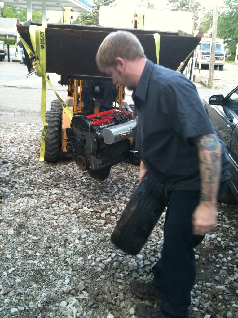

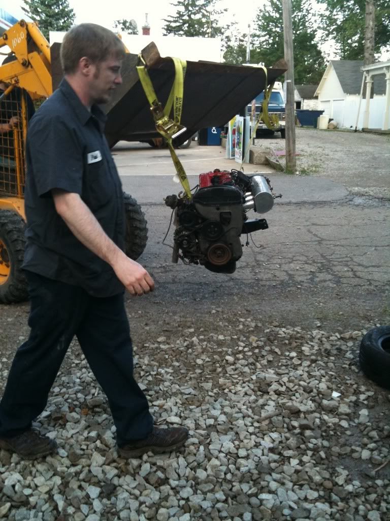

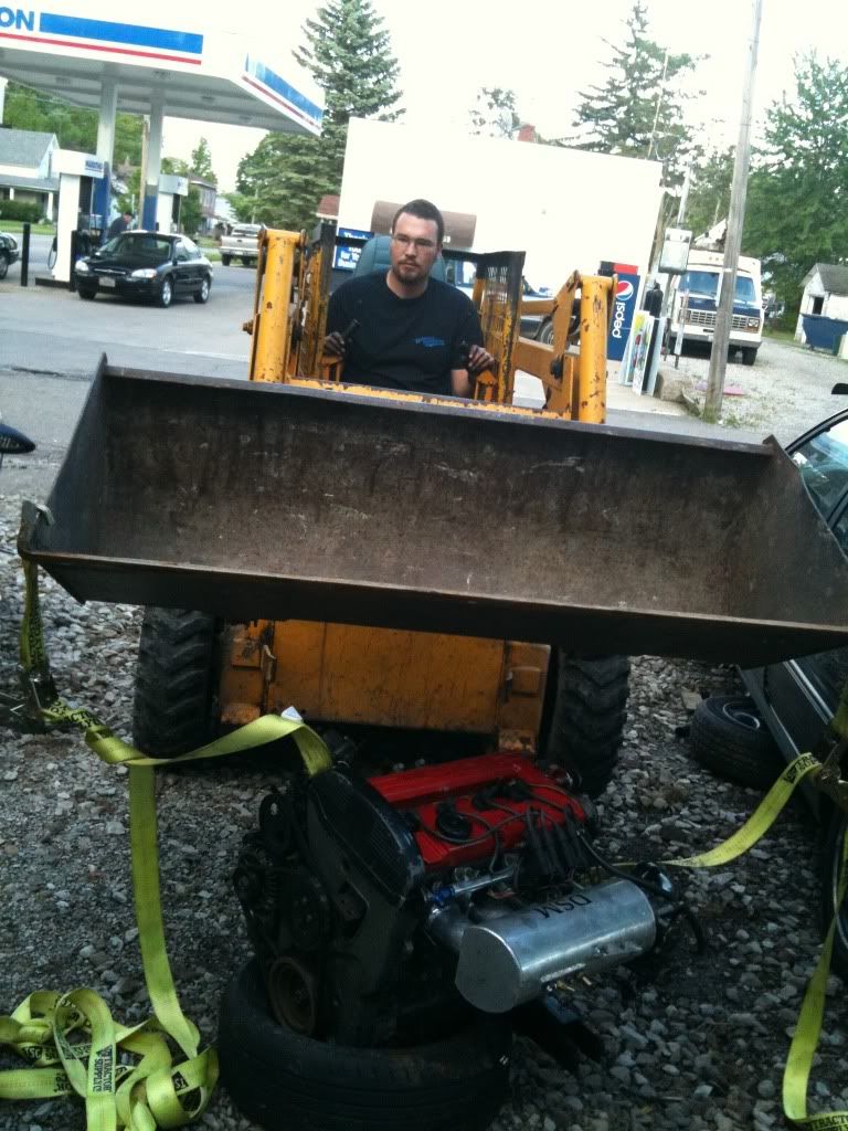

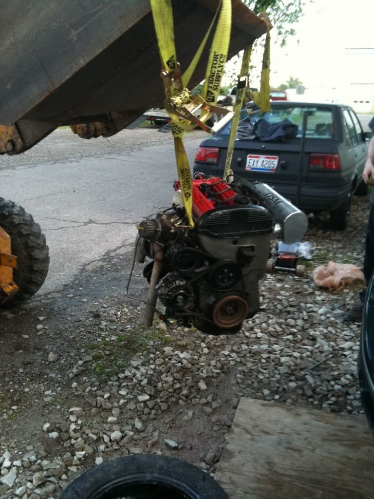

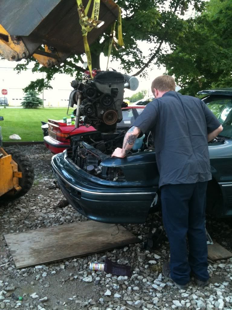

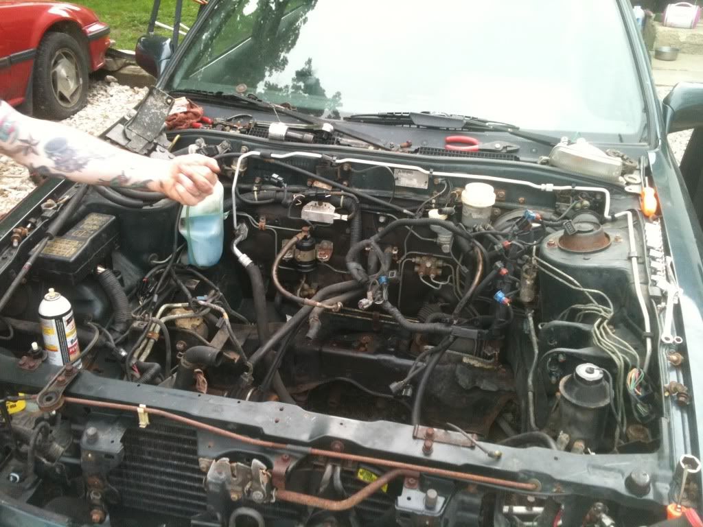

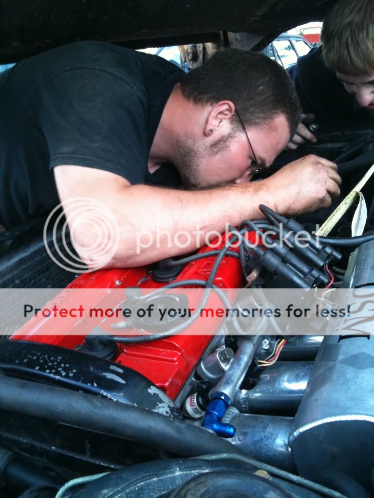

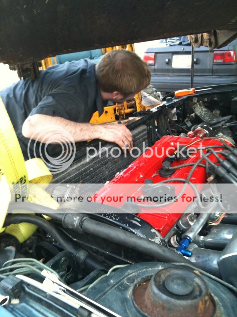

Alright got the tranny off and everything else buttoned up. Did not get the engine dropped in due to two different motor mounts. Any one curious its the front and the back are different. Will be pressing the old out and the new in tomorrow and hopfully the next nice day get the engine dropped in. Here are some exciting pics from the day. Note the captions on each.

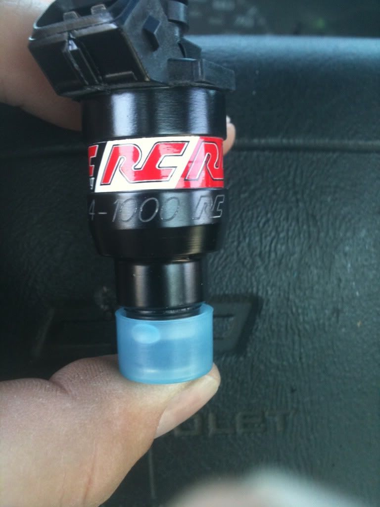

the new rc 1000cc blood pumpers
oh couldnt guess what the issue is. Someone please tell me
pp got rubbed aliitle bit but still looks ok.
fw still looks good. To bad I cant use it.
sh*t laid out. Yet another pp shot
getting ready to go in before the realization of the motor mount issue.
the new home of the forged engine. She will like it there. Get plenty of abuse.
the aftermath of the gst
the hillbilly engine hoist. FTW. This sh*t works great minus the noise.

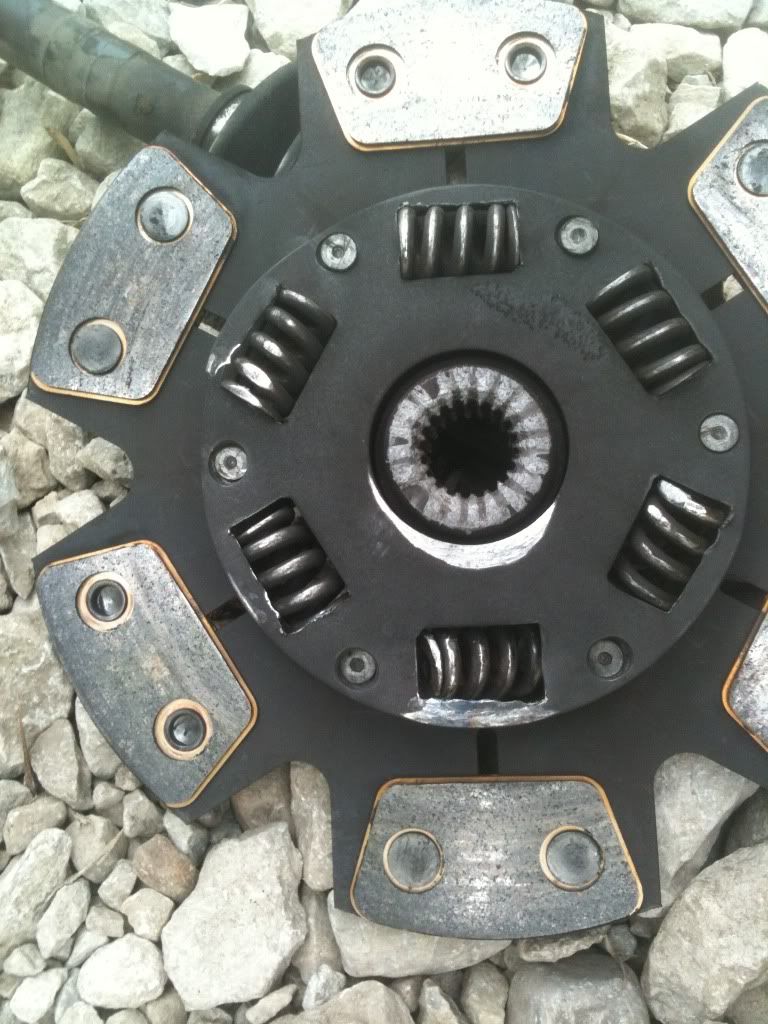

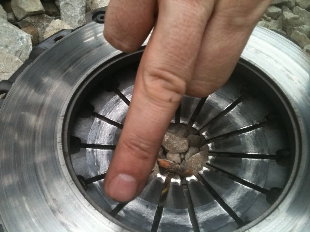

This is why I say xtd is a pain in the ass. I have 5k on this disk and pp and this is what it gives me. I slipped it once at24-25psi on the holset. Its rated at 350hp.

Wow it looks like it is rated as a good paper weight or something that you never ever never need to run again. I got a Act 2600 I think if you want to buy it. It is brand new let me know. It is a six puck
willyp20
Apr 28, 2010
61
Cardington Ohio
Going in a different direction then a heavy pressure plate. Almost stock plate with a really grabby disc equates to a good dd and no act leg. And I have been told that its good for 450-500hp.

Question for all. What will cause a brand new set of 1000cc RC's not to fire? Plugs are dry as a bone and no hint of fuel.

Are you getting fuel to the rail? Maybe something fishy went on and the pump fell off causing little to no fuel to reach the rail.

Yes there is fuel to the rail. Left the gauge off the AFPR to purge the fuel lines and there was alot coming out. Also builds fp up to about 35 psi when cranking on it. These are the injectors I have. click

Stick a long screwdriver to the injectors and listen while someone tries to crank. If it ain't going tick tick tick the driver in the ecu is funked That or the grond side isn't grounded. Have to look and can't remember how its wired but you have a break down in the electrical side some where.
