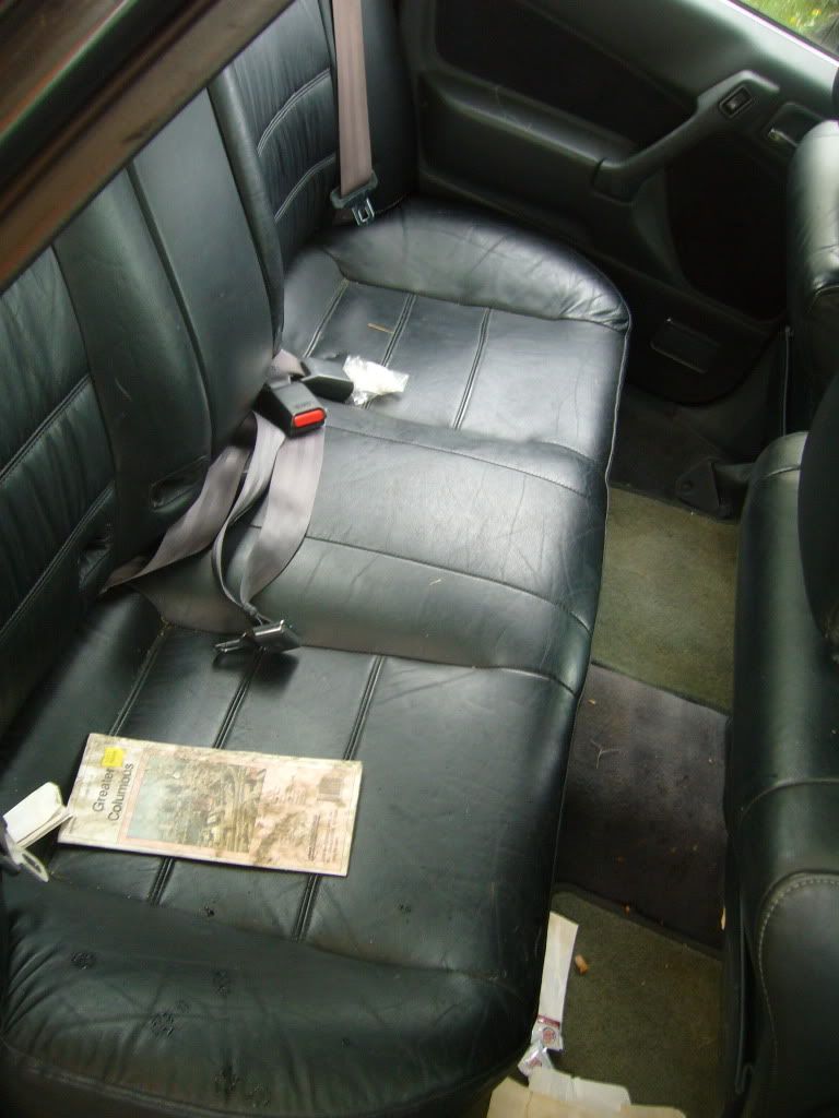

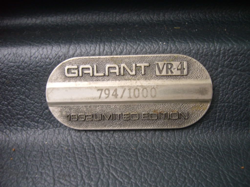

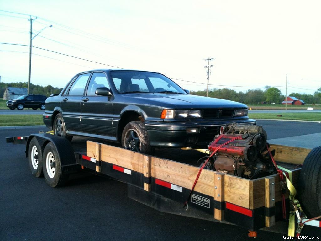

I recently aquired a 1992 Galant VR4 #794/1000. I am the third owner and it has been sitting for a year and a half in a pole barn. I have been into dsm's for awhile now and have built up my gst to where its not any fun anymore so this is the replacment. My goals for this build is for reliability and comfort. Along with fast and handling of course.

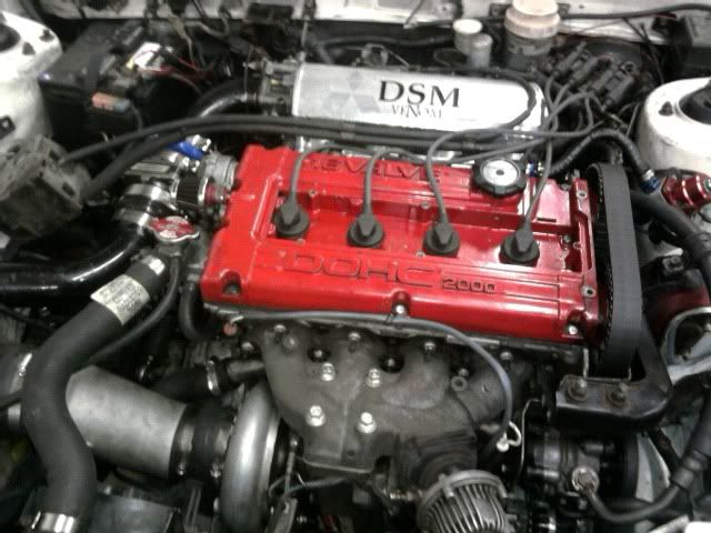

Engine specs
6bolt base bored 20 over
Wiseco Pistons
Manley Rods
Clevite 77's
MLS HG
ARP ROD and Head studs
BC 272 cams
Manley springs with TI retainers
Venom SMI
PTE 680cc injectors
SAFC NEO currently but switching to DS-Map soon
As I said this engine is still in the gst but will be removed and transplanted into 794.

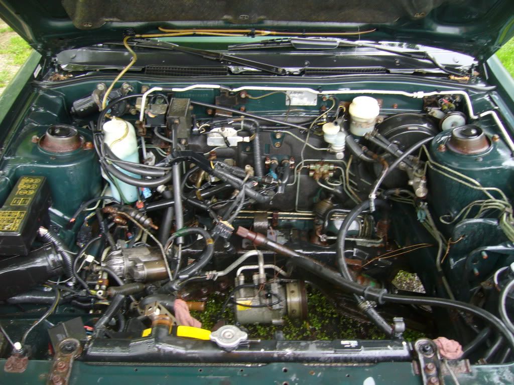

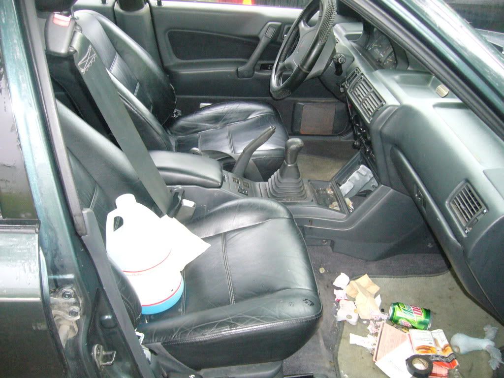

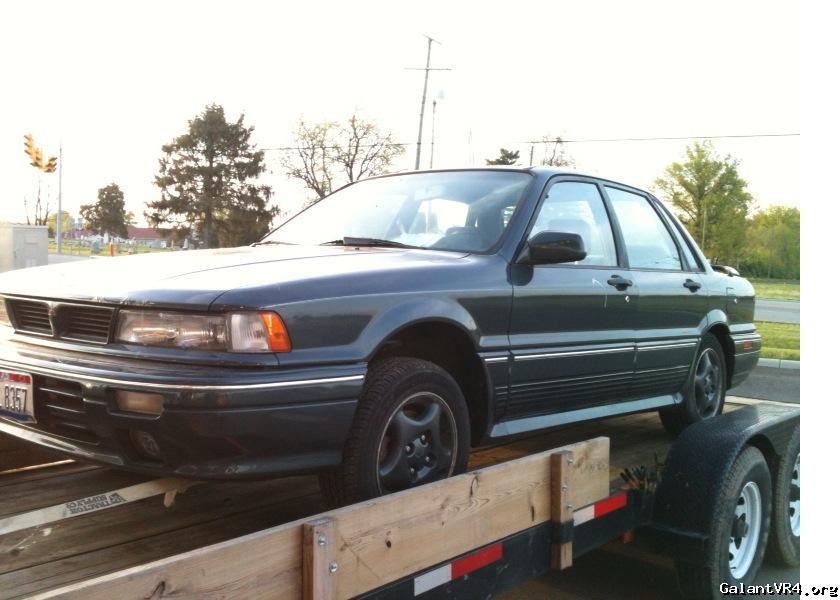

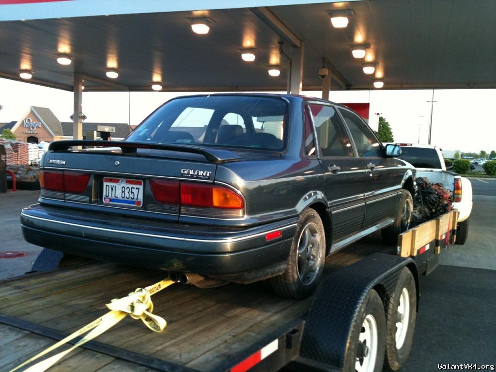

These are the first string of what is to come of this project. I picked it up last night and brought it home. This weekend will be cleaning, Gunking and powerwashing the engine bay and retaping and fastening everthing back to where it goes. I will keep everyone posted and take alot of pics. Plan on this thread to picture intense as I go along. Thanks everyone for welcoming me and I look forward to get this thing rolling. /ubbthreads/images/graemlins/smile.gif

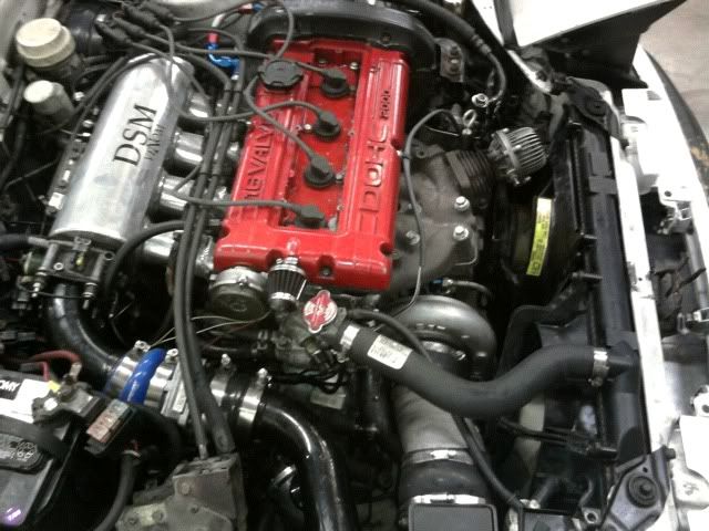

I took a few more pics today. I am going to start tearing into the gst this week I think. Pulled the ecu out today to prepare it for socketing. I am going to also try to order my ostrich this week too.

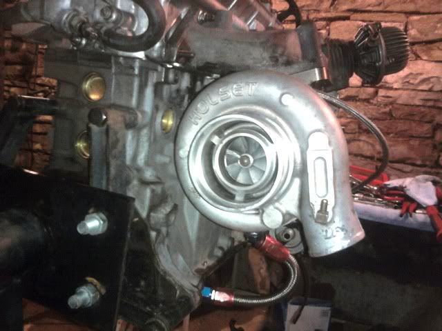

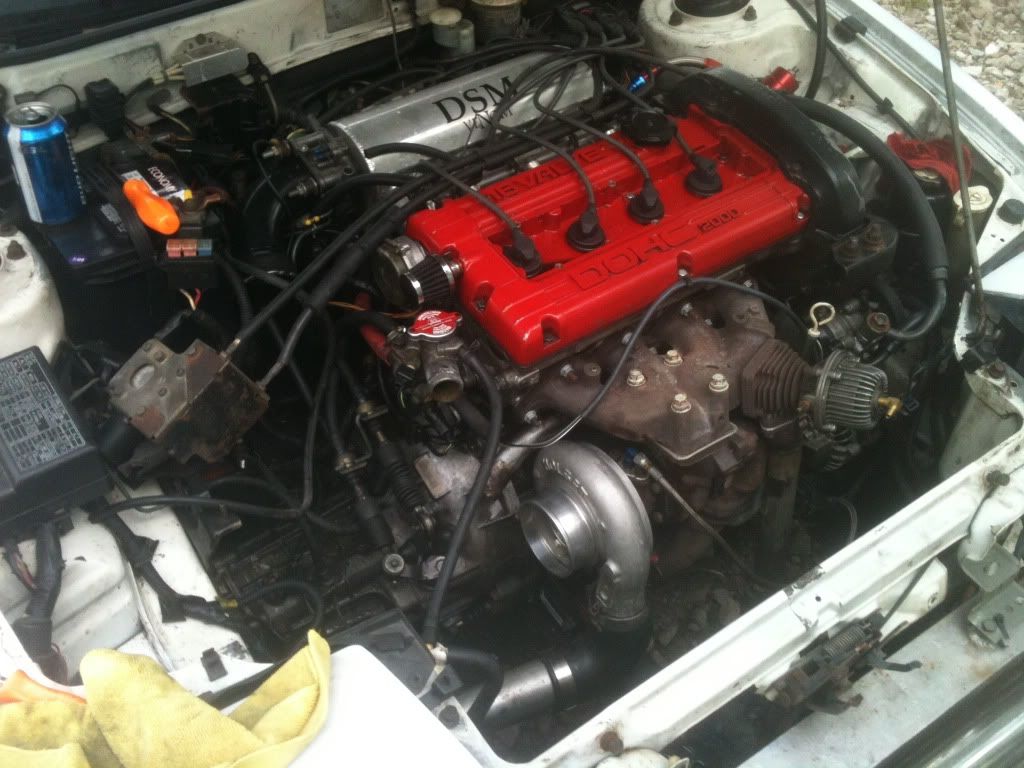

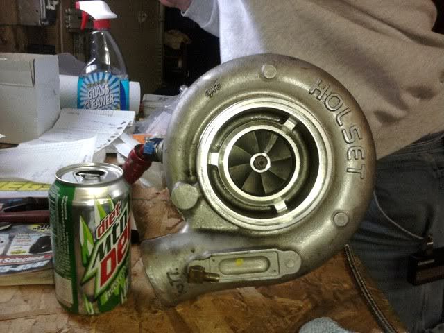

This is the powerplant that is going in the VR4. Should be fun... Working on getting my ecu socketed this week and getting my ostrich. So when It comes time Ill have everything ready for the first fireup.

Are you planning on using that exhaust manifold and waste gate as well? I think you might have some radiator clearance issues with it?
Looks like a nice build.
May 4, 2003
11,892
Clarksville TN
Agree the hks pineapple may need to be turned and whats up with the diet Mtn Dew. That's like caffeine free Mtn dew ....whats the point.
yeah clearance is a lot different in the vr4s over the 1gs. i had to have a custom manifold made for my car to fit my turbo.

I hope this not be the case. I cant afford another manifold. My wife already wants to casterate me. And john. Your an ass..... /ubbthreads/images/graemlins/applause.gif
You wont have to have another manifold built but you could get an aluminum radiator to put under the support or do a half cut civic radiator in aluminum.

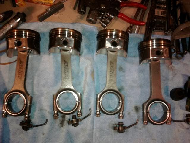

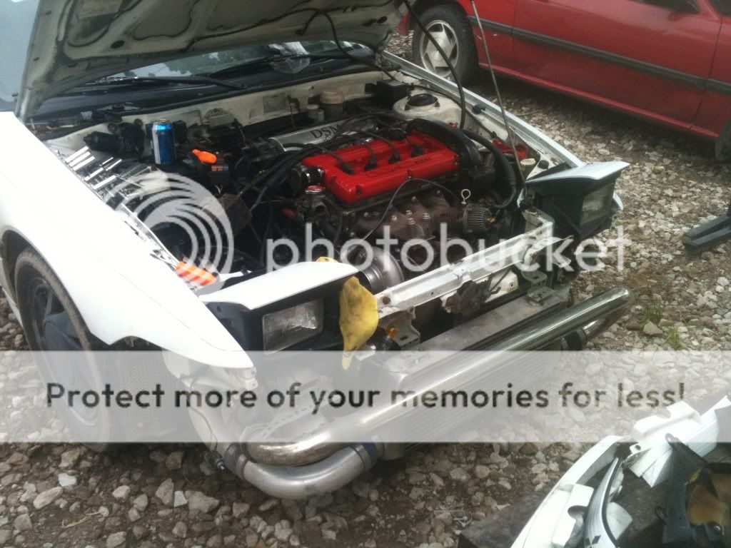

Well I was not planning on getting to this so quick but I want to make it to the import nationals the 30th of this month. Here are some pics of me tearing apart the gst for the powerplant. Im planning on dropping the block into the galant this sunday and hopfully I will have my clutch so I can put my tranny in by the middle of next week and be driving it. Holy sh*t I cant wait.

There is going to be some work routing the piping for the innercooler though. I am not looking forward to this part. I will not be using the same piping as what you see on the eclipse BTW.
