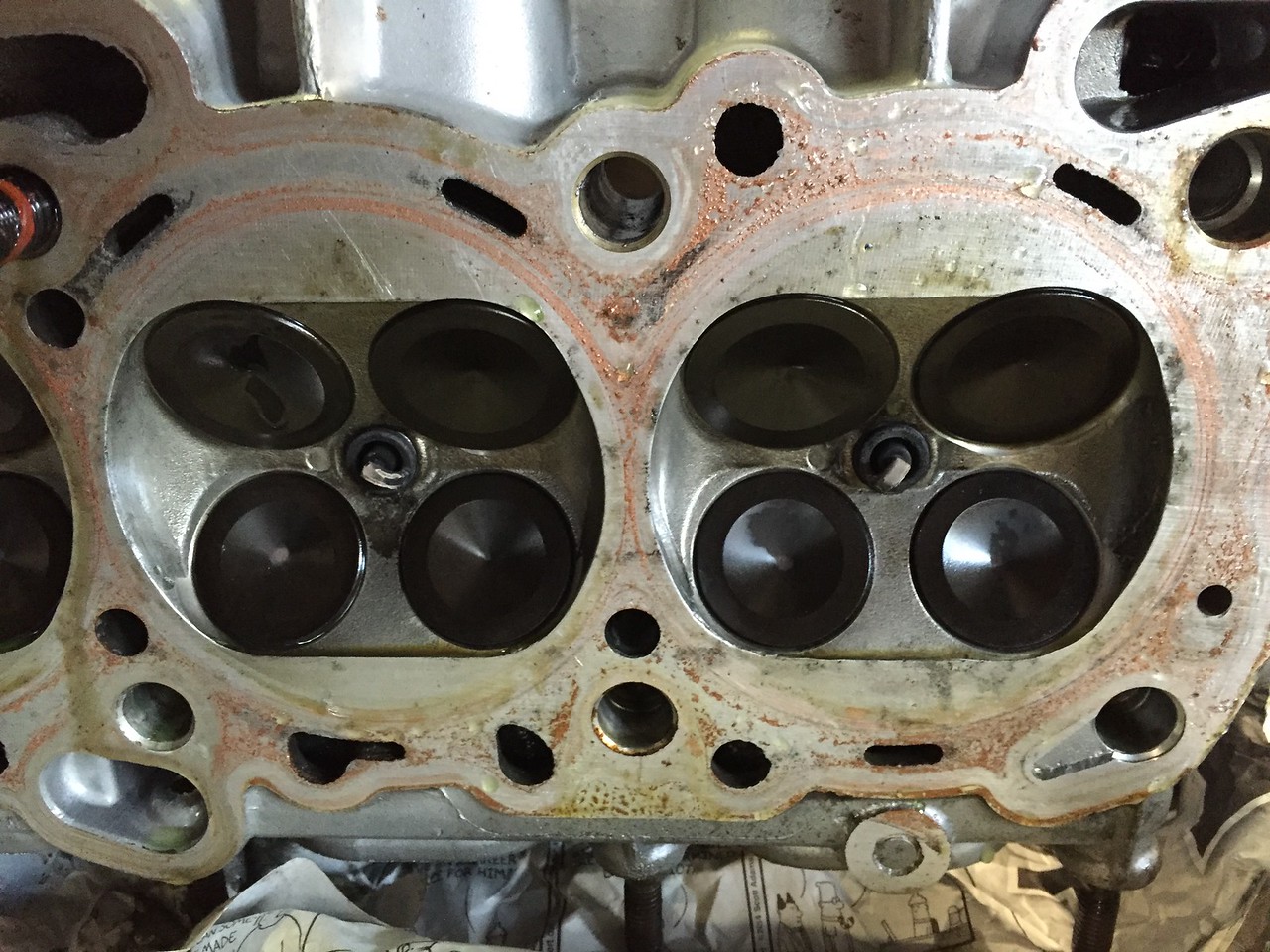

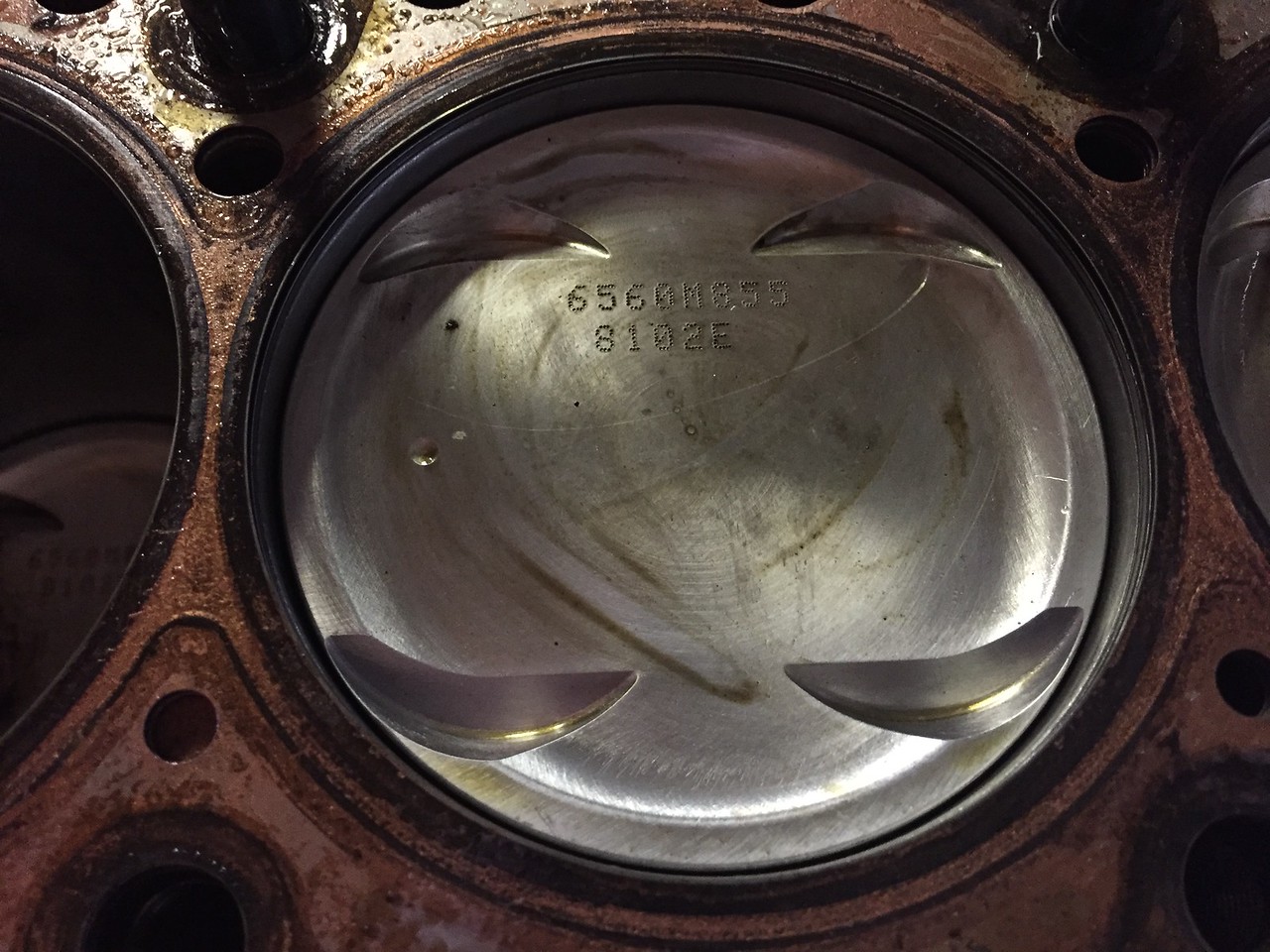

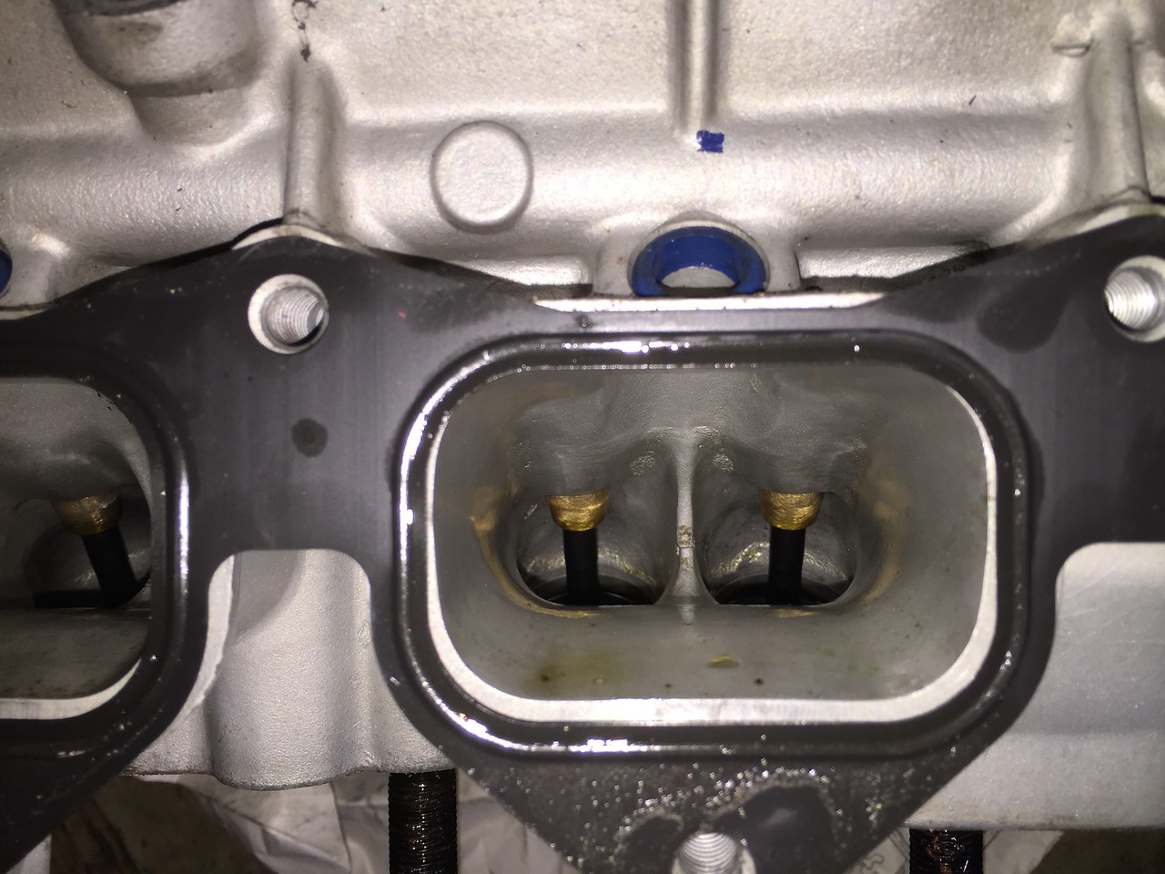

Got the motor out and on an engine stand this afternoon. Then pulled the head off...here's a few Iphone quality pics of what I see:
9:1 Wiseco 85.5mm +.020" overbore pistons. (oily on top, but basically brand new. TommyD said the motor had like seriously 3 miles on it and was smoking.) Ill pull the oil pan and start checking rings and investigate what rods are in there tomorrow possibly. All the bores look very nice..no scratches.
Head has +1mm stainless valves, aftermarket springs/retainers. Deck surface looks minty. Lots of oil in all the head ports and chambers.
Nice looking port work.

Those ports are terrible, hope your joking. I see huge cast marks at the bowls. Biggest airflow choke there is. Very nice valves though, look like the MAP valves I used.
Do you think the head gasket was holding together? You said lots of coolant and oil in the ports, maybe I misread.
Hopefully when the guides where installed the guide bores weren't damaged. Did the plugs look like all 4 cylinders were burning oil, or just one?

hahaha yeah, I jest. someone went nuts making the port ultra smooth up by the flange, but didn't clean out around the valve seats at all where it's most important. yeah valves look good. has oil everywhere, but I don't see coolant. All 4 cyl look the same, so I kinda suspect some sort of assembly error rather than a part failure. wondering if Im going to find broken oil rings, missing oil ring or something like that. will see tomorrow.

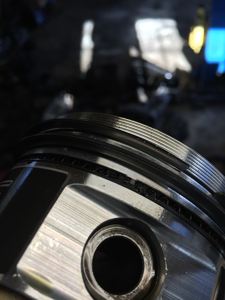

Pulled piston/rods from #2 and #3 quick on sat morning while waiting for a customer to pick up parts. Manley Turbo-Tuff rods (nice $) and the wiseco pistons are in pretty excellent condition. Barely scuffed yet. I didn't find anything drastically wrong with the rings yet, at least on these 2 holes. The gaps weren't staggered around like they should, but I don't think that's the smoking cultrit at all.
Will see if I can get some time money to pop those rings off and check the end gaps. would be nice to find "something" awry to fix.

I saw one where someone lined up ring gaps and it smoked like a chain smoker that's under a lot of stress lol

Pic no worky.
If the ring gaps line up (even top and 2nd) this will burn oil dramatically. Honda is having huge issues on their engines doing this. The offset ring gaps are what prevent crankcase pressure from working it's way up to the combustion chamber.
The oil control rings can be not lined up and this will still happen. Ring rotation is a normal part of the cycle, but if the rings are improperly installed during the build, then the engine can have a lifetime issue of oil burning. (crazy as it sounds)

Fixed the pic...yeah....the oil rings are not staggered end gaps 180*....this piston (I think #2) they are literally lined up. The other one I pulled, I think the oil ring end gaps were maybe spaced slightly apart...maybe say 25* rotated apart. Upper rings don't seem to be specifically staggered at all, they are random.
Nelson also suggested to check for dots or paint at the end gap tips to signify "this end up" as well, possibly rings upside down too.
Now that I see at least one cyl with the oil rings lined up, I'll certainly pull all 4 cyl, remove the rings and check end gaps to be sure they are correct, then do a proper re-install or replace.
BUT....this is the smoking culprit Im pretty sure /ubbthreads/images/graemlins/smile.gif

How did the plugs look? Did they have build up? I'm about 98* sure that's your smoking problem too. Too be safe I'd get new rings.
Hows the cross-hatching look? Is it even close?
