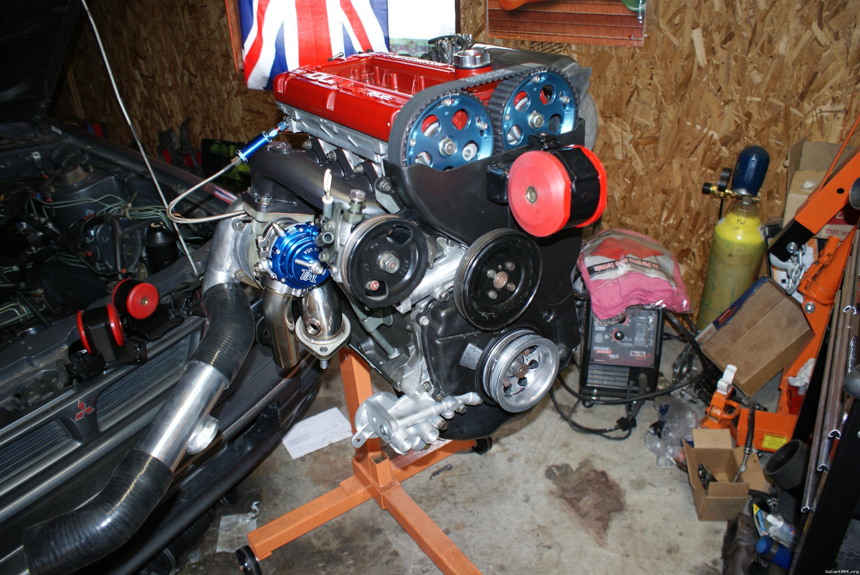

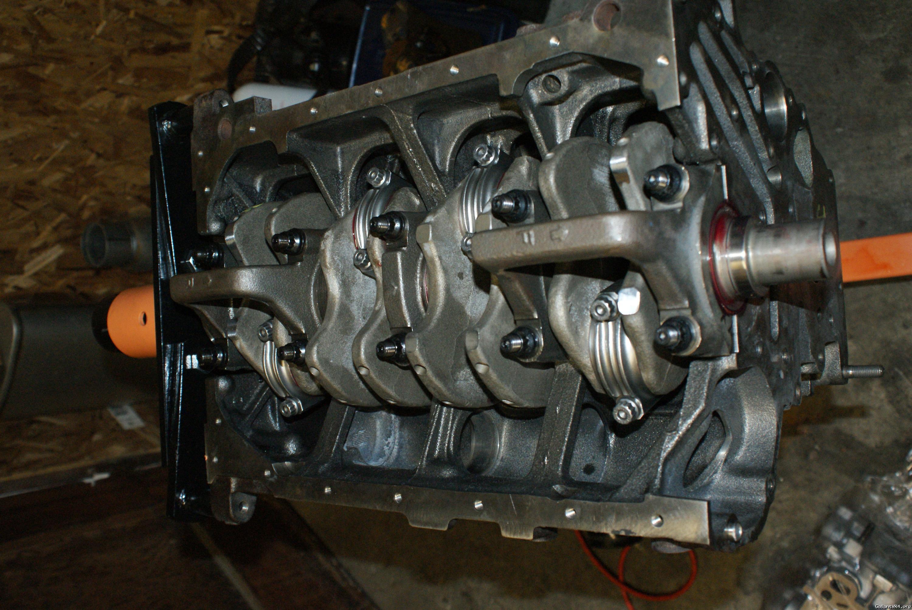

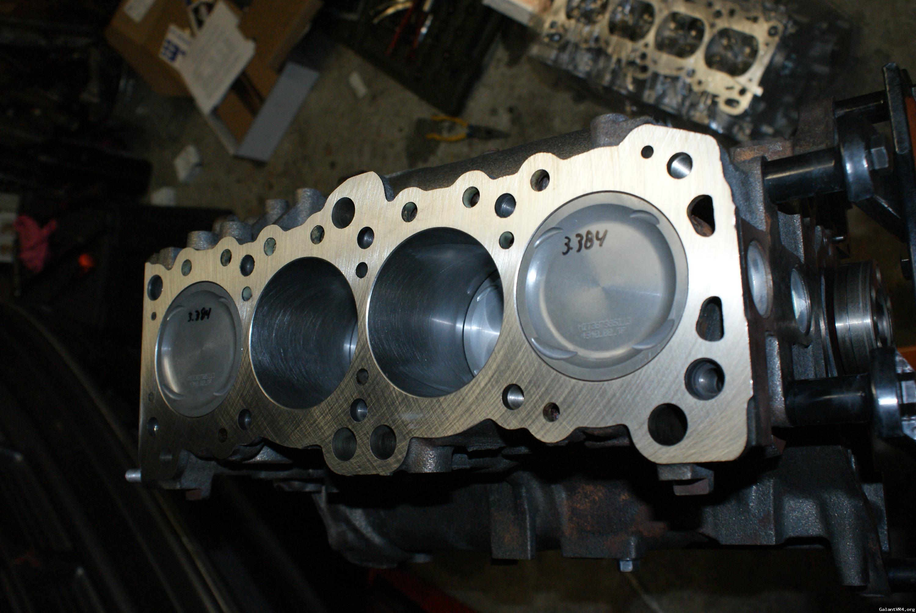

I got this stuff put together tonight.
Took my time, made sure thrust was at .005" clearance. Made sure everything was right and tight, and clearanced and aligned properly.

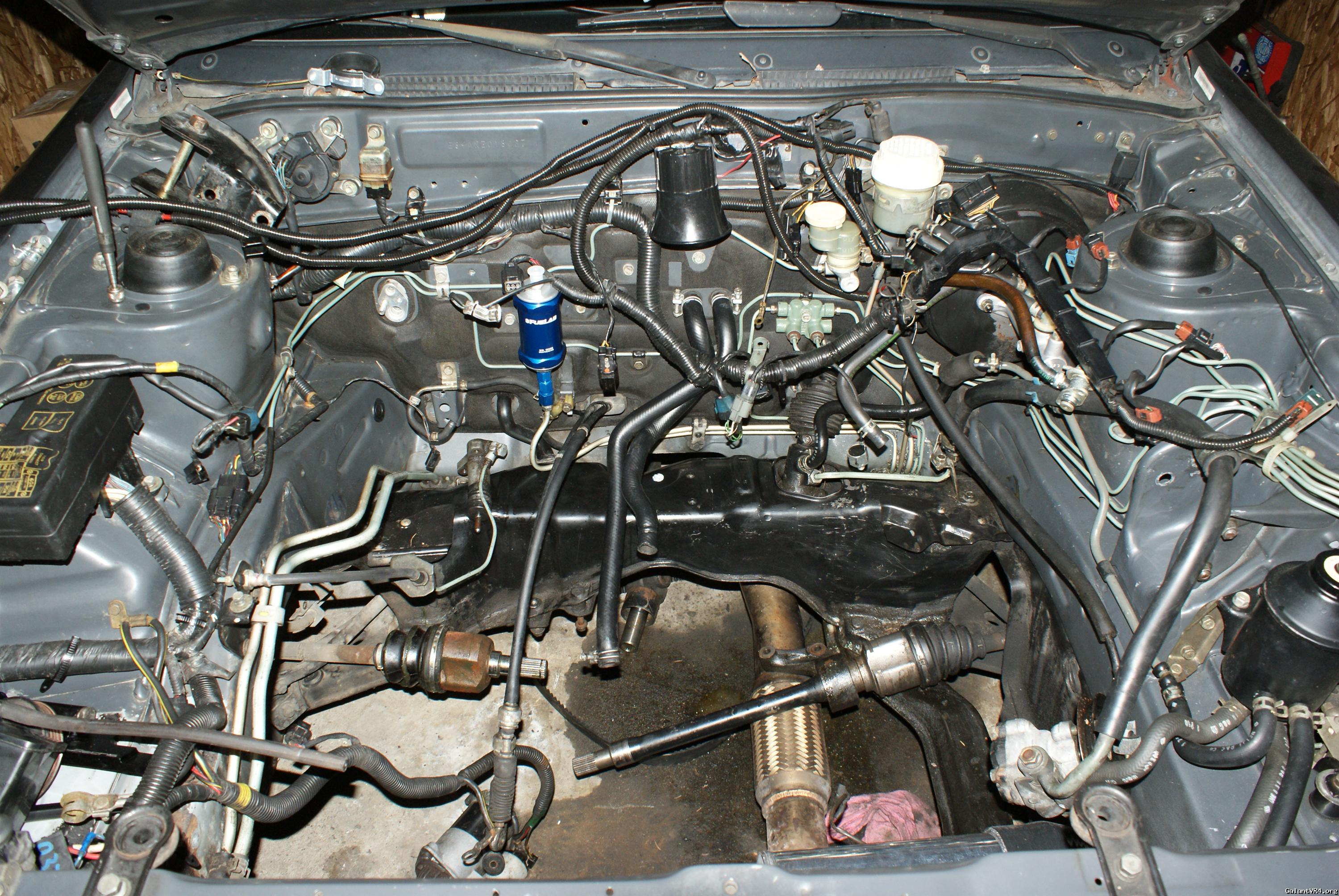

I did a little more cleaning in the engine bay as well. I still have a long way to go.

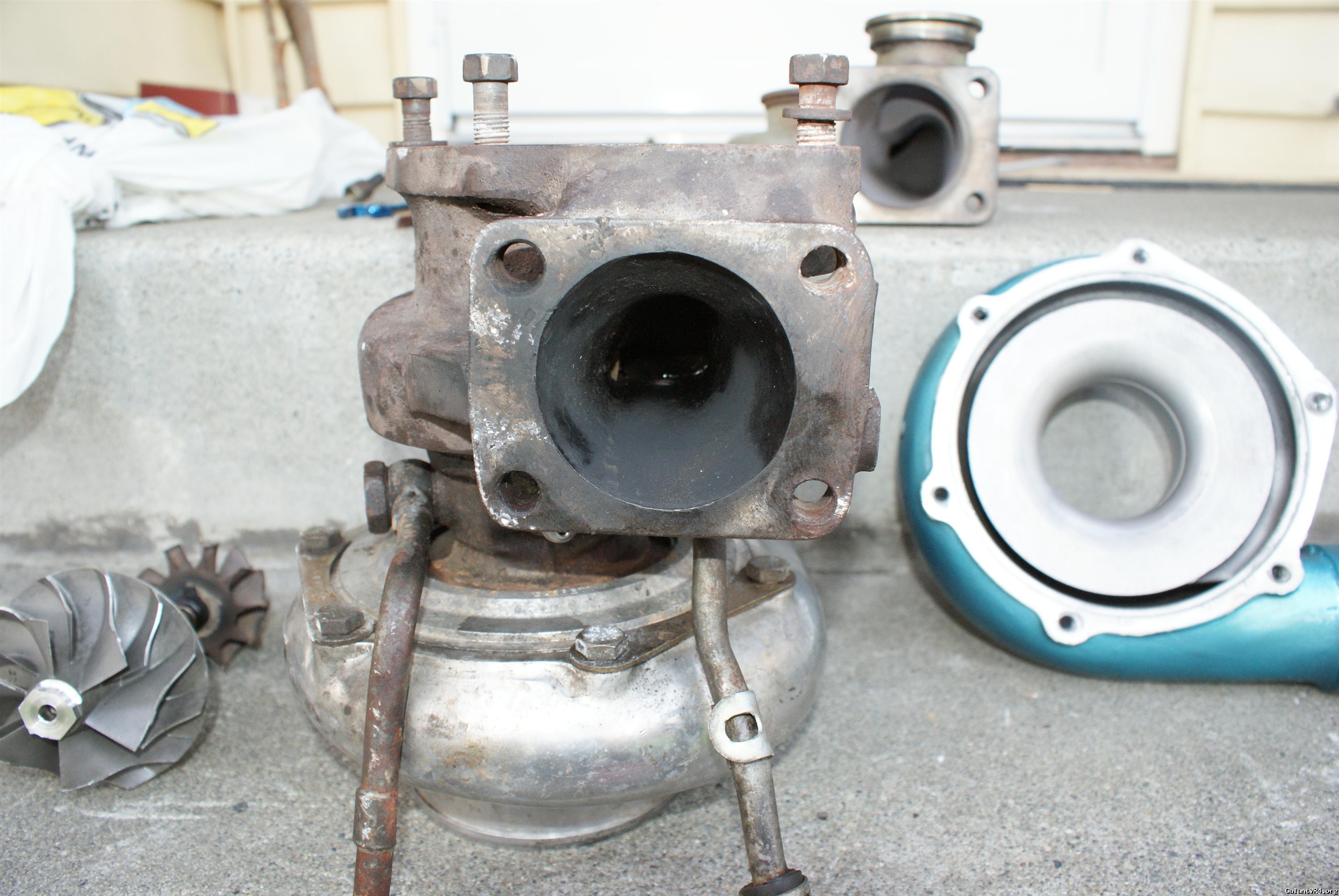

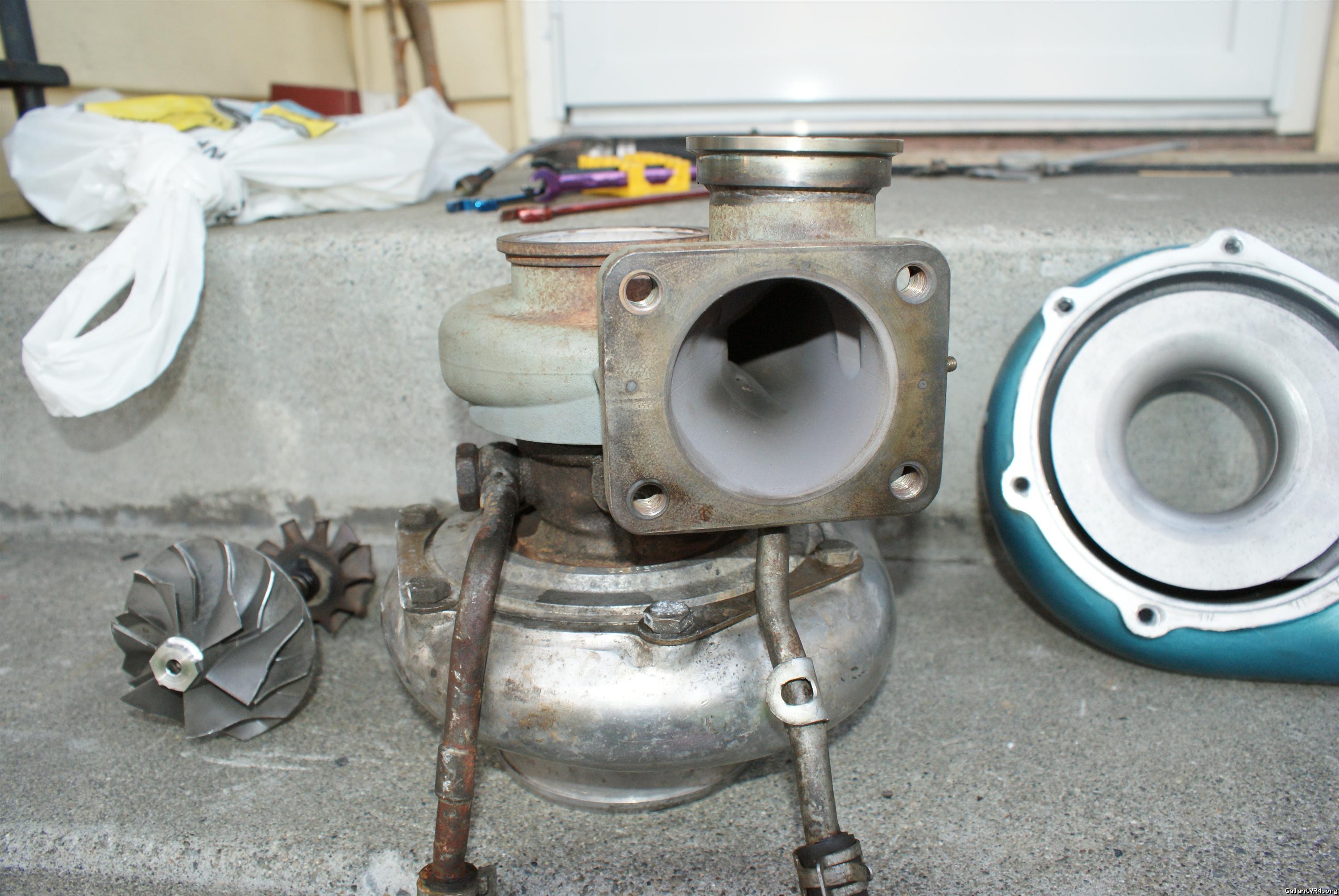

My b0rked turbo showed up today. I'm pretty damn happy with the purchase, considering i expected it to be in MUCH worse shape than it is.
The compressor housing is TOTALLY re-usable, and the turbine housing is just incredible. I should have bought one of these for my 3076r long ago.
OLD turbine housing - some reworked mitsu stock cast garbage
NEW turbine housing - Coated FP HOTNESS
Really can't beat it for $225 shipped, considering the turbine housing alone is $399 from FP. If and when this turbo goes kablooey, at least a replacement CHRA won't be crazy expensive. I could always just order the fp3065 chra. The guy i bought this blown up one from said they want ~$900 for one.
Yes, i know my compressor housing is FILTHY. I'll polish it up again before it goes in the car.
I just did some research on what i have here. Was it common knowledge that the FP3065 is basically just a Garrett GT3082r?
It looks like i could upgrade my 3076r to this compressor for pretty cheap now, since i have the housings and know the measurements. /ubbthreads/images/graemlins/devil.gif

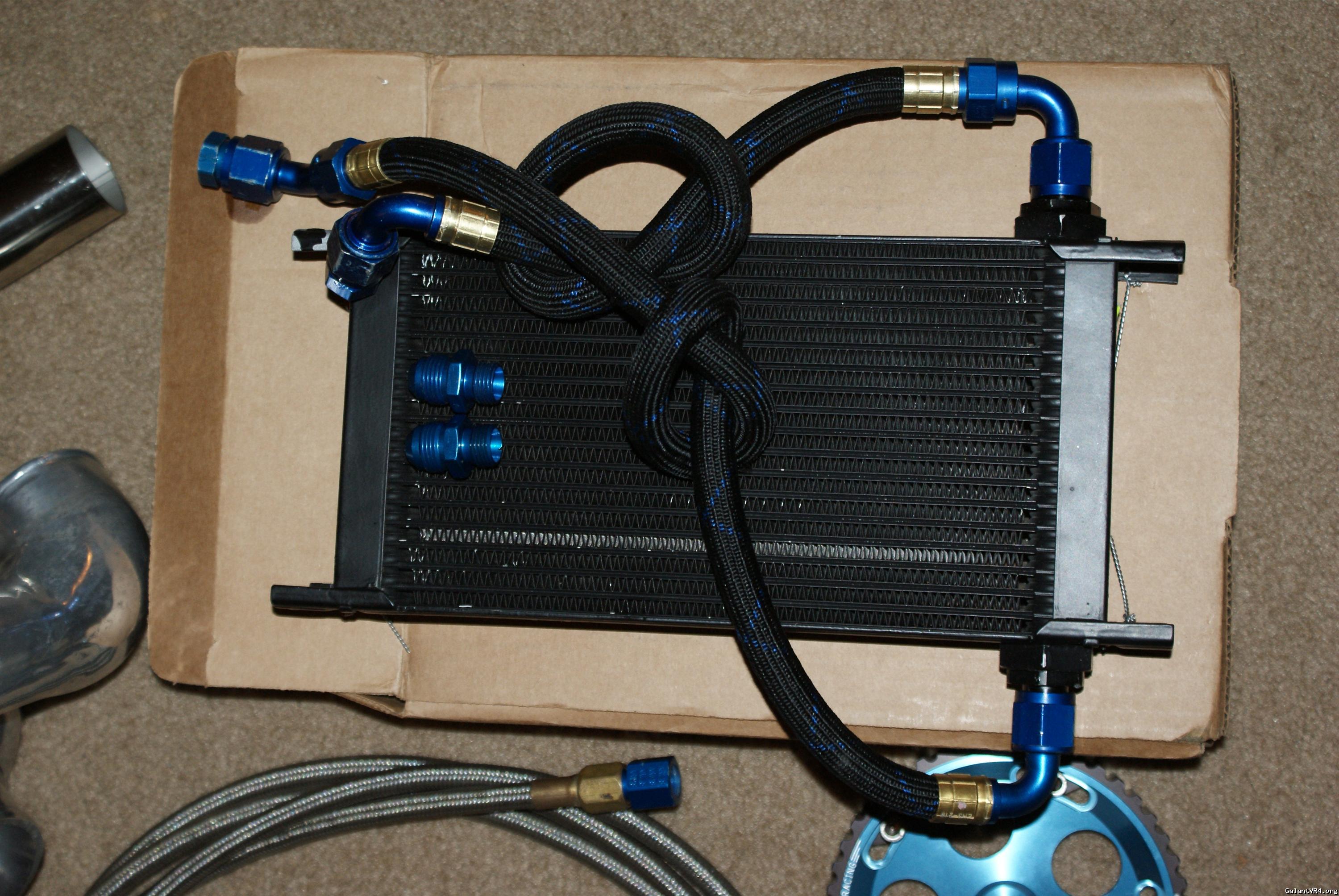

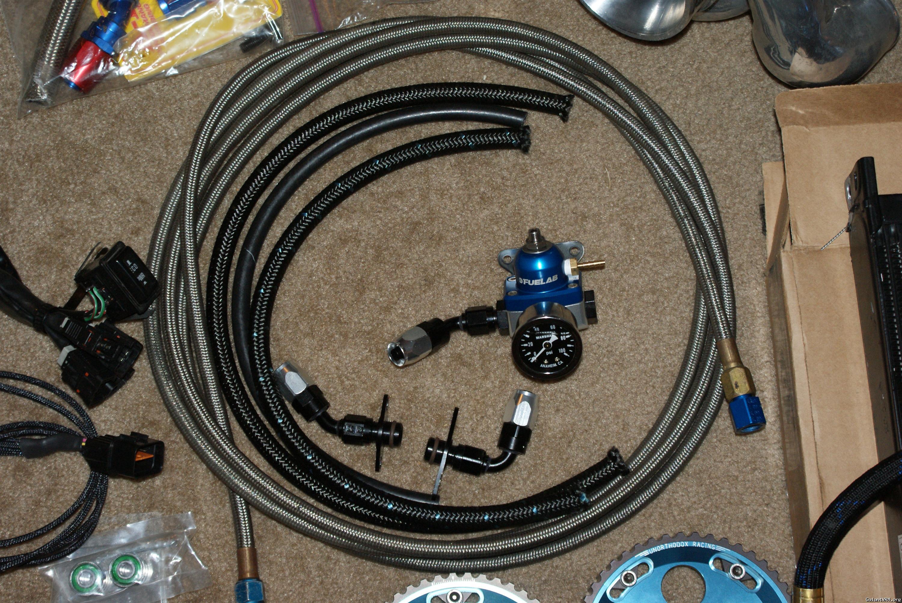

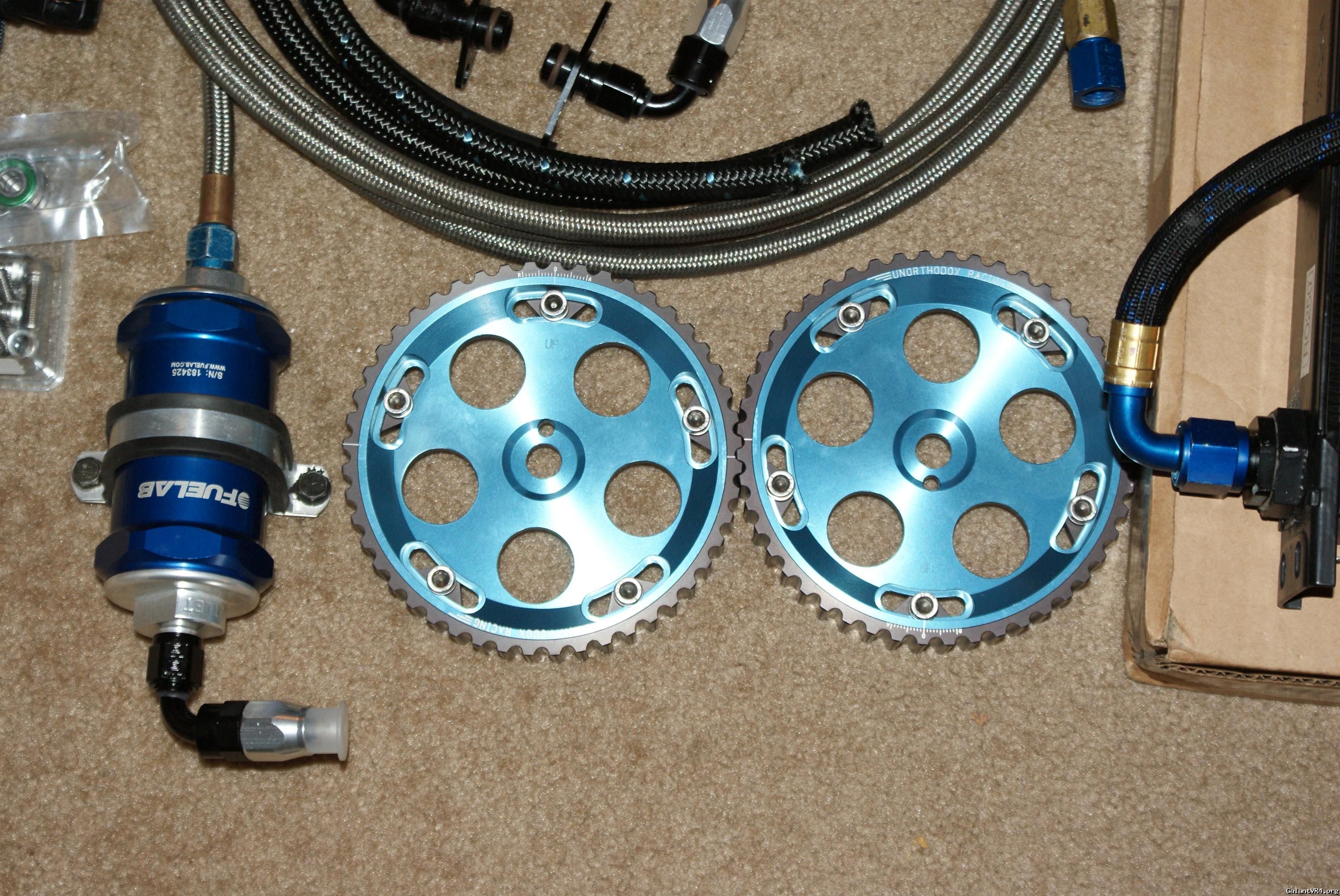

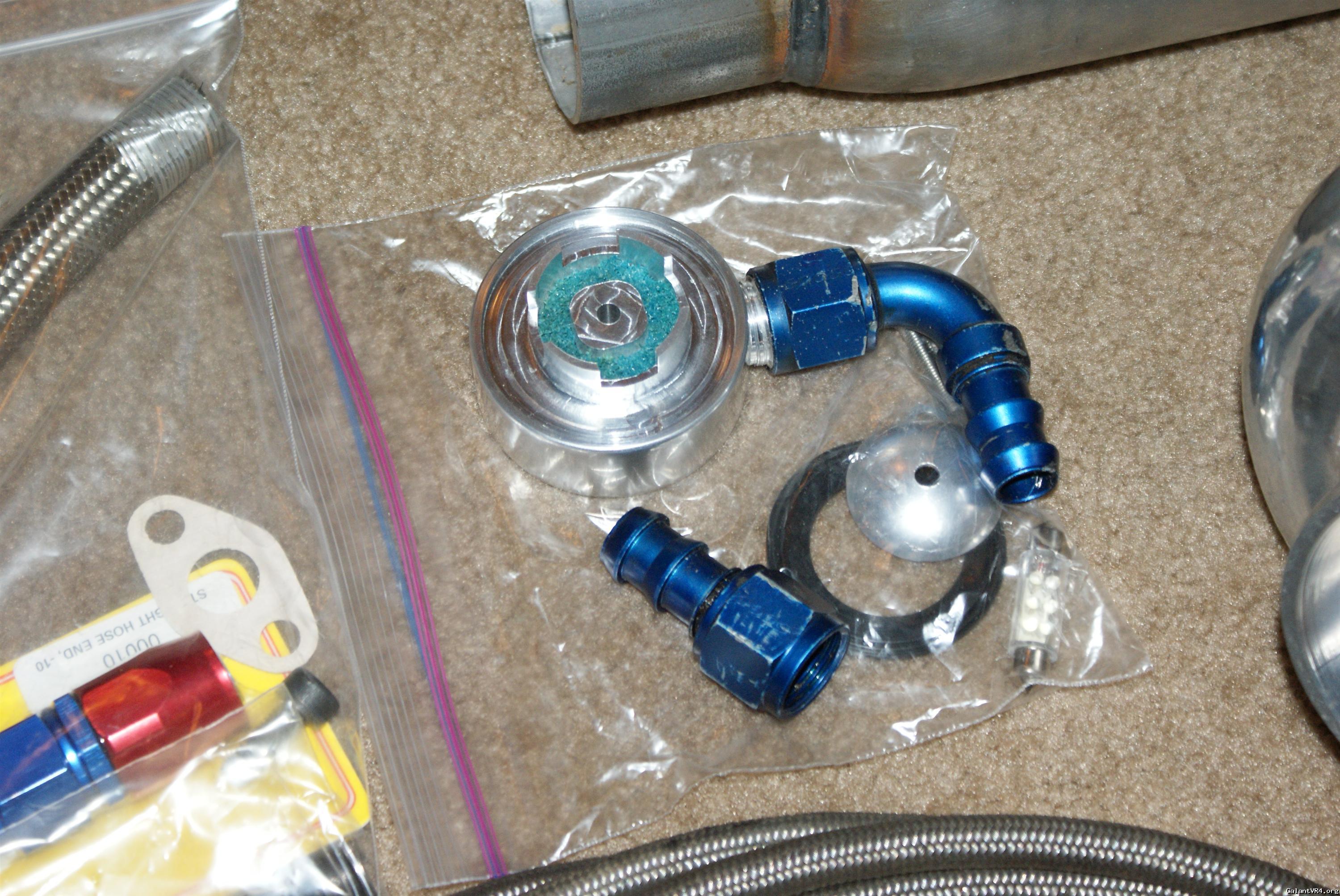

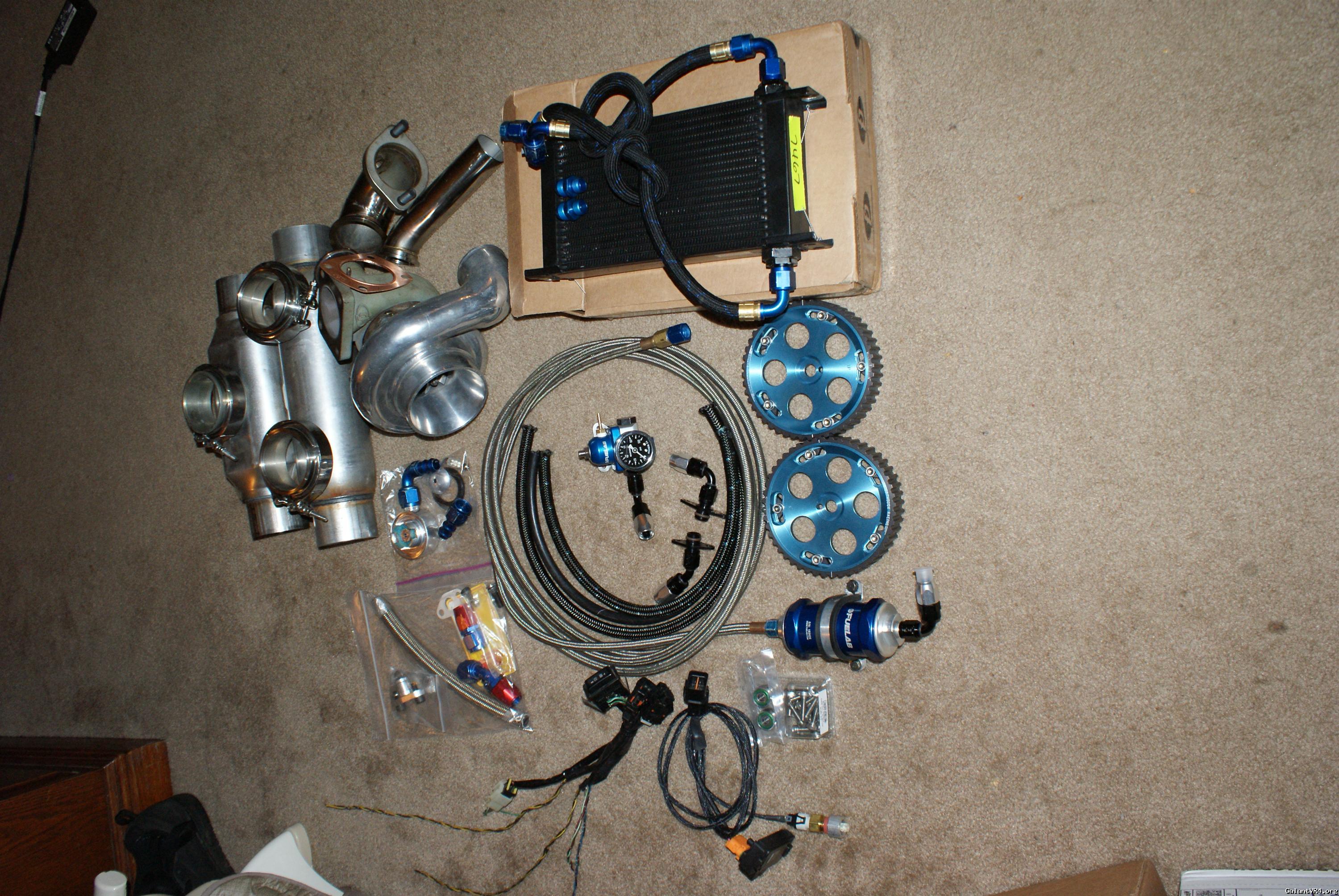

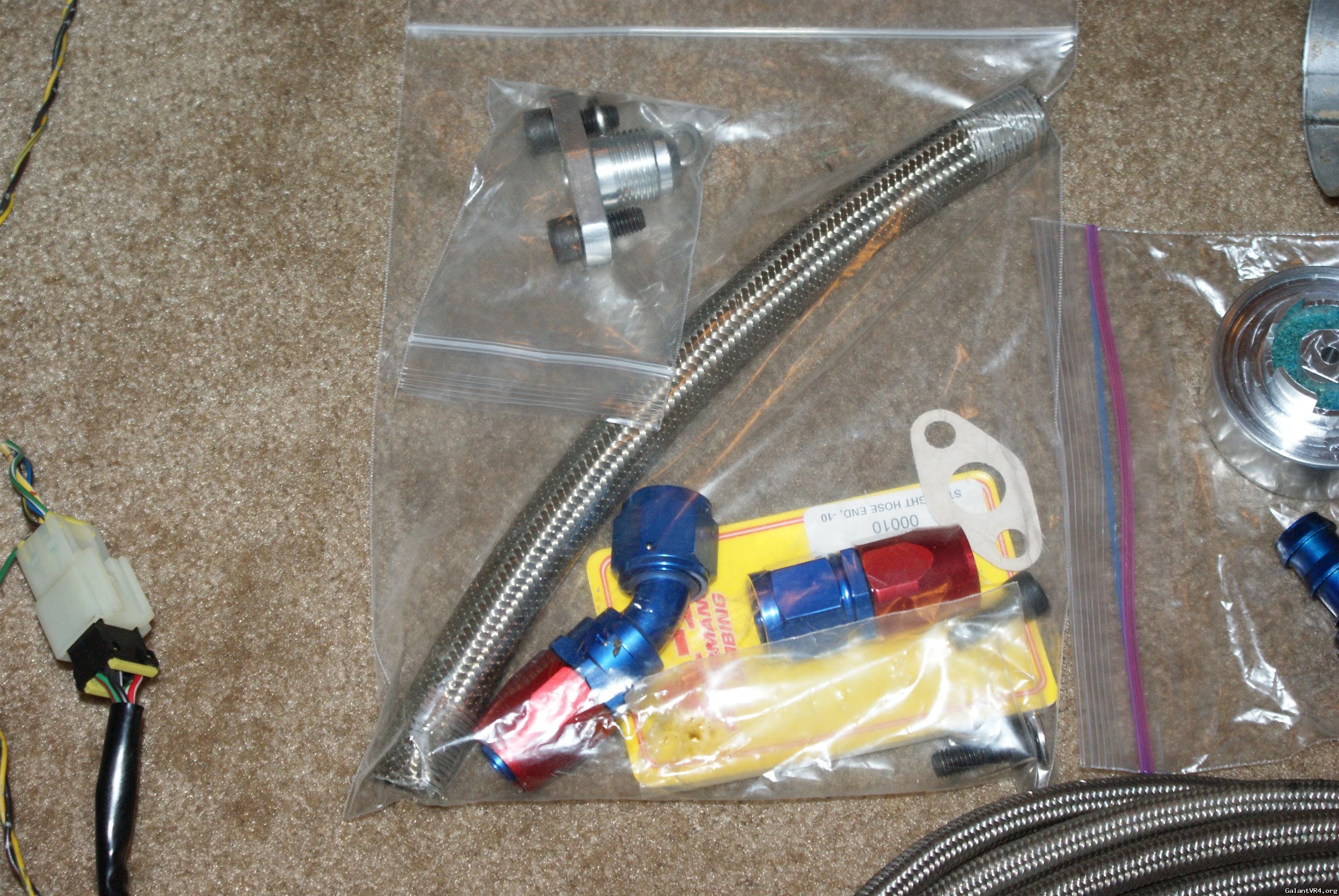

Got some more parts lined up.. it'll all be coming together soon. I just have to get the rear end done before i finish up the engine and everything else. I'll have to have some things "professionally" welded, such as the aluminum IAT bung, and a bung for my EGT on the SS o2 housing. Here are some more photos. Check out the lines that came with my oil cooler... i wish they weren't well over $20 a foot or i'd have done ALL the lines under the hood with them.
-6 AN Fuel delivery/regulator setup
Setrab oil cooler with super lightweight and flexible lines.
-10 AN breather oil cap.. bottom view, with pushlok fitting i've had FOR EVER attached
Oil return line setup.. still need one fitting though.
UR cam gears and fuel filter

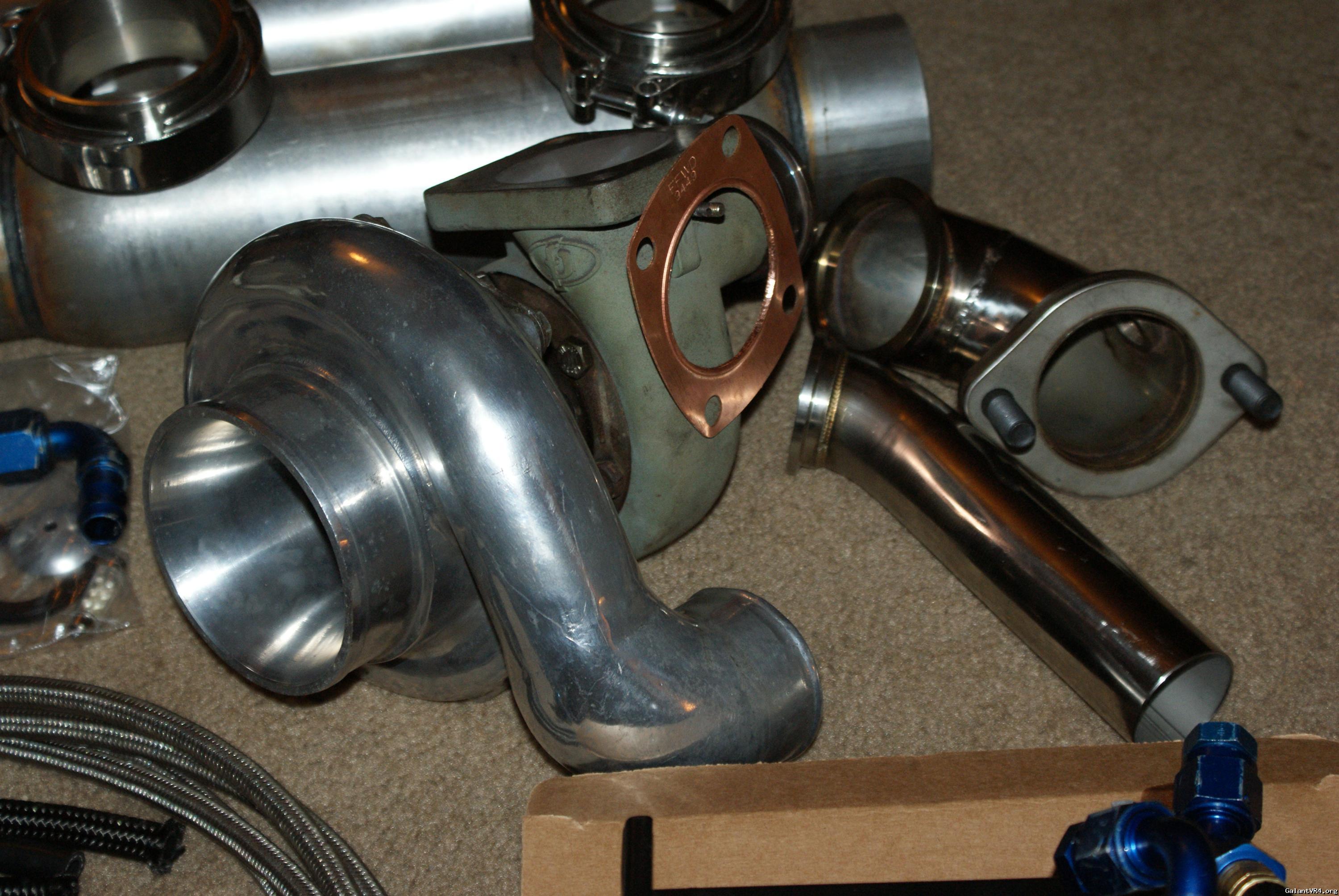

Kitty for emissions test day. "Muffler" for every other day. /ubbthreads/images/graemlins/devil.gif
Semi assembled 3052 turbo... still waiting for the clamp to show up from FP.

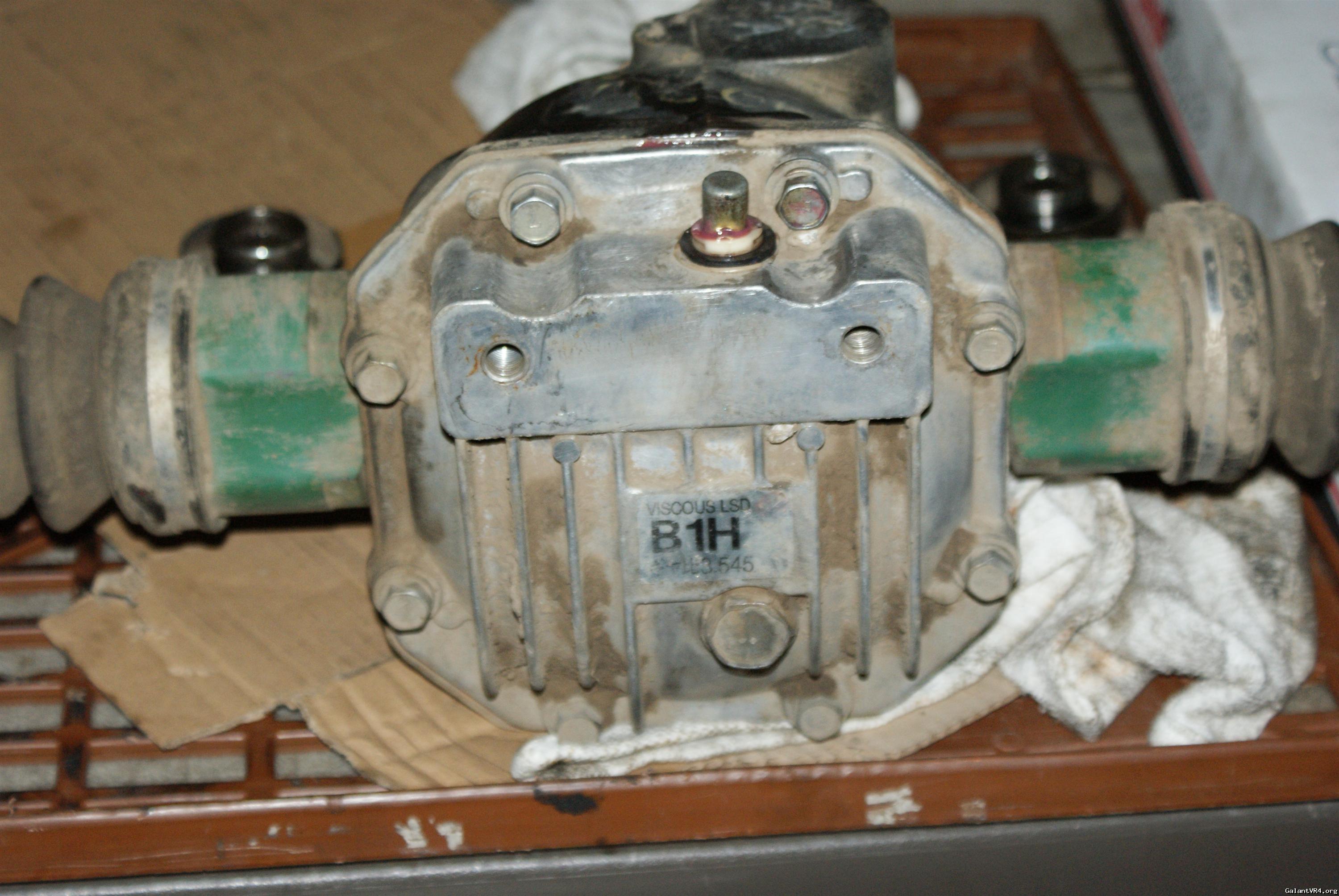

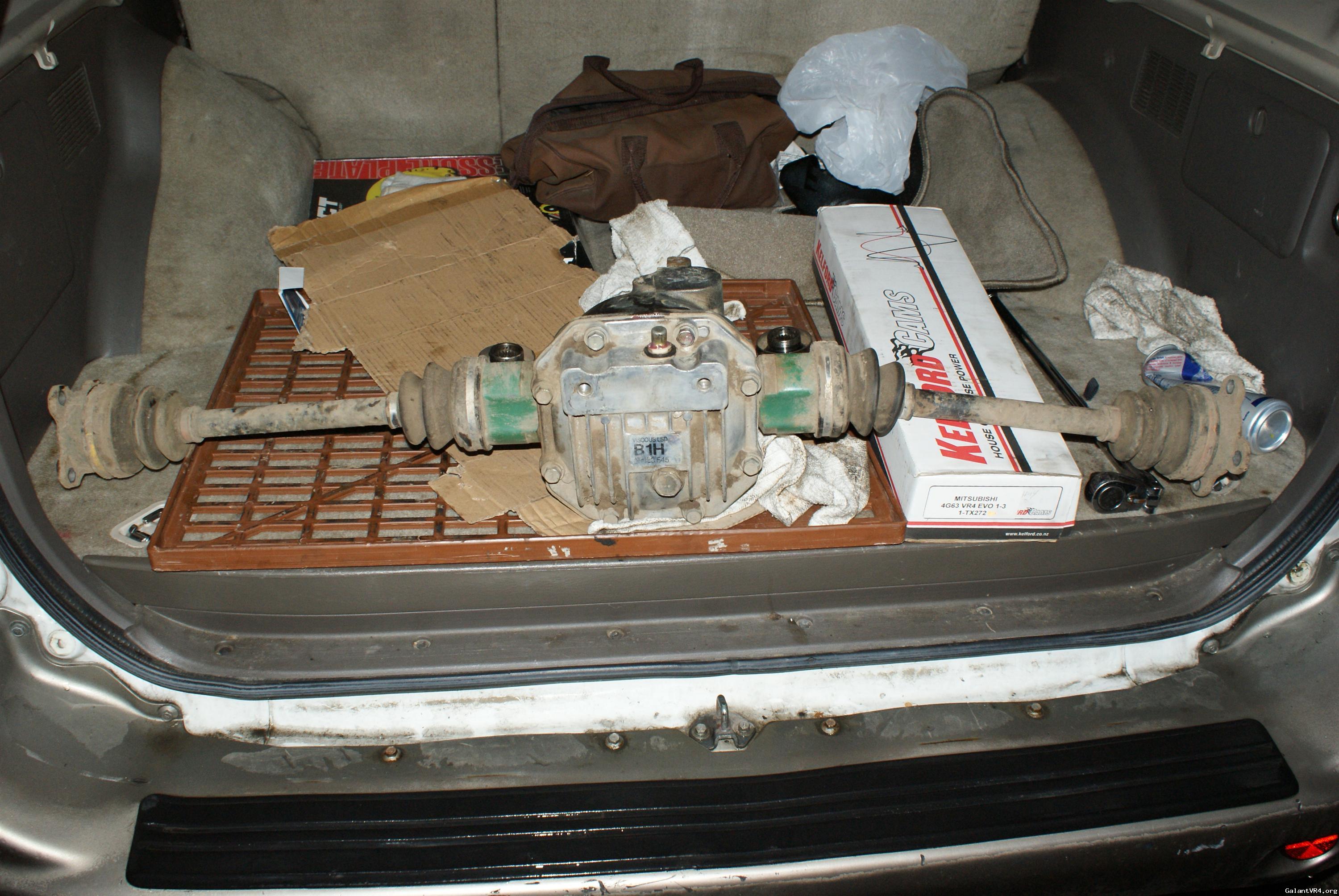

I picked up another 4-Bolt rear end, complete with cups and all fasteners for ~$75 today. I saw it out at Pick-a-Part last weekend, and ran back up to Arlington to pull it this morning. I actually had it out in about 20 minutes with just hand tools! I'm pretty happy that i have a "spare" 4 bolt now. It's not like they're getting any EASIER to find. The nice thing is, it came off a car that appears to have never been modified. /ubbthreads/images/graemlins/grin.gif

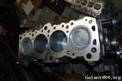

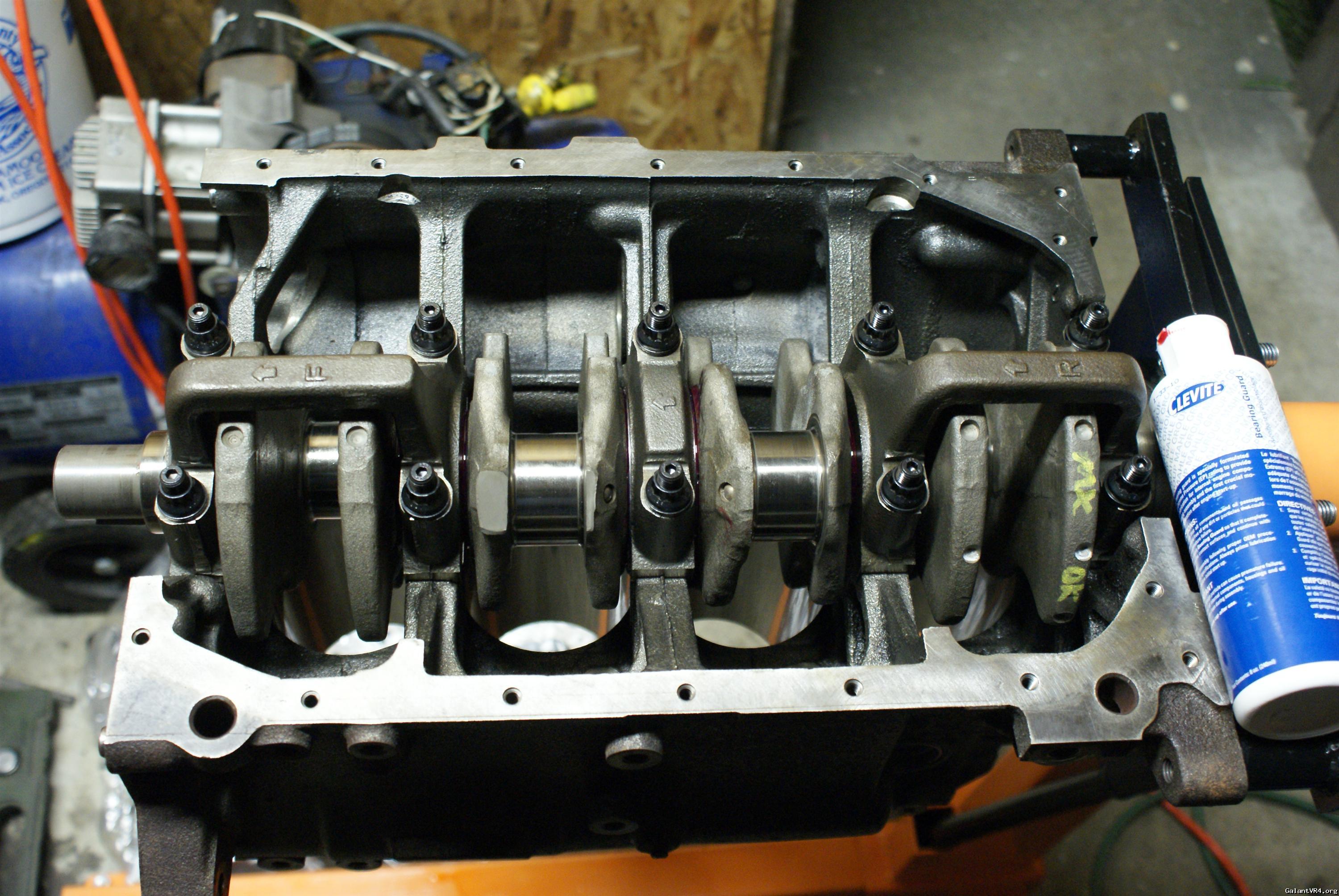

I guess i'll put the oil pan on tonight... FINALLY.

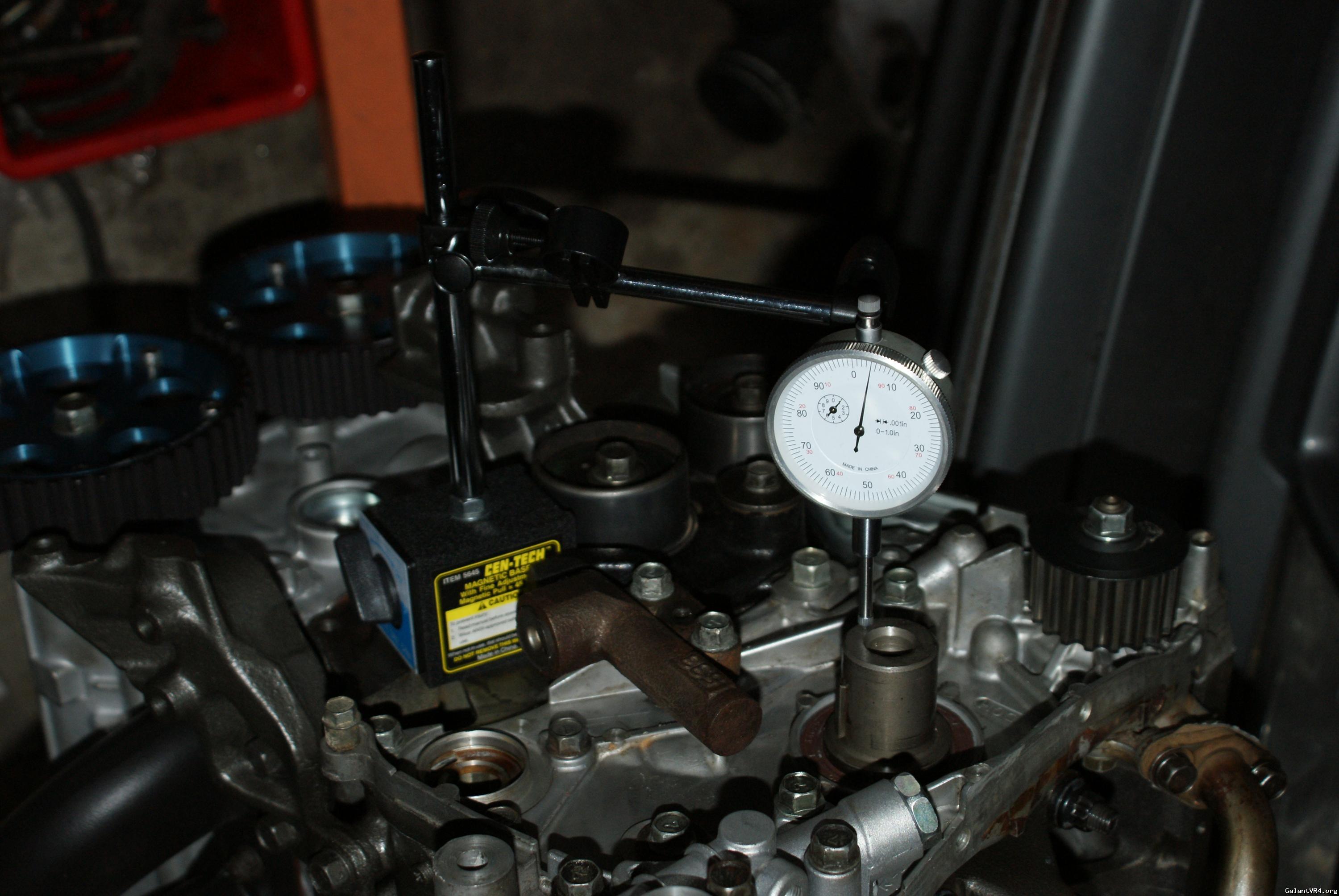

I wanted to triple check the thrust clearance (crank end play) before putting it back together, so i went and got a dial indicator and checked it again. I've been doing it for years with feeler gauges, but it's hard to get at the top of the thrust bearing that way. I wanted to make DAMN sure it was perfect. It's a good thing i did. I popped the bearing cap loose and forced pressure both ways once again before tightening it down. I was barely at .003" before i did this. Now it's right where i wanted it... right at .004". Luckily i didnt have to wet sand a thrust bearing this time around.

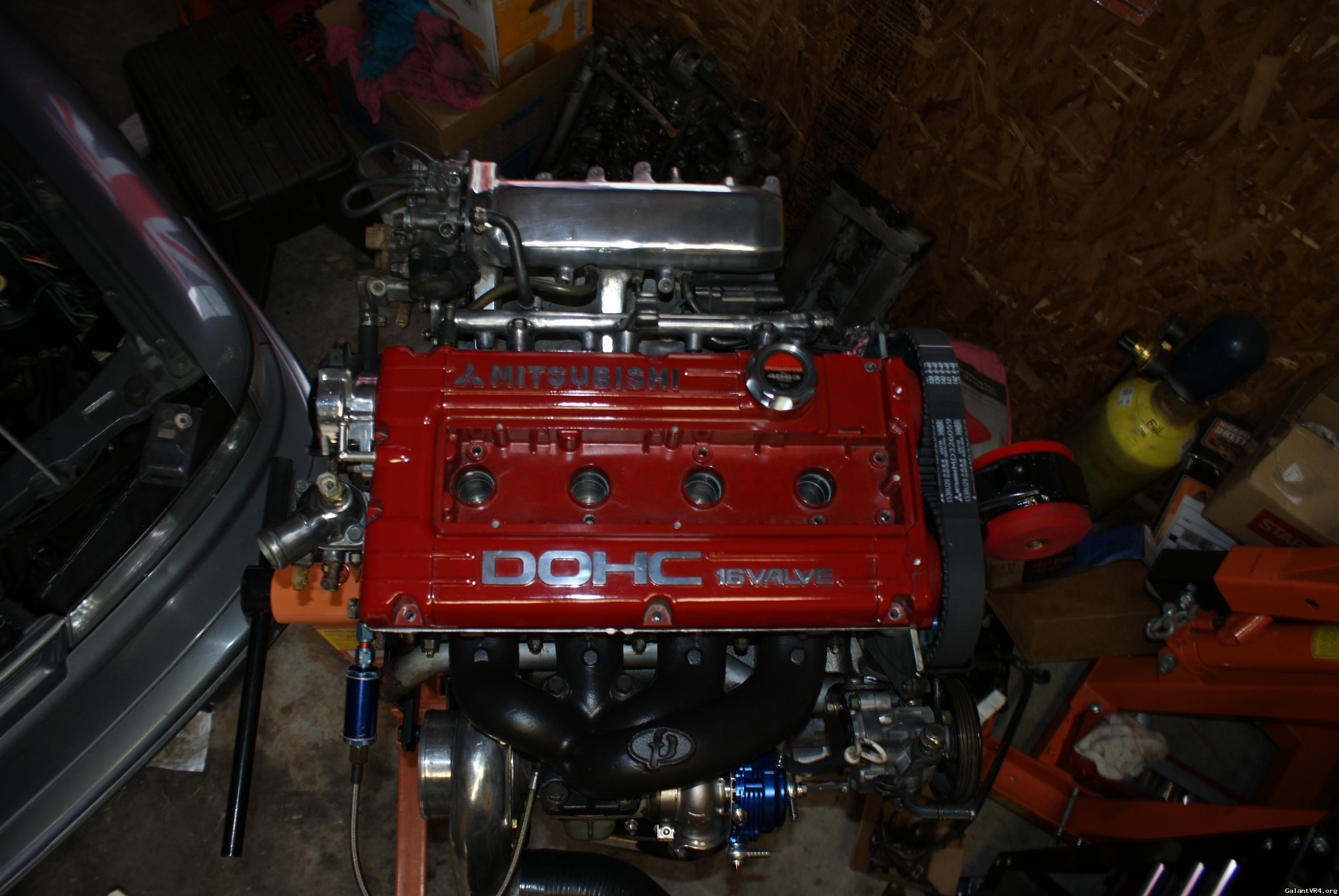

WTF is this chutter?
Anyhoo, i got some more put together yesterday. I polished my intake manifold a bit more. Pointless, i know.. but i like the way it looks.
BTW, that valve cover came new from the dealer less than 2 years ago. PO paid over 3 bills for it! /ubbthreads/images/graemlins/jawdrop.gif
