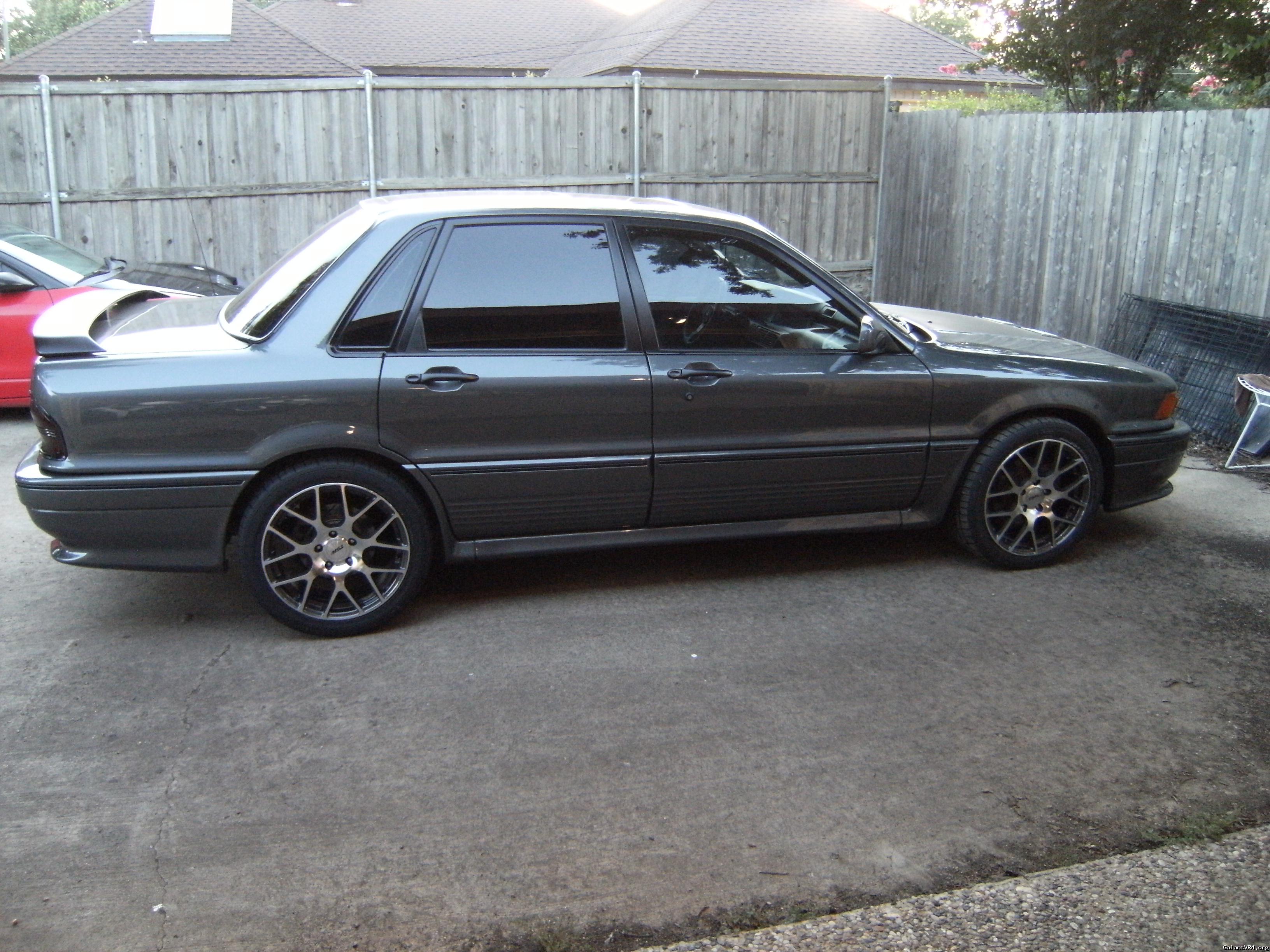

Drove the Galant today, after letting it sit idle for awhile. I had some driveline issues that I wanted to try and sort out before I started driving it again. Got the car back from paint a few months ago and went ahead and got the parts to install new U-Joints, carrier bearings and Torque Solution driveshaft bushings. I also went ahead and swapped in another 4 bolt to see if I could get a whining noise to go away. New rear end, did cause noise to diminish slightly, but I think the poly rear subframe and mustache brace bushings are just transferring a lot of driveline noise into the car. Getting a slight clunk noise when I turn to the right while driving. I have the Jay Racing passive steering elimination kit, so it's possible it's just the Heim joints making noise. Everything looked, good to go and tight while I was under the car, so I'm inclined to drive it till something falls off. Ahh well.
Took it to a buddies house to watch a movie and eat pizza today. he snapped a few pics of it in the driveway, so I figured I'd post up. Felt good to drive the car again, after so long. Now I get to add more stuff I have stashed away for it. Heh, heh.... /ubbthreads/images/graemlins/devil.gif

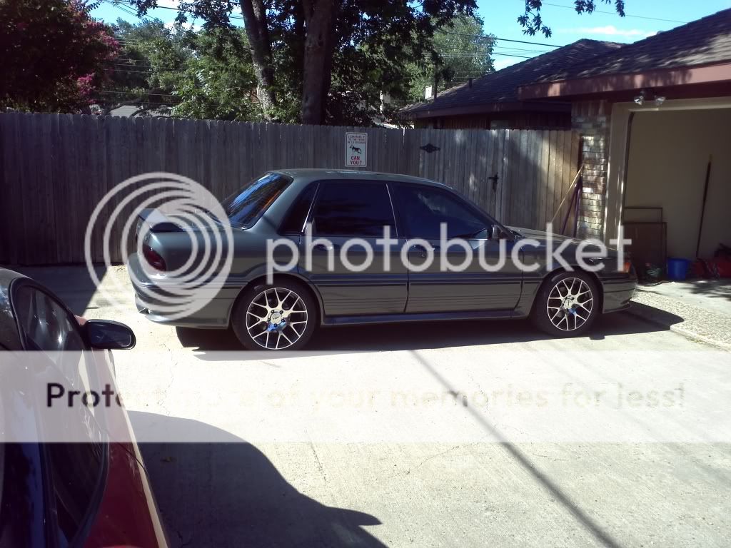

TSW Nurburgrings 17X8, +35, 245/40/17 Sumitomo Tires- Swapped over to these wheels from the SSR Competitions /ubbthreads/images/graemlins/bawling.gif for the future 3KGT VR-4 Brake install.

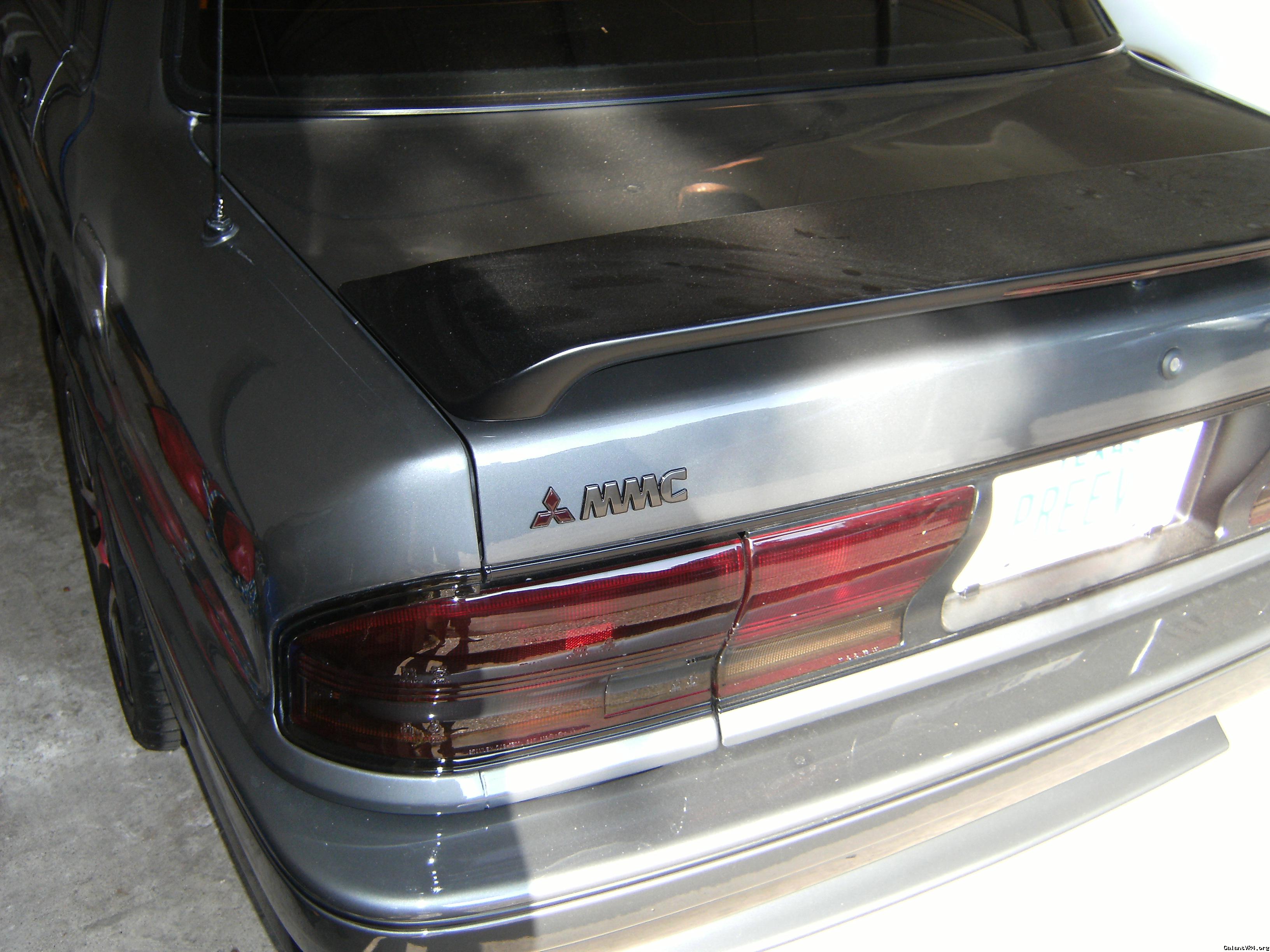

Smoked MMC/Mitsu Diamond Badge and Factory New VR-4 Badge- Still haven't gotten around to getting the exhaust tip fixed. /ubbthreads/images/graemlins/banghead.gif
I like the TSW's, but think I might have made a mistake in not getting the Matte Grey wheels instead of the polished machine face. I'm really going to miss the SSR's on the car though. I did notice that the front wheels stick out a bit past the fender. I should be able to dial in some camber to try and bring the tops in a bit. I'm still trying to decide what ride height I want for the car. The way it sits, I haven't rubbed once since installing the new wheels and tires. I think it'd look better just a hair lower.

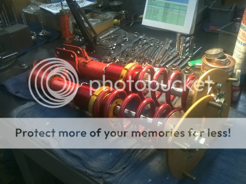

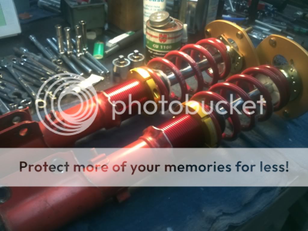

Been awhile since I updated this, but have made a few new changes to the car. First I went ahead and ditched my old AGX/H&R Combo, in favor of a set of GVR-4 Ground Controls with Koni Yellow fronts. I kept the rear AGX's as there wasn't anything wrong with them. The fronts as expected were completely blown. Removed the guts from the AGX's and installed the Koni inserts along with the Ground Control setup. Took the struts home and painted the front housings red, reassembled and installed on the car.

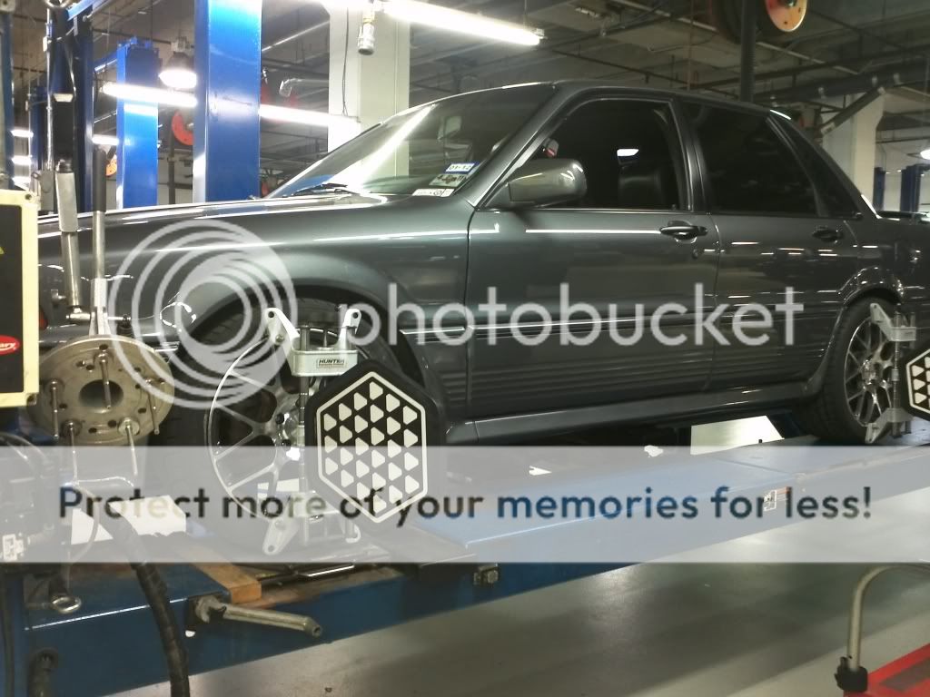

Got a buddy who works at a Mercedes dealership, so I was able to get it on the alignment rack immediately afterwards to get everything setup and aligned.

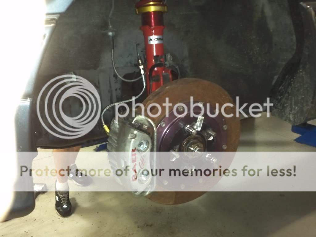

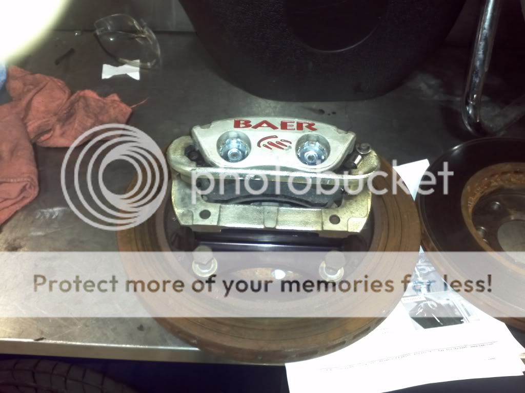

I was originally going to go with a 3KGT VR-4 brake setup. but happened upon this Baer 13in Track Kit from a 1G Talon that a local was parting out. Decided to go with these instead, so I could keep my SSR Competitions. The TSW Nurburgrings I bought to clear the 3KGT calipers are rather nice, but I just didn't care for how they looked on the GVR-4. They'll probably look better on the 97 Spyder I just picked up as a daily driver. /ubbthreads/images/graemlins/grin.gif

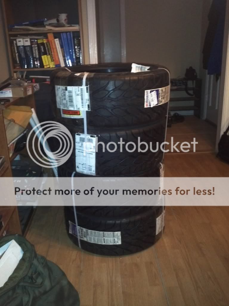

Since I was keeping the SSR's I figured they could use some new rubber, so some BF Goodrich T/A KDW'
s in 235/40/17 were ordered.

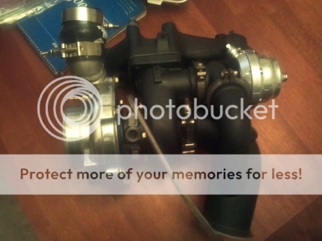

Finally installed a FP3052 that I've had lying around from my old Talon AWD, and after a few days driving it found out that the alternator really didn't like a cast FP O2 housing right next to it without a heatshield, so I went ahead and pulled everything to have it all ceramic coated.
