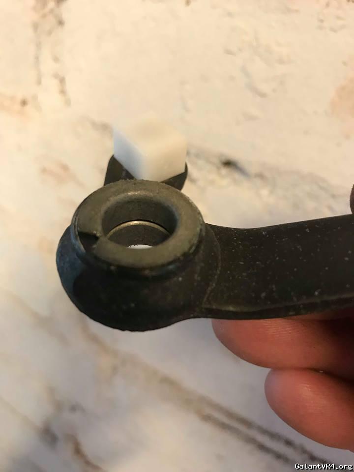

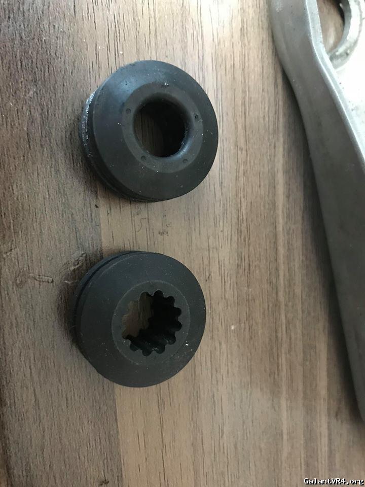

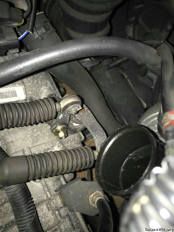

Update on shifter assembly rebuild. Made a massive improvement. No play at all. Replaced the pcs on the transmission too. Although the stock ones looked ok. Easy job though.
Base bushings wore out.

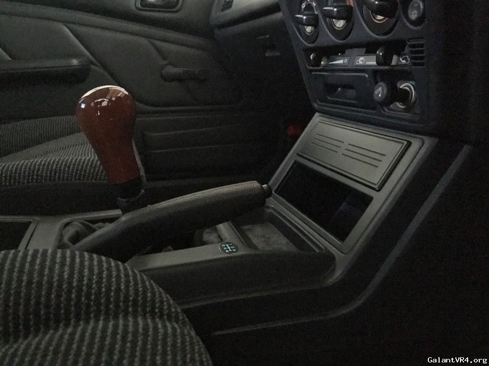

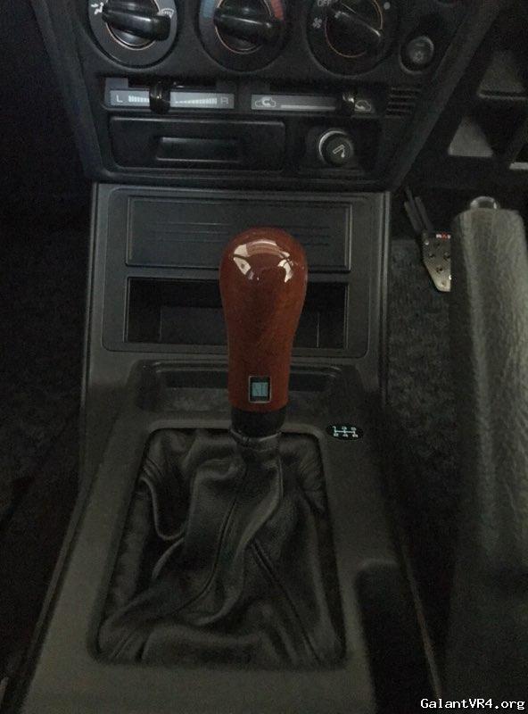

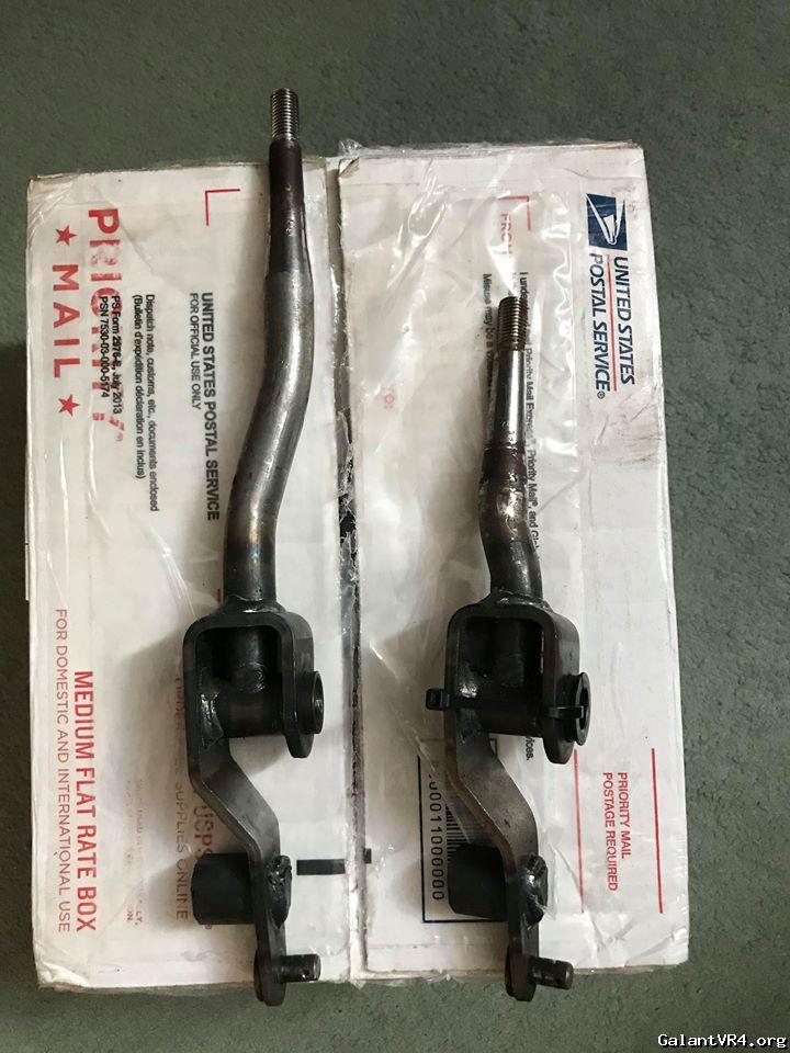

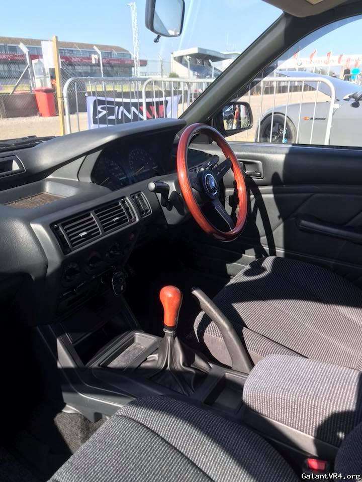

Got some new Nardi parts in. Steering wheel, VR6Eater shift boot and Shift knob. The shift knob sit to high with the stock shifter arm. I have a 1G unit coming. Should sit a lot lower.
Took the VR4 to another show. Japfest in UK. Had a great time.

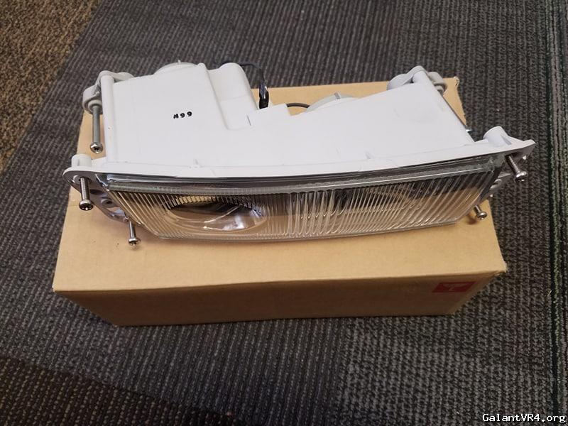

Still collecting parts for 504/2000 repaint. Waiting long time for this box.
bobdole
Aug 23, 2007
899
U.K.
</font><blockquote><font class="small">Quoting pot:</font><hr />
The suspense is killing me. Pray tell what’s in that box?

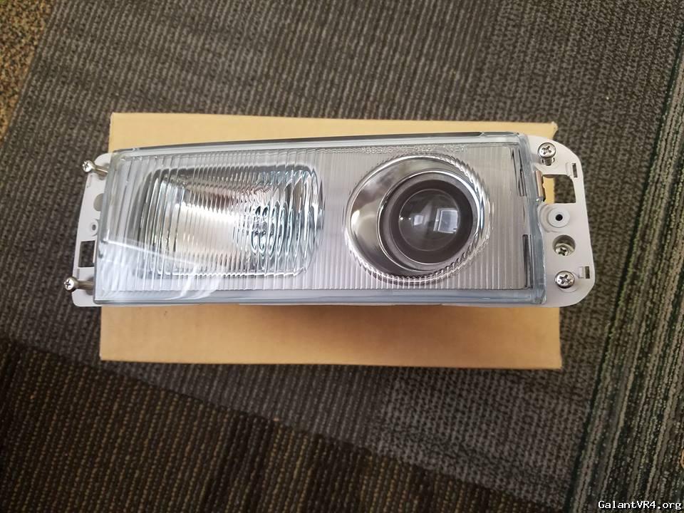

New fogs. 504/2000 is ready for repaint now.

Ok installed the 1G shifter today. Great improvement. No stretching of the shift boot. Great mod.
Did these same replacements on my F5M33 transmission mated in the Colt, and it does make a huge difference in taking up all those little bits of play. They really do add up across the whole system.
However, a Mitsu trans only really shifts well once the shafts and fluid are all properly warmed up. Nice to see the attention to detail there!
