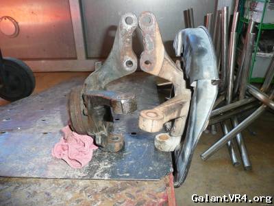

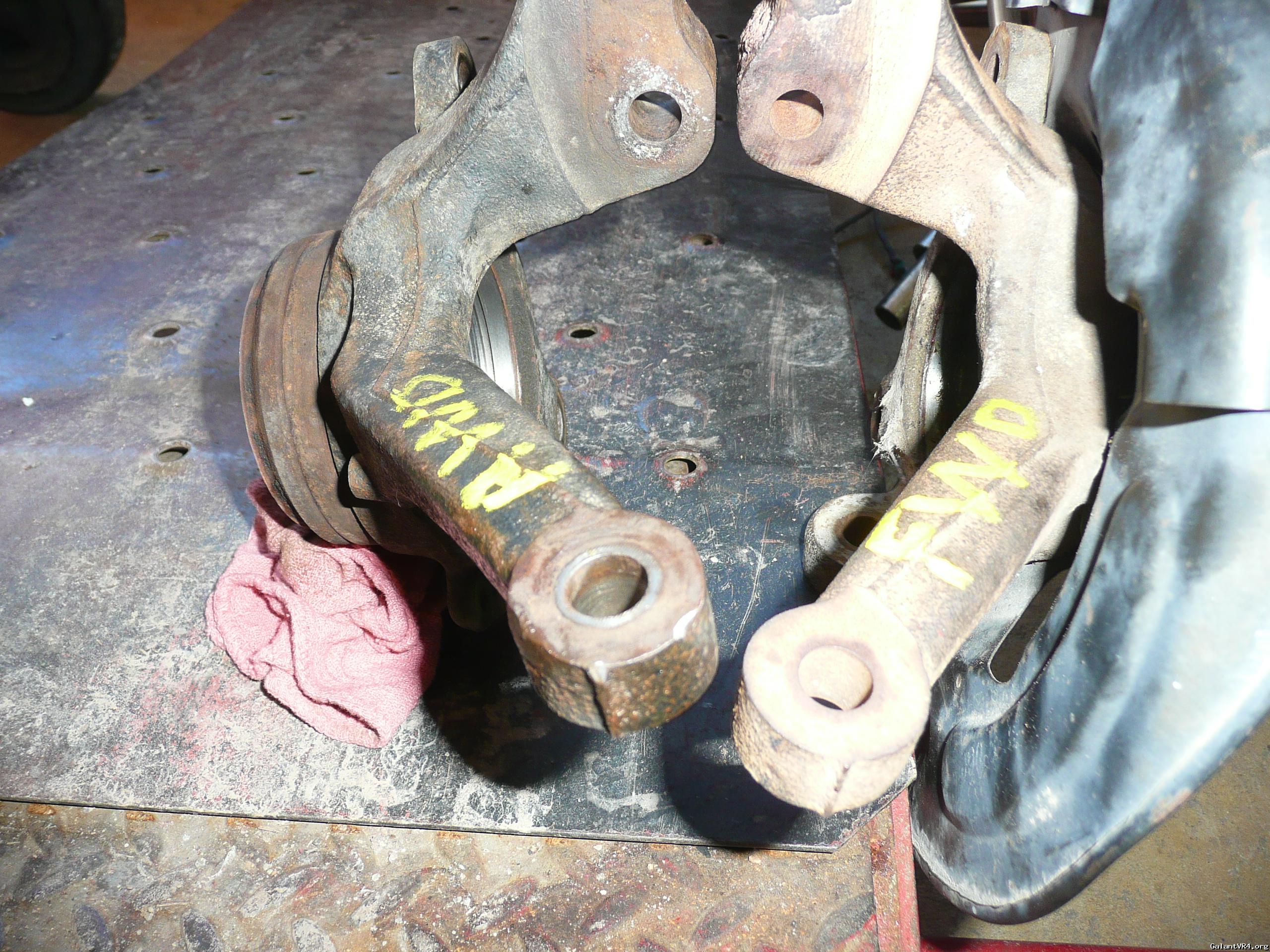

I posted pics some time ago showing the knuckle difference. I can't remember where, and don't find them in a few of the posts in the information archive section. If I find them, I will give a link. Or someone else better at searching can do it. /ubbthreads/images/graemlins/grin.gif

Different pics, but well, you get the picture. /ubbthreads/images/graemlins/smile.gif
