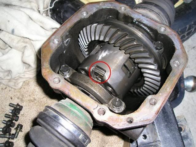

cons = 3-bolt mech lsd has no drivegear for the 4ws pump. 3-bolt viscous lsd does, but is inferior.

If you want to use a mech lsd it doesn't matter, whether you use a 3-bolt mech lsd, a 4-bolt mech lsd, or an evo lsd in the vr4 pumpkin, none of them have room for the gear to drive the 4ws pump.
This is a 3-bolt mech lsd from an early JDM vr4 RS

do any of the USDM GVR-4s have rear LSDs in them? most JDM ones do, but they're viscous LSDs. As Nikk said above, you can't have a plate/clutch type LSD with 4WS, so if you want a plate/clutch type LSD you'll have to lose the 4WS.
