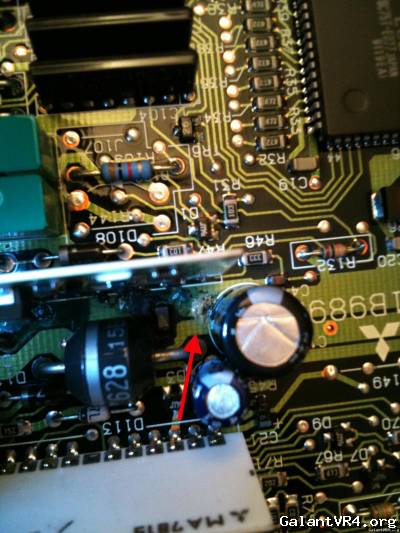

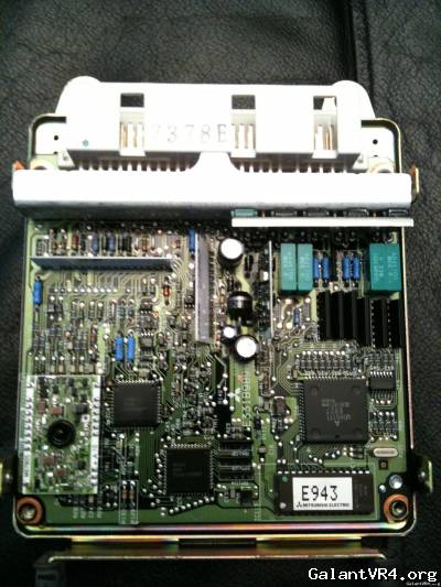

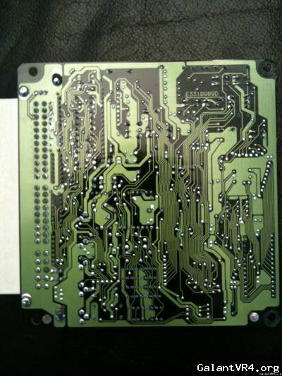

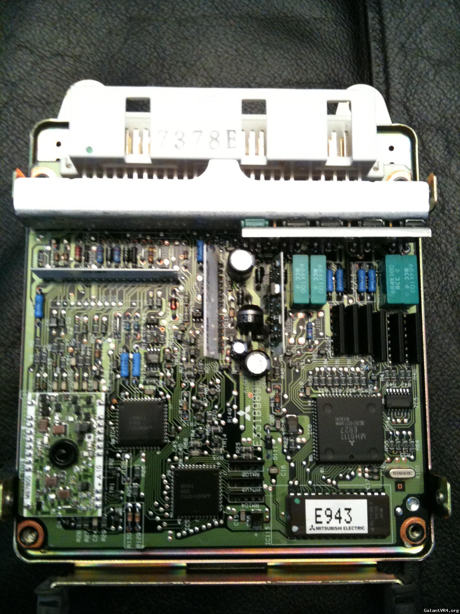

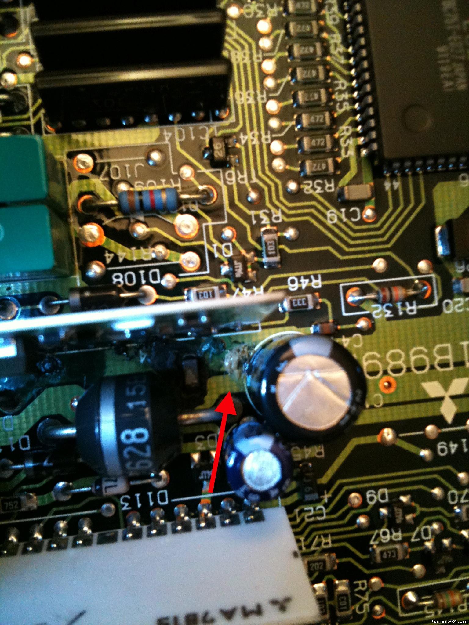

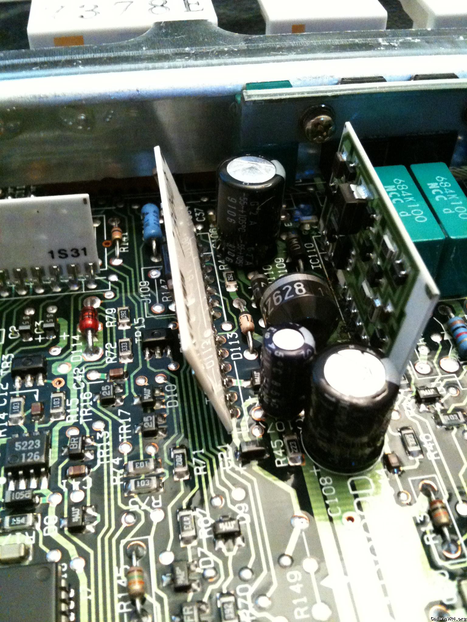

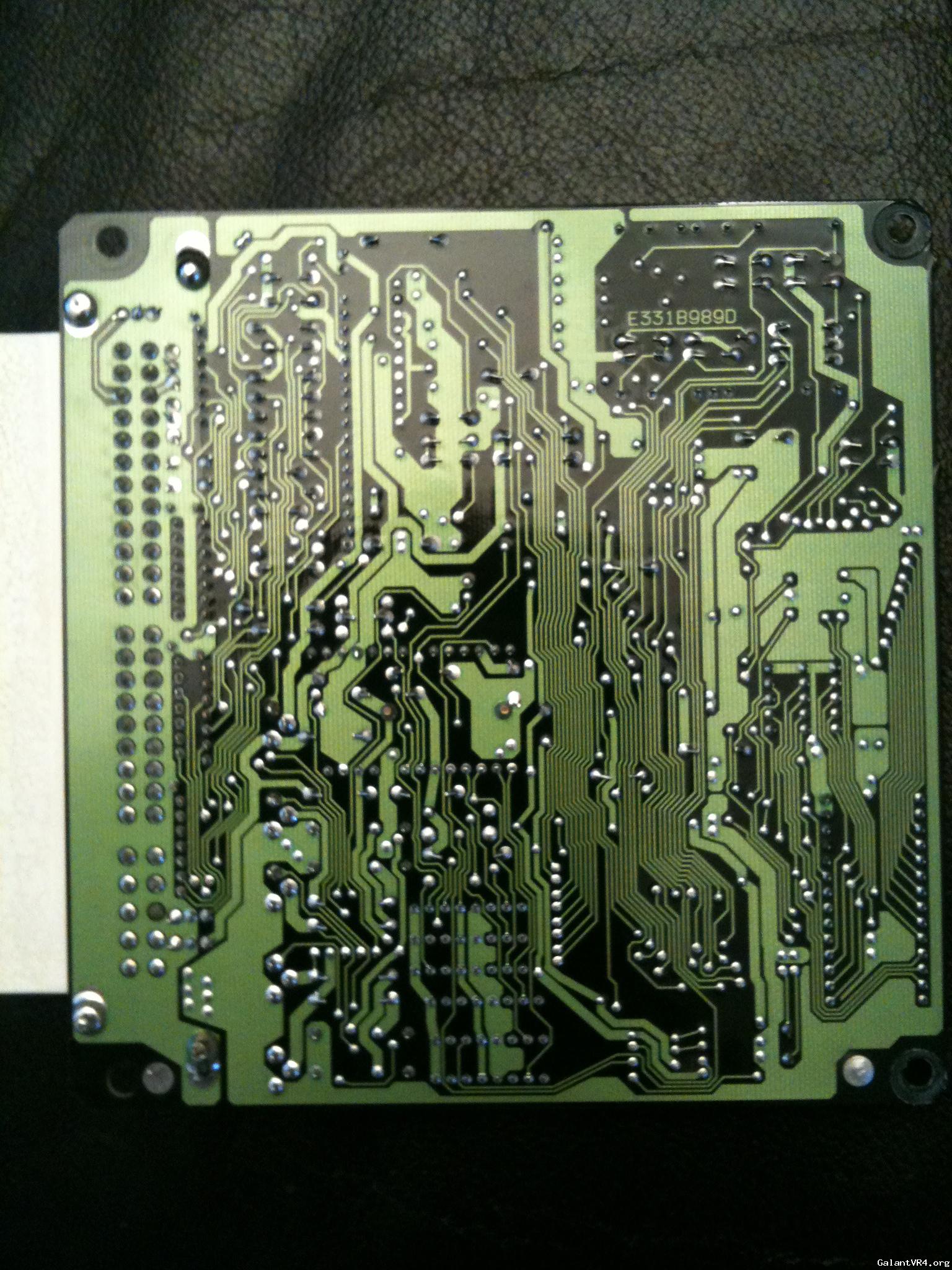

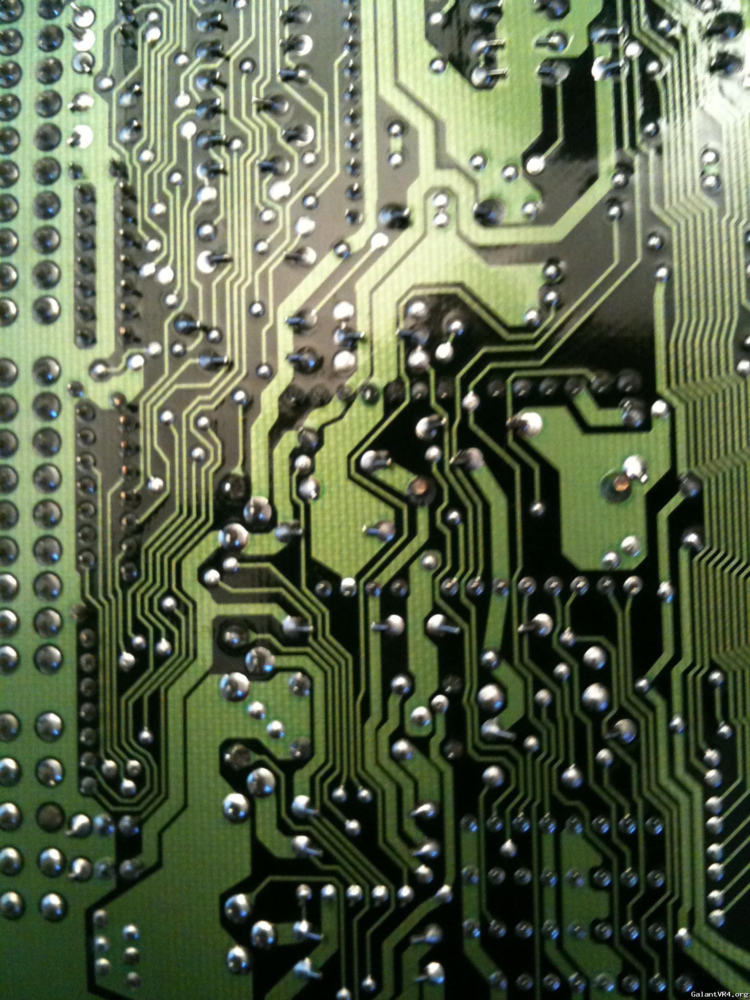

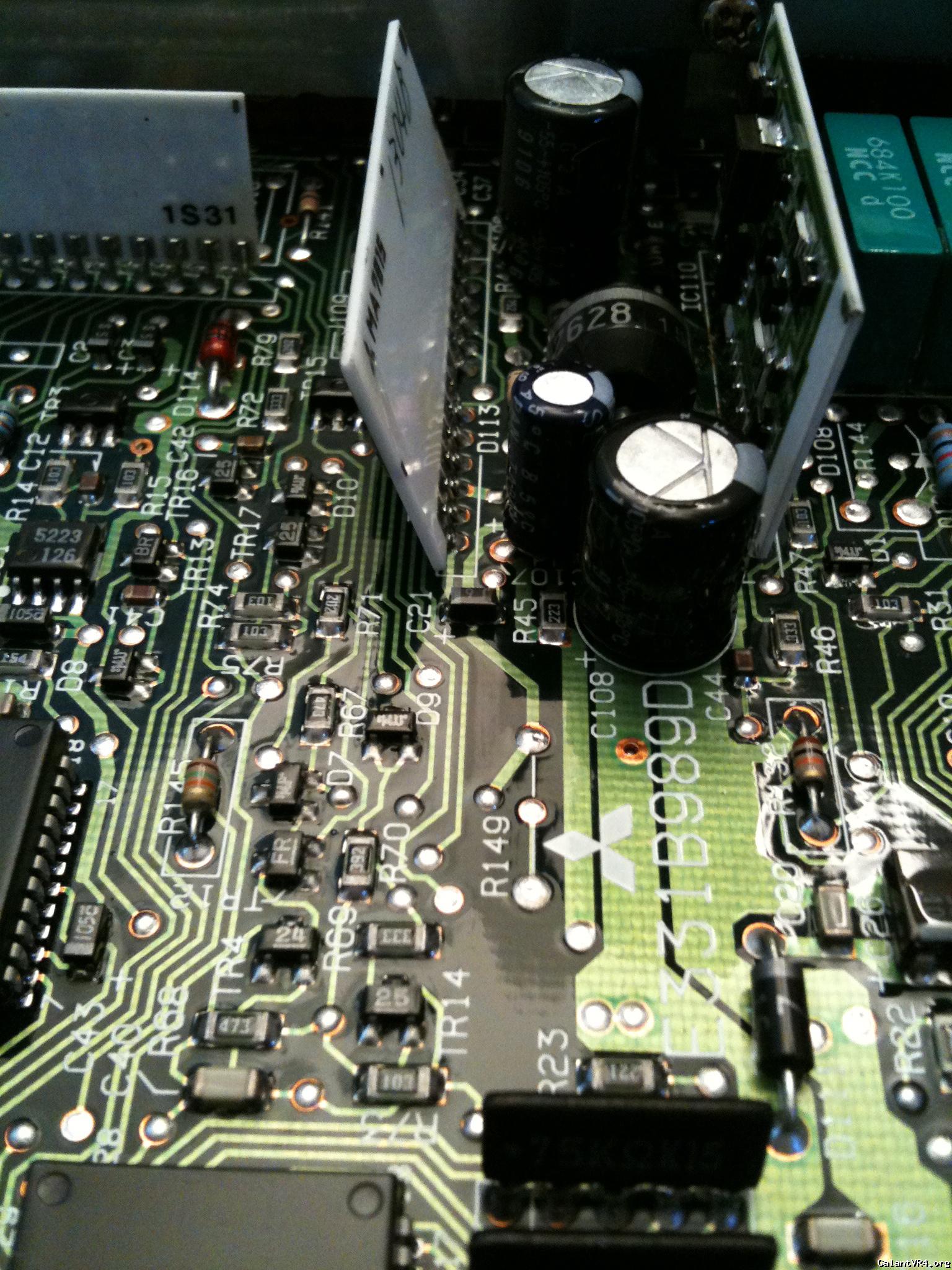

Pulled ECU...not 100% on what I'm looking for...but here's what I found:
(Click for fullsize)
The last picture shows the only thing that caught my eye (and I almost overlooked it, as the rest of the ECU looks so clean), next to one of the larger caps, it looks like a small area of brownish-tan something...I don't know if that's the sign of a leaking cap, and if so - what are my next steps?
Terry Posten
Dec 16, 2003
9,009
Davenport, Iowa USA
Yeah, that is most likely your problem. The brownish goo above that cap you pointed to is acid and is eating the copper traces and lifting the surface mount parts right off the board. And when that happens, it starts blowing up chips.
I do not repair ECUs anymore but ECMTuning does (only replace caps on working units). click I would bet that it is going to cost you about $150 to have that repaired.
The only other option is to buy a used one.
BUT make sure it is a working unit that has had the caps replaced already. Expect to pay anywhere from $200-$300 for a guaranteed working Eprom unit

Thanks Terry. Just put in a KGC and it fired right up. Although I'm not sure if this one has had it's caps replaced either...I may try to clean it up and do them myself.
I already have an evo 8 unit and knock sensor, but don't plan on doing that until next spring/summer when I have some time to tackle it and sort out the tuning.
I remember seeing that when I joined up and thinking to myself "sh*t, I need to have that done ASAP"...but then I just never got around to it.
