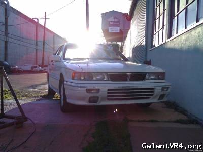

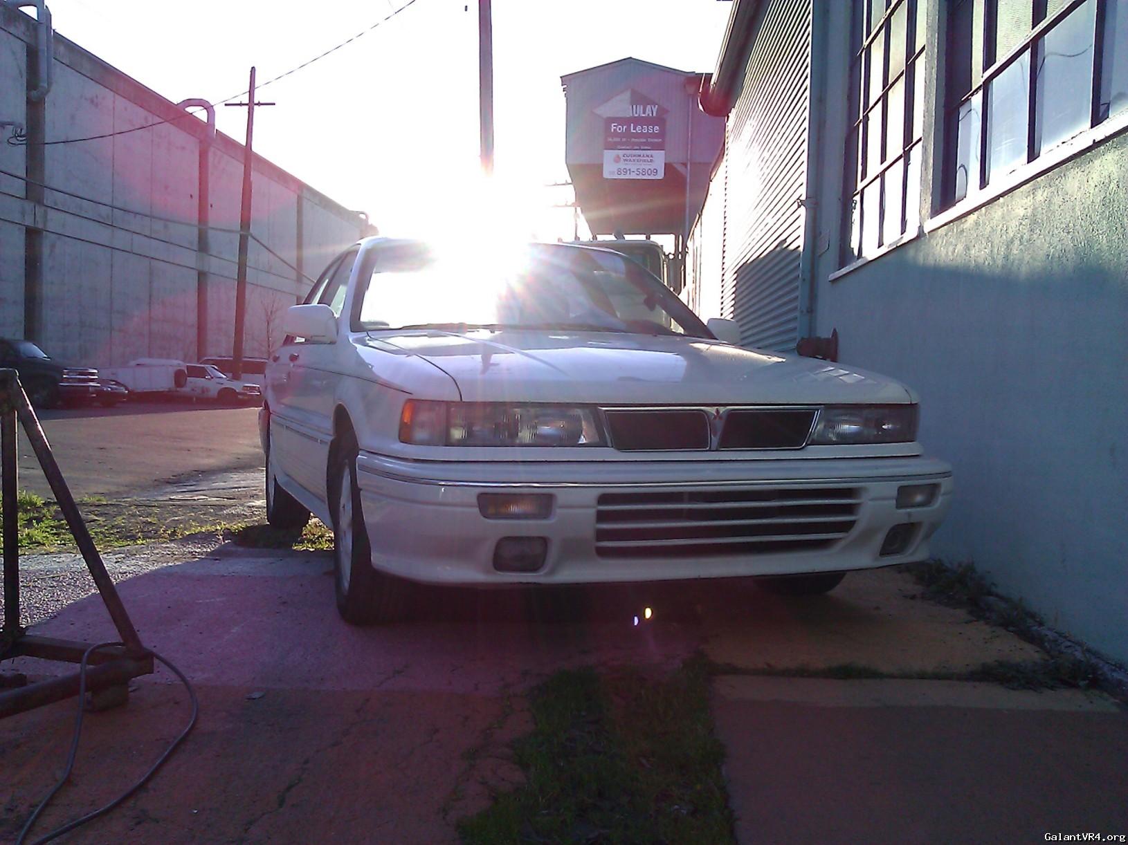

Just keeping this updated for the record;
Runs and drives GREAT! the rear carrier bushing or bearing is causing a slight vibration on deceleration.
Also had a scare with the front brakes, brand new Smoking. Someone overfilled the brake fluid resovoir /ubbthreads/images/graemlins/banghead.gif
Easy fix, Motor has no noise aside from some from the injectors! Sounds and runs great even the sunroof works one out of three times!
With the open air filter, bcs plug removed, and some mods to the MAF, she hauls butt!
The maf restrictor screw i unscrewed all the way im sure this leans it out a touch, but i think its also causing my low/rough idle issue.
Now time for some regirstration and ill have a fun lil beater car /ubbthreads/images/graemlins/applause.gif
sunroof works 100% as of today and some lithium grease /ubbthreads/images/graemlins/grin.gif
transmission is still a rebuilt warrantied, giant piece of crap.
