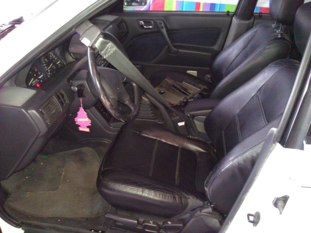

Bad; rear seats torn need upholstery, headliner is in poor shape, sunroof wont open all the way but vents and closes properly. glovebox latch is broken so i have the entire right side underdash removed. the paint is a bit faded could use a buff and wax, underhood is really dirty, and the front brakes are pretty poor shape.
