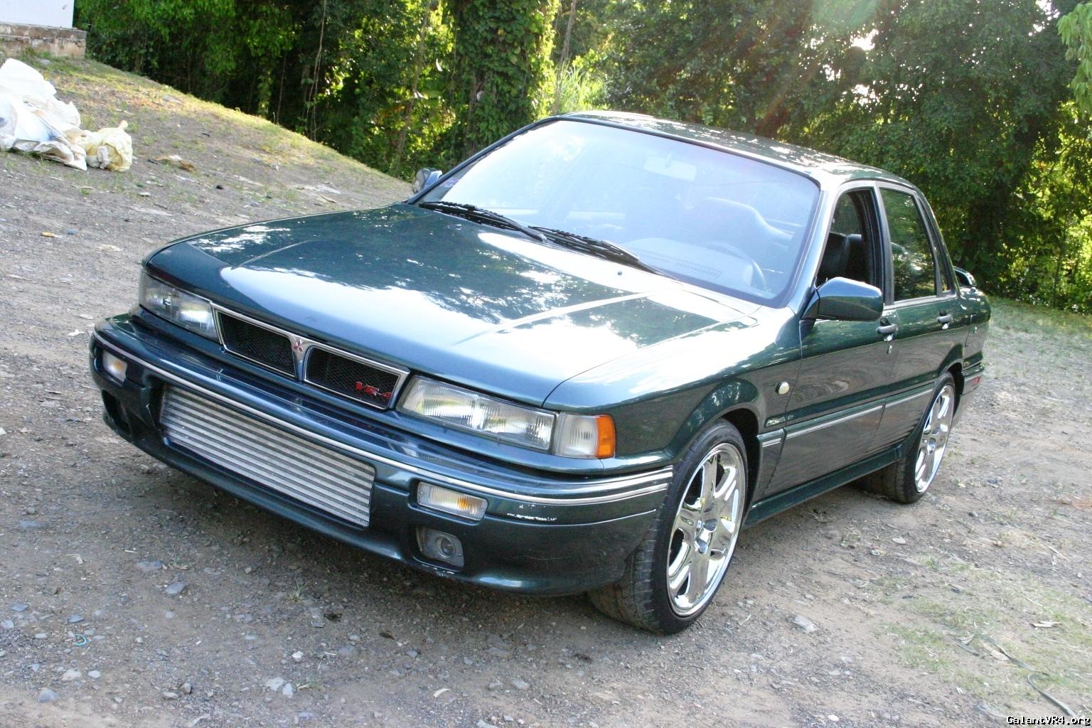

Will they fit? Obviously 5-lug is necessary, but I have that.
broxma Well-known member Joined Nov 16, 2009 Messages 911 Location San Antonio Tx Jun 12, 2010 #2 Yes. /brox
Barnes Well-known member Joined Feb 9, 2003 Messages 6,249 Location Richland, WA Jun 12, 2010 #3 Dont' forget 3000gt SL wheels as well. They aren't as big and bling as the 3000gt VR-4 rims, but they are nice for the price.
Boostdtalon Well-known member Joined Oct 15, 2009 Messages 913 Location Buckley, Wa. Jun 12, 2010 #4 What are the size of the SL rims? I saw some in a junkyard not too long ago on a ford probe.
turbofonz Well-known member Joined Sep 27, 2006 Messages 475 Location Granby, MA Jun 13, 2010 #5 16x8 with a 46mm offset, IIRC. I had some on my 1g for a little bit, and with 225/55 tires I had to grind the rear subframe's pinch weld down for them to clear.
KenGVR4 Well-known member Joined May 13, 2001 Messages 278 Location Seattle, WA Jun 16, 2010 #6 The big bling VR-4 chrome wheels will fit on a DSM with 5mm spacers, but they're really heavy so I would pass on them honestly. Plus the chrome is hella ugly imo Last edited: Jun 16, 2010
FCR Well-known member Joined May 17, 2008 Messages 121 Location Orlando, FL Jun 17, 2010 #7 I use those for a while but belive me this rims are really heavy.... Last edited: Jun 17, 2010
