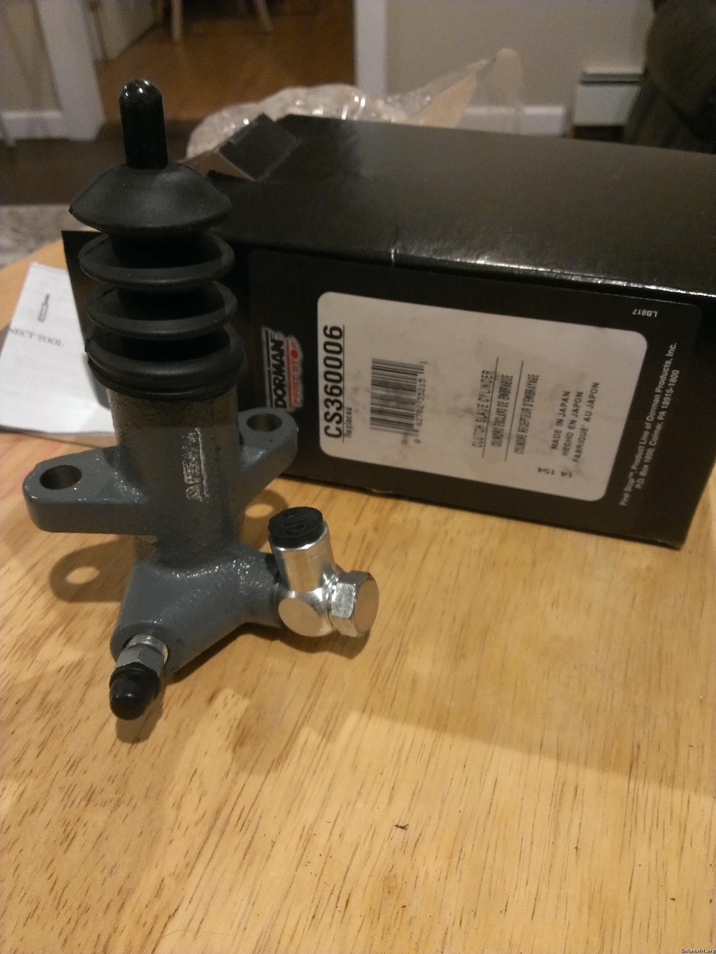

Aisin made in Japan part in Dorman box
Bleeder is on the bottom too.
I'm not playing with it tonight, maybe Saturday.

Having the bleeder on the bottom will make getting all the air out a huge PITA. It's going require some time.
