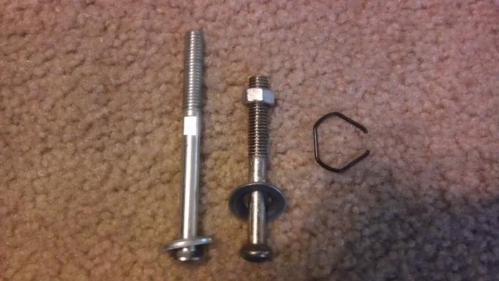

If you are running out of adjustment and need to get that little bit more out of it you could use a 2G DSM master rod, it is just that little bit longer.
Spyke169
Aug 17, 2005
324
Greenfield, Wi
