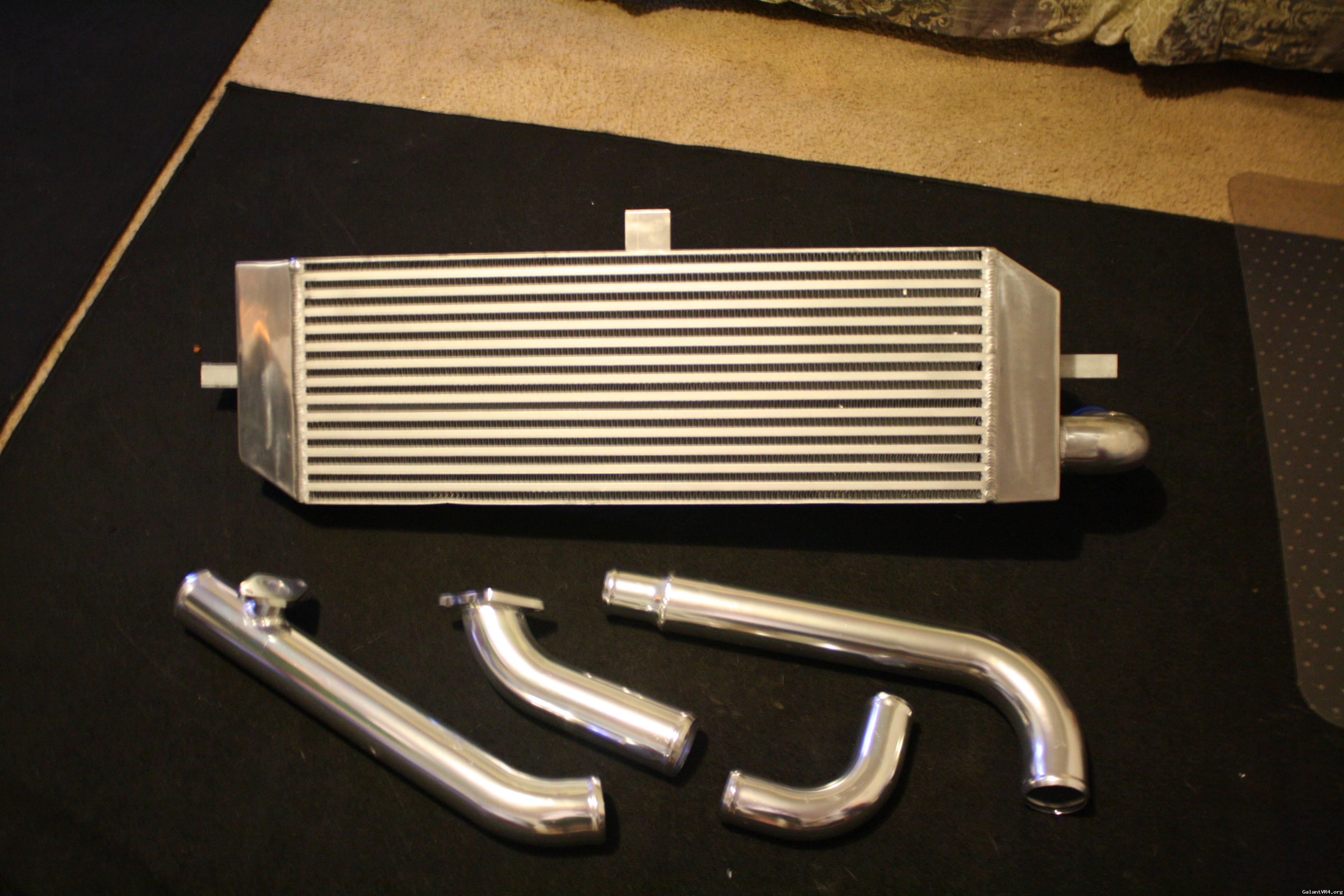

Alright, Made up my mind and bought the 2g intercooler kit. I will do a log on the install.. I got the kit off of ebay for $240 shipped witch is cheaper than the once i posted in the first post.

Got my 2g ic kit today. Waiting for a j pipe and a clear weather to put this on. Same kit i had on my previous 2g.
I will post a log and take pics of the install.

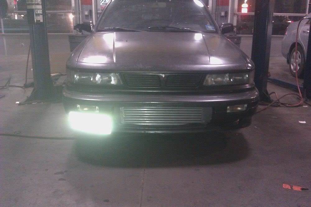

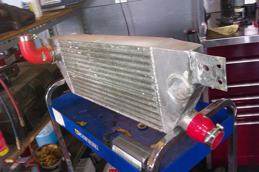

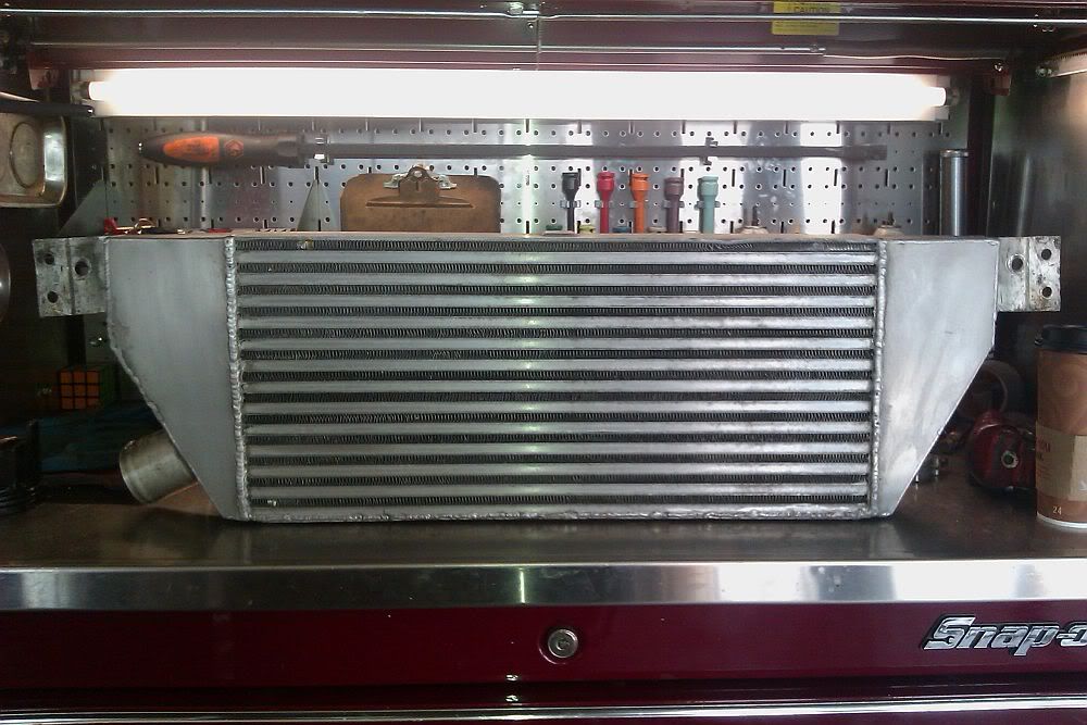

my car has the slowboy racing 1g frontmoutn kit on it. the endtanks were modified to accomidate a vr4. here is pics for reference.
