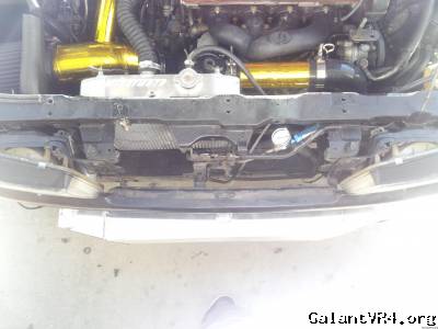

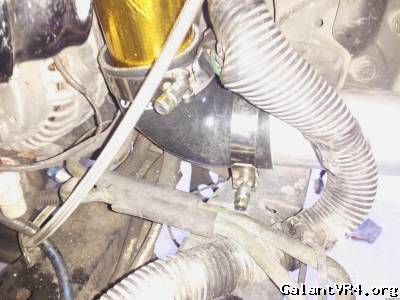

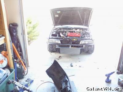

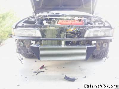

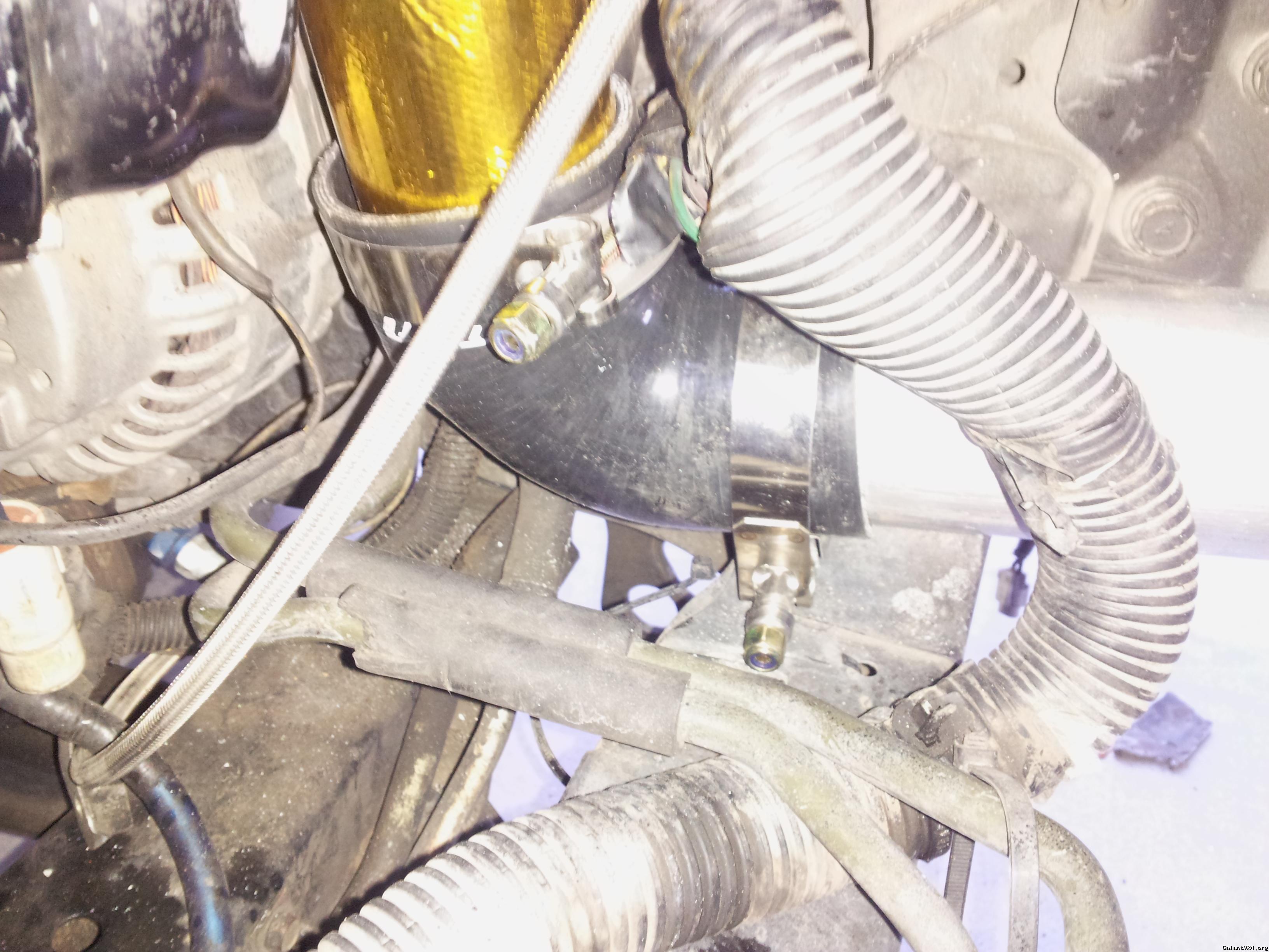

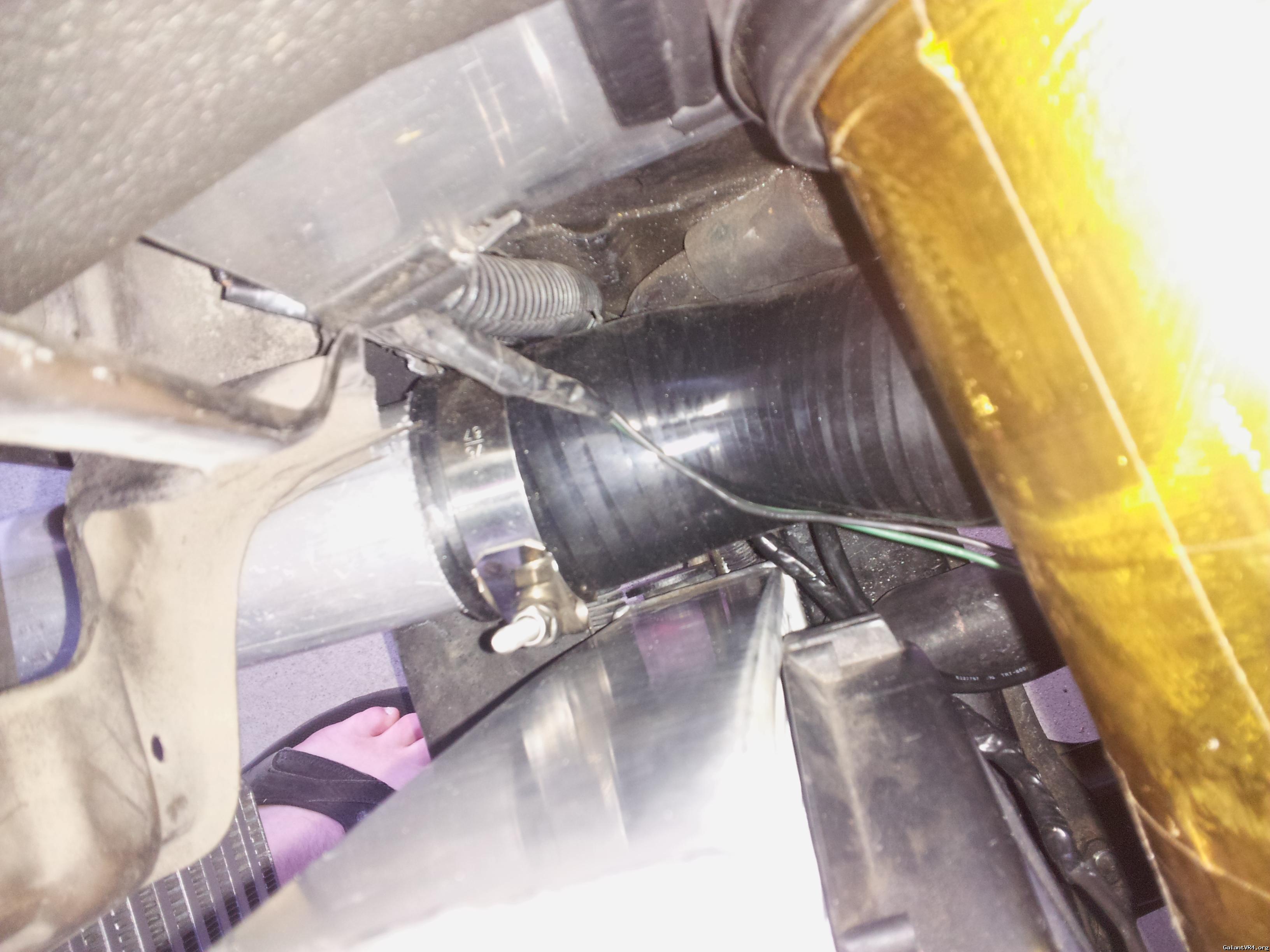

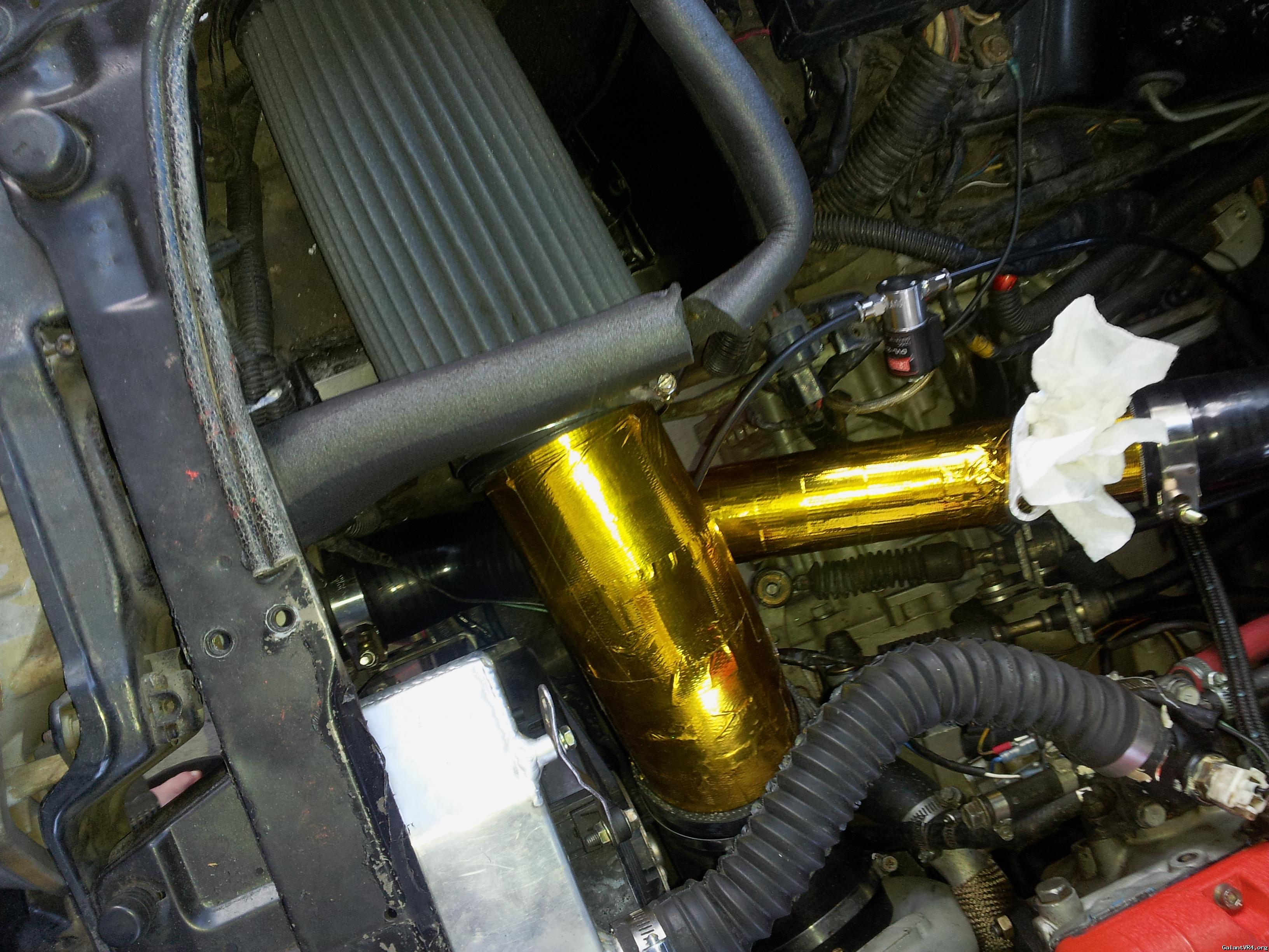

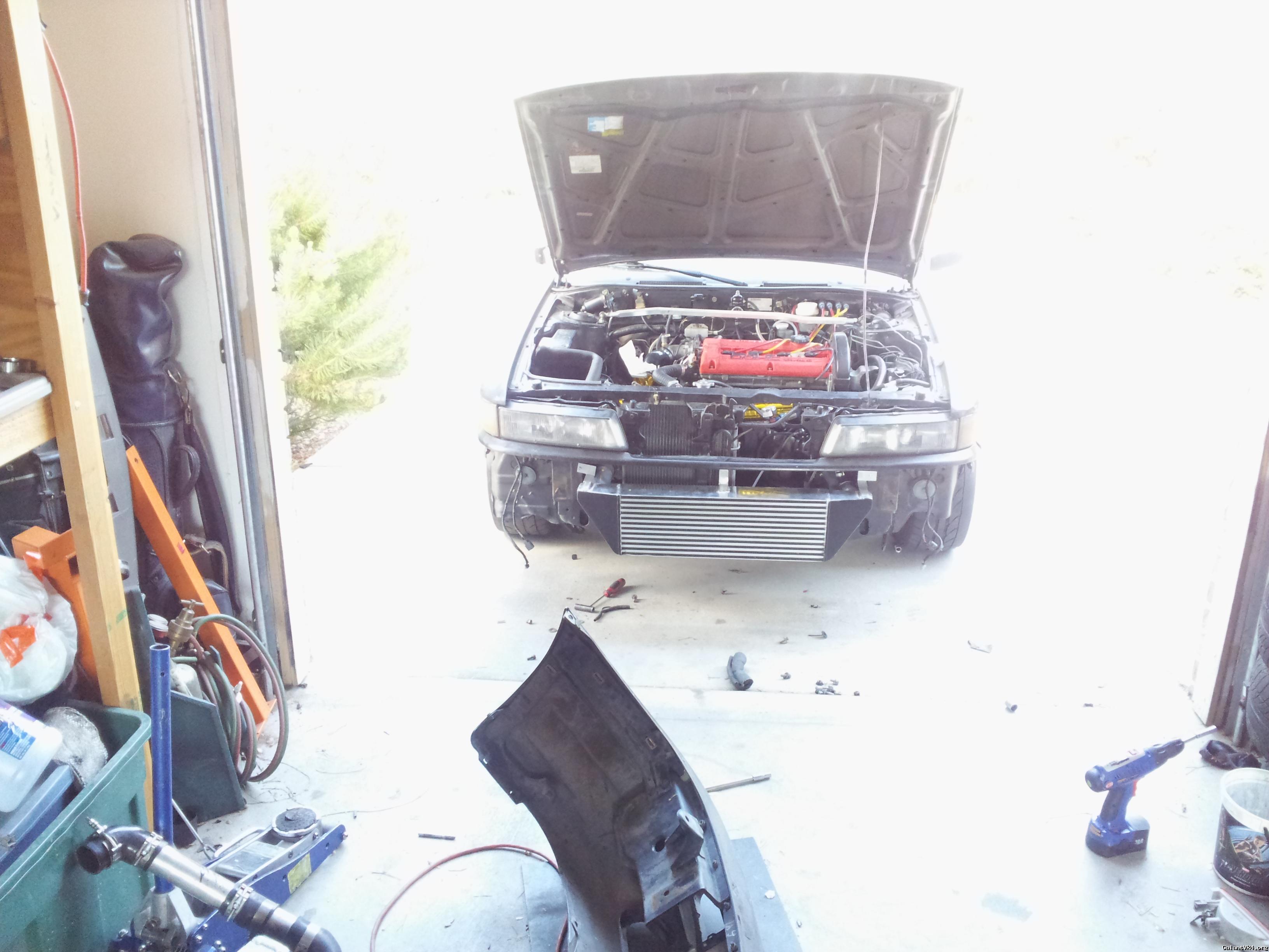

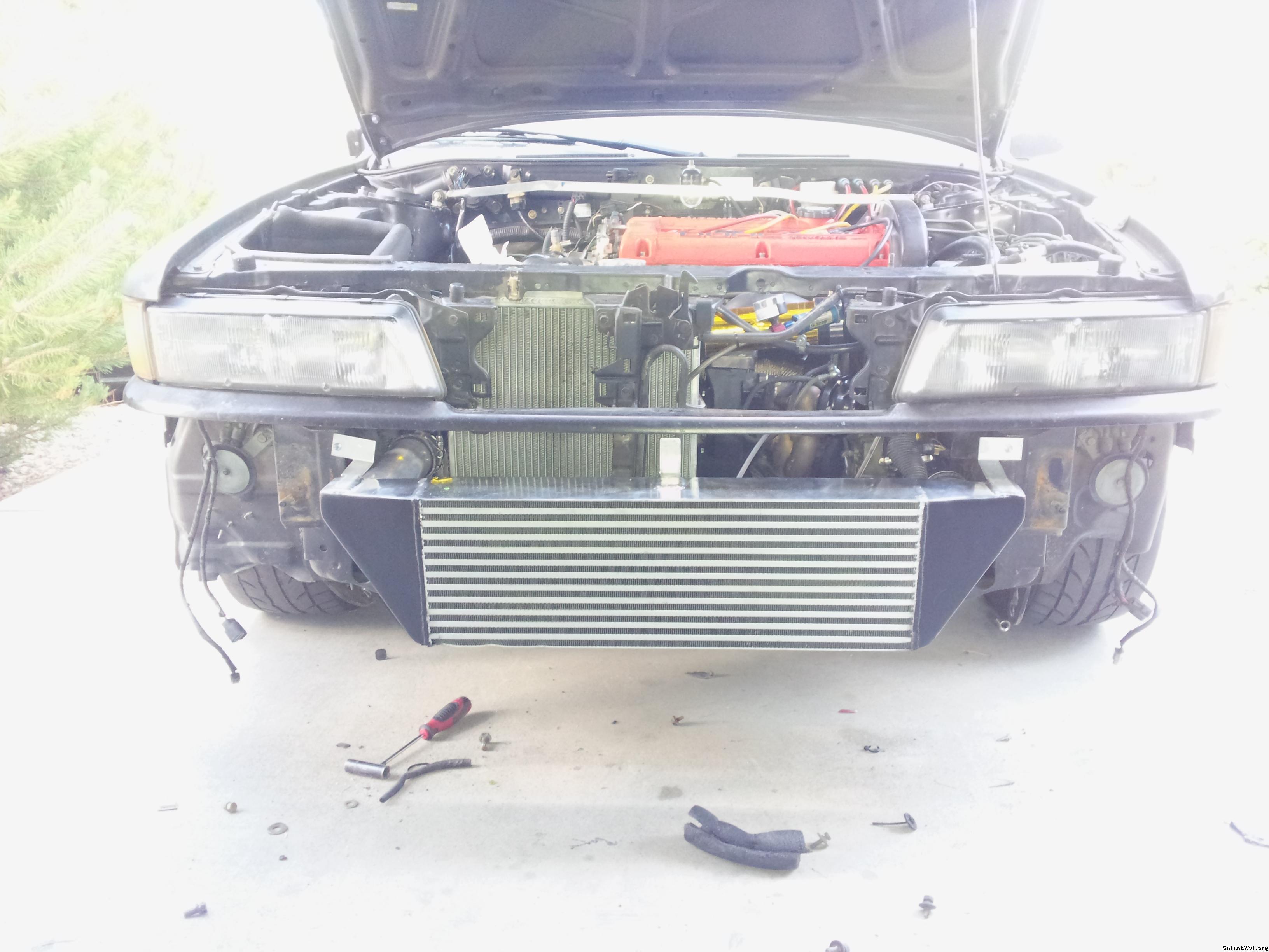

Well i have not found any pictures or info on here about a 1g dsm VR Speed intercooler installed on a gvr4. Anyways i did one this weekend. It was not hard at all. The only modifications i had to do was trim the sides by the radiator where the wire harness tucks by. Even the mounting tabs that came with the intercooler matched up the the frame. Not the center one but im not to worried about that. I had to but another 90 degree 2.5 bend and 2.5 pipe since i cannot fit the holset with this stupid civic core. I will be going with a scirocco setup soon. anyways heres some pictures for you guys.
Anyways ill have a little stuff left to do and i snap a picture of it with the bumper on.

Nice set good install. I would like to see a picture from the top showing how far forward under the bumper it comes.

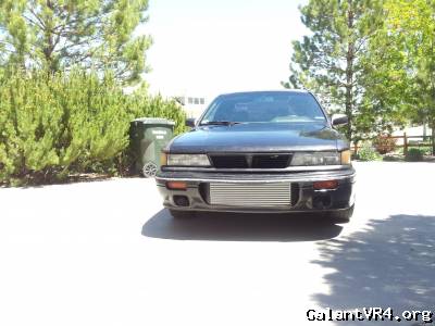

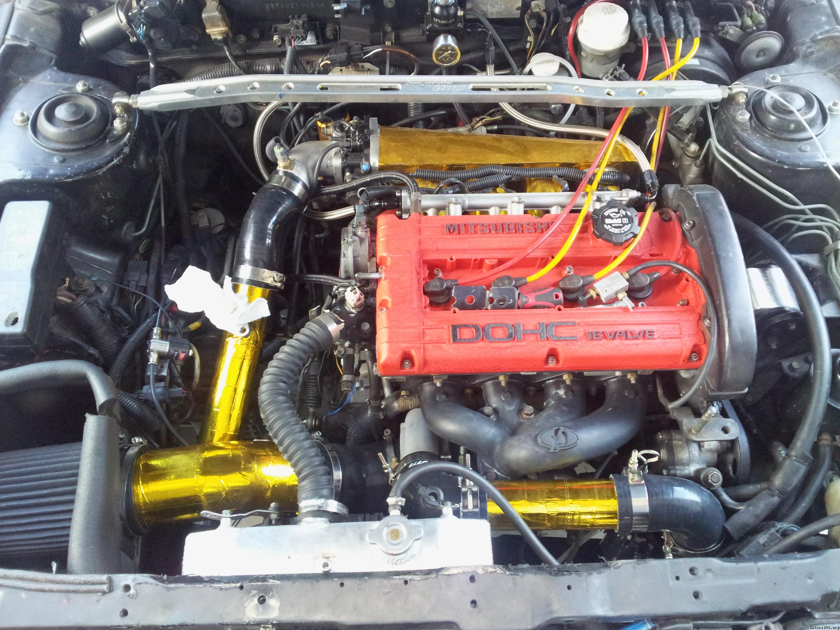

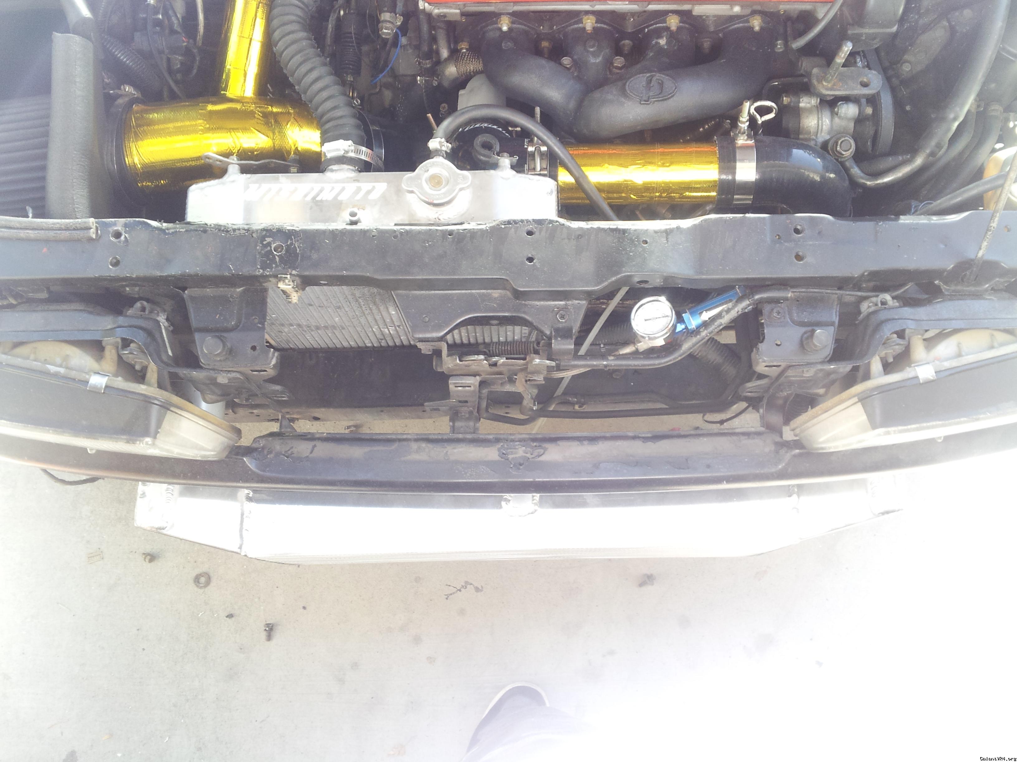

okay heres some completed picture and the requested bumper picture. I noticed 200 rpm faster spool and 30F drop in temps at the manifold.

Thanks. I just installed a scirocco radiator and now have the turbo down firing. Clean up the engine bay a little. Overall though i love the vrspeed fmic and even at 104f outside its only showing 110f intake manifold temps
