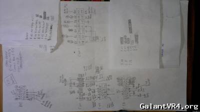

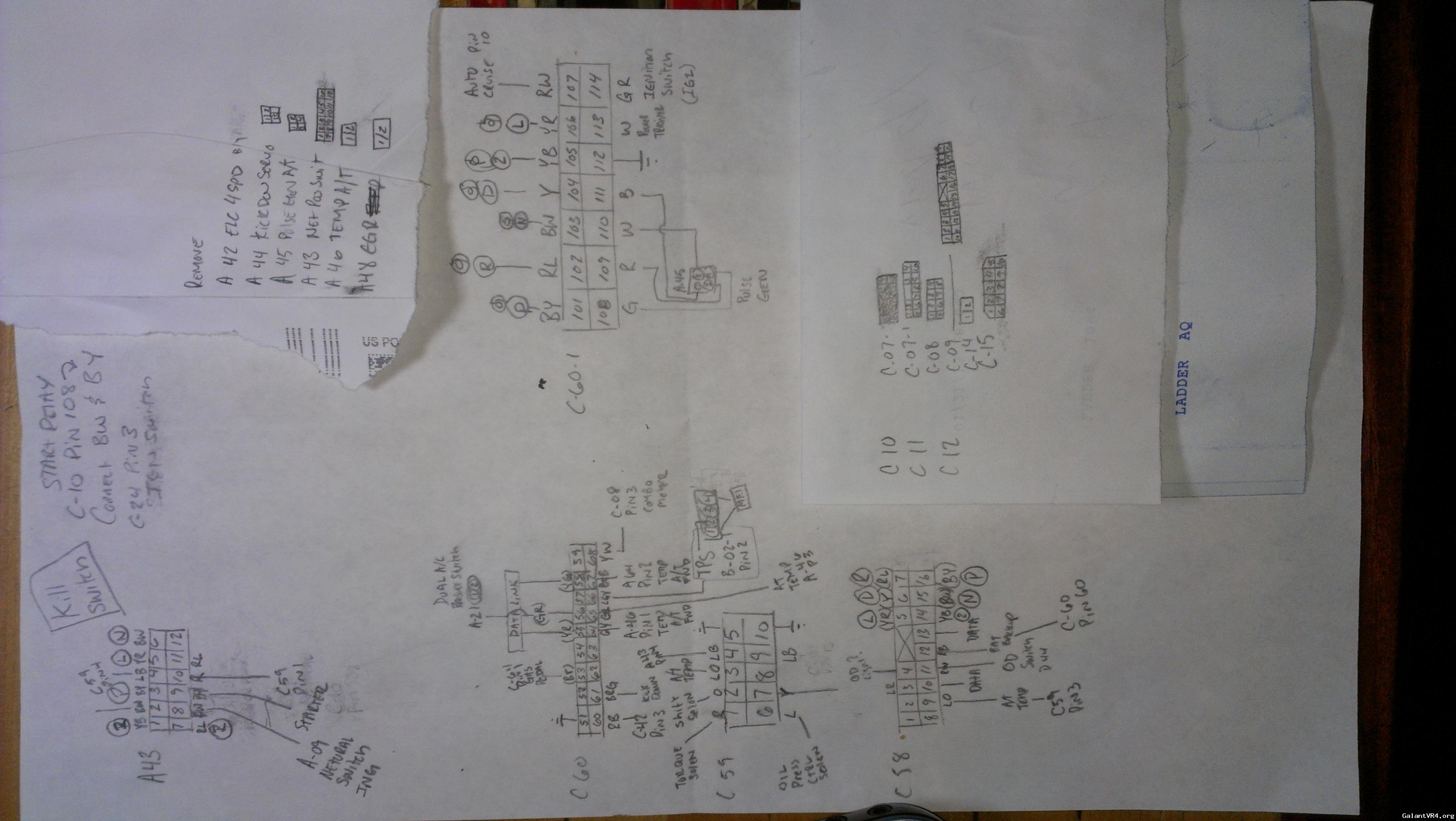

tucson,az
Im currently doing this swap, have been away from home due to work but have spliced the dsm auto harness into the galant harness. Its a pain not gonna lie. I still have to see were some wires go off the biggest plug will post pics of it see if I can get some guidence
