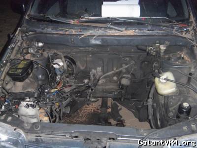

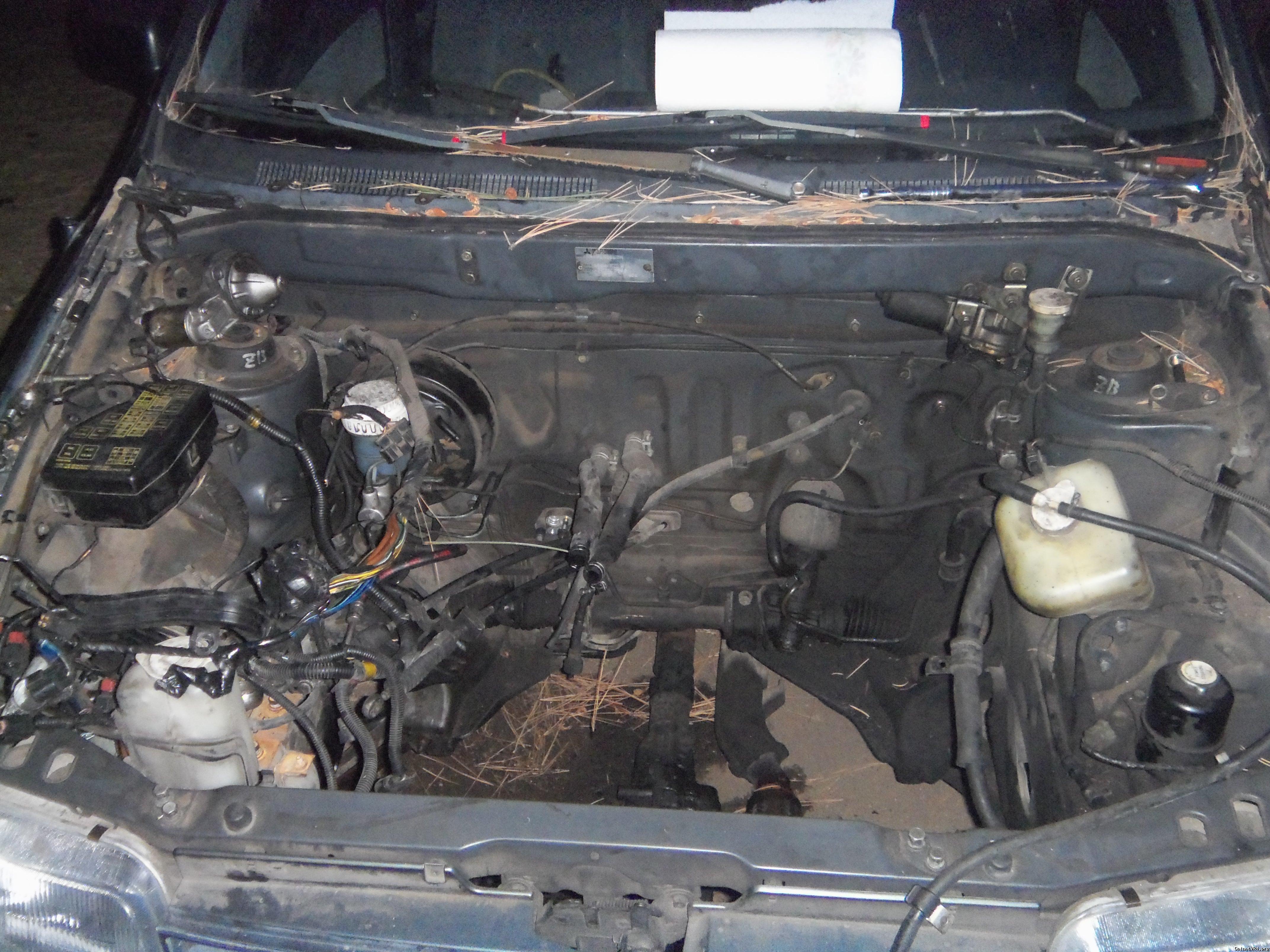

Evan and I dropped the motor today!

worked on her again a few days ago before we got a foot of pow up here in tahoe, i have the 1g 91 eclipse harness in, got the intake mani tapped for the map sensor, buying a ets street front mount this weekend for 350$ off craigslist just need to buy a fuel pump,spark plug wires,fuel pressure regulator,thermostat and a boost control solenoid and ill have all the parts together. excited and anxious but need some help.
What do i do to get her started, I'm using a 91 galant vr4 ecu w/ v3 ecm link full running sd, 1g 91 eclipse engine harness, a 91 galant vr4 mpi.I deleted the ac, car is all manual windows. so anyone have a idea of what i need to splice and where i should be splicing it?, I just want to get her runnnngi also have a 91 eclipse interior harness as well. i have a fsm for the expo as well.any help would be appreciated, I'm a electric newb, and all around turbo car swap newb(hondas).
