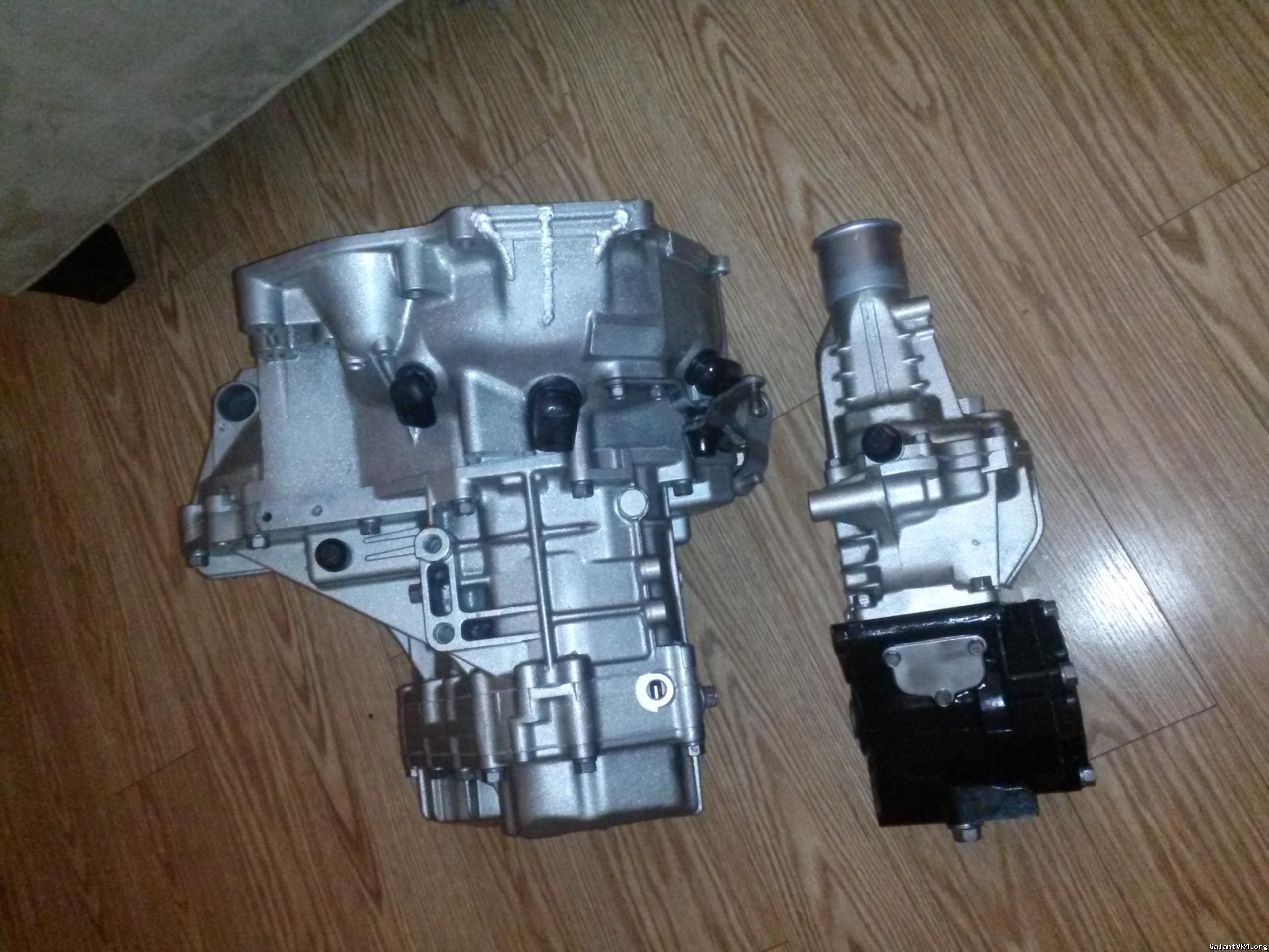

I bought a never installed built jacks transmision from a dsm owner he said it was from a vr4 so i didnt look at the codes till after i brought it home. Well its from a 1990 the linkage looks like it has been converted to a 91 im just wondering about the sensor i unplugged from my vr4 tranny there's no spot for that in this one. /ubbthreads/images/graemlins/dunno.gif
3,473
You talking about the reverse switch? If so, there is a spot. It's the empty hole in your trans toward the bottom right of the picture. You need to take the reverse switch out of your old trans and screw it into this one. Or, buy a new one.
