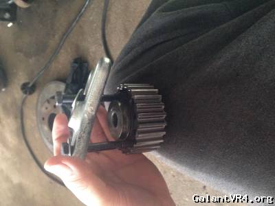

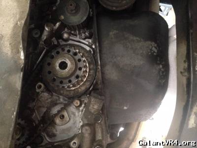

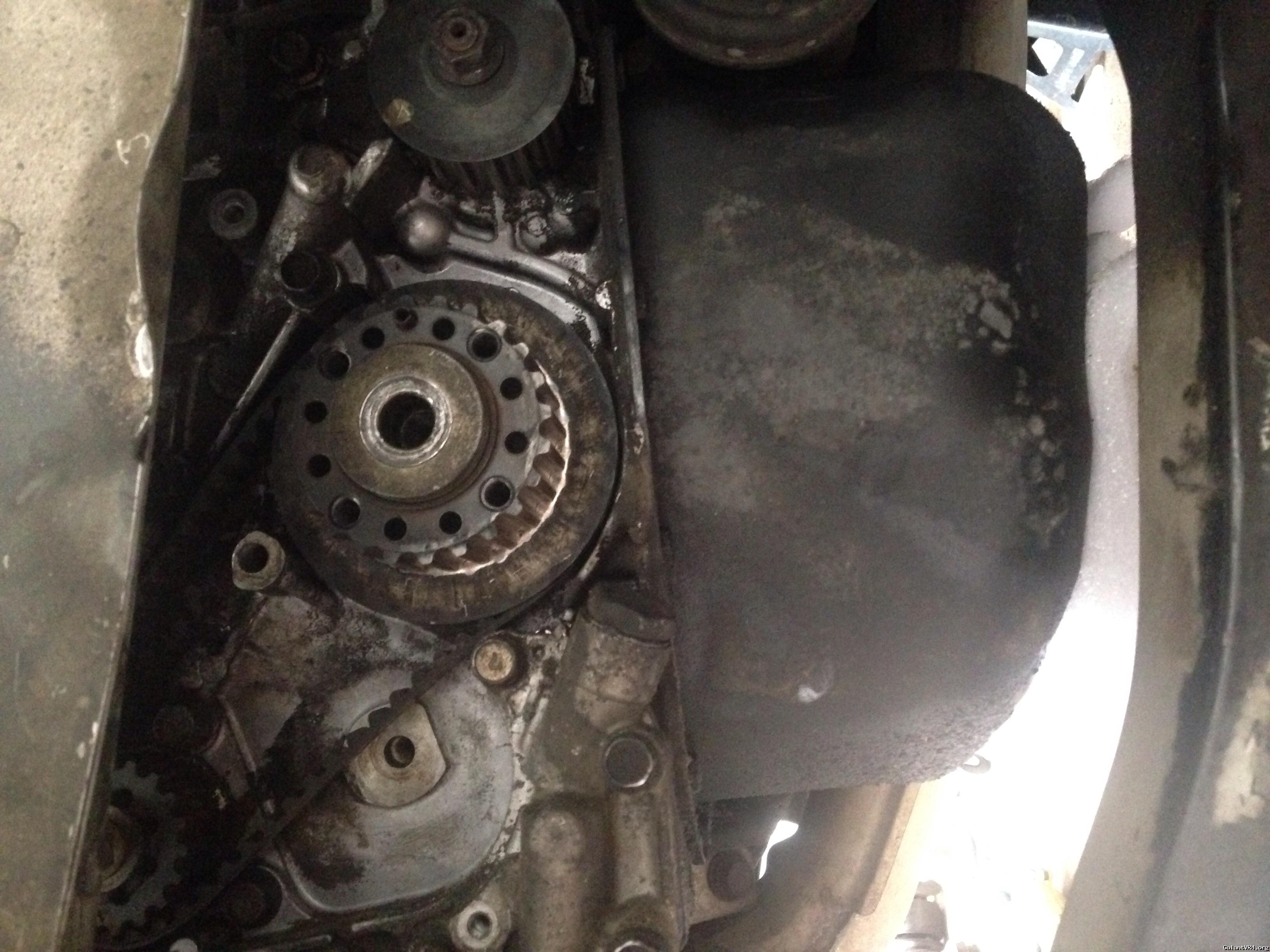

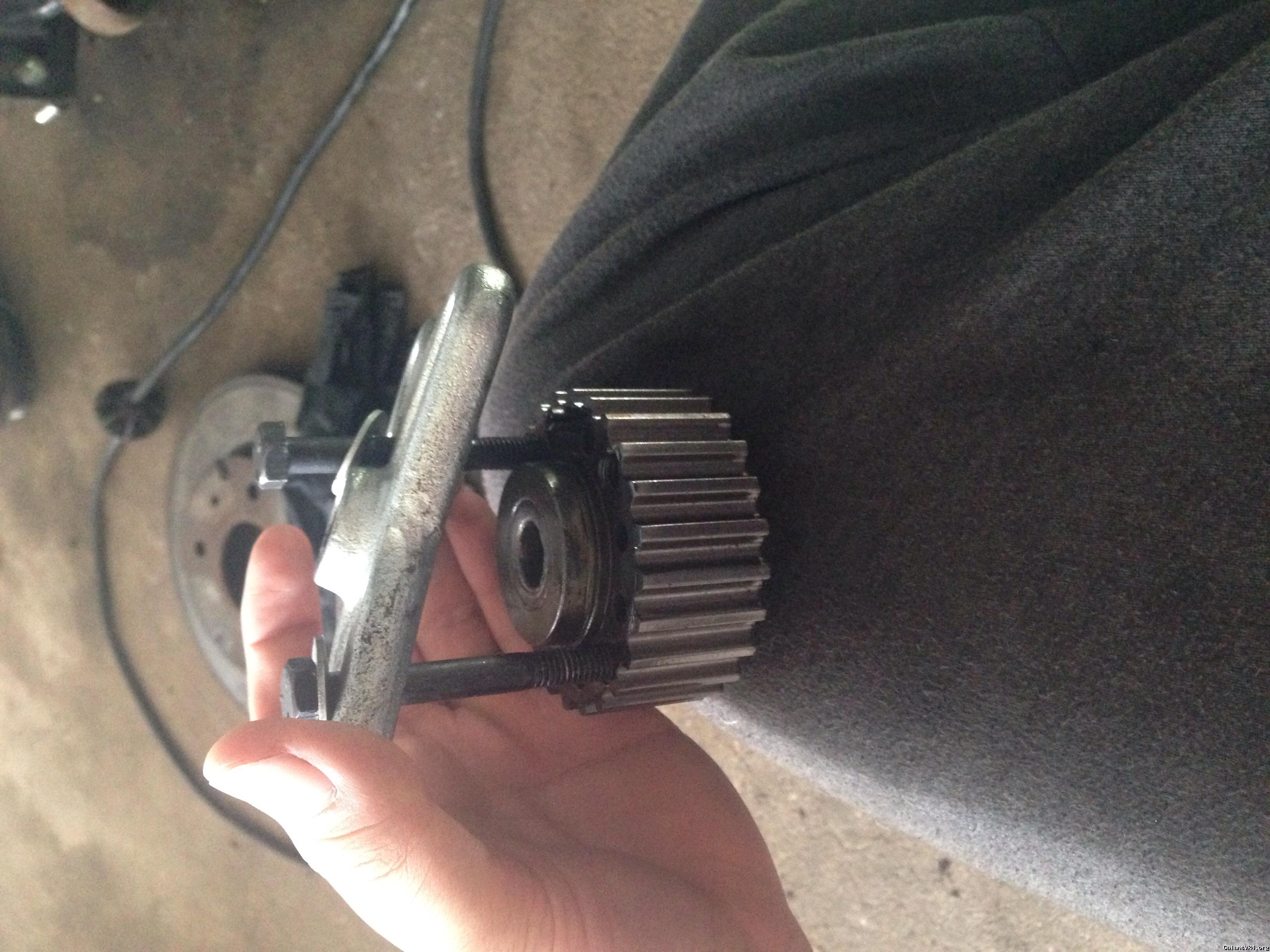

I finally got the chance to work On the car after months of being away, I've gotten everything on my list done except the timing belt. I have hit a road block and I'm not sure what to do. I have the timing belt off and Im working on getting the balance shaft belt off. I have taken off the bolt that holds on the crank sprocket, but I cannot get the sprocket off to take off the belt. I also took of the balance shaft tensioner so the belt is loose. Is there something else I need to do? I read that it should simply fall off after the bolt is taken out. I followed the 1g vfaq and didn't skip any steps.
This is where I'm at, I can't take off the sprocket. Any tips on how to get it off?
prove_it
Jul 3, 2008
4,201
Sioux Falls, SD
Yep, pretty much what I was going to suggest. They tend to do that. I always take some scotch brite to clean off the crank snout so it's all very clean before reinstalling. Of course now in days I have it apart so often that it never has time to get tight.
