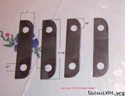

One more question I bought the EVO 8 suspension from LIV4PSI (Craig) and its not coming with the spacers to mount the fronts, is there anyone on here that sells them? Or should I have a machine shop to make me some? I can give them the dimensions from the EVO 8 suspension how to.

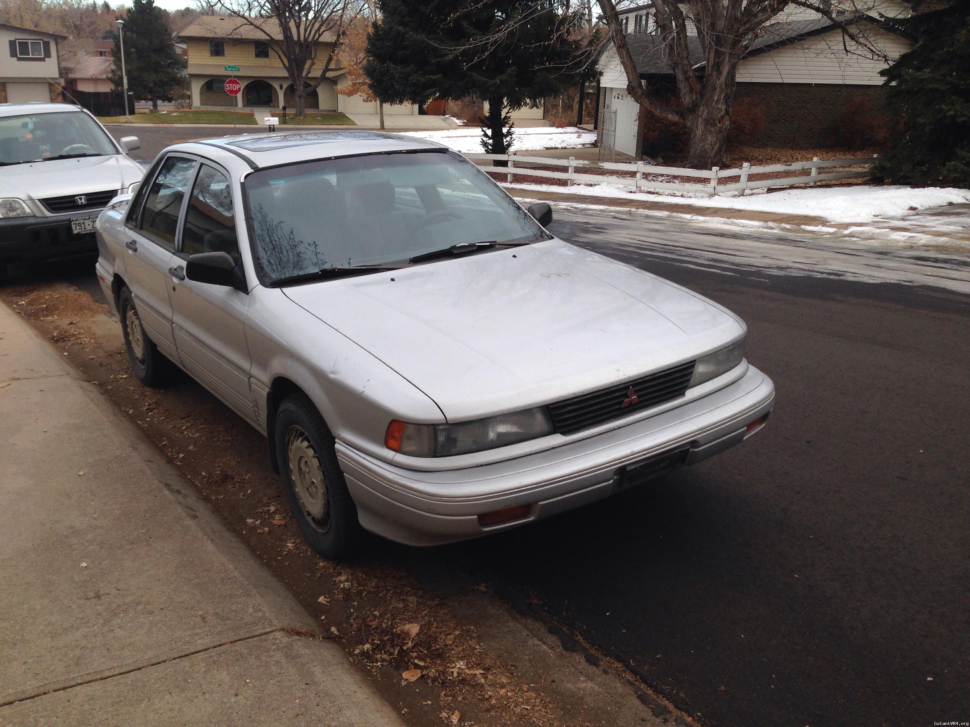

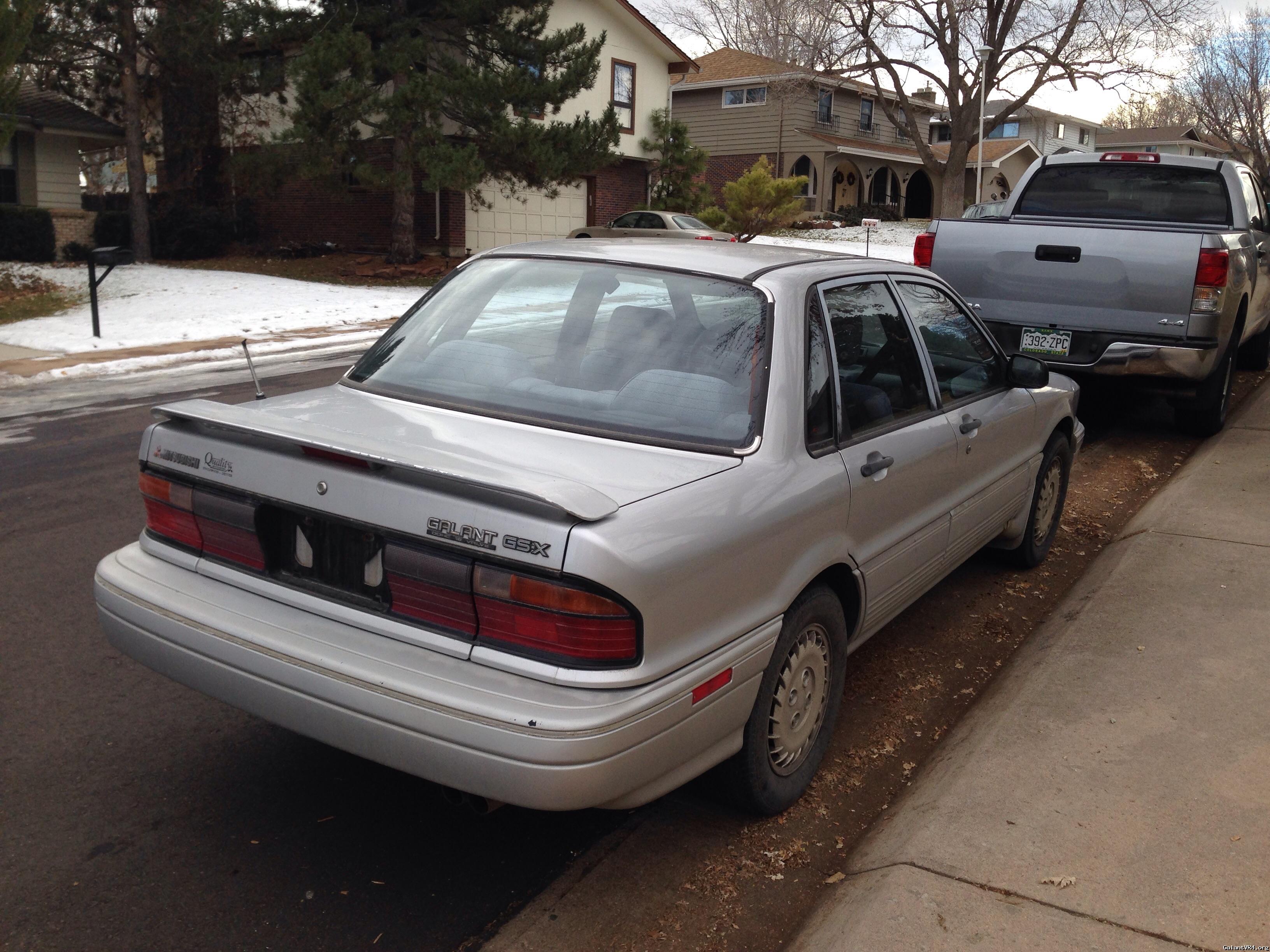

I only have these two pics of her as of right now, I can have my wife send me more pictures though.

Supercar-engineering. Com sells the spacers you are asking about. I was going to link you to them but can't get it to pull up on my phone right now.
Funny. My GGSX has the original dealership's sticker on the same place on the trunk lid. Haven't removed it because I'm sure there will be a distance in paint tone.
The only thing I see on that site, is stuff for the 3000GT, has the adapters for the rear struts, but not the spacers for the front it only has washers. click
This is what I am looking for!
Yea man I don't want to even touch that dealer sticker! It's probably going to be a huge color difference!

So now I know why I was confused. My parts car just used washers. That's why I had no chance of finding them. And those soacers look pretty easy to make, I doubt anywhere makes them to sell.

Problem with washers is the evo shocks have larger mounting holes than the Galant.so you can drill out your steering knuckles and use evo bolts. Or get these I mentioned. When i first put the evo suspension on my dsm i hacked up the dsm ears to use as spacers, eyeballed what looked like 0 degrees camber and marked the position. After 100 miles or so i checked back. They had shifted. At that point i opted for the spacers from supercar engineering instead of drilling out the knuckle. Here is a link to the spacers click
You can get just the front, and chop and weld for the rears, or get both to make it a no welder bolt on affair.

Have you had any issues with the spacers from supercar-engineering, such as the positive camber prove_it had? The mounts didnt need any modifications with the spacers from supercar-engineering? The spacers make this a bolt on affair for the front? The rears are already welded and ready to bolt in.

No. The issues he had were from the slotted hole allowing the bolt to move on hard corners. This is not an issue with the spacers, as you can see they have a step on them. The smaller diameter portion takes up the space in the larger diameter strut holes. The larger diameter part is what acts as a spacer. When installed the larger part of the spacer is against the steering knuckle. Using only a thicker spacer on one side changed the caster angle resulting in a greater camber angle and results in a more negative camber gain when cornering. The spacers from supercar center the steering knuckle in the strut base maintaining the caster angle.
Edit: Yes those spacers make it a bolt on affair. Alternatively drilling out the steering knuckle holes and not slotting anything makes it a bolt on affair as well. But you will then need evo bolts. FWIW I believe the evo bolts (versus galant camber bolts) allow for a degree or two more camber adjustment, not really an advantage of you are aligning to factory specs.
