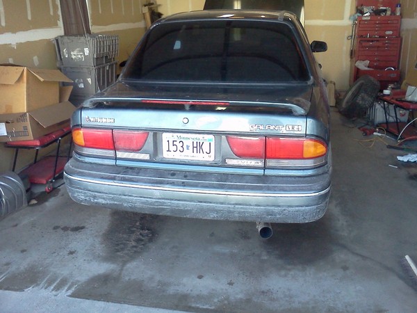

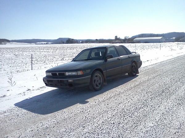

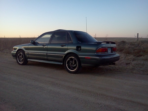

Stopped on my way home and took a few pics. Finally washed the Galant yesterday.

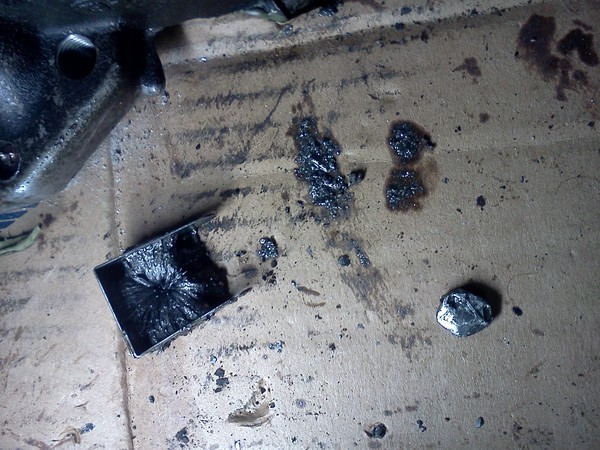

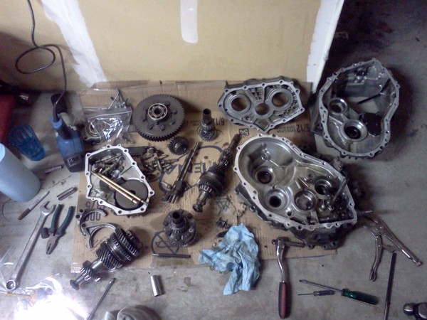

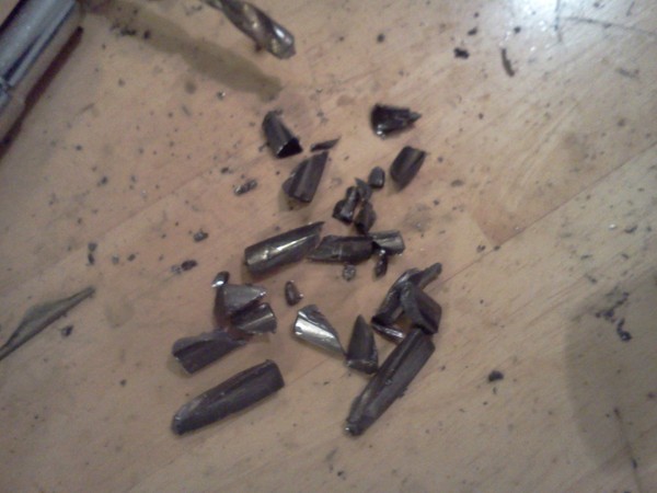

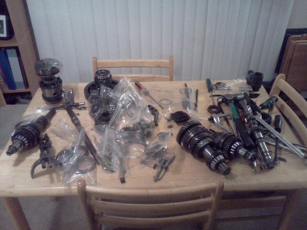

Picked up a transmission from a friend that was ran dry on fluid. Pulled it all apart for my first time ever tearing apart a DSM trans. Surprisingly, there's only 2 bearings and races that are trashed (on the intermediate shaft assembly), and the center diff doesn't quite feel right to me. Otherwise, nothing else seems to have abnormal play, the syncros look great.
Just some of the metal inside:

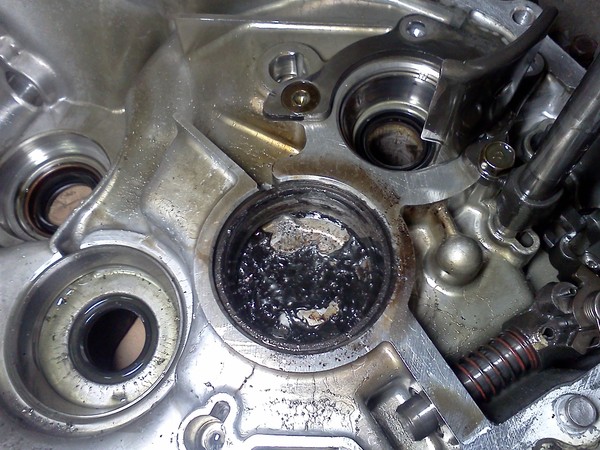

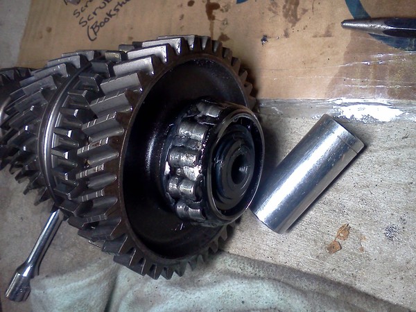

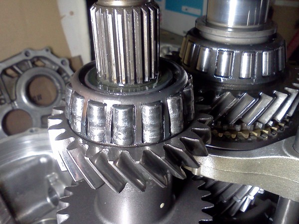

Outer bearing has some bad marks, along with it's race:
The inside bearing is pretty bad, explaining the chunks of metal:
The race is just as bad. I'm assuming the black build up is gear oil that was super hot?
I'm going to pull the transmission that's still in my Galant and take that one apart to figure out what happened and if anything is usable. I have my fingers crossed I can make a good transmission out of the two with some left-over parts. I'll have to make more room to take the other one apart:

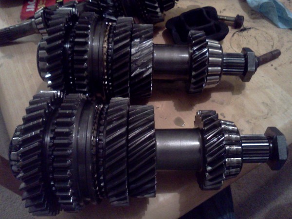

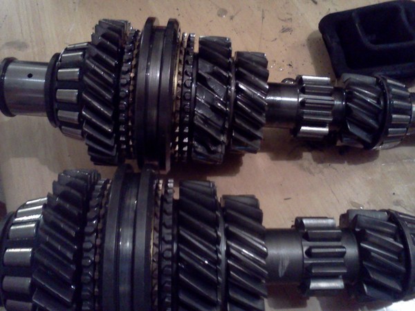

Finally pulled the trans out of my Galant and took it apart to see what happened. Pretty much, exactly as I thought....stripped gears. The gear clusters on the bottom are whats going into the trans, above is the ones that were in it:
Just a few of the gear pieces:
My plans have changed slightly after finding a huge crack on the case of the trans I got from my friend. So far, as much as I can tell the trans case out of my Galant is good, so that'll be used. The center diff is being switched as well, due to mine having it's teeth crunched as well. If I can re-assemble correctly this should be a decent transmission with a GVR4 first gears, and bronze syncros. My old syncro's were the brass ones.
Thought I'd take a pic of the transmission rebuild table, in our living room:

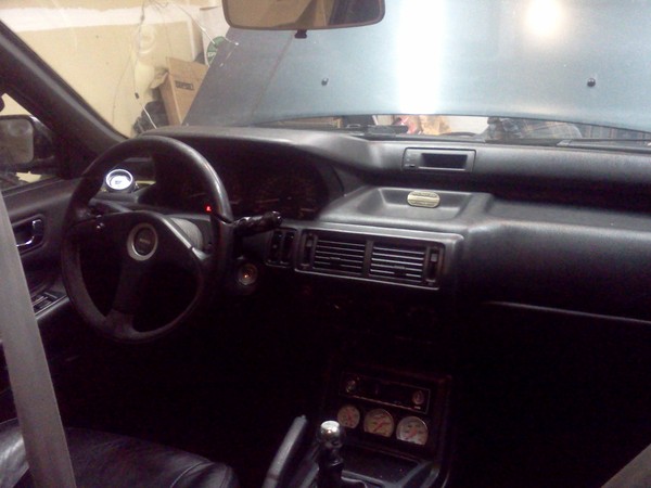

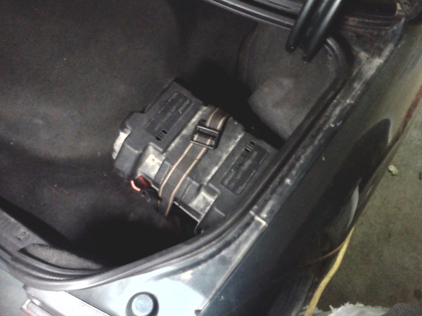

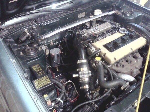

Well, now that I lost my job, I have much more time to tinker with the Gaylant. Finally mounted the DSM ecu up where it should be in the Galant, ran the release cables for the trunk and the fuel door, also stole the latch off my Talon so now the fuel door is on. I took the stupid lawn mower battery out and put a real one in the trunk with all the stuff from the Talon. Bolted down the battery box, ran the cables. Fixed the non-working reverse lights.
Took a couple pics:
Engine bay is much easier to work in now. Also safer without the battery up there.

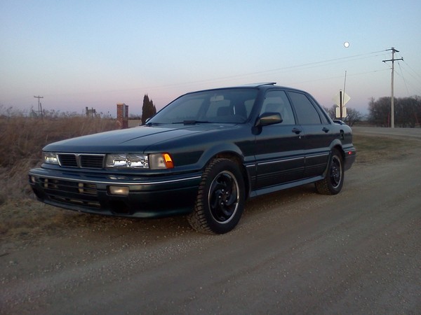

I was bored, so I painted the chrome trim around the 92-93 tail lights to black. I think it looks better than the chrome:

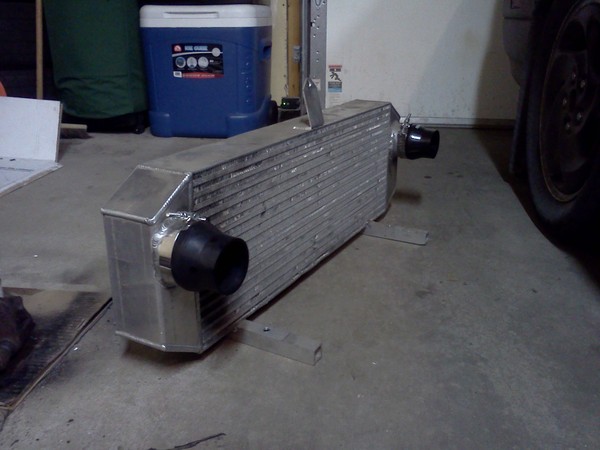

I bought myself a different intercooler from a friend of mine. It's about 28in wide, 10.5in tall, and 3.5in thick garret core. It was off his low 10 second 90 Talon, put down a little over 700 something to the wheels. I was very lucky as I didn't have to cut anything to get it to fit. Only had to drill two holes to mount it.
Only real issue is both the inlet and outlet are 3in in diameter, but the couplers solved that. Put it together, test drove it and it pulled harder than it ever has at 22 psi with that on it. When boost hits, I actually get planted in my seat.

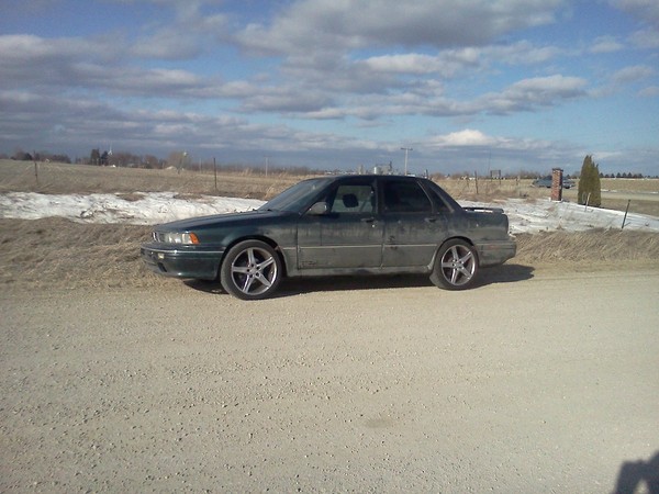

Sick of this so called "winter" season, and wasting my snow tires on dry pavement every day so I put the summer wheels on. I like the 18's on the Galant, I'm curious what others think. My guess is the general vote will be too big:
Yes, car is filthy. Now that I'm working back at my old quick-lube car wash job I'm going to wash it really good, wax it, and clean the inside tomorrow after work.

Good idea painting the tail light trim, i always hated how the 92's had that silver around them. just doesnt look right.
