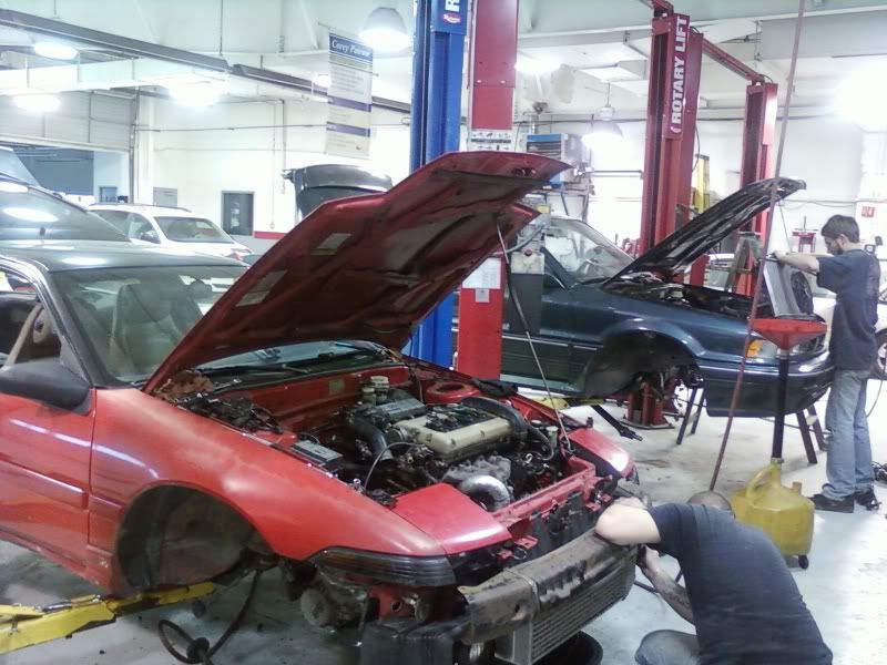

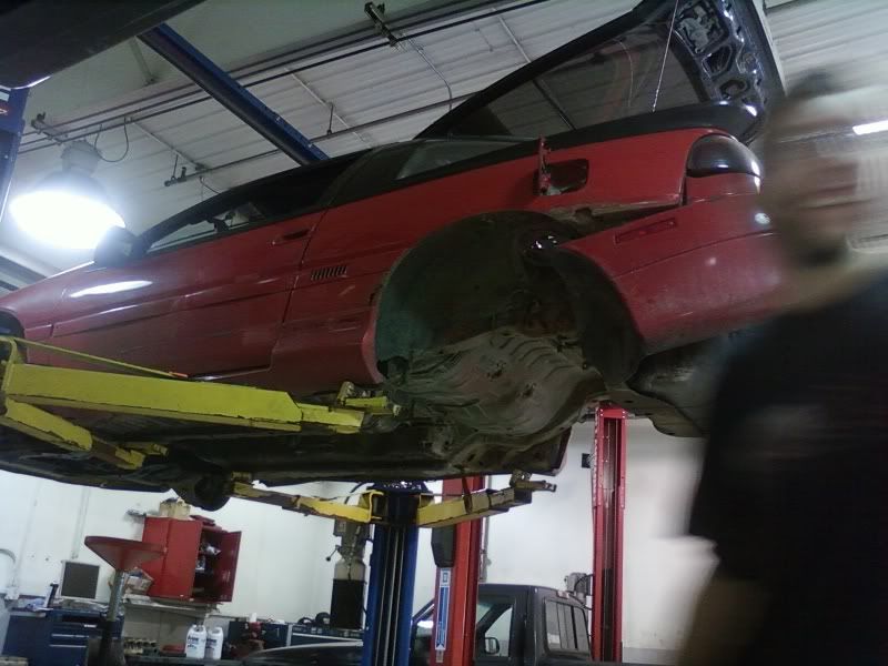

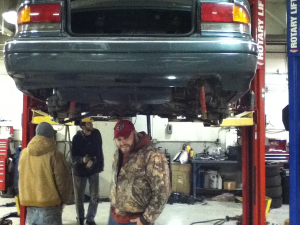

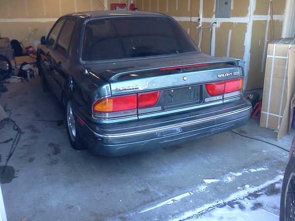

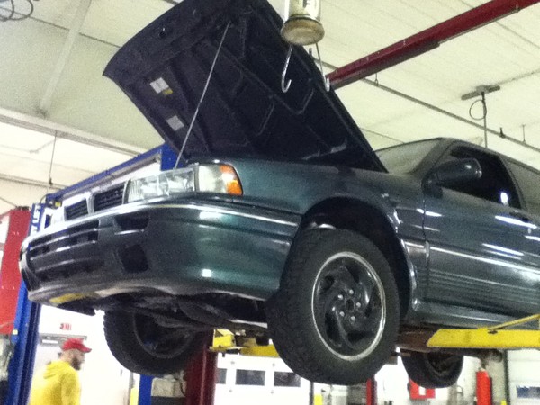

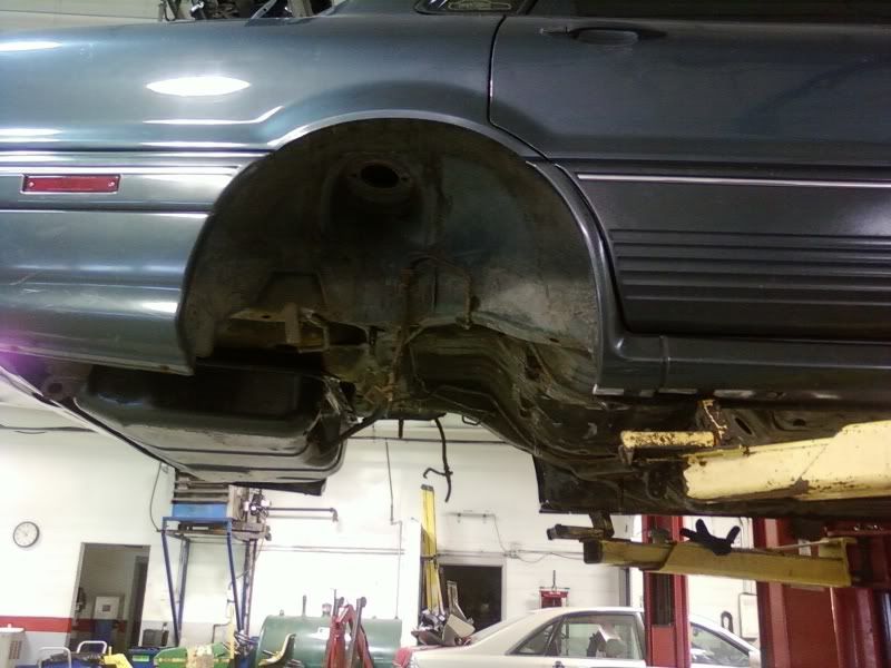

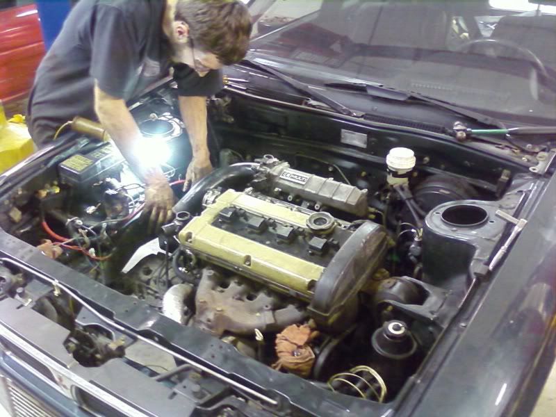

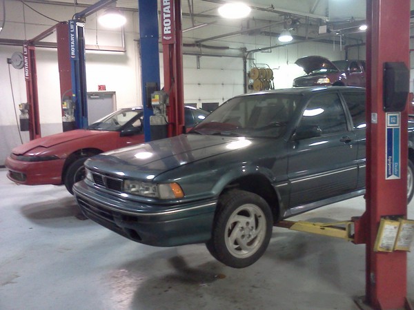

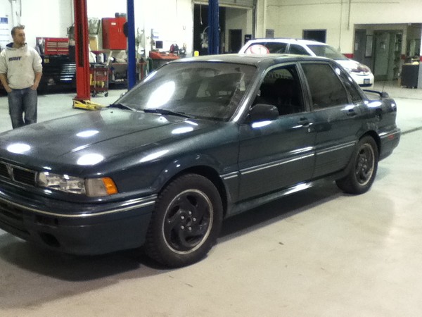

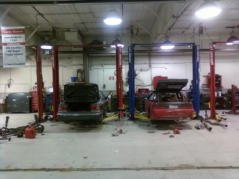

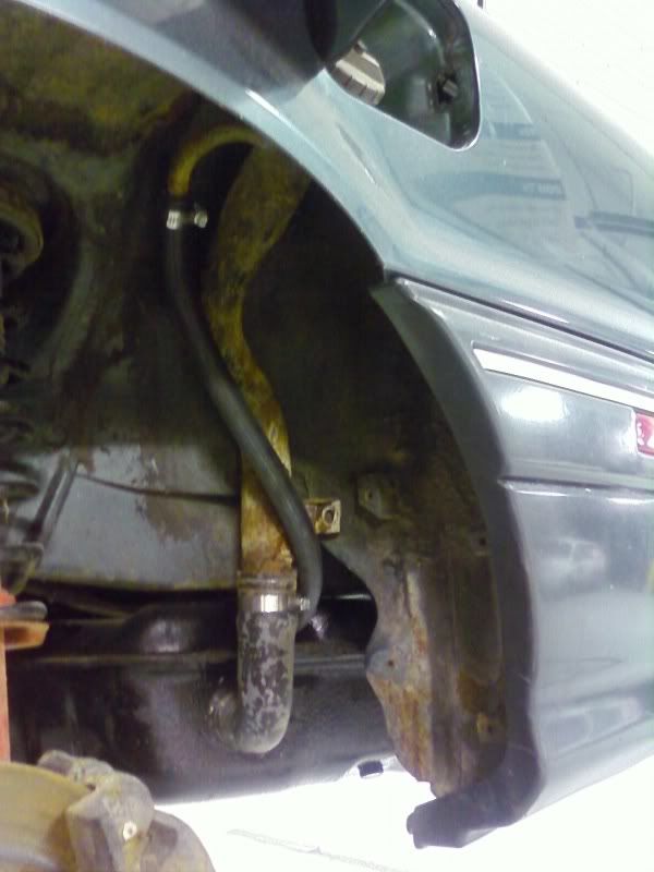

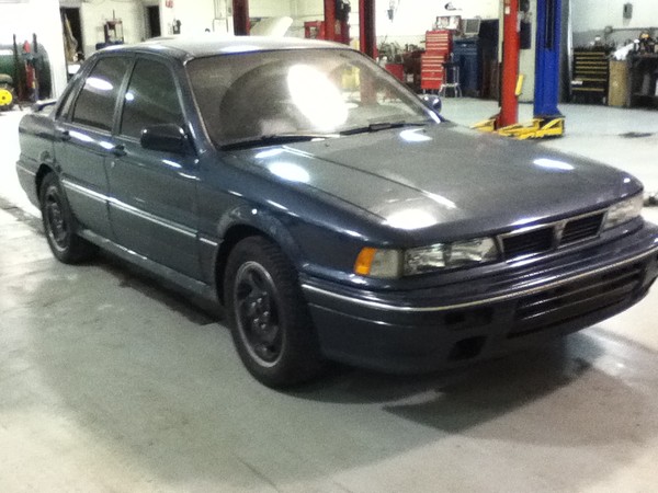

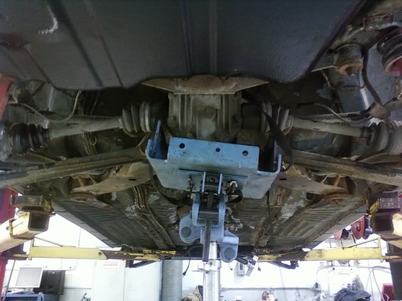

Galant is running and driving! Drove it 27 miles yesterday for the first time. Already the car drives better than my Talon did, but then again maybe thats because I have more poly bushings up front and the correct motor mounts. Still needs to be put up on the alignment rack, hopefully that'll happen tonight after work. Here's a bunch of pics twack and my friend took:
For anyone ever wondering, yes, a 1g filler neck and hose fits great:
Here's the crew that made it possible:

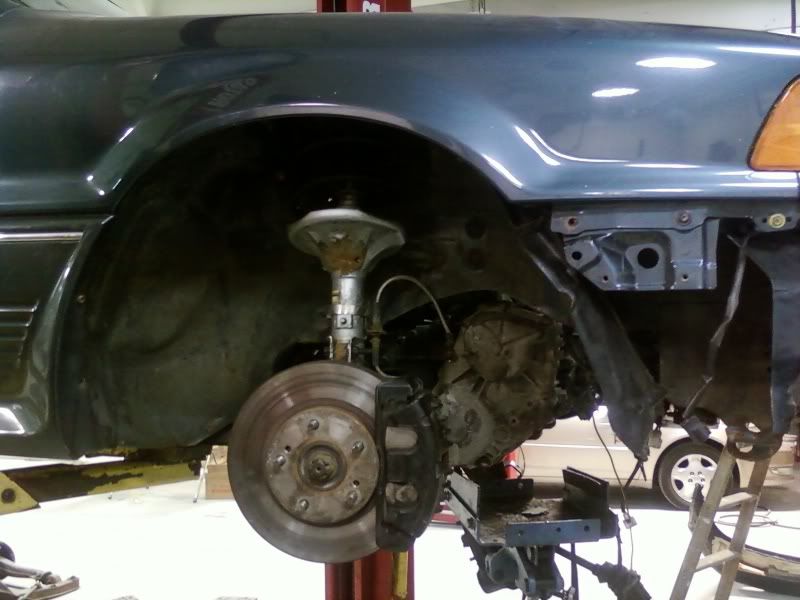

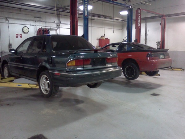

First things first, swap rear ends:
Doin werk:
Where'd it go:
Here it be:
Poor Talon:
Camaro brakes rockin strong:
Because intercooler:

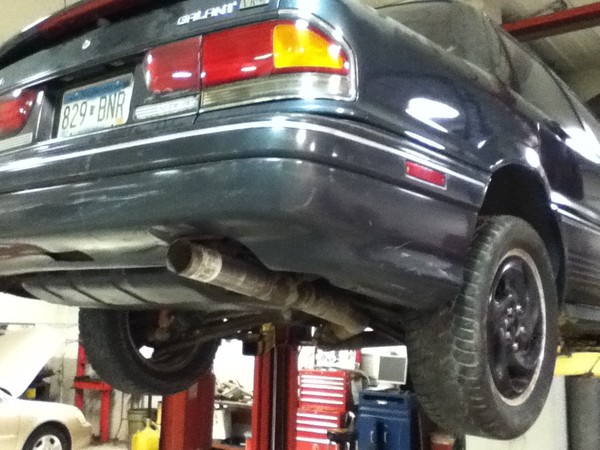

Exhaust:
Here's 1945, with 100% new life:

Thanks guys! Having access to a lift is one of the many benefits of working at a dealership.

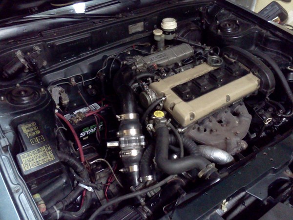

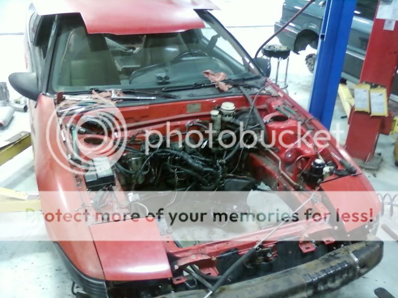

Gave the car an alignment at work today. I'm thinking one of my control arms is bent because one side has more camber than the other in the front end. I have some much better control arms that I had sand blasted then I painted them and put new moog ball joints in them. I just need to buy a poly bushing kit for them.
Pic of engine bay as is:
I need to pull the power steering pump out of the way and tighten the bracket that bolts to the block tonight yet. Somehow, it's loose and being my daily driver I can't have something happening.

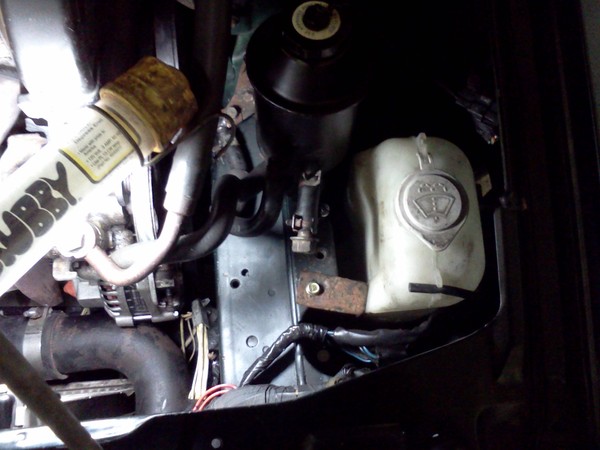

Thanks guys. If anyone is considering relocating their washer bottle on a GVR4, It's pretty easy. I was able to use the stock bottle, with an L bracket from the washer fluid bottle off my DSM. When I had the wire harness out for fixing, I pulled the two wires for the washer fluid motor through the grommit and then ran it behind the dash, through the dr. side fender, and out the grommit behind the dr. side motor mount. Just have to run new hose (which I had to anyway, old stuff was junk).
Looks way better in this location than where it is on the firewall from the factory.

Where's the overflow for the radiator? Down in the bumper void behind the fog lights/under the battery shelf?
