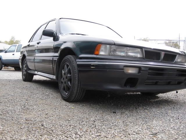

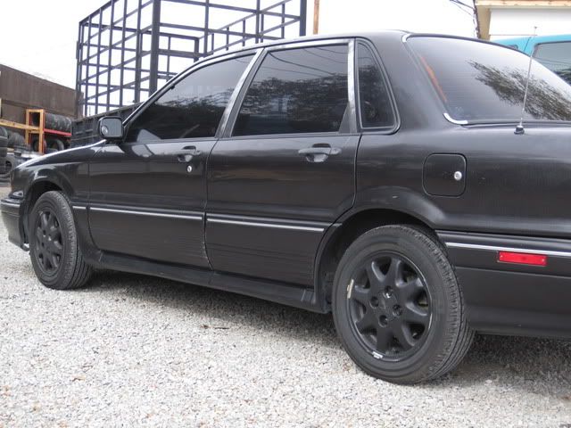

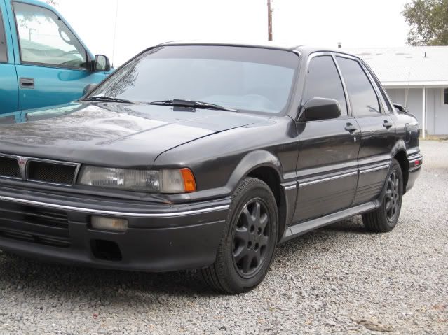

Heres how she looks now after the second cleaning. It still needs a good wax as it still has alot of oxidation from sitting.

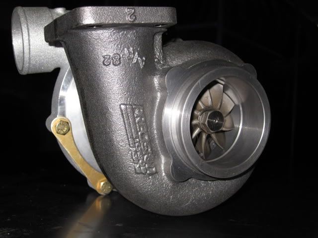

Which PTE turbo are you looking at? Im planning to possibly upgrade this winter, everyone is telling me the 6262 in journal bearing is good and cheap and will work well in a .82 T3 housing with 5bolt o2 flange. (meaning bolt on for me).

I was going to go with a Dnp, but having run one on my race car it cracked at the wastegate tube 25 passes into the season. I was really looking for a twin scroll design but that will limit me to I think would be two turbos. The borg warner and the pte 6262. The more I think about it I may go with the PTE billet ball bearing with a divided housing. I know punishment racing sells a true divided housing manifold and so does shearer fab. I think this is where the money is gonna count. It would be nice to lay down almost 600 hp and have crazy spool up time.

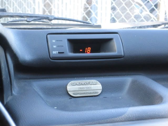

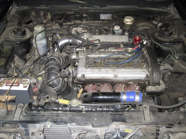

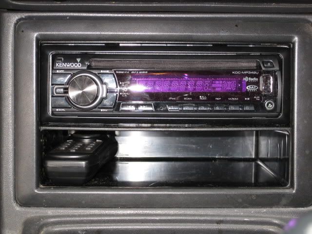

Ok so I was excited on how this turned out and couldn't wait to post it up.
I had to find a place for my boost gauge that was not really in sight.
I have also been do alot of little stuff to the car getting it ready for all the big upgrades. I cleaned out the engine compartment of the a/c, power steering, and cruise control. Last night I installed the 1G shifter and new bushings from SAM (blue642). Thanks sam what a difference those made. Sitting on the shelf is a freshly cleaned head that I will start porting this week and EVO 3 intake that I started on. the 4 bolt rear is sitting there waitin for the gears to go out to get shot peened and then rebuilt. As soon as I start getting all these parts together I will get some pics of the install. I have a turbo picked out, it is sitting on the shelf waiting for me to send the money. Maybe this week I will get my lazy ass to the bank and deposit the cash. Still trying to decide on a manifold I have narrowed it down to the DNP, punishment, and the ERL. Why those? IDK just right there avalible at a good price I guess.
gmp
Apr 1, 2007
549
Denver,co
Dang thats sweet i was going to do something similar with my turbo timer. But ended up hiding it in the cig tray since it never gets used..
But that looks really good clean the thefts will never expect that !!!!

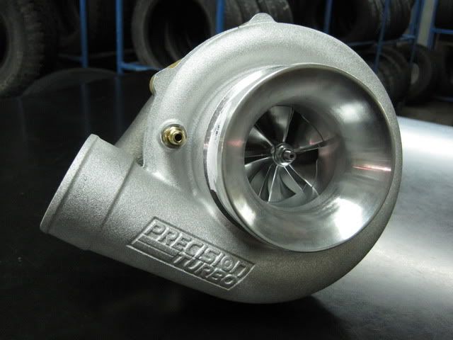

The fed ex guy also dropped off this:
Good choice in turbos. That turbo running 35-40psi will get you
to your goal.
Personally I like the T3.63 but i'm sure
that will work fine. /ubbthreads/images/graemlins/cool.gif
Steve

It took me a bit to figure out which turbo. I really couldn't find any info on what exhaust housings others are running to get an idea. I think that spool between your .63 journal bearing and my .82 bb should be close. I believe you and I were chatting in the sd section of ecmtuning. I saw your thread after I purchased my turbo. Now after seeing your logs im pretty confident in my setup and goals. When are you getting the springs in and heading to the dyno. There's so much doubt on these forums on what I want to do and what you have done with pump. My disadvantage is we are limited to 91oct unles I want to pay 5 something a gal for 93. Then I might aswell go 100 but that out of the question.

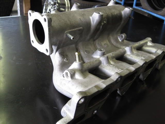

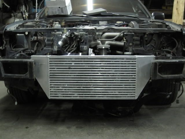

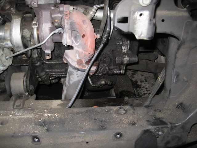

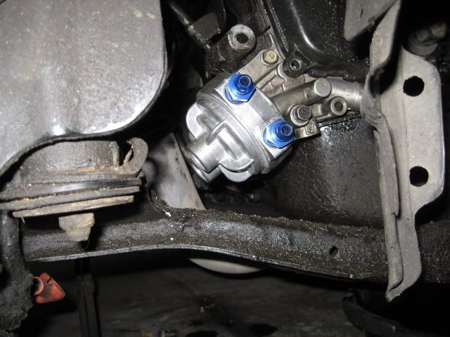

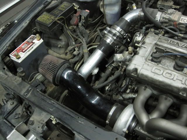

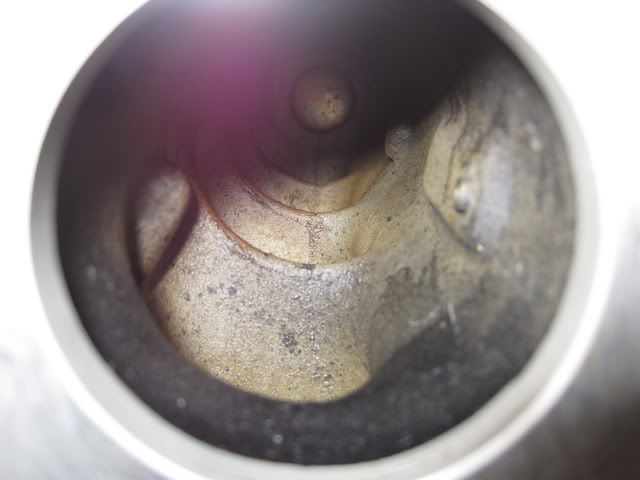

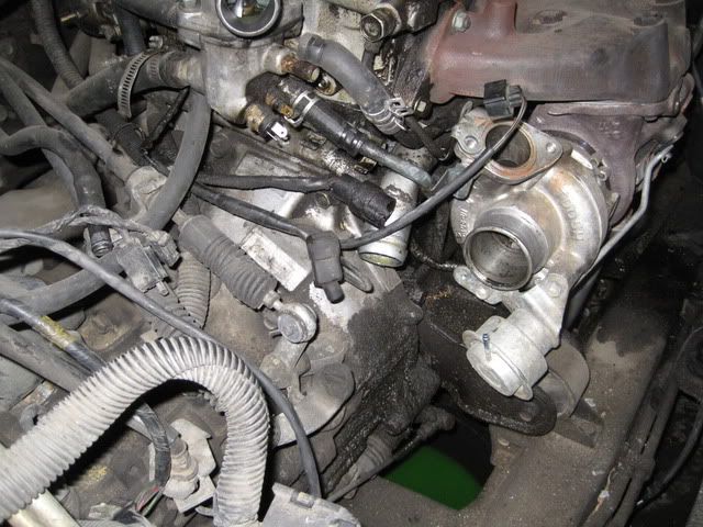

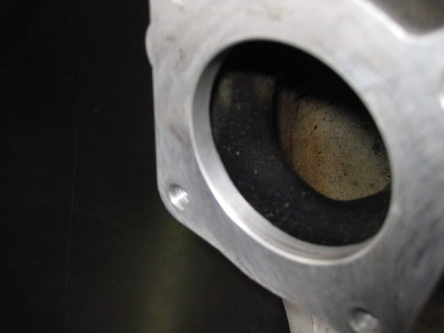

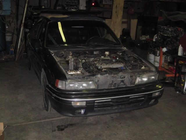

OK so its been awhile since i've updated this. I finally got to the point where I was able to park the car and start tearing it apart. Right now I will be putting in a stock 90 engine with 75k miles on it. I pulled the head and words can't explain how clean this engine is. While im rolling around on this 75k engine I will finish building the engine thats in the car now. Im in the mocking stages of this so I can make sure everything I chose is gonna fit.
Heres some pics of the before and the mess I have to deal with:

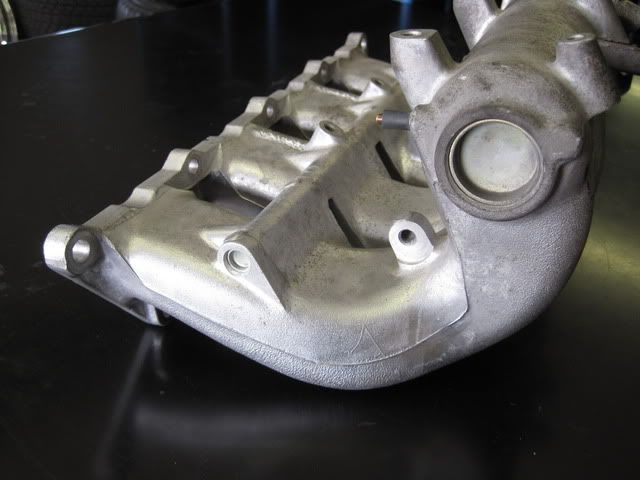

Heres the Good stuff:

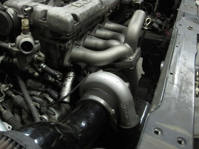

Erl Manifold With the PTE6262
Oil filter relocation with oil cooler
Very big Dsm front mount
