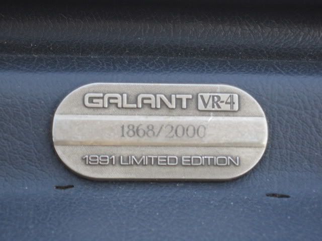

Good luck with the car and your goals. Send a PM to iceman69510 with your VIN and the badge number so he can update the records. Welcome to this community as well.

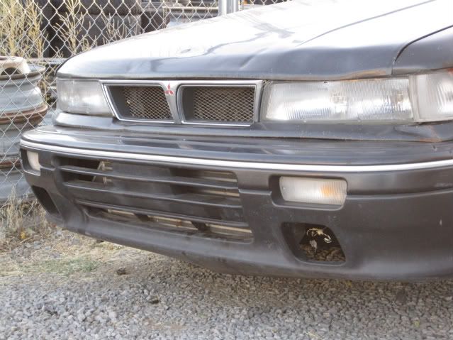

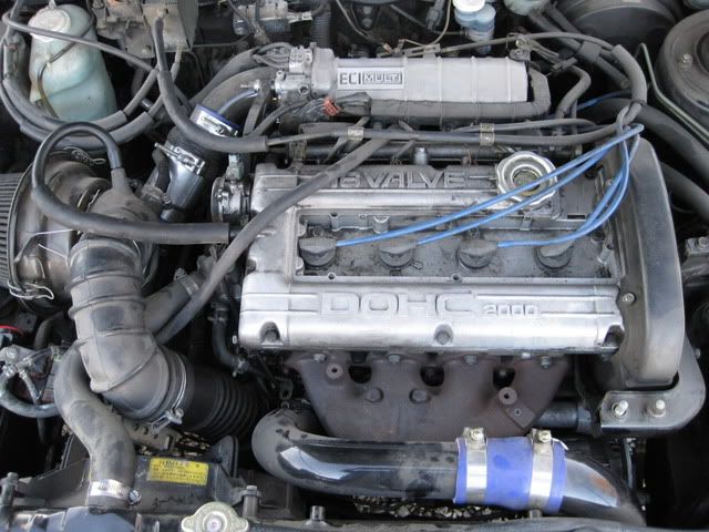

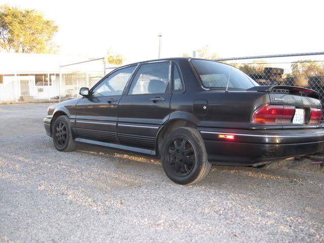

Thanks guys. The pics are up. This thing needs alot of work. I can see why though with the odometer clocking in at around 224,000. By the time im done the whole car will pretty much be like new.
