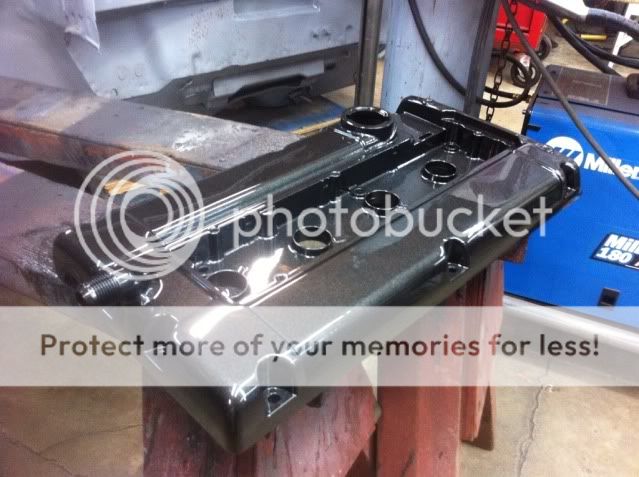

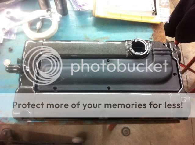

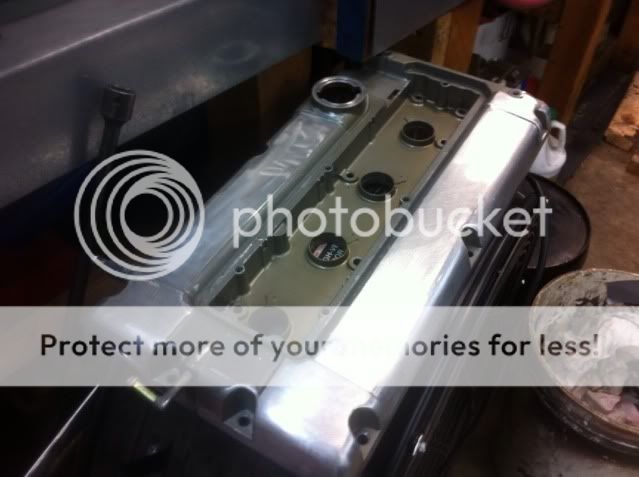

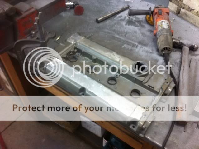

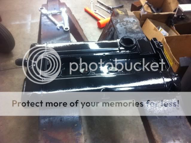

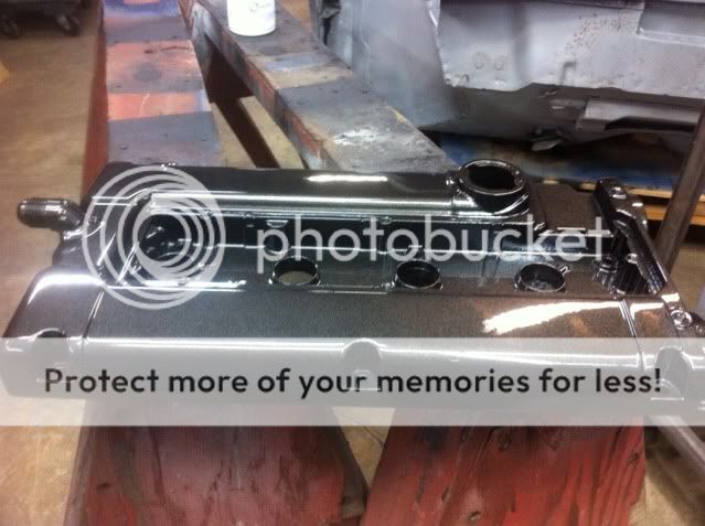

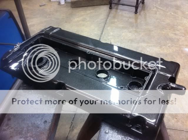

Shaved and painted the valve cover today. I also tig welded a -10 an fitting for the breather system.

Looking good. We have matching valve covers /ubbthreads/images/graemlins/cool.gif

I wish I had your fabrication skills. I've been following your work since day one, Noobsauce /ubbthreads/images/graemlins/tongue.gif

Thanks guys. I've picked up most of my skills from reading,trial and error and forums like this one. Only thing stopping anyone from doing this is being overwhelmed with the big picture. Break the project you want to take on into sections and it's much more manageable.;)
