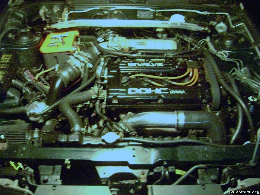

ALRIGHT!!!! Whoo hoo, I have power steering! I do have the buschur fmic installed on the galant. It took some time. I did alot of cutting to get it in there. THe front bumper support, shaved the radiator on passenger side, removed the lines for power steering that run up beside the A?C lines, cut a C on both sides to make room for the couplers. It was really not that bad just time consuming.

I have fabbed a lower intercooler pipe for the car. New ported hotside including exhaust port and area around flapper. 3 in o2 housing directly off the turbine housing with external dump. Also I now have my PLX wideband installed. Will post pictures soon. Time to get a better time. /ubbthreads/images/graemlins/devil.gif

Well it pretty much rained all day but it slack off to none this evening. I have posted a picture of the new lower intercooler pipe I had to fab up. The picture quality sucks sorry. its dark.
