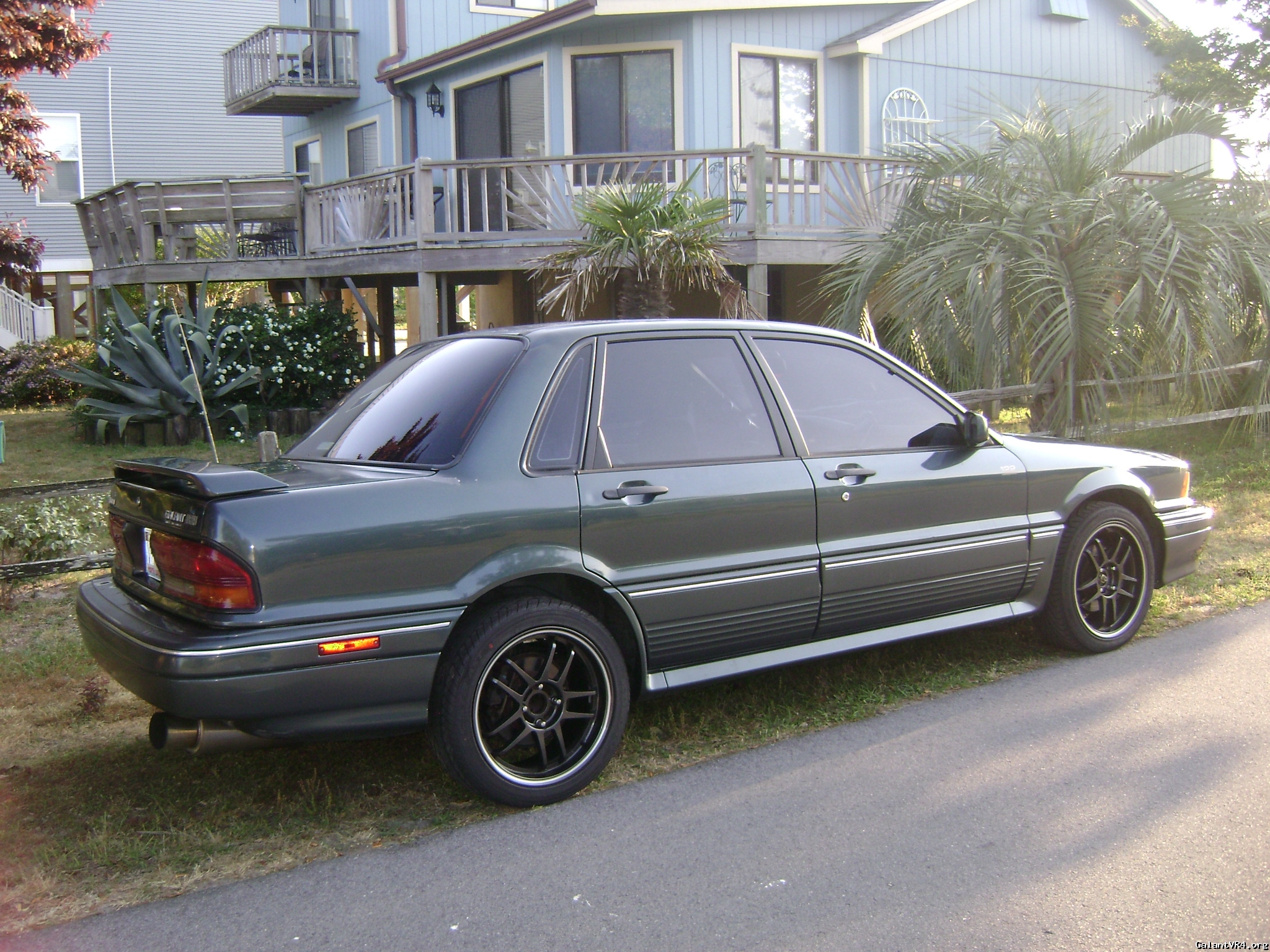

car looks excellent, throw some springs on there and it will look even better. Great job getting it running again, we are all glad you didn't give up /ubbthreads/images/graemlins/applause.gif
The tint is 5% and its dark. I look to get some springs for it also. What would you guys recommend. I have been reading about Evo8/9 springs lowers it just enough, yet some reaise the car due to if its an MR or not. Thanks for the support.

Your car looks good though, congrats on getting her running.

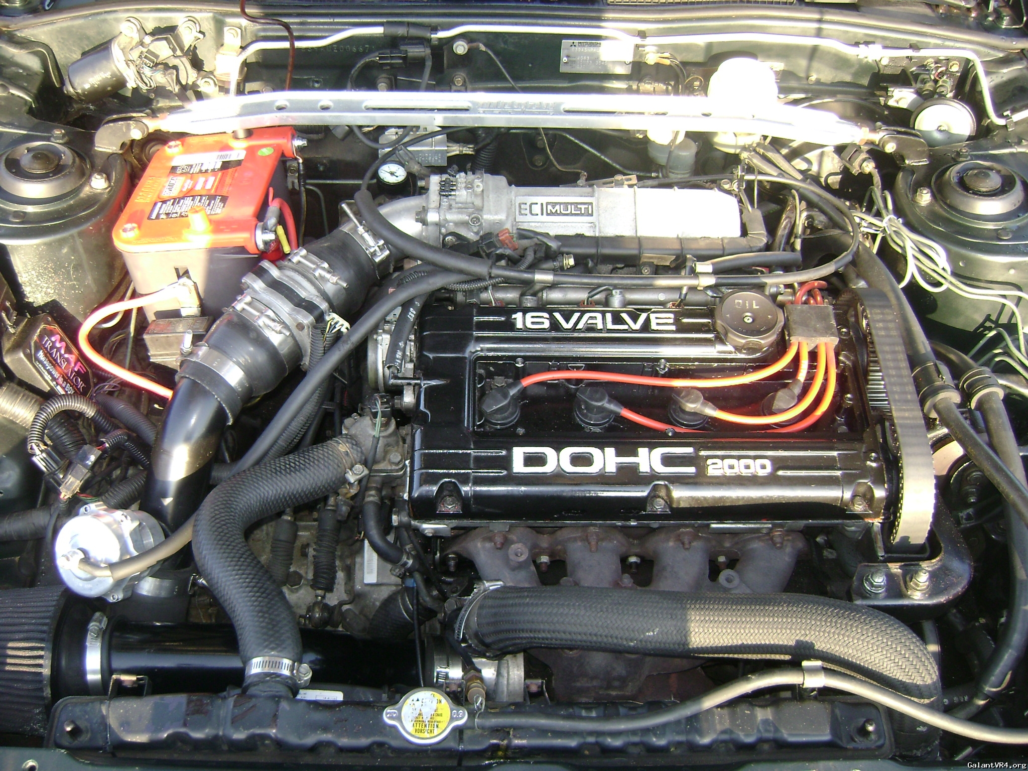

Hey Wendy, where did you end up mounting the wiper fluid reservoir? My battery is in the same spot and I need to find somewhere else to put the reservoir. It looks like its down on the firewall behind/below the battery?

Yes, the washer resevior is under the battery. I must say I have spent all day with this 4WS delete. I had to run to several stores that carry M14 X 1.5 thread pitch. I finally found some at a hardware store yet they were way too long. Broke out the dremel and cut them to lenth. BTW, no one around here carries AN fittings so I could cap the lines on the steering rack. I used Quick steel, this stuff is awesome. It is a pure pain in the A** to get to those 2 places on the rack to put the bolts in!!! /ubbthreads/images/graemlins/banghead.gif I wouldnt do that again if someone paid me. Quick steel is curing overnight. I will give you prognosis in the morning if I have power steering again. Fingers crossed. To all my VR4 friends. Good night

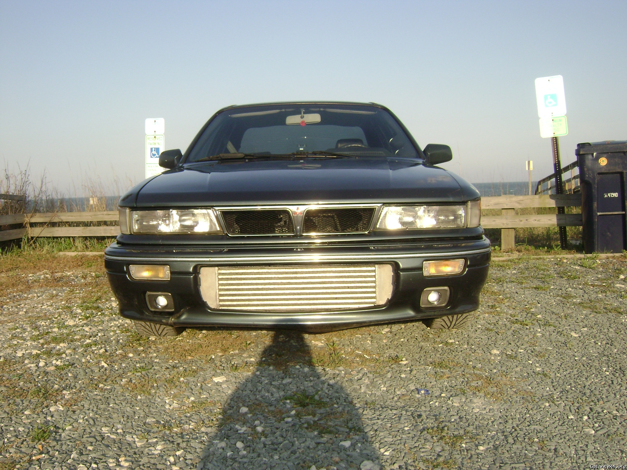

Is that the Buschur FMIC in the front there? If so, how easy was it to install?
