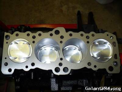

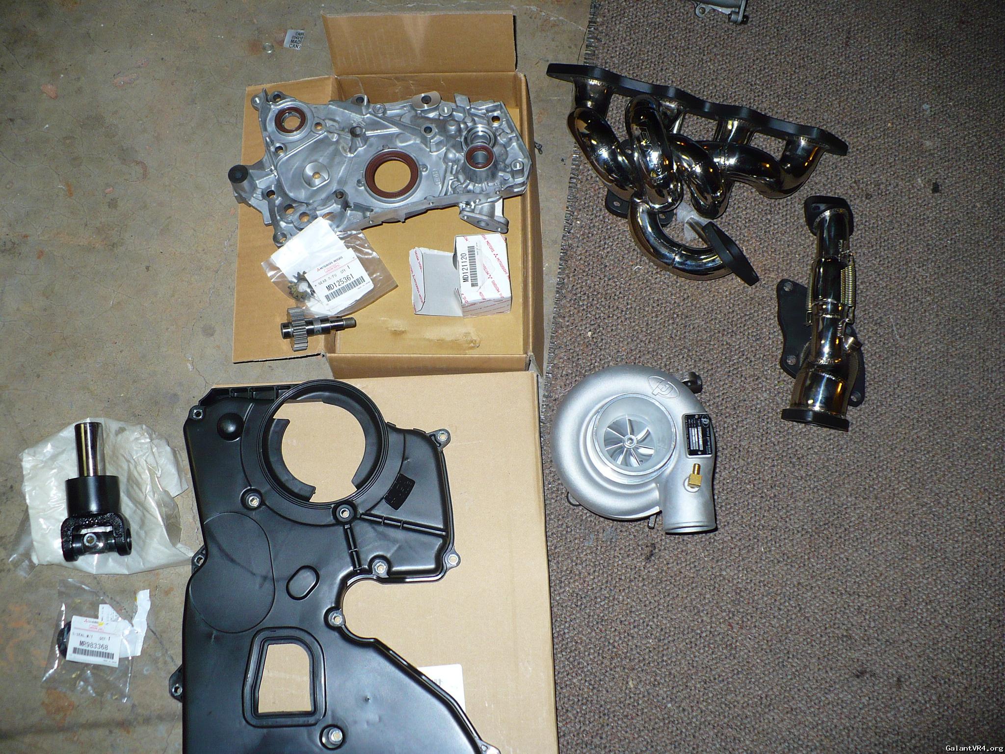

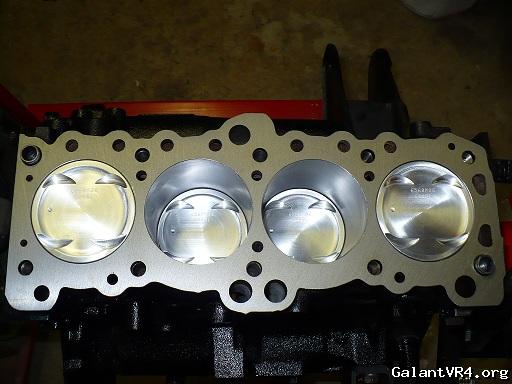

So I'm not happy with this 7Bolt Evo8 piston combo. Its never been right since a piston got destroyed in it. I bit the Bullet and ordered all NEW parts for my 6 Bolt Build. I'll post pics as it gets assembled.
So far I got The Block built, Wesico 9.0:1 and Eagle rods. I Pulled the 7 bolt out today since I was snowed in from work. Pic below (say goodbye to the 20G)
Waiting on UPS to bring the rest of my goodies (oil pump, turbo)

6Bolt block .40 over w/Arp mains
Wesico Pistons 9.0:1
Eagle H-beams rods
Cometic 1.6mm Headgasket

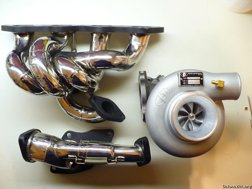

DNP Manifold w/matching O2 housing
FP Green Turbo

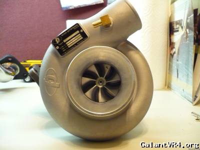

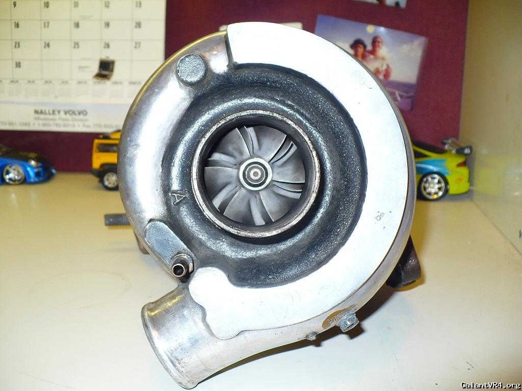

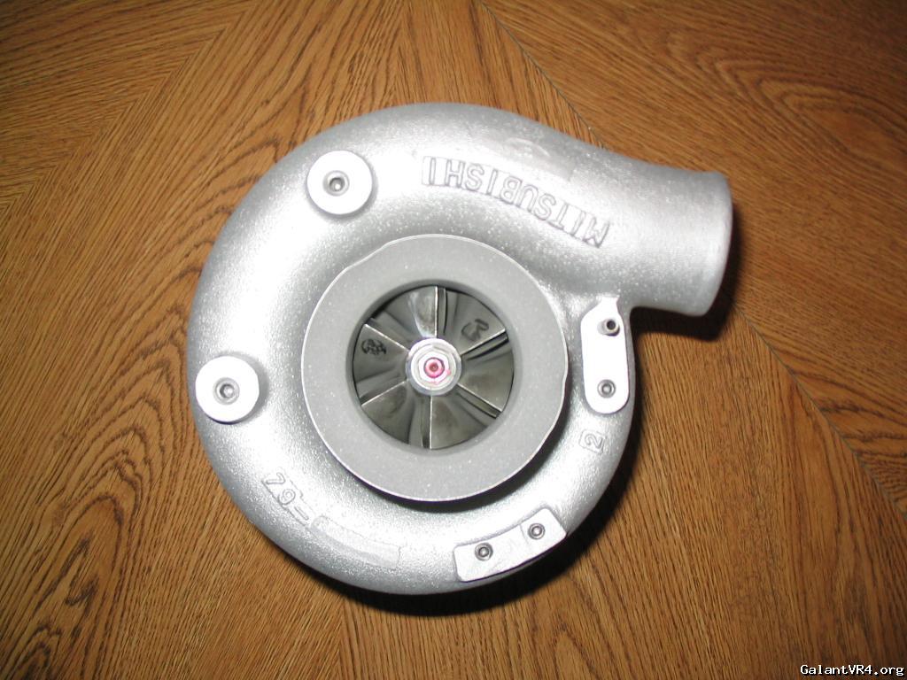

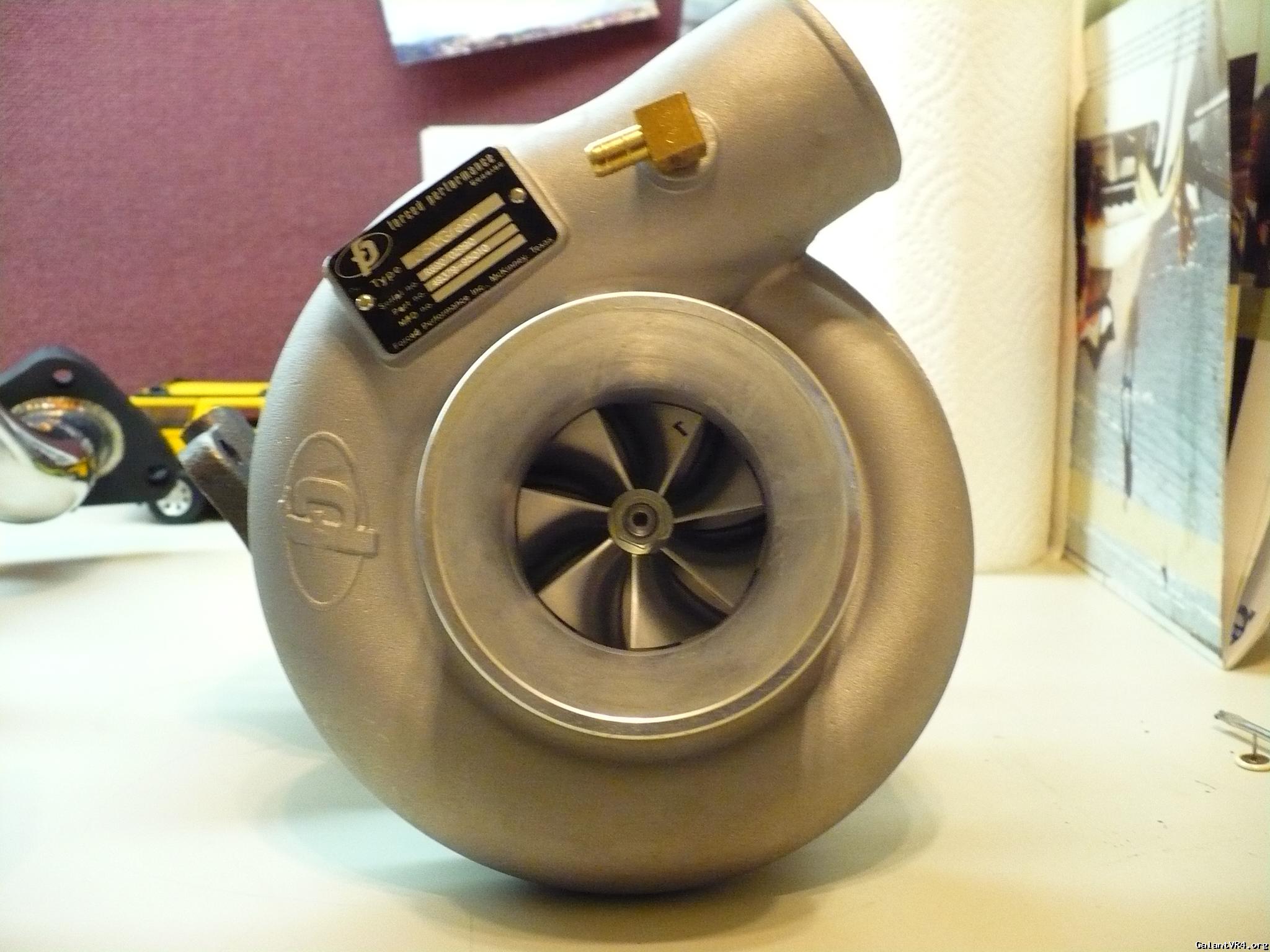

They must have changed the green a bit. My old one used a six blade compressor wheel. Is that an HTA version or something?

found this on FP Green
- The Green turbo is a Mitsubishi/Garrett hybrid, with a compressor flow of 730cfm, and around 500hp. The turbine wheel is the larger TD06H rather than the TD06. Testing showed no increase in response using the TD06 in place of the TD06H and the smaller TW only reduced overall turbine flow. We pioneered the Mitsu/Garrett hybrid design to make use of the bolt on convenience of the Mitsubishi housings, and the super efficiency of the Garrett compressor wheel. We modified the Mitsubishi bearing housing to include our exclusive Monster thrust bearing which isn't going to be found in cheap immitations. The Green utilizes a modified TD06 compressor housing with a 3 inch inlet. The outlet faces down, and thus the Green bolts up just like a standard 20G turbo.
11,983

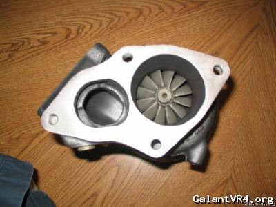

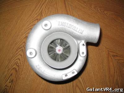

That's what it said back when I owned mine as well. It was always a TD06h turbine wheel and a 50trim compressor wheel. Your compressor wheel is different though. /ubbthreads/images/graemlins/dunno.gif
My old FPgreen from back in '03:
onesickcrx
Jun 3, 2007
1,076
NY
Looks like a HTA wheel.... /ubbthreads/images/graemlins/grin.gif

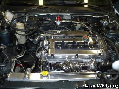

Quoting Vman911:

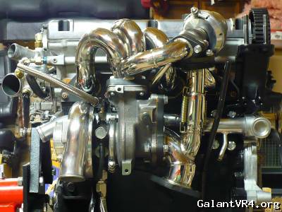

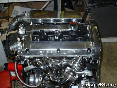

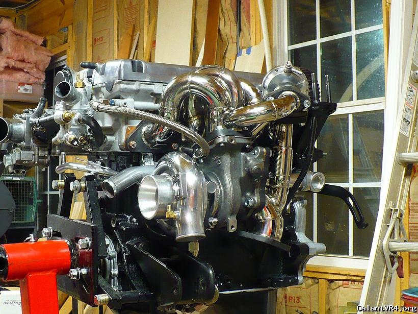

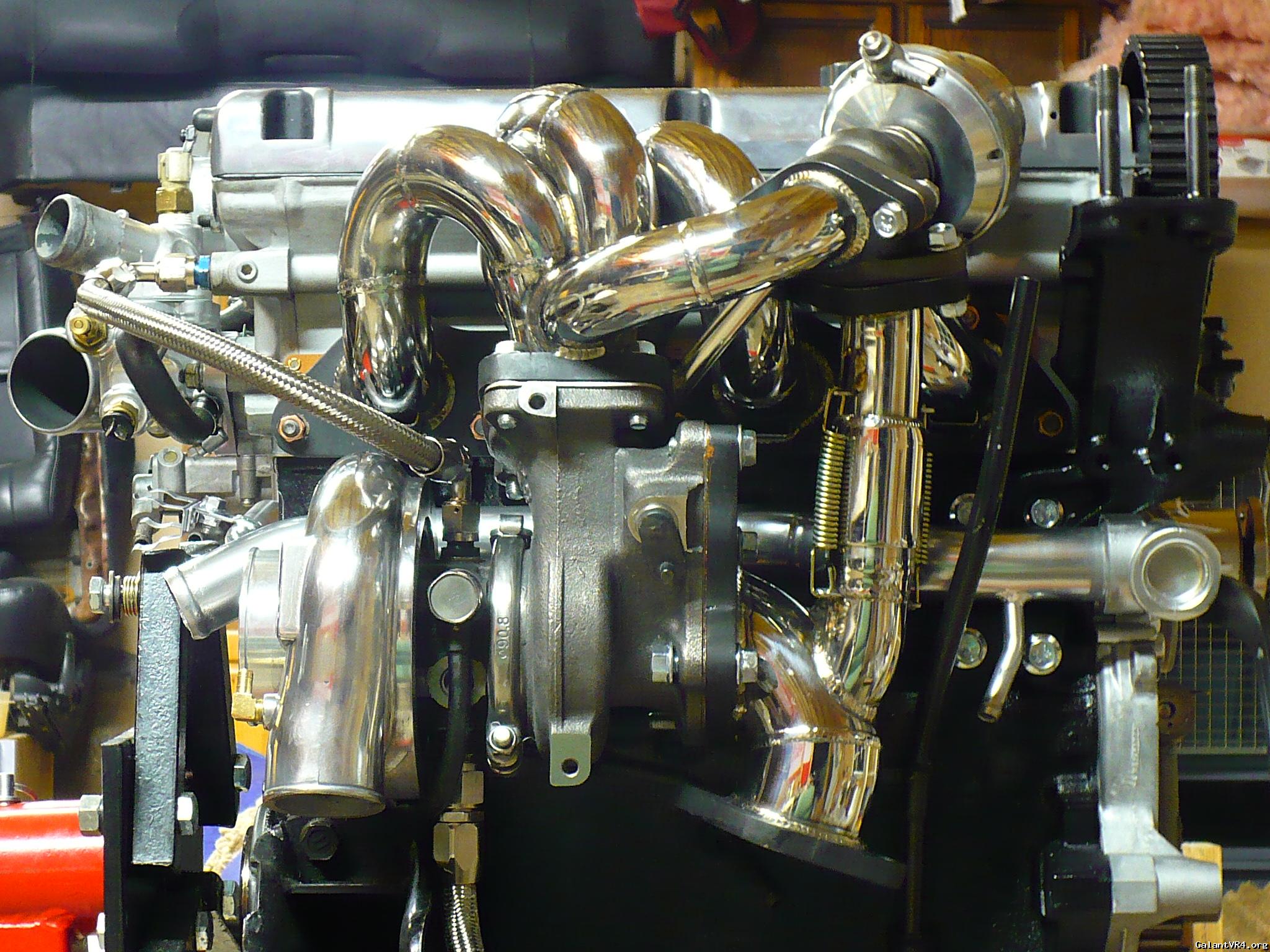

Got the FP green Polished and Installed on motor...
Holy oil feed line batman!! Any particular reason you chose to do a -6 as opposed to the usual -4?

I have always used 6an lines on journal bearing turbo's. 8an return line. Here's my 20G turbo. The FP defiently has a bigger wheel.

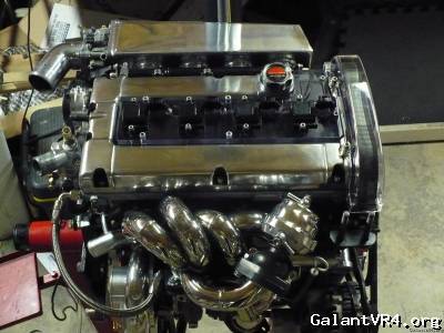

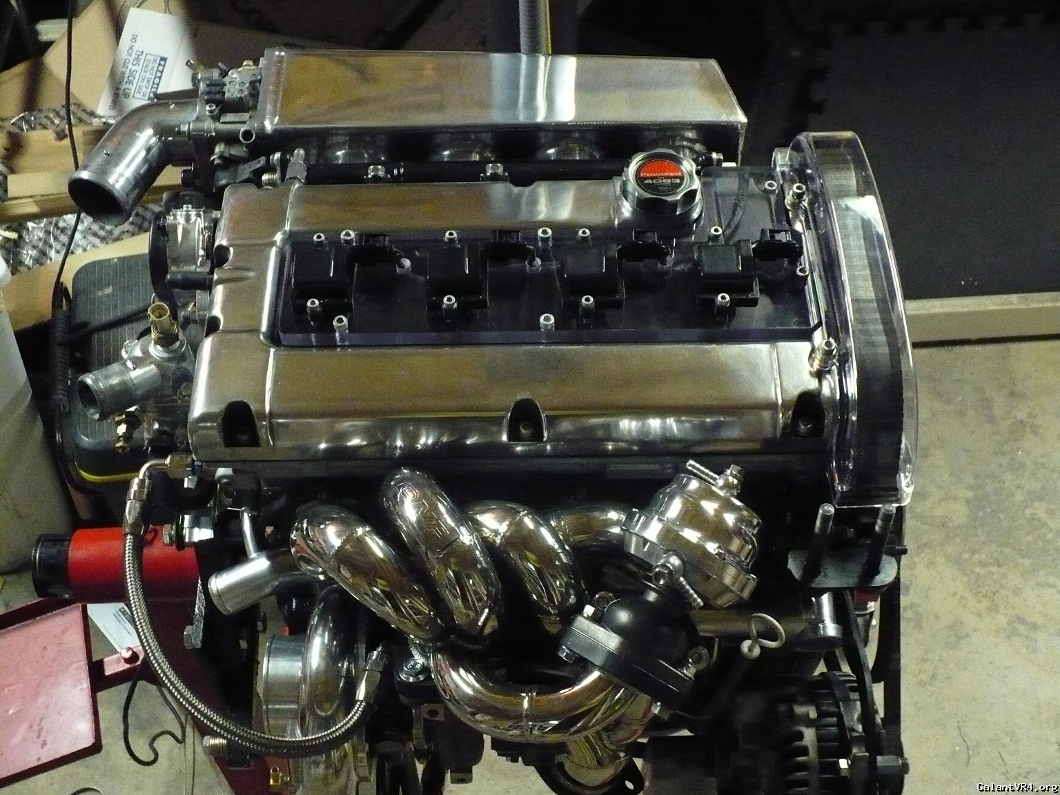

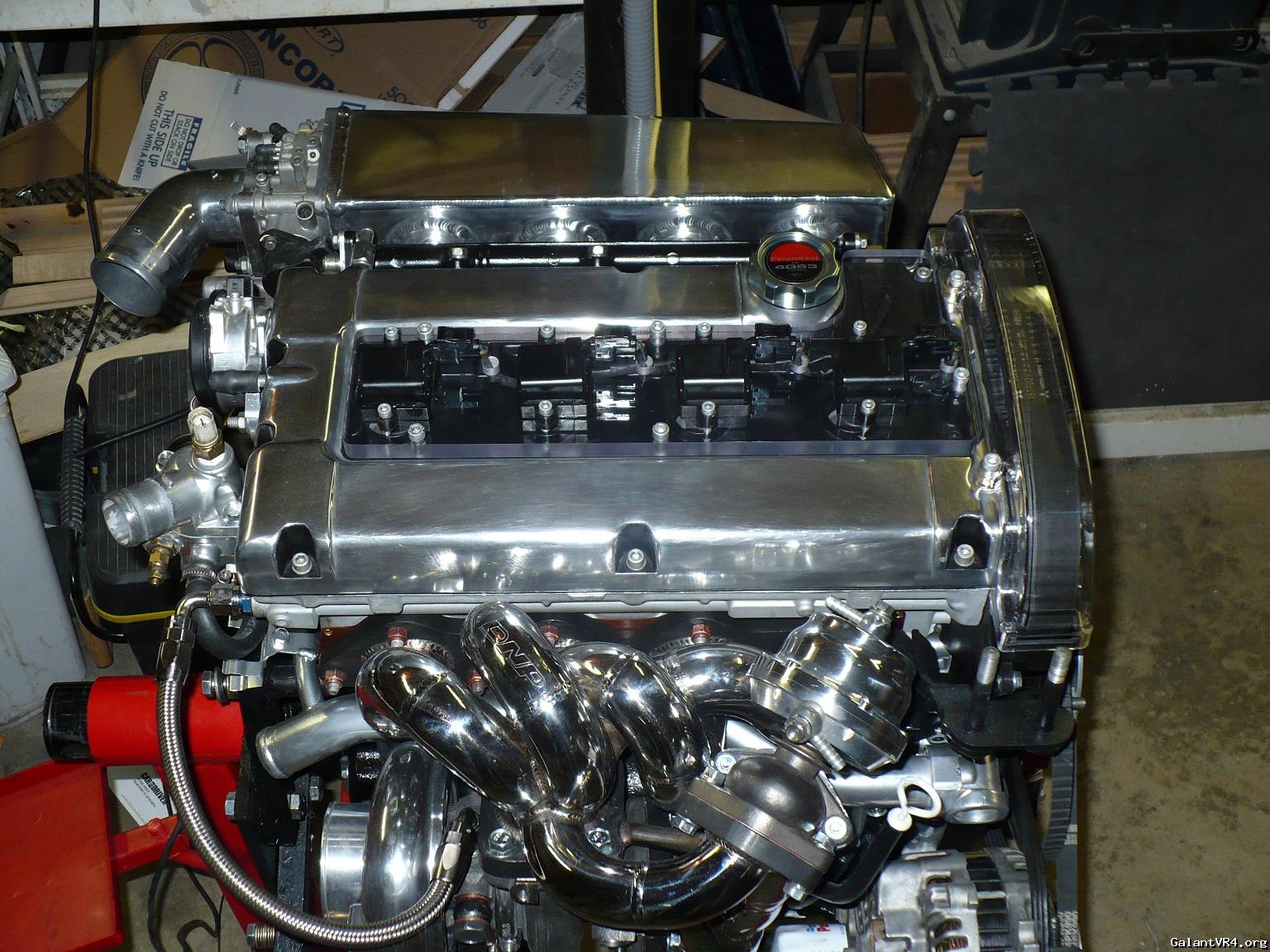

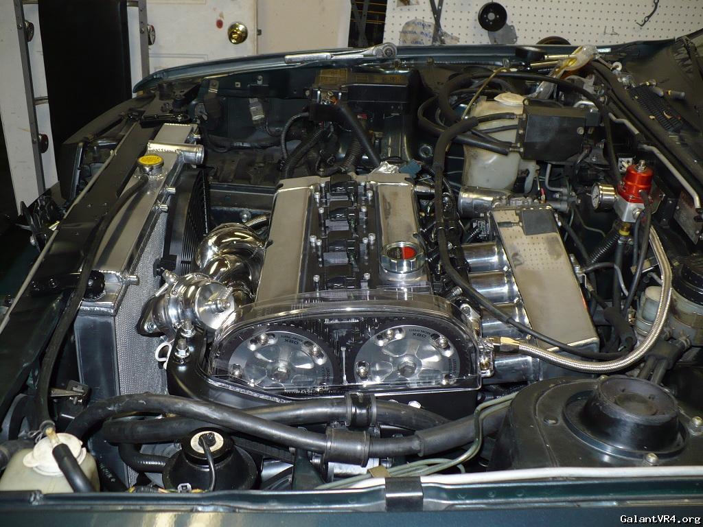

I had a friend polish the valve cover for me. I did recut a new COP plate (in pic) 1/2" lexan. My other had a couple cracks where I tightened it down to much.
I almost want to put it in my living room for awhile. I hate to see it get dirty.

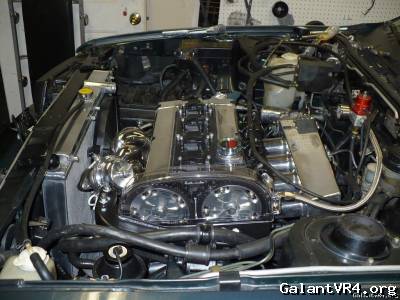

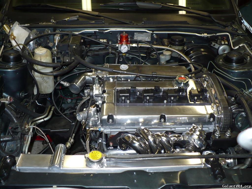

Just curious, is that a VR-4 spec radiator, and what brand is it??
Looks very nice with all that bling bling in the engine compartment! /ubbthreads/images/graemlins/smile.gif
Vman911
Sep 18, 2005
359
Douglas county, Ga
that is a ebay alumniunm rad for the 89-92 galant vr4. Came from china. Doesn't fit right with out modifing the brackets on top and bottom. Sensor hole is too small also had to retap it bigger.
