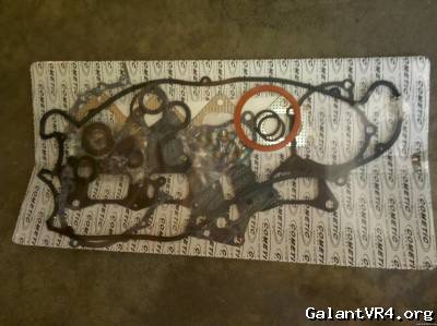

Avid 75dd Motor mounts

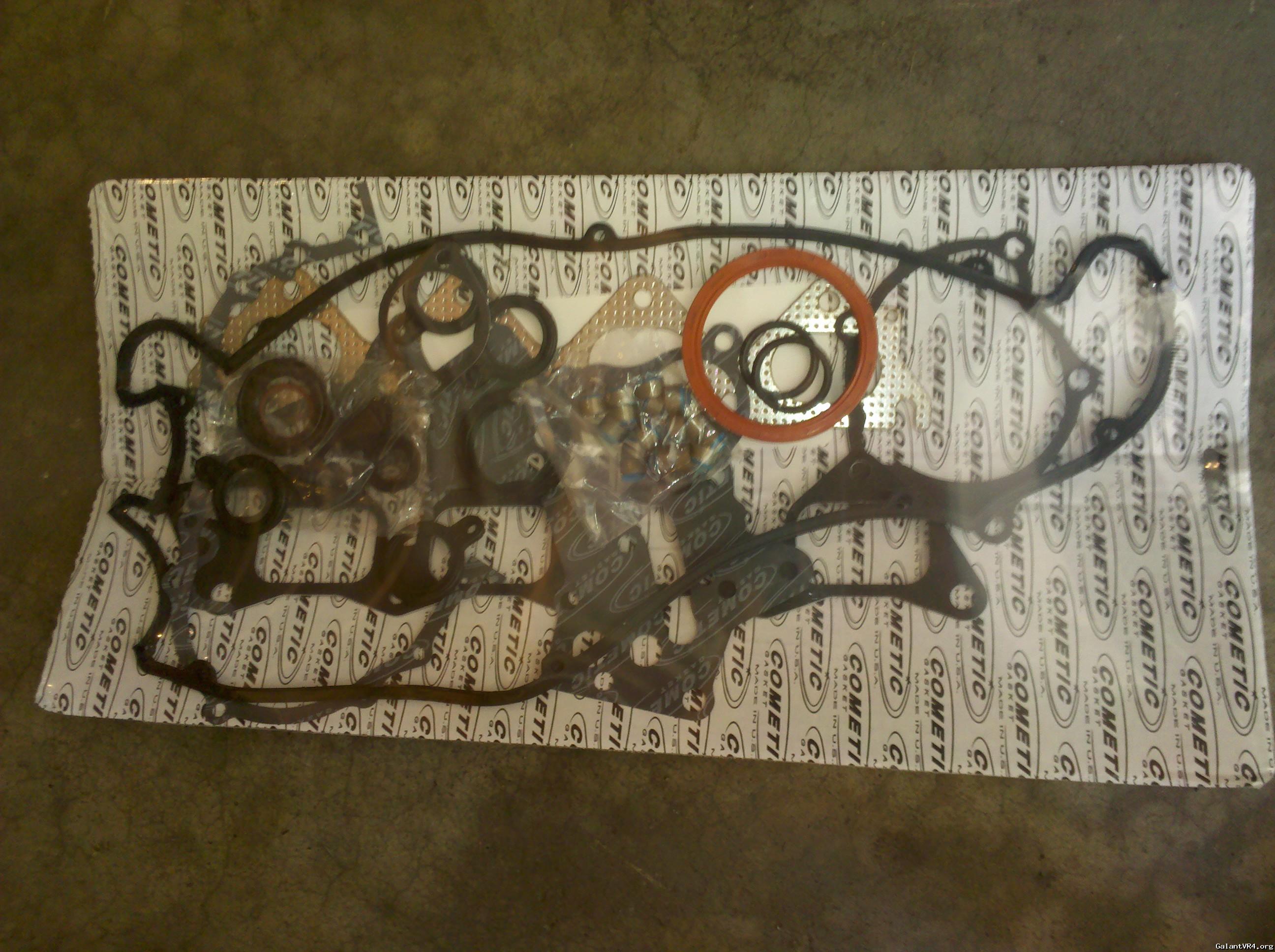

Cometic full gasket kit

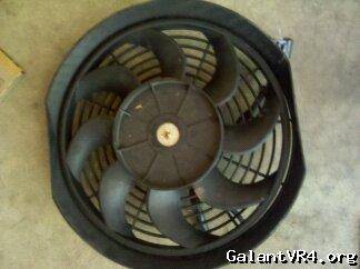

Slim fans from Punishment Racing (have a pair)

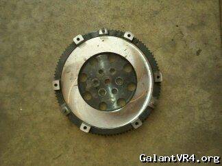

A.C.T. street lite flywheel (used obviously, traded a set of DSM pedals for it)

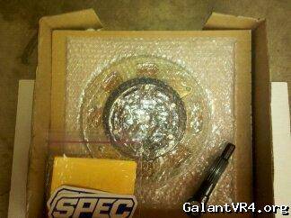

SPEC Stage 2 clutch disc

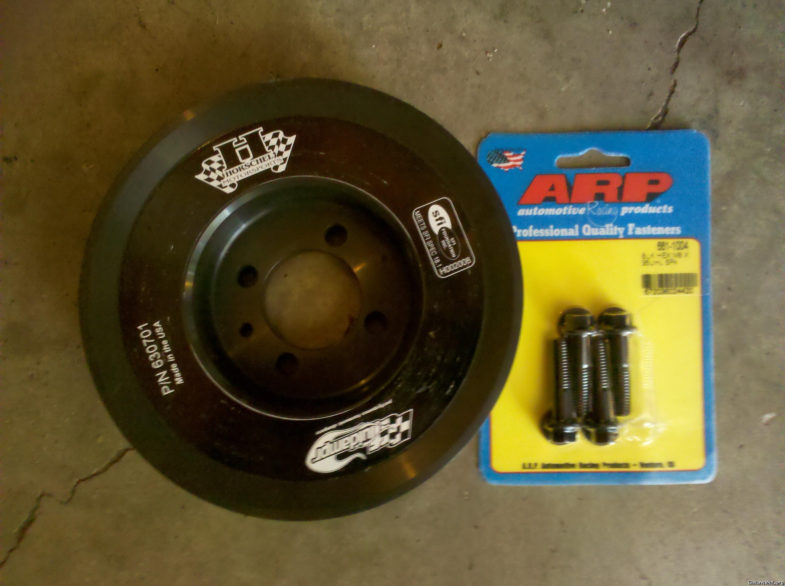

Fluidampr Pulley with ARP small bolts and main bolt

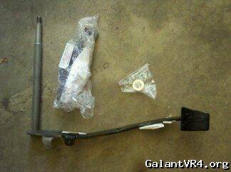

Clutch Pedal rebuild kit with brass bushing

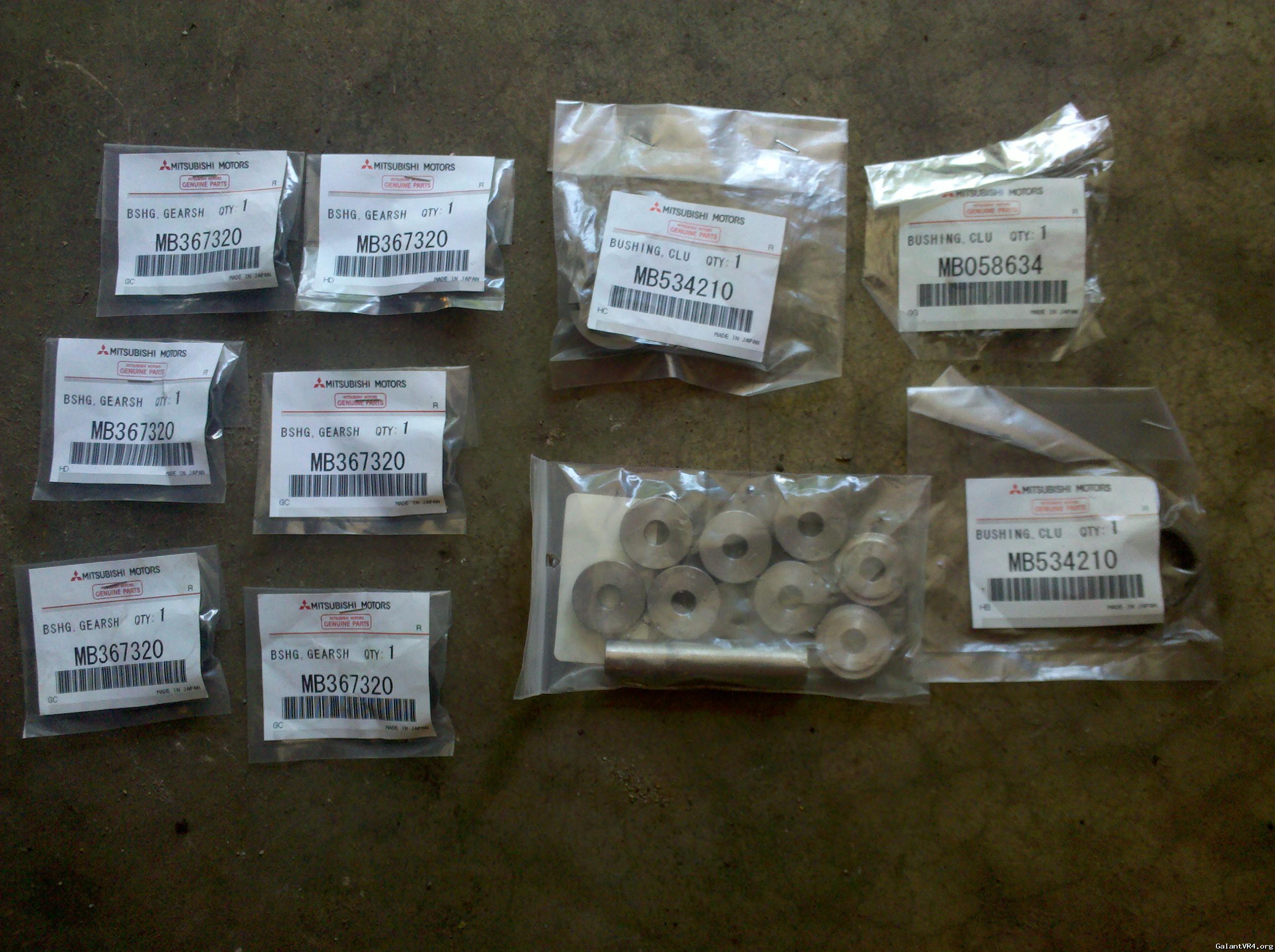

Symborksi shift kit w/ OEM shift lever bushings

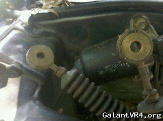

Brass shifter cable bushings (parts car freebie)

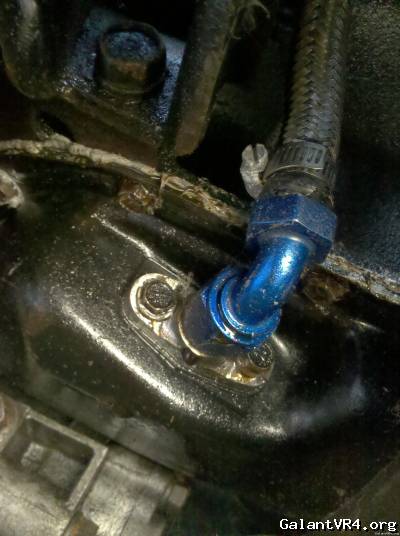

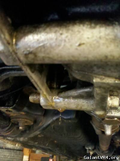

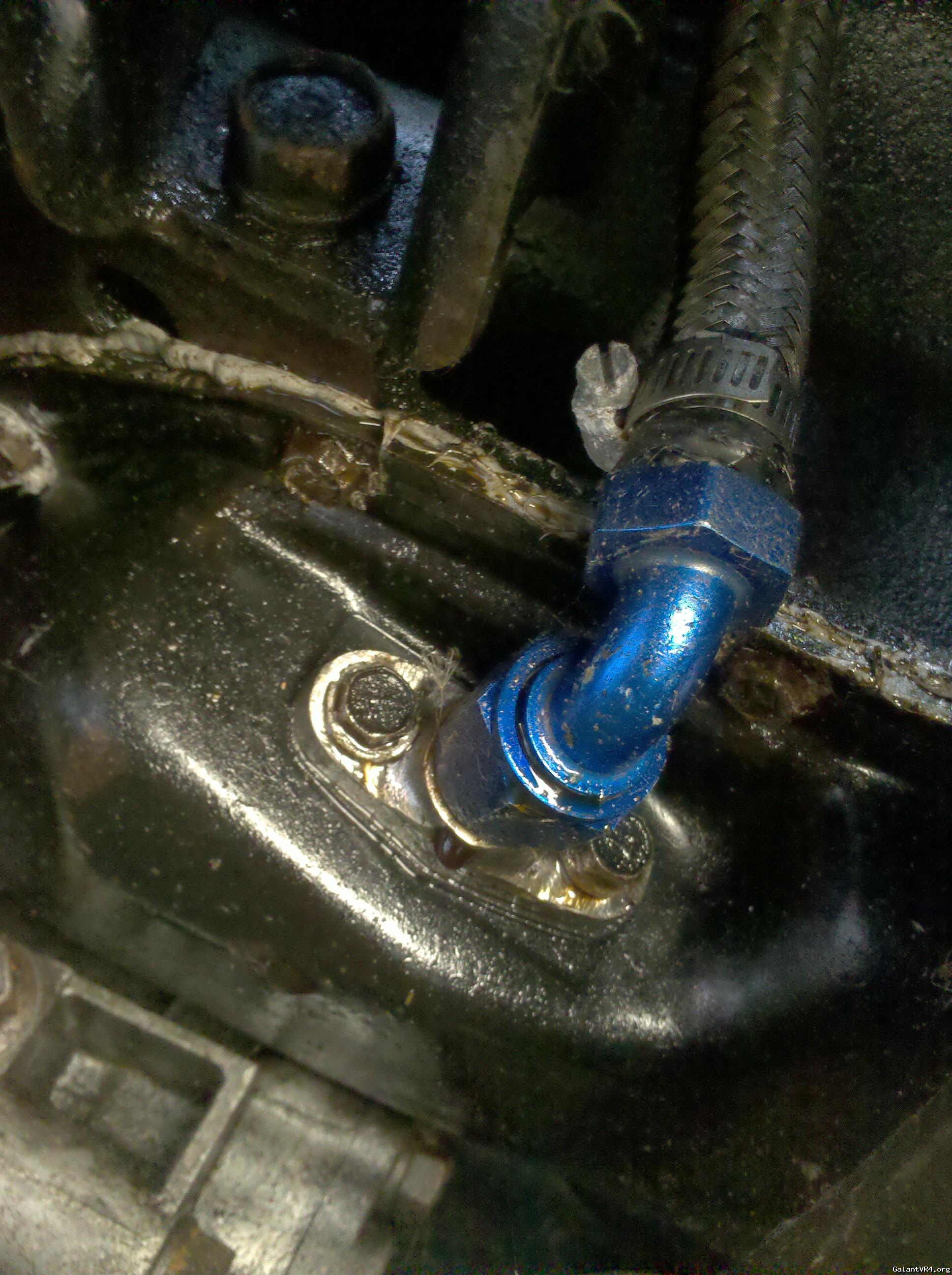

Some fun finds of DSM-esque junk during my day

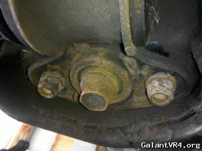

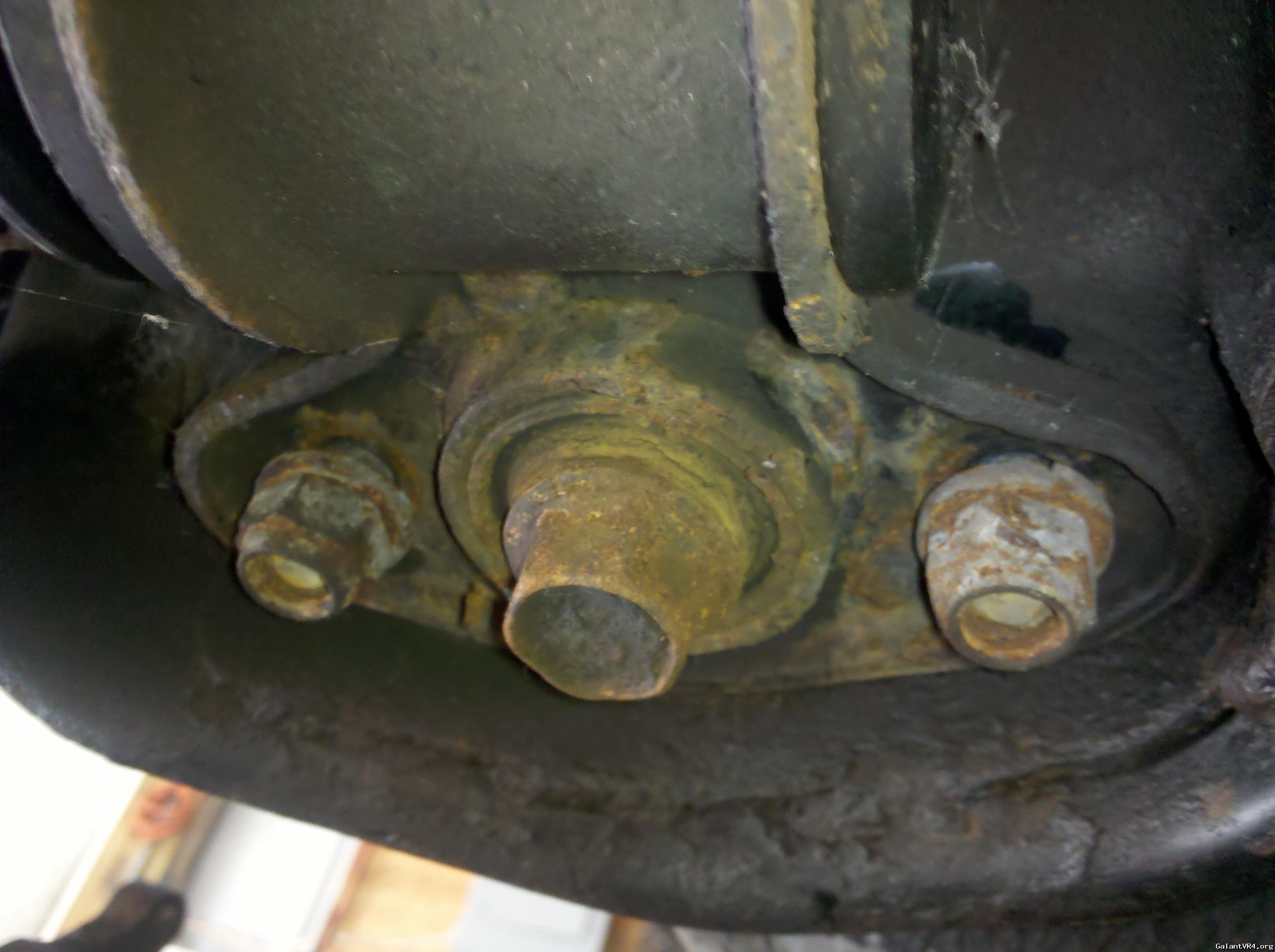

Not all of the control arm bolts were tightened when a P.O. installed new ones
Hose clamps on AN line???

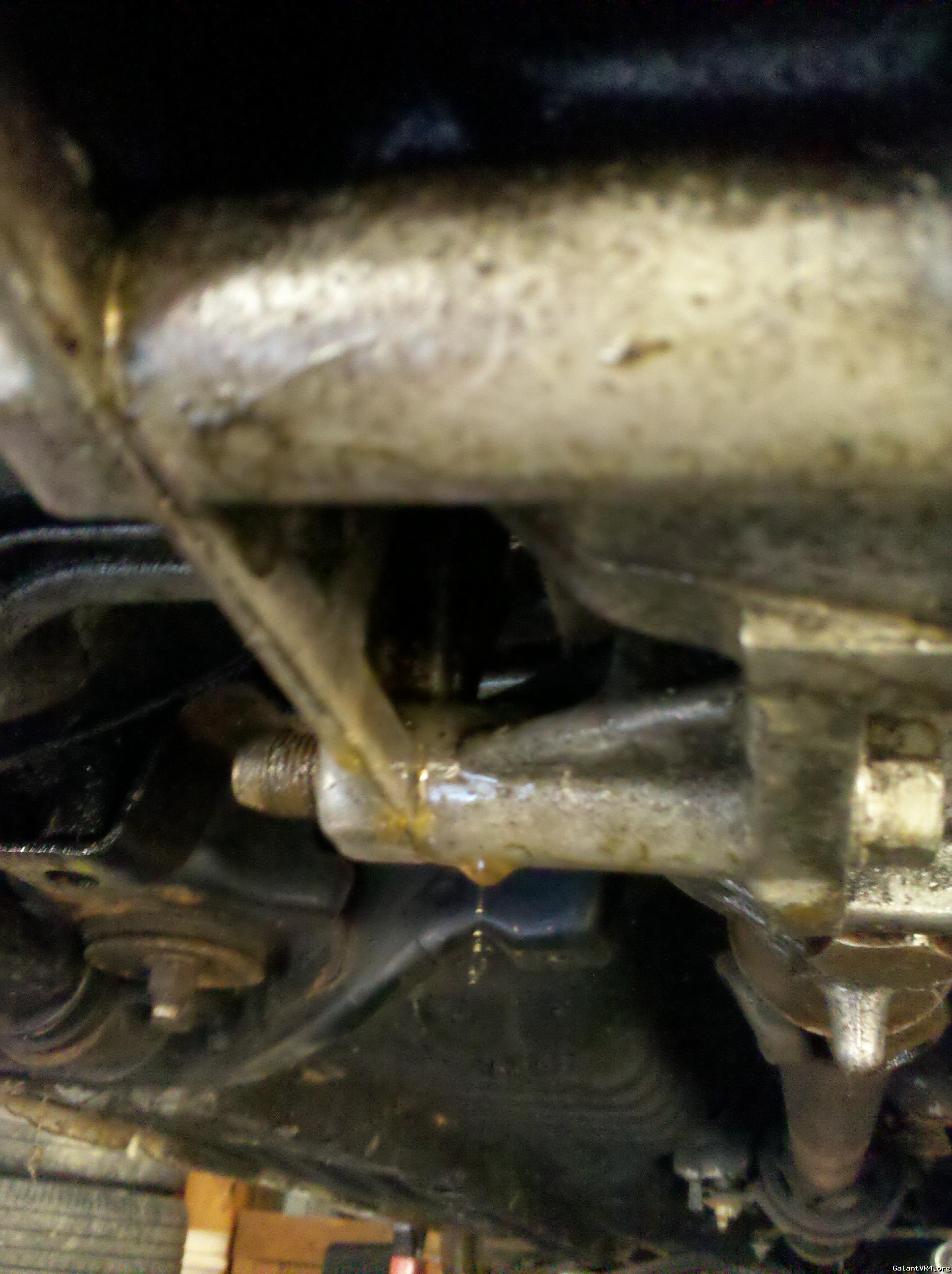

Huge T-case leak, found out 4/5 bolts were installed

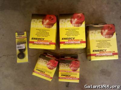

Some more goodies

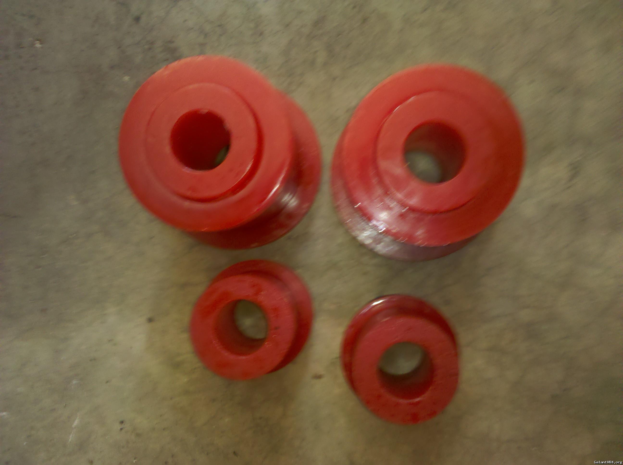

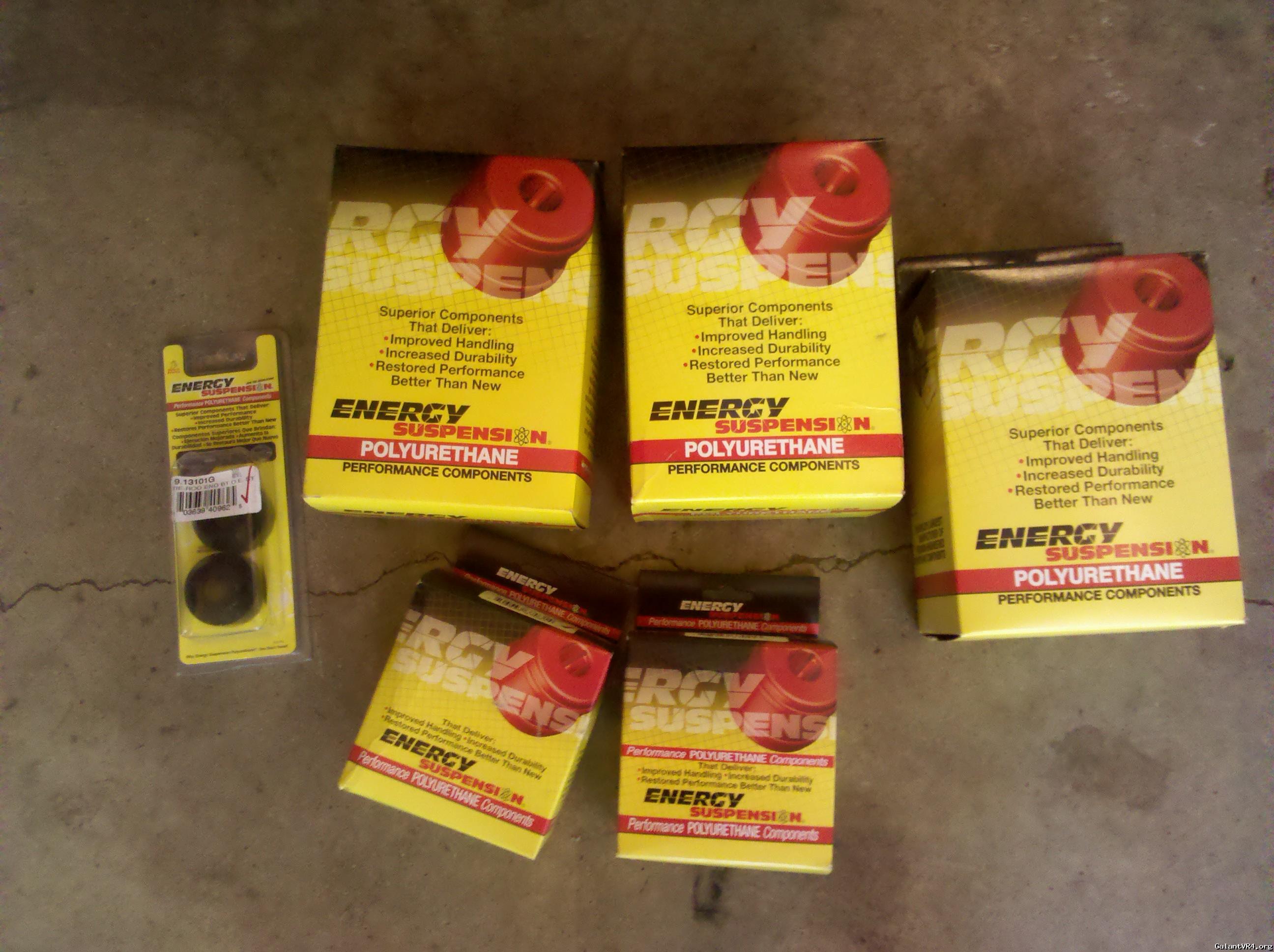

Energy Suspension Master 1G bushing kit

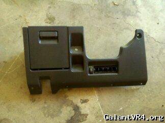

89 Underdash (parts car freebie)

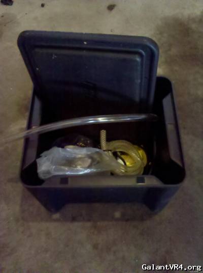

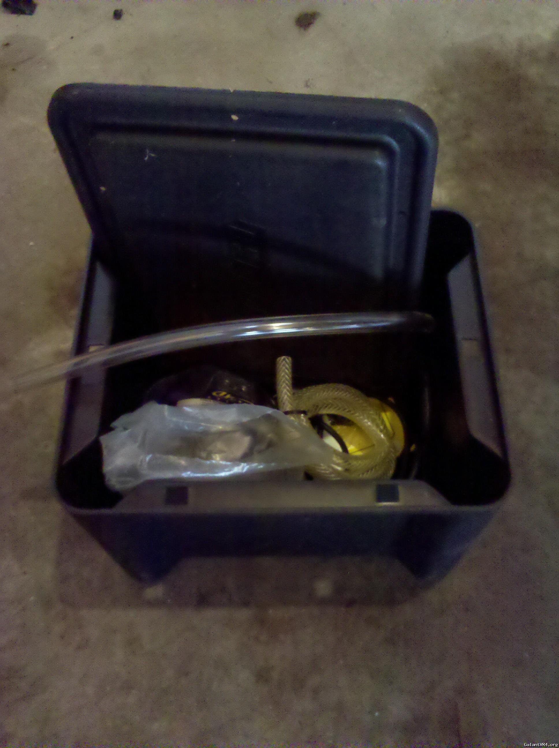

Moroso Battery box. 10ga wire, distribution block, inline fuse, etc.

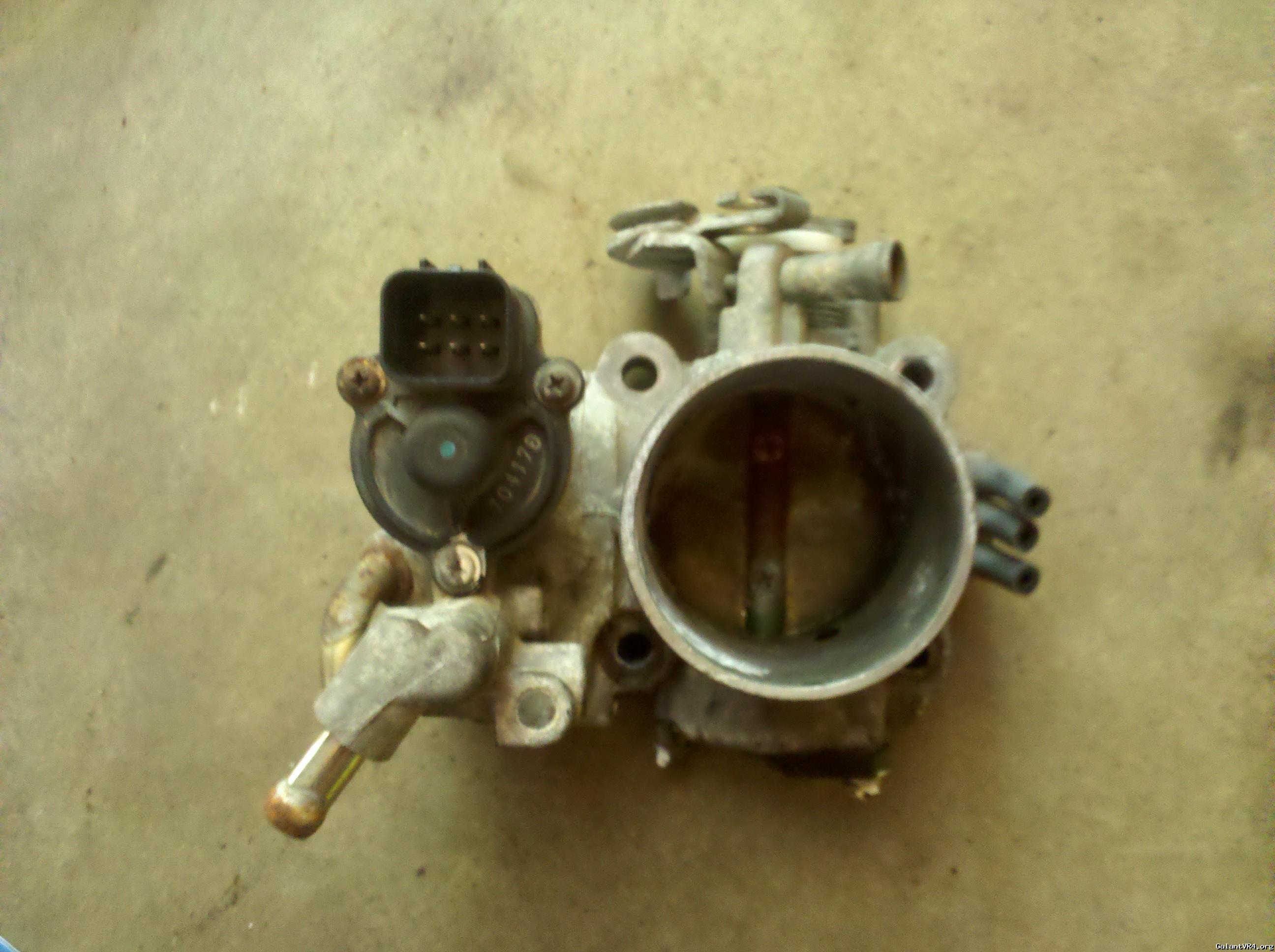

1G NT throttle body (waiting to be sent to TBs.com)

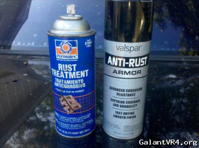

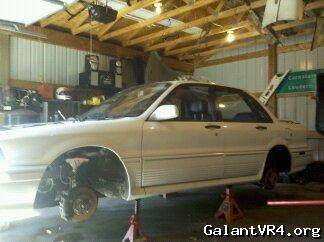

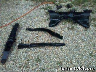

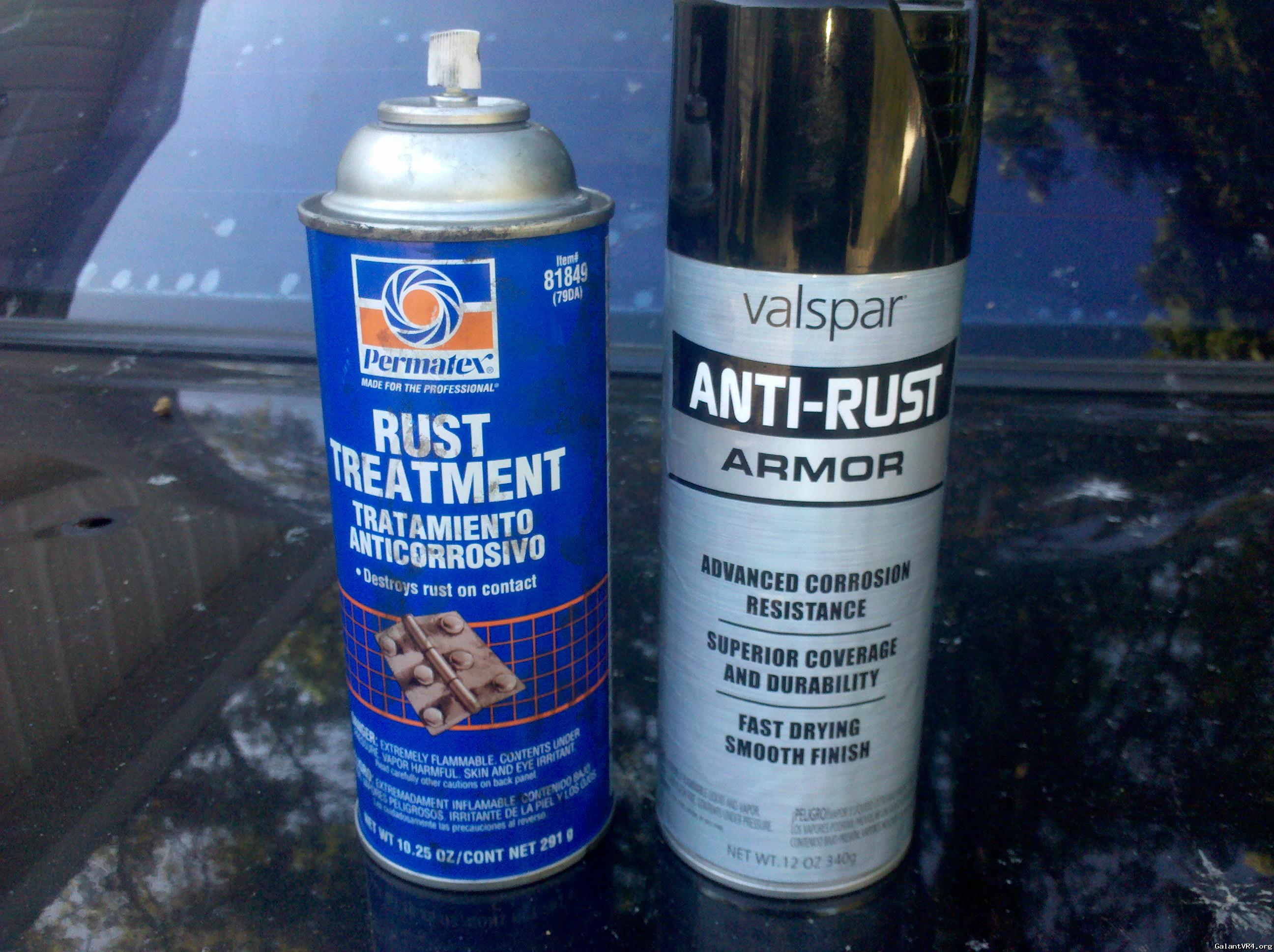

The front is totally disassembled, so I can do the bushings. I went the cheap route since I'm short on time, and just used some rust treatment and rattle canned everything.
After the rust treatment, I have to wait 24 hours until I can paint. The 5 lug hubs are sandblasted and ready to go. I'm not doing the control arms or steering rack, as I replaced both of them with new parts.

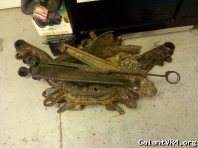

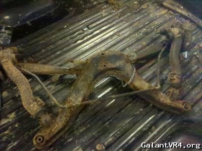

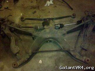

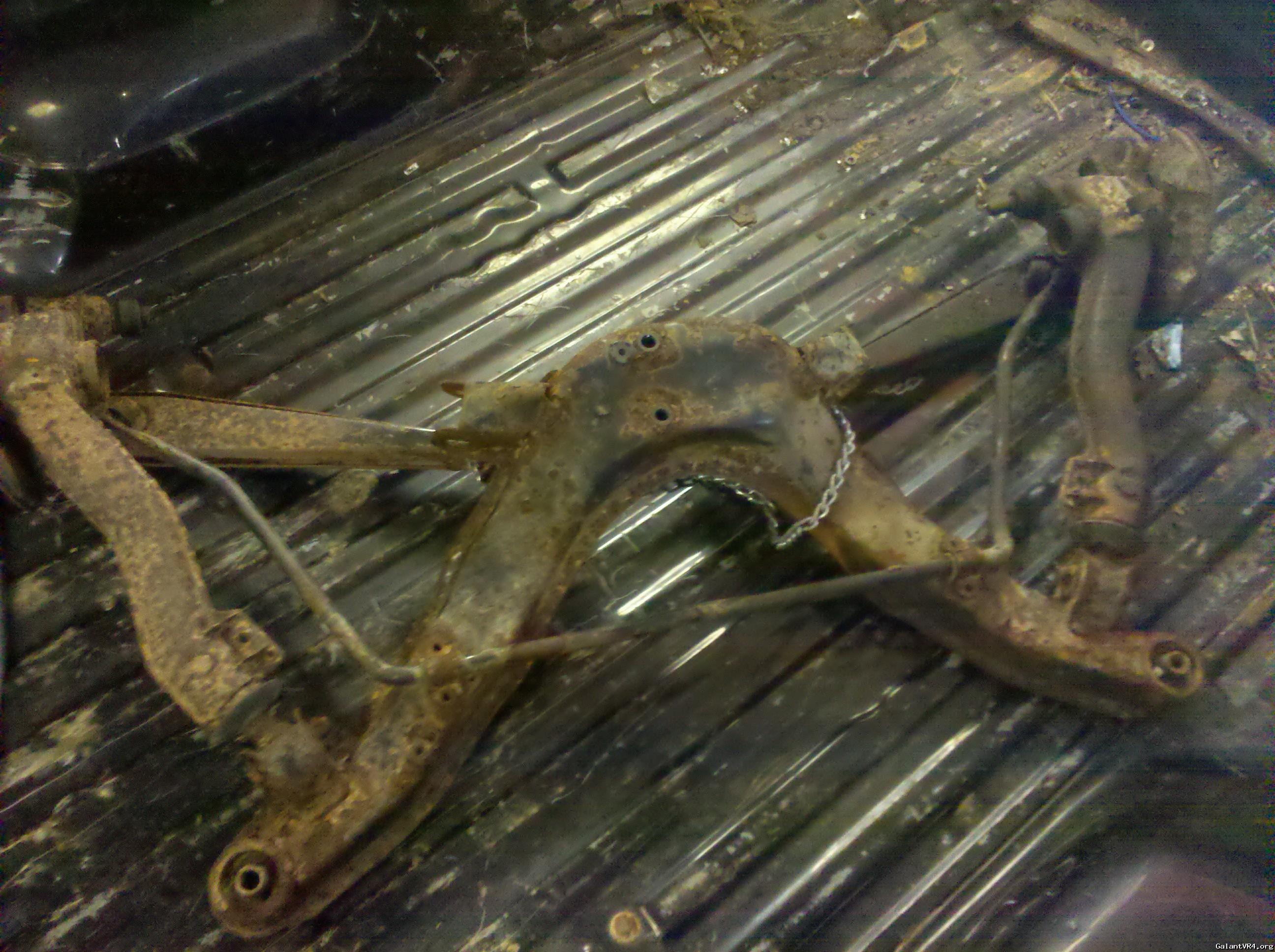

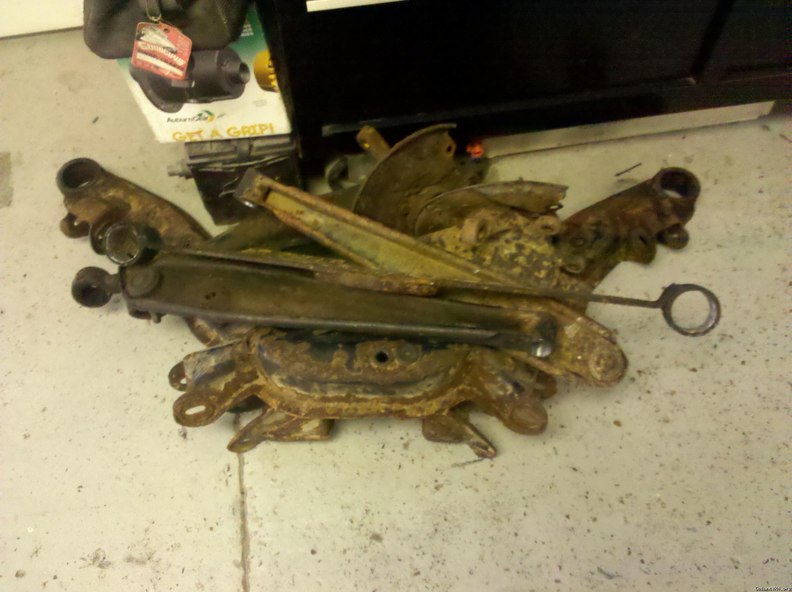

I am using a full DSM rear subframe and suspension when I do my 4 bolt swap, to get rid of the rear steering rack. Here it is in my truck on the way to the shop. Mmmmm... rusty
All broken down, and the bushing removed and holes cleaned up

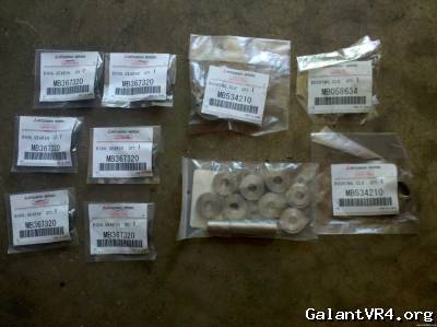

And some more random goodies have shown up. I'm only waiting on my order from JNZ still. Anyways

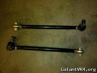

3SX adjustable rear arms

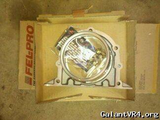

New OEM rear main seal and housing

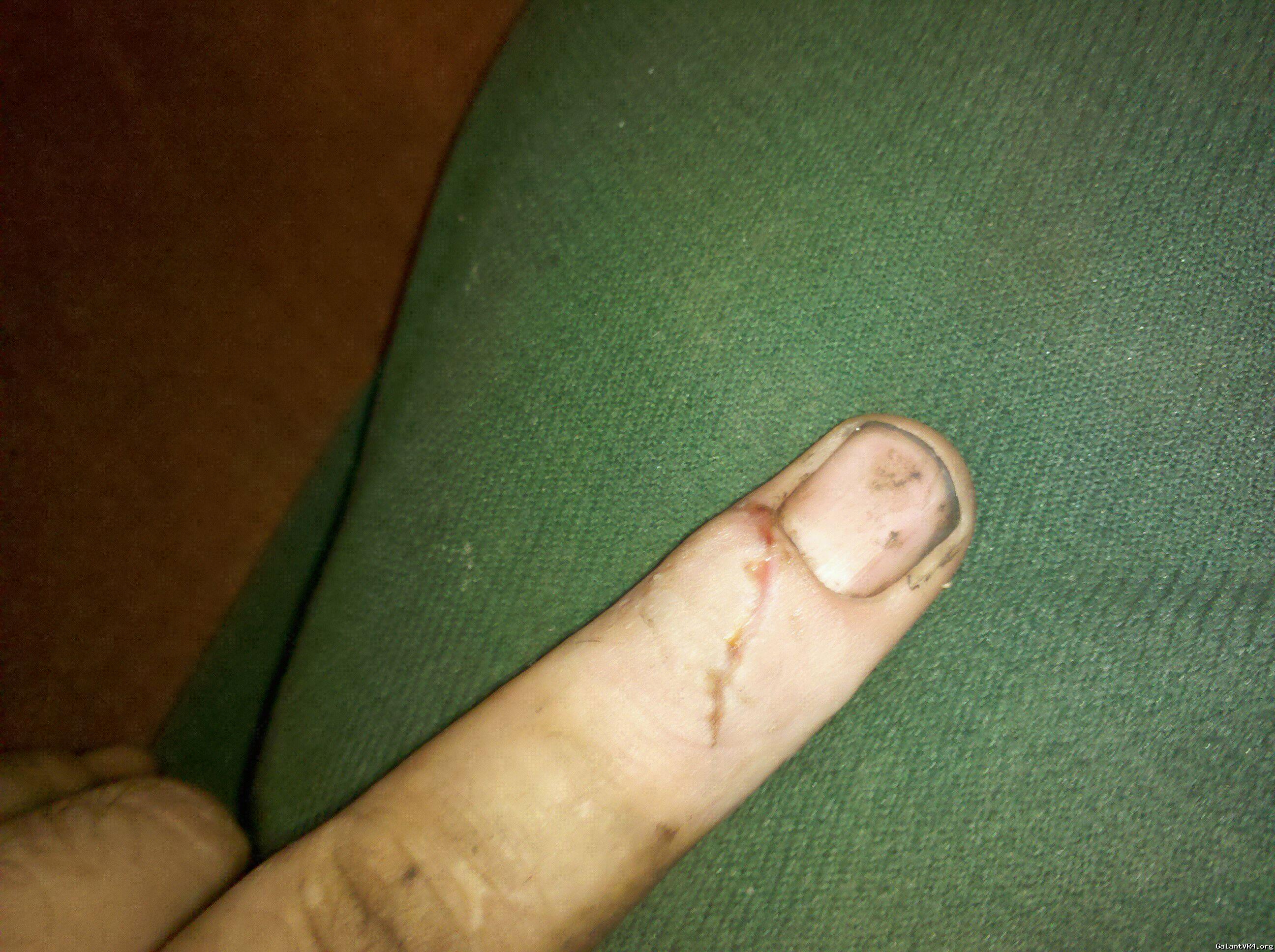

My lesson for the week, be careful with razor blades. My second lesson of the week, super glue works great on clean cuts

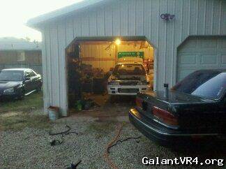

So in my mad rush to get the car to the Shootout, I didn't get to take as many pics and update this thread as much as I wanted to .
I ended up using my spare 4 bolt DSM rear end temporarily, since I didn't have time to finish my BoostX bushings and Jay's Toe Eliminator kit in time for Norwalk

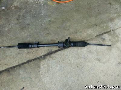

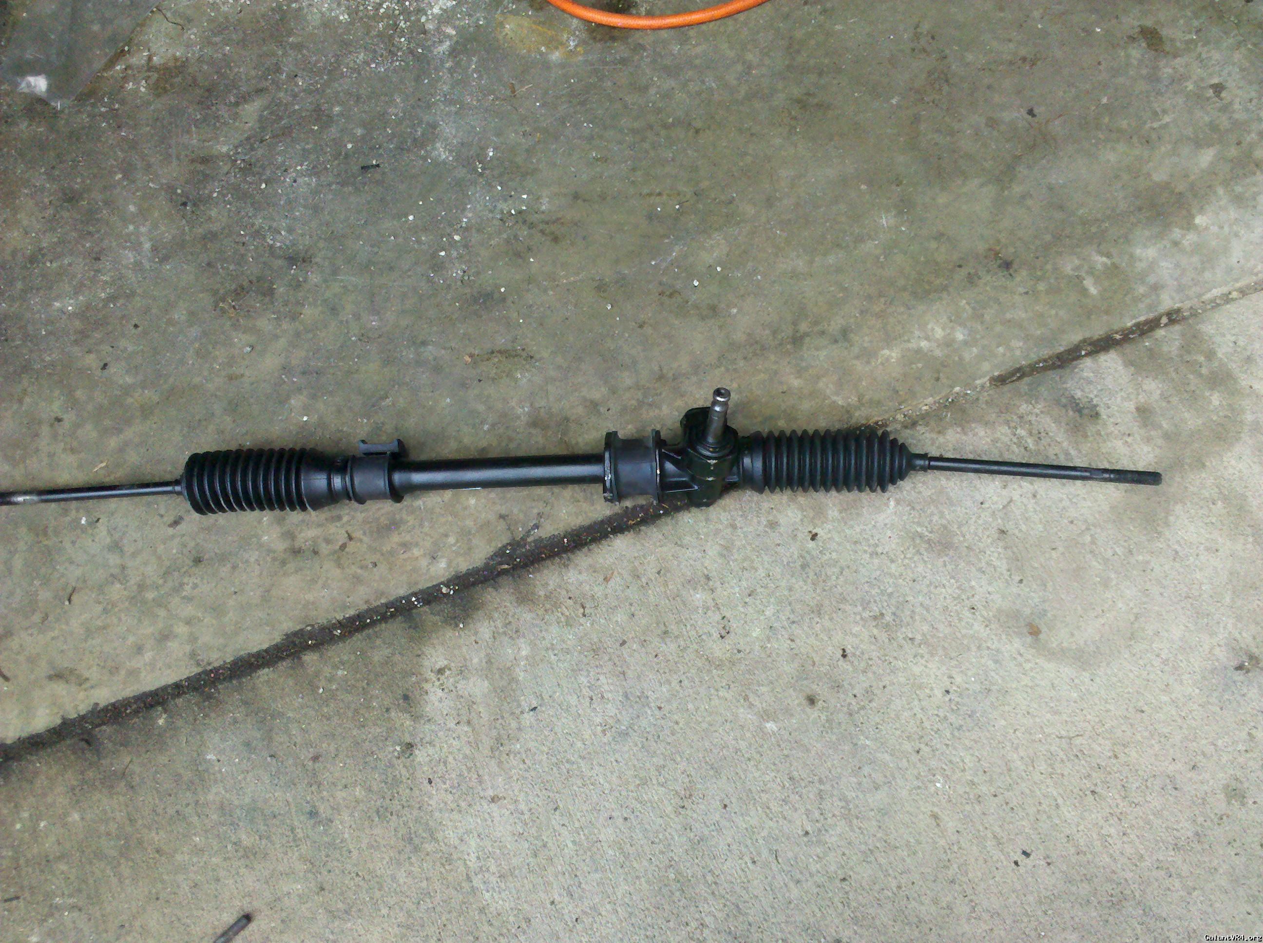

Bought a new manual steering rack for a 1.8 Eclipse, newer out tie rod ends were already installed by the previous owner. I also bought new bushings from JNZ Tuning. I love the way it feels, not too much effort

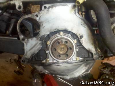

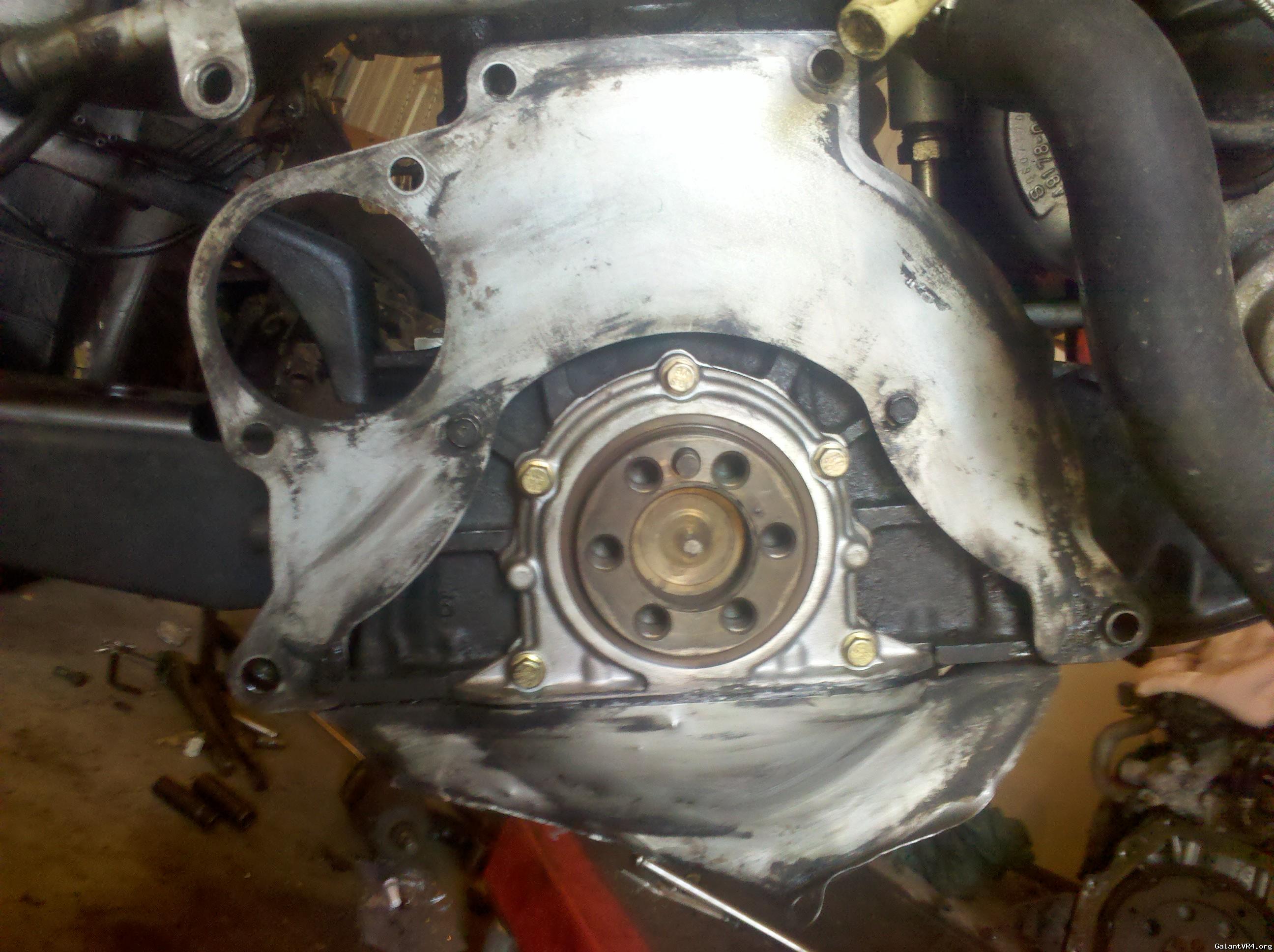

Rear main seal and new housing intalled. We did all of the timing belt side gaskets and front main seal as well

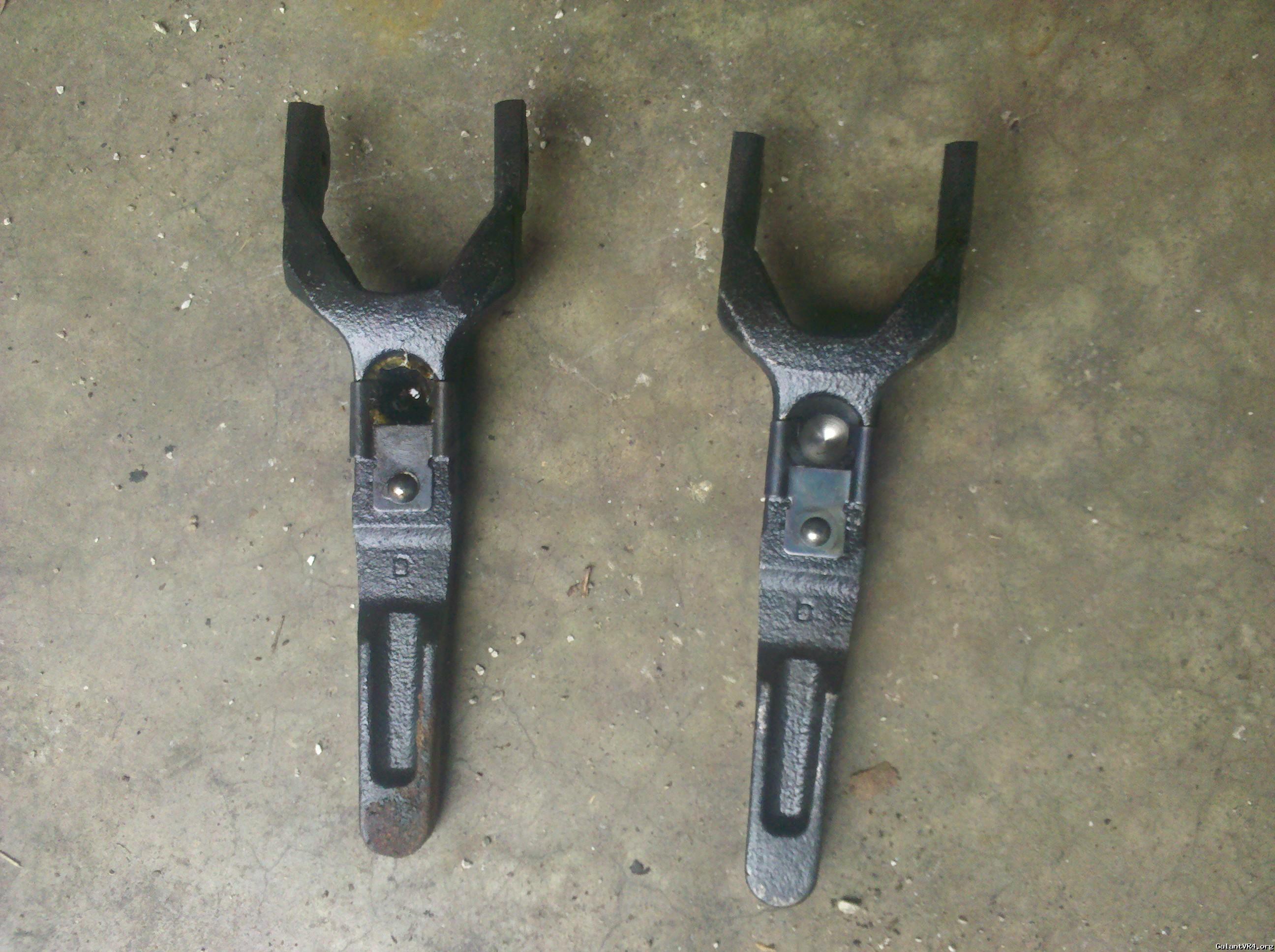

I installed a new 2G clutch fork and new OEM pivot ball while I was in there. The 2G for in noticeably larger, and is an upgrade

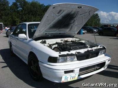

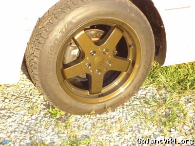

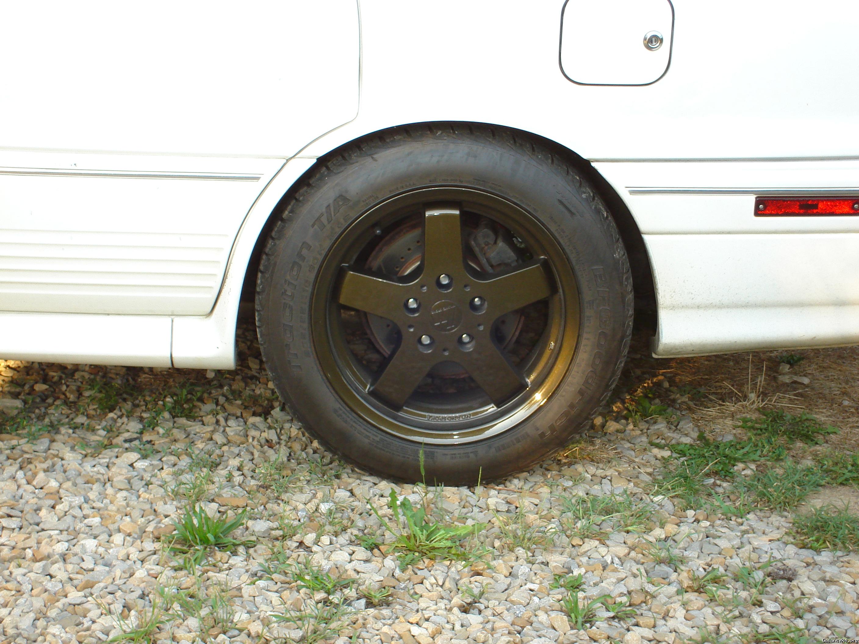

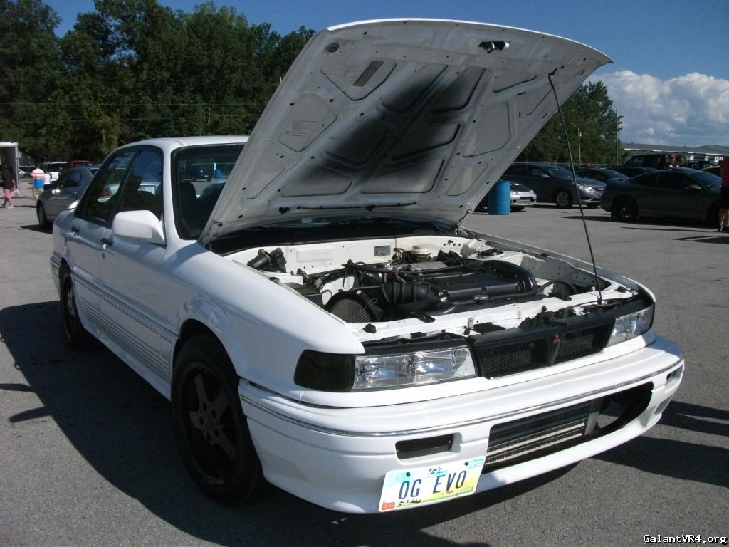

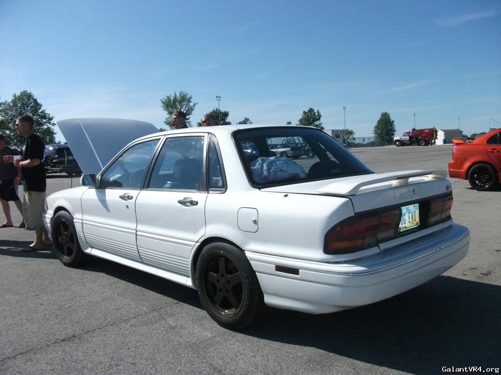

Here are a couple of shots of the car borrowed from the Shootout thread. Wheels are Milano's that came on an FD RX7 I parted out. I don't know much about them. My friend sprayed them, its amazing how much direct lighting changes the color. I'm also stoked to rock the OG EVO plate, its had tags for 6 months while I've been accumulating parts.

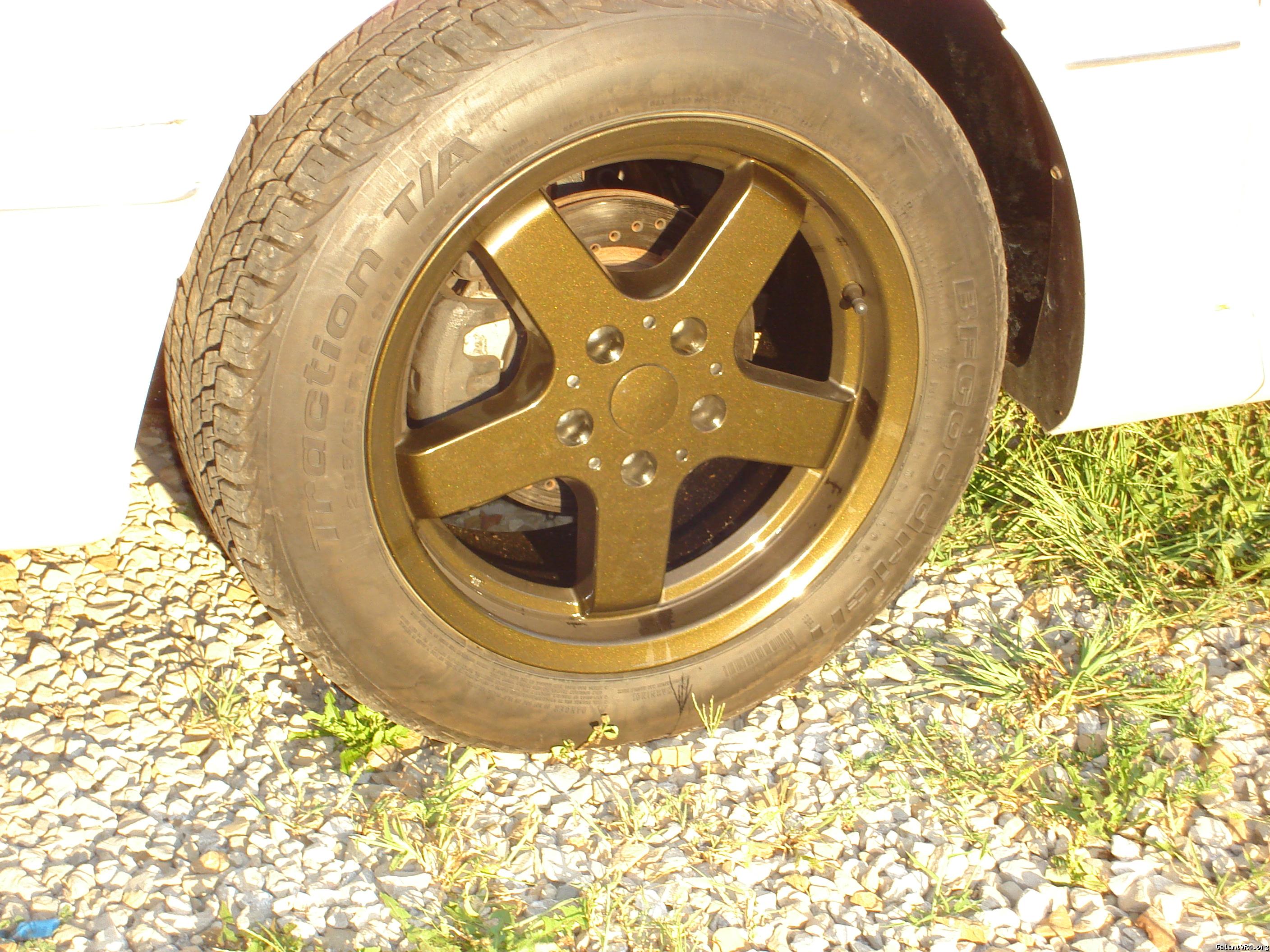

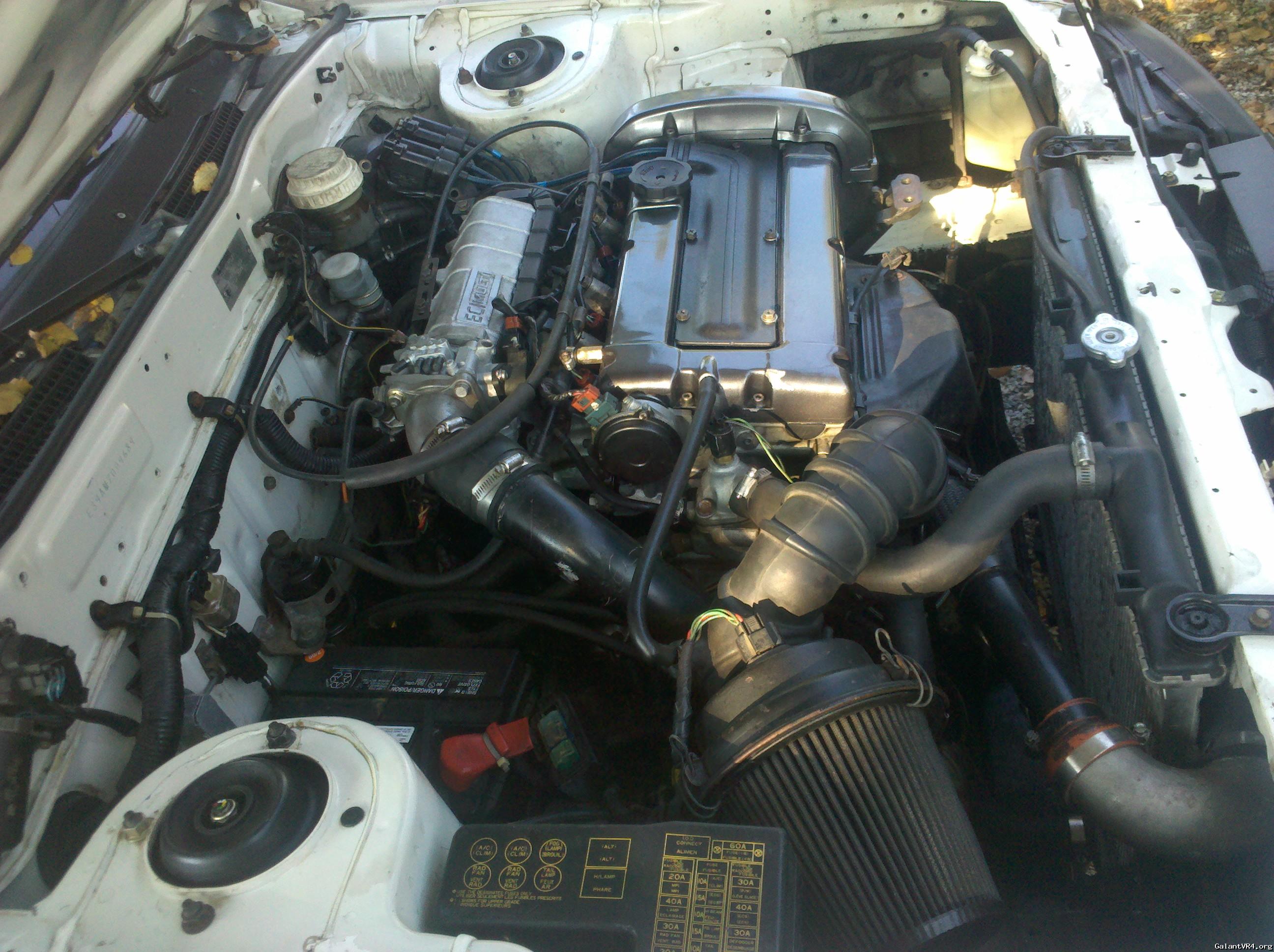

Here a few better shots of the new wheels and my engine bay. The wheel color is more green than I was anticipating, but I do like it alot
Indirect lighting
Direct lighting

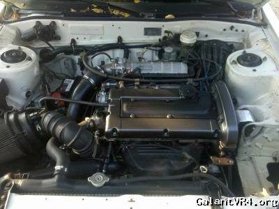

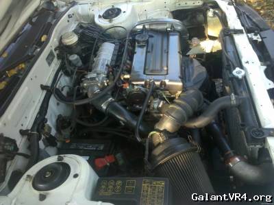

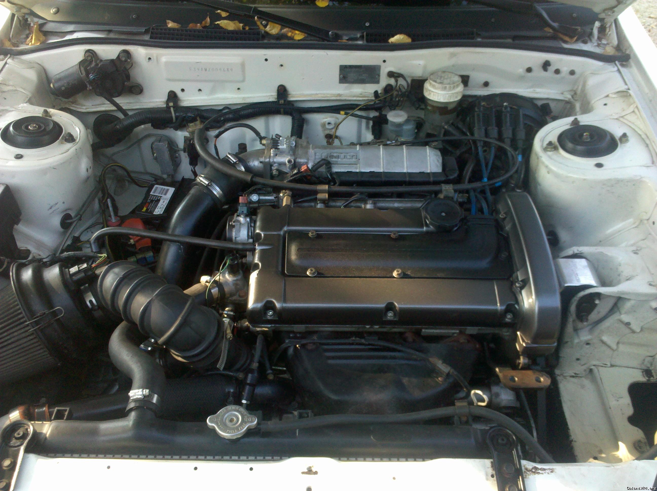

Full engine bay

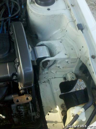

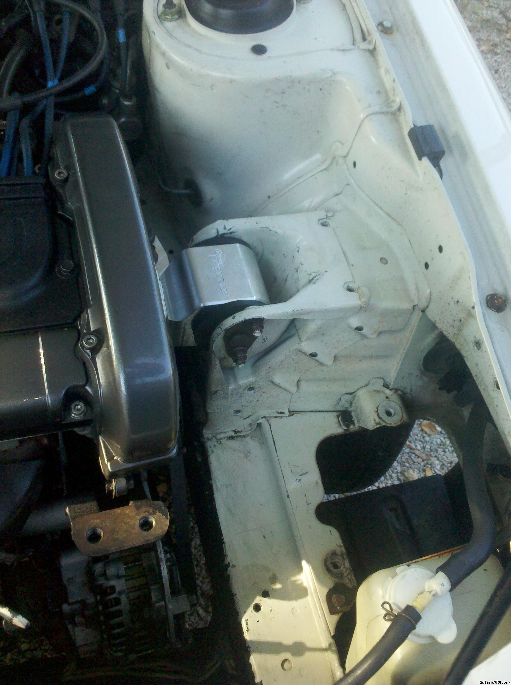

A shot at the Avid mount and the ABS delete/power steering delete. Cleans that side of the bay up so much!

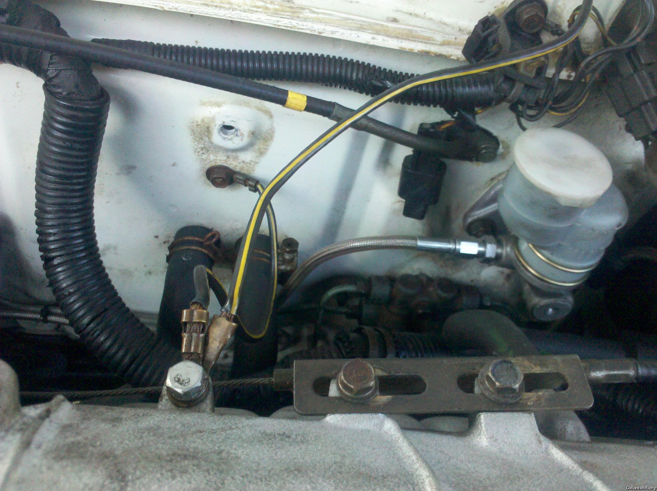

SS clutch line from master to slave courtesy of JNZ Tuning

A.C.T. streetlite flywheel

OEM clutch pedal and arm w/ brass bushing

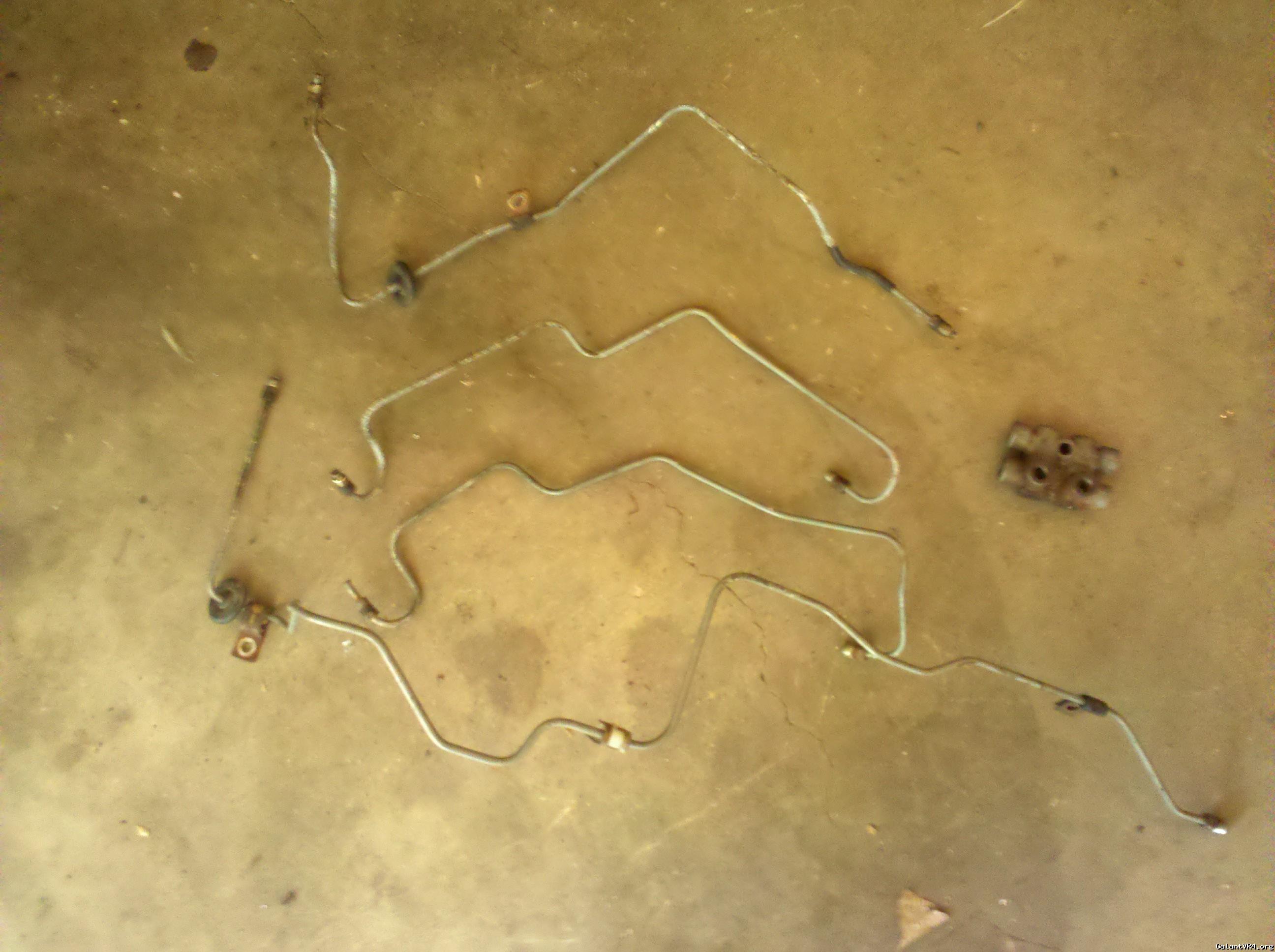

Do you find any slack on your SS clutch line compared to the hardlines + SS?
What's your take on it so far?
LIV4PSI
Nov 24, 2011
1,774
O-H-I-O
Quoting Prolab:
Are you talking about slack in the line itself, or more about the pedal feel? I'm not really sure what your asking?
The line fits damn near perfect, and you are able to use alot of existing brackets to hold it in place. It cleans things up alot compared to the stock metal hard lines. As for pedal feel, I didn't drive the car much before, but I don't have any complaints. I can't shift at high RPMs until I rebuild my pedal assembly though.
Sorry i meant to say pedal feel.
Ive read that with brakes and clutch system, you dont want the line expanding (even if its SS lines) and to keep most if not all hardlines to prevent any reduce pedal feel.
LIV4PSI
Nov 24, 2011
1,774
O-H-I-O
I've read similar info about keeping metal lines for that purpose. I honestly can't say I feel any difference with the SS line being installed. I can say that I am happy with the amount of pedal pressure I have, and it doesn't feel spongy at all.
