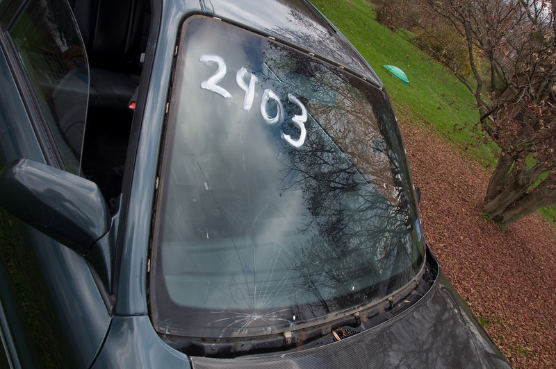

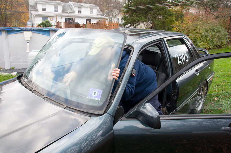

Swapped a different used starter motor in today, it's making the same rythmic clack/crunch noise when the starter is turning the engine. But it fires up and runs good without any noise. The noise is ONLY there with cranking. I called up GTLuke for a phone consult, and he thought it was a broken tooth or few on the flywheel ring gear. I spun the motor over twice while car was up on the lift and checked all the teeth with flashlight, and didn't see anything unusual but a little bit of metal shavings. Didn't think to see if the shavings were steel or aluminum via magnet. So the noise mystery is yet unsolved, but I bet has to do with the flywheel.
New windshield went on today, $200 installed. guy swapped my inspection sticker and it looks good. sucks, but not the end of the world. With hood pins, the CF hood will still be on my car, it's not damaged bad enough to where I'd rather not use it. might just have to straighten the bottom a bit and screw in a small flat brace under the spot where the fiberglass underbrace cracked.
