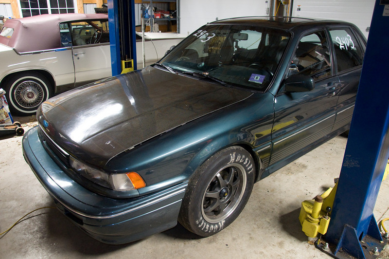

#139 got two new mods today:

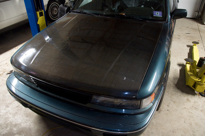

CF hood that came off #255/2000. No vents (and no rain water rusting up my turbo & manifold!). The fit is ok, but the curve on the front edge is too tight and doesn't match the angle of the fenders by the headlights. Oh well, it fits good enough. Uses stock latch, but Im going to put hoodpins on soon since the hood was already cut for them. It had some cloudy haze which 20min with a buffer & polishing compound took right off. It could use a little more cleaning/polishing work and a coat of wax, but Im happy.
The oem steel hood was just over 40lb. This CF hood with FG underside brace was 23.5lb. So it saved about 17lb.

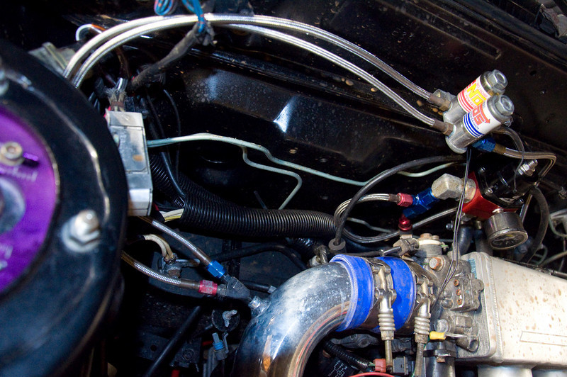

I got the mechaincal part of the installation done tonight:
[*]Bottle brackets mounted in trunk
[*]-4 feed line ran through interior
[*] Solenoids tested and mounted to firewall
[*] Upper ic pipe drilled and tapped for 1/16-27 NTP
[*] Fogger nozzle threaded on, all SS hoses and fittings are tight. (jetting checked 3 times due to OCD)
[/list]
Tomorrow I need to do the electrical half of the install which consists of wiring up a solenoid relay, a throttle microswitch, a main arming switch in the interior. I also have a bottle heater that needs to be hooked up, which is a simple relay & thermo-switch and I can pull the 12V from the fuel pump rewire. I also have a purge kit, but Ill likely save that for next year as Im going to remove all but the hoses during winter for daily driving after one trip to the track.

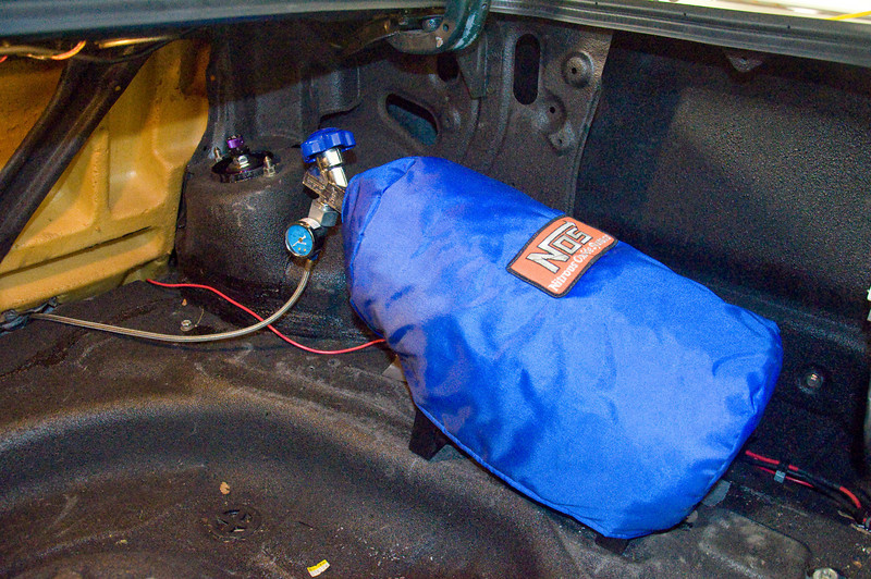

Bottle mounted in the trunk on passenger side. -10 SS vent hose that goes outside through floor in the event the bottle gets over pressure and blows out the burst disk. -4 SS feed line to the NOS solenoid. There's an electric heater under the blanket, which is a must for fall/spring use to keep the pressure consistent at ~900-1000psi.

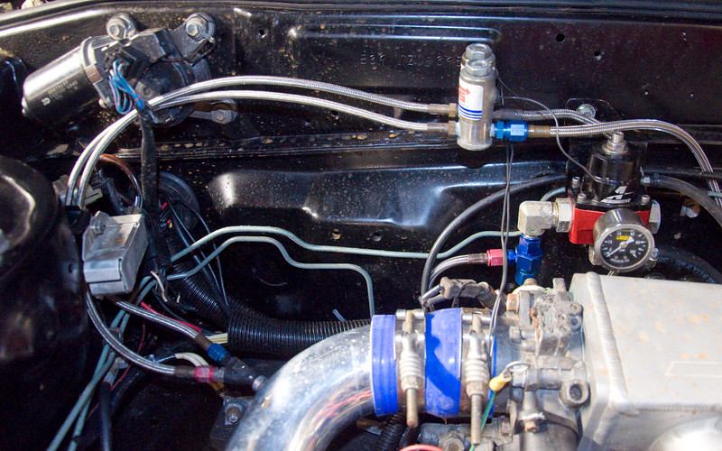

Pics of the solenoids, fogger placement, and hose connections. The tuning jets are in between the fogger nozzle and the -3 SS hoses. Two wrenches are all it takes to change jets, going from as low as 25hp to as high as 150hp hit. Easy to get greedy. /ubbthreads/images/graemlins/devil.gif

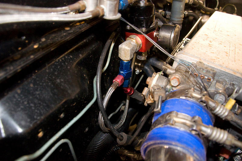

Tapped the fuel supply into the -6 line going between the fuel rail and the aeromotive regulator using a -6 pressure gauge port adapter that I had laying around. Fuel line from there to solenoid is -4 SS.

Looks good Nate. Your hood looks to be a carbon creations witch is the same as I have. You for sure want to put hood pins in. Ask me how I know /ubbthreads/images/graemlins/banghead.gif. Just like yours the fit is ok. My hood does the same thing by the drivers side head light. I can live with it to get rid of some weight.

If you think it isn't safe, Ill take it off before going to the track on sunday. The hood was cut for pins, had the latches on the hood, but the pins are MIA. I suppose i could find a set of walmart/autozone pins to get me by for now. Yeah...function trumps form. The hood might not be perfect and has some blemishes, but 17lb is 17lb and Im not running a show car here.

If you don't have pins its not a good idea. I lost my first hood do to the fact it opened up on a 2nd and 3rd gear pull. Slammed the roof and broke the hood and also put a nice dent on the roof of the car. The hood just has to much flex in it for the latch to hold it down.
Just don't want to see the same thing happen to you.
