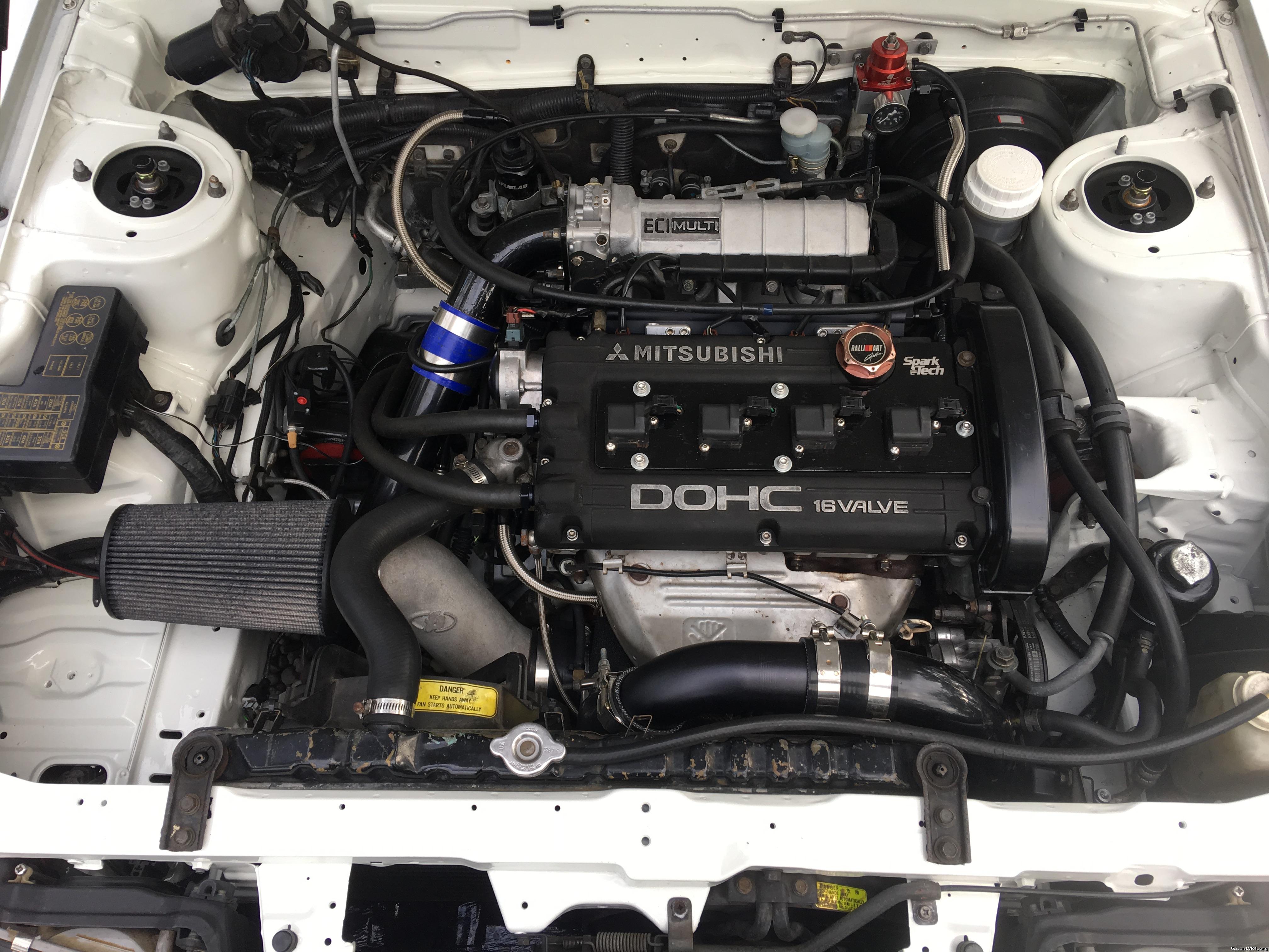

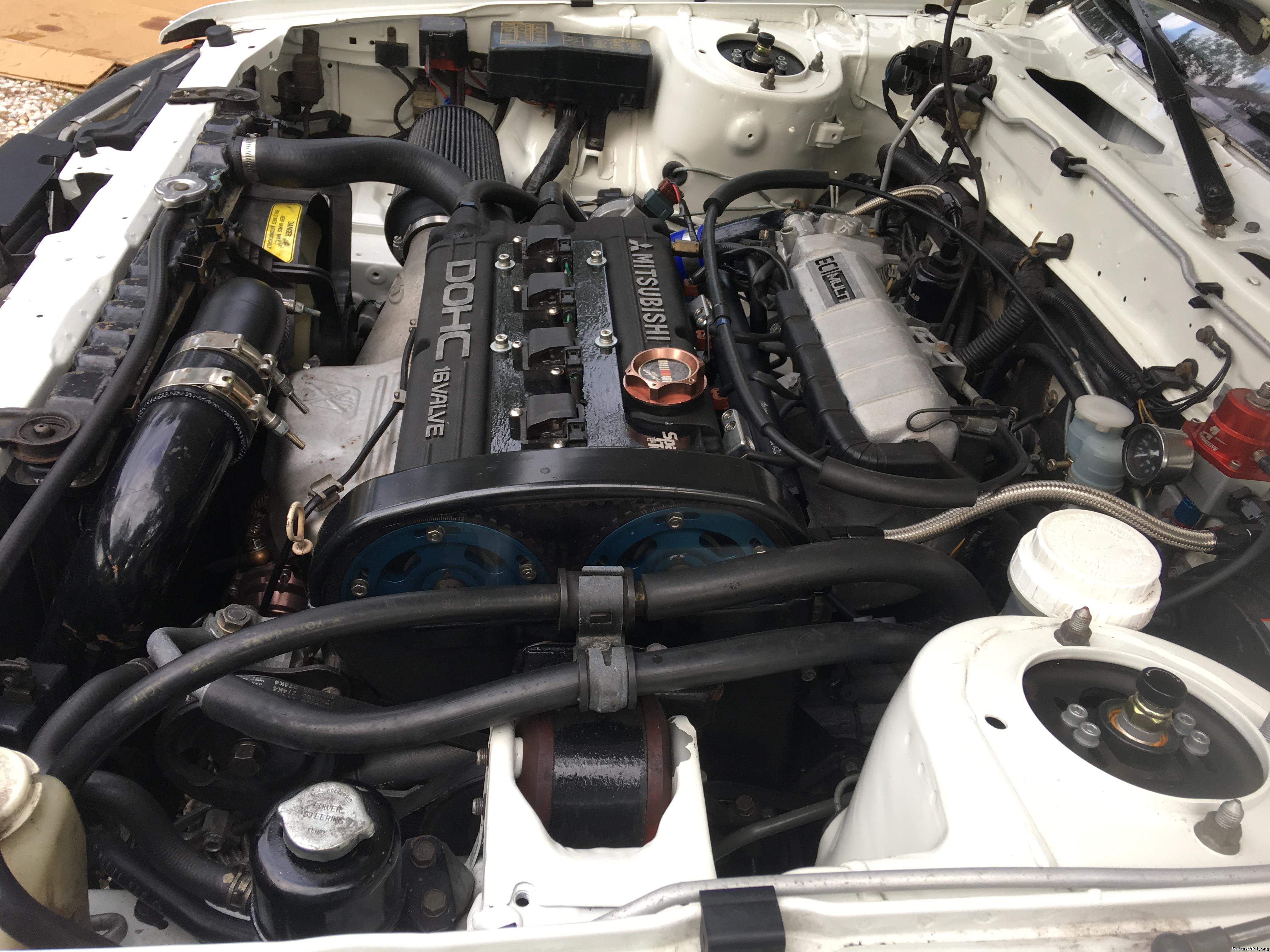

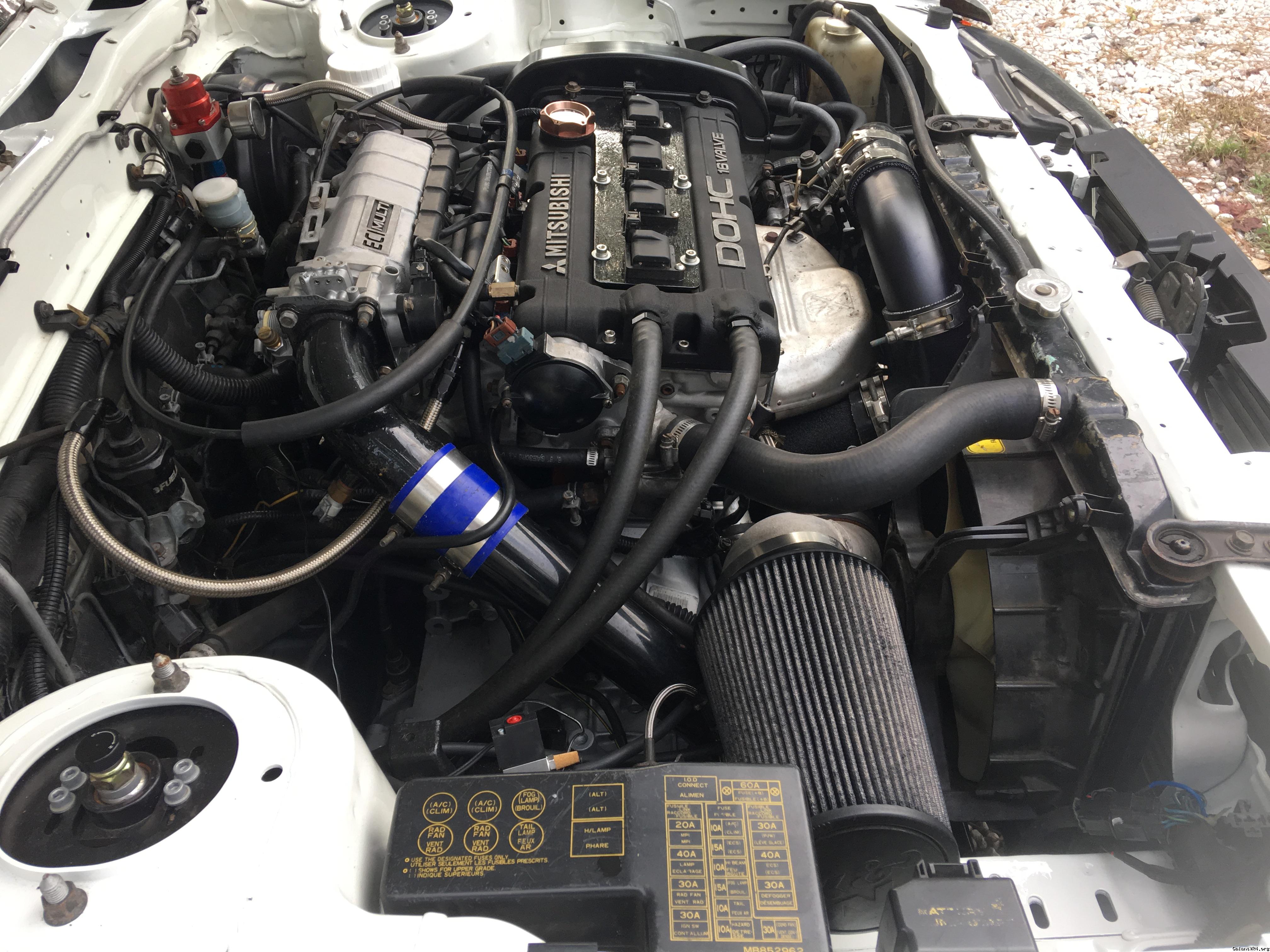

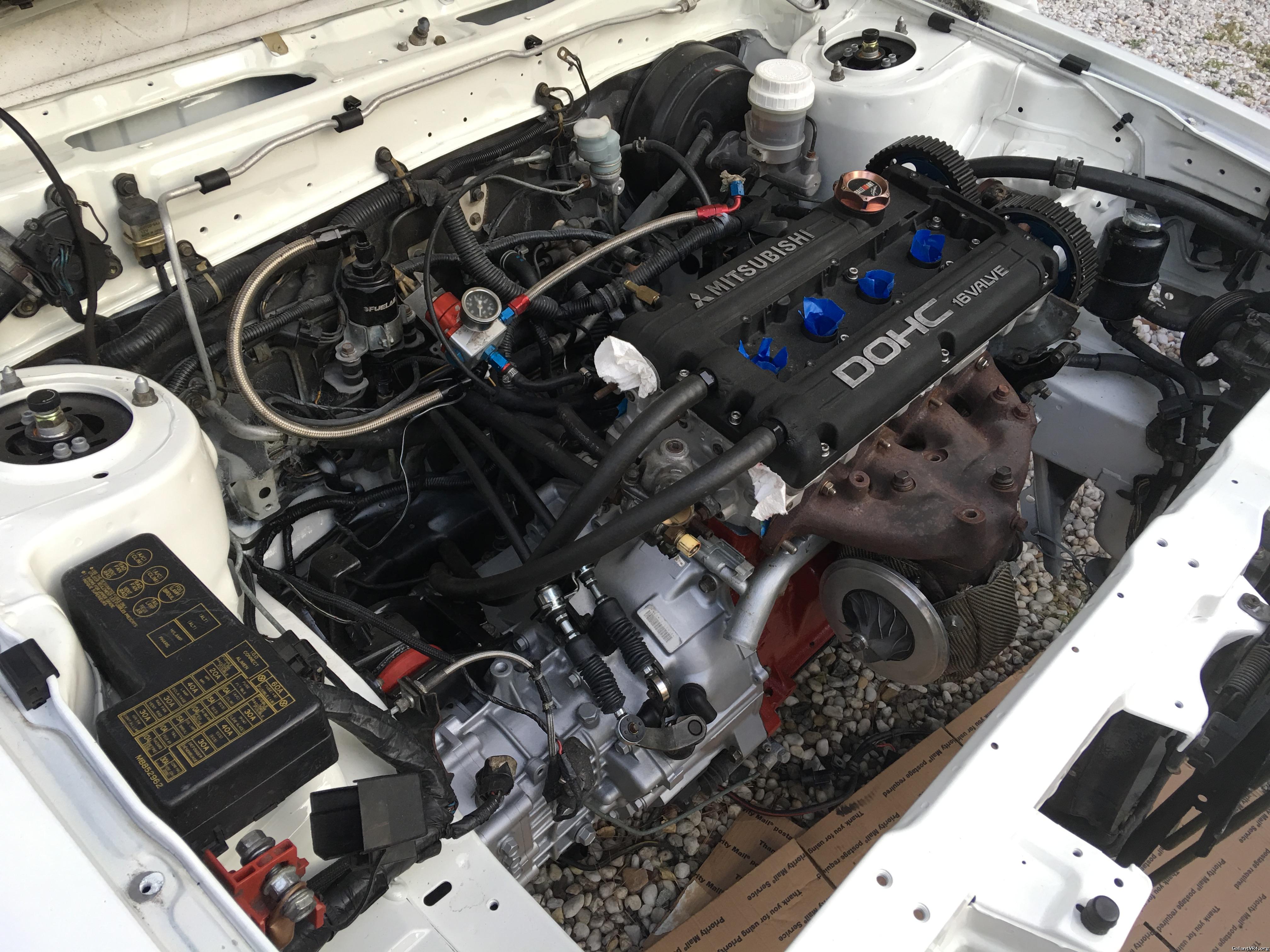

Engine (built 2017):
- 2.3 stroker engine
- 9:1 Wiseco pistons
- Eagle rods
- ACL bearings
- New factory 2.4L crankshaft
- Balance shaft elimination w/ OEM Mirage parts
- Rebuilt head with valve job
- L19 Head studs
- OEM composite head gasket
- OEM hydraulic tensioner
- ENGNBLDR SS valves and guides
- SuperTech dual valve springs & retainers
- SuperTech small OD valve stem seals

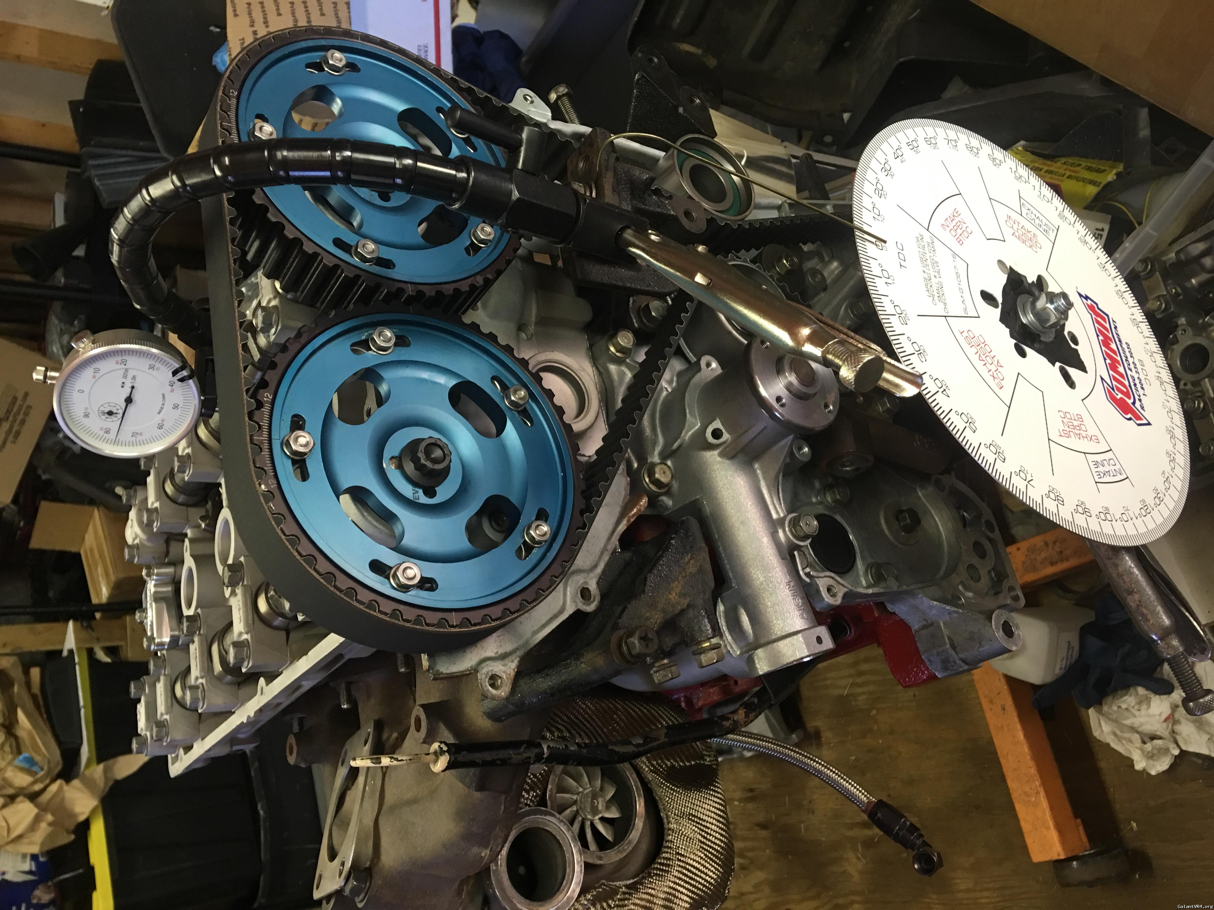

- Kelford 272 cams
- Fidanza adjustable cam gears
- 3G lifters
- OEM valve stem keepers
- OEM oil pump and front cover
- ’90 oil filter housing
- ’90 turbo waterpipe
- OEM water pump
- Stant SuperStat 180* thermostat
- OEM Evo 9 kevlar timing belt
- Custom painted zaklee upper timing cover
- New OEM lower timing cover
- Wrinkle black valve cover w/ 2x -10an fittings
- NGK BR7ES plugs gapped to 0.020
- Sparktech COP
- Black top CAS
- All new seals and gasket kit
- Fluidampr balancer
- ARP balancer bolts
- Shortened driver’s side mount
- Prothane mount inserts

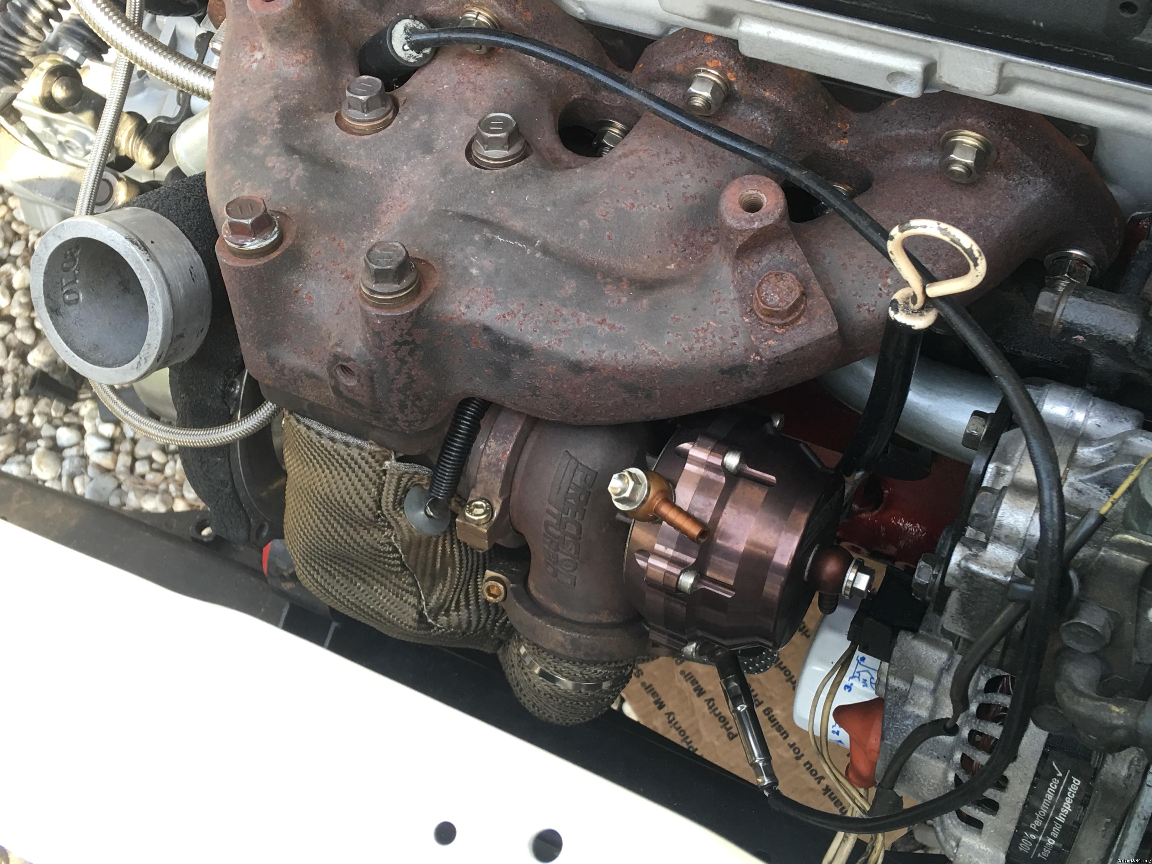

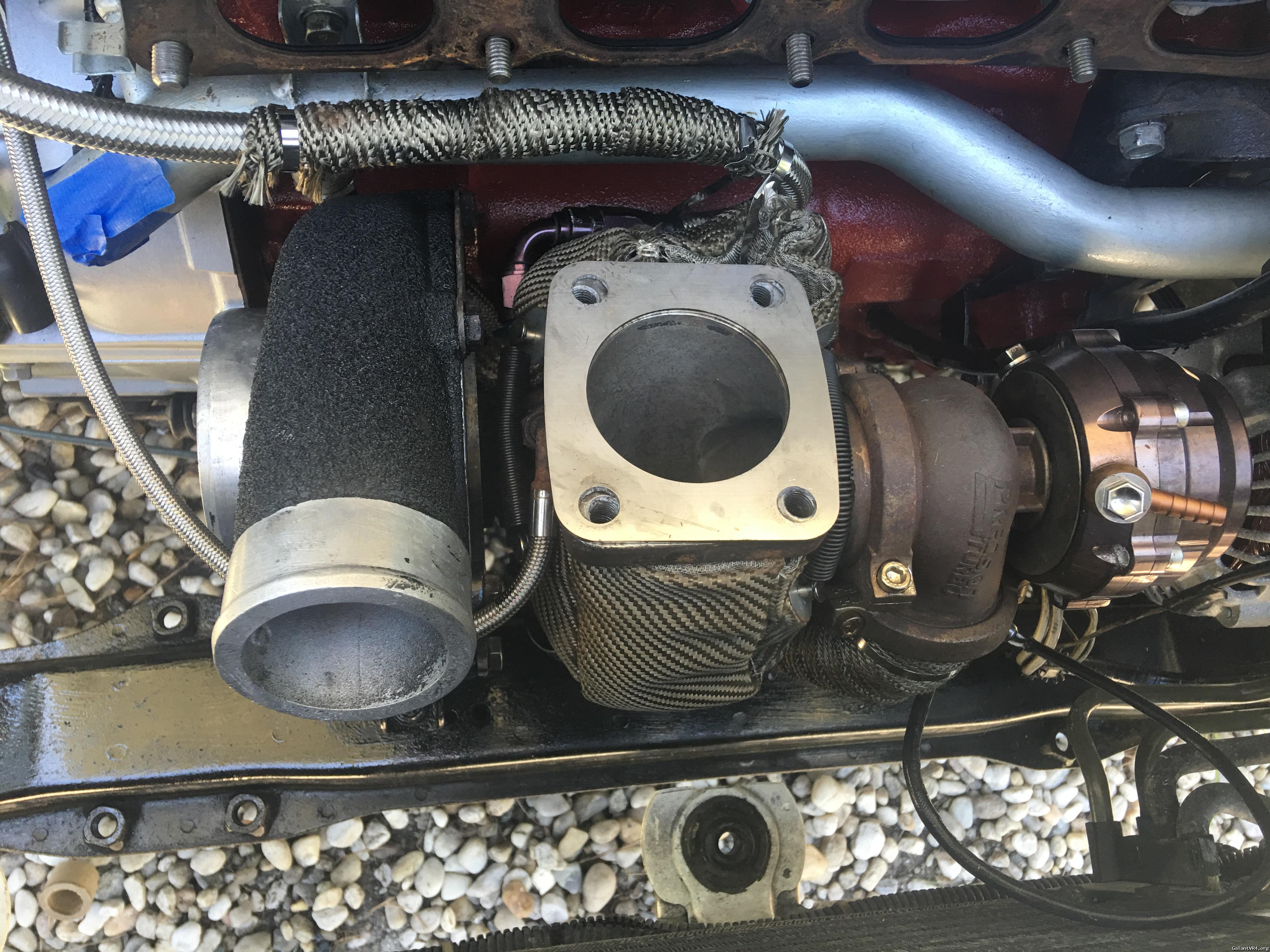

Turbo / Intake / Exhaust
- GT35R in bolt-on FP housing
- FP 2.5" O2 housing
- FP oil feed line
- ExtremePSI oil return line
- SBR ported exhaust manifold
- New OEM upper turbo heat shield
- Custom turbo blanket
- Precision 46mm wastegate

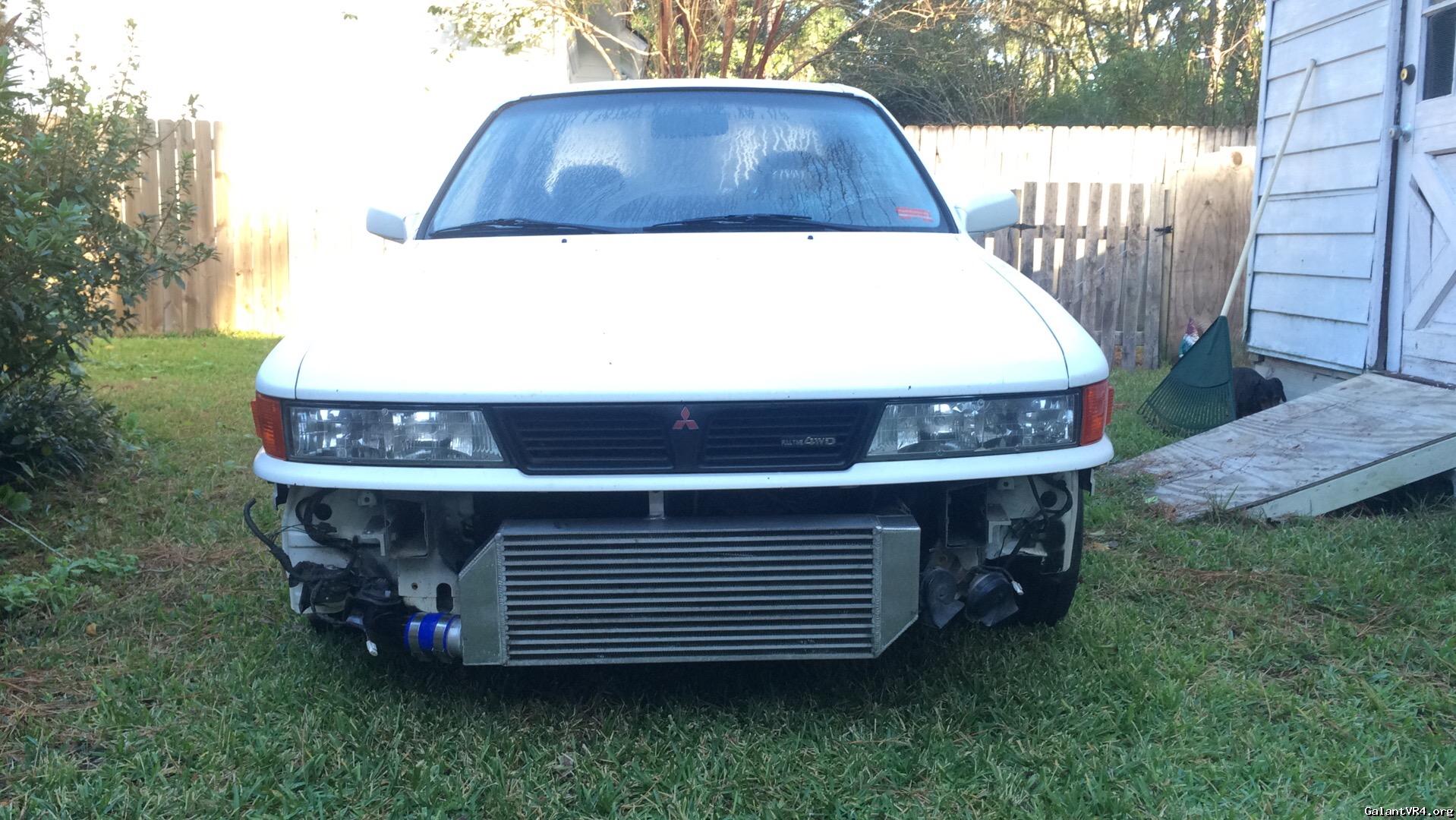

- ETS FMIC kit
- Throttlebodys.com 63mm throttle body
- OEM EGR block-off plate
- custom machined FIAV delete
- FP intake with K&N filter
- stock bov with dodge garage mod
- 3” Apexi downpipe
- 3” custom exhaust with 18” Vibrant resonator and Vibrant 3” duel tip black muffler
Engine Management / Fuel / Electronics
- Socketed EPROM ECU
- ECMlink V3 w/ SD
- Omni power 4 bar MAP sensor
- GM IAT
- FIC 1120cc injectors
- Ingersoll Rand boost control solenoid
- Fuelab filter w/ -6an ss line & fittings
- FIC black black fuel rail (E85 safe!)
- Aeromotive FPR w/ gauge (custom mounted in stock brake fluid reservoir location)
- GM flexfuel sensor
- Innovate LC-1 wideband O2 sensor
- Walbro 450LPH in-tank fuel pump (E85 safe)
- Fuel pump rewire
- New OEM knock sensor
- Battery relocated to trunk (power distribution block in engine bay)
