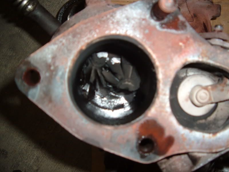

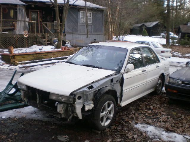

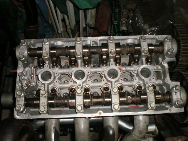

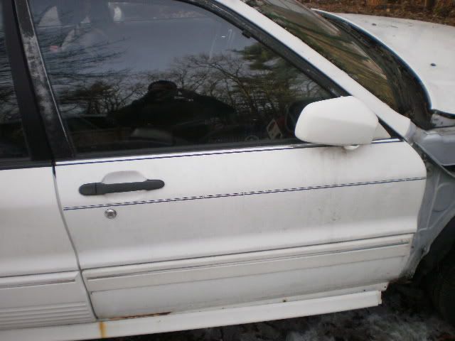

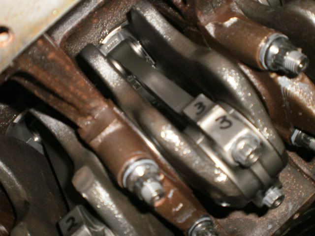

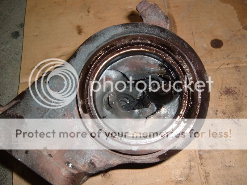

I have been putting it off for a long time to post everything up here, So I'll do it now to see what you guys think!! So far I have nothing done to the body as far as paint but have the gallon of bright white that I wanted to do the entire car, I swapped out all 4 doors, both fenders, and the hood from a low mileage galant gs. I burnt a hole in the #3 piston and melted a hole in the head between #1 & #2. I had put a T4 60-1 to play around with and thats what I get for running the piss out of it on a MAFT. The car should be getting finished up very soon, so i will have completed pictures. As soon as I can dig the car out of the snow back its behind now.... So here a few things I've been working on getting ahold of to just make some power and have a little fun!

-manley turbo tuff rods

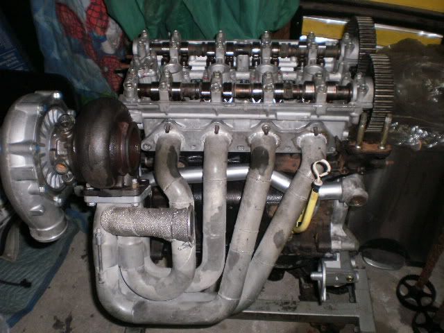

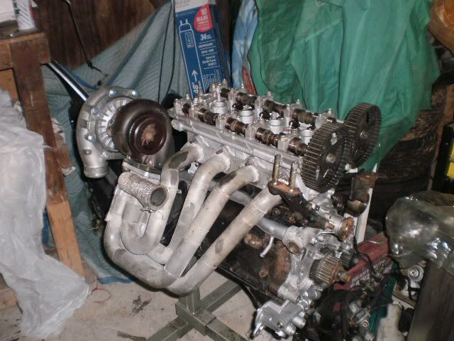

Does that manifold have a brace that runs from the turbo to the block?
If not I bet #1 runner will be cracked in no time. Sweet looking build though.

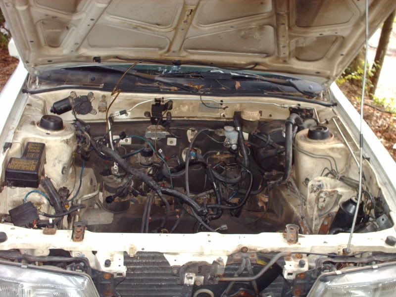

Pics of final engien bay would be nice to see too.
+1on the pics. I'd just like to see it fit in the engine bay. Definitely agree, without support, runners will weakin and crack eventually.
