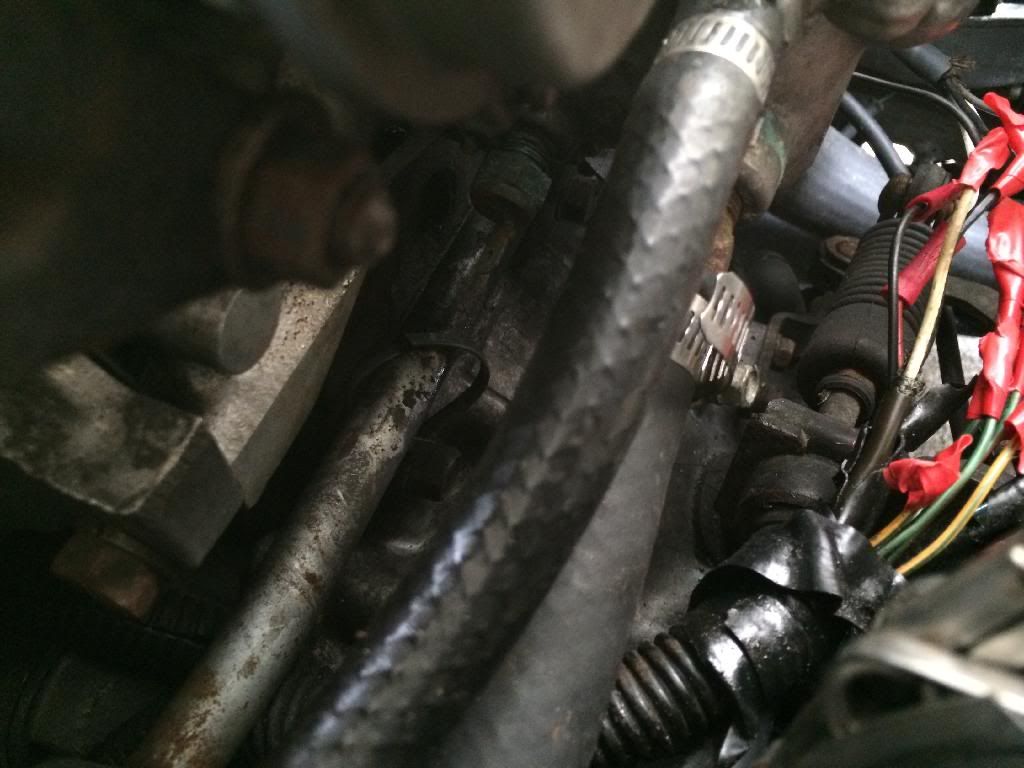

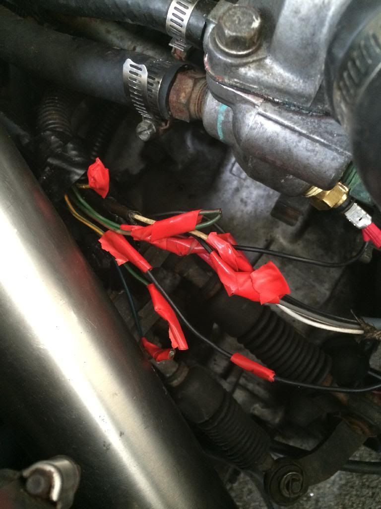

Pic Below - The two extended black wires run to the CTS - they were grouped together in the harness, so I assumed these were the corrrect ones. The car seems to want to start (with this wired as is) but just runs like it has a major leak. It barely responds to the gas pedal, and pours white smoke. If I let off the gas, it will die immediately.
The green wire right up front, is folded in half and taped off (looks like two wires because it was spliced into before (I don't know why))
As I said in the OP, the O2 sensor is now hardwired. Since I found the wire broken off the plug, I am not sure if it was being used before, when the car was running well? It had to of been though, right?

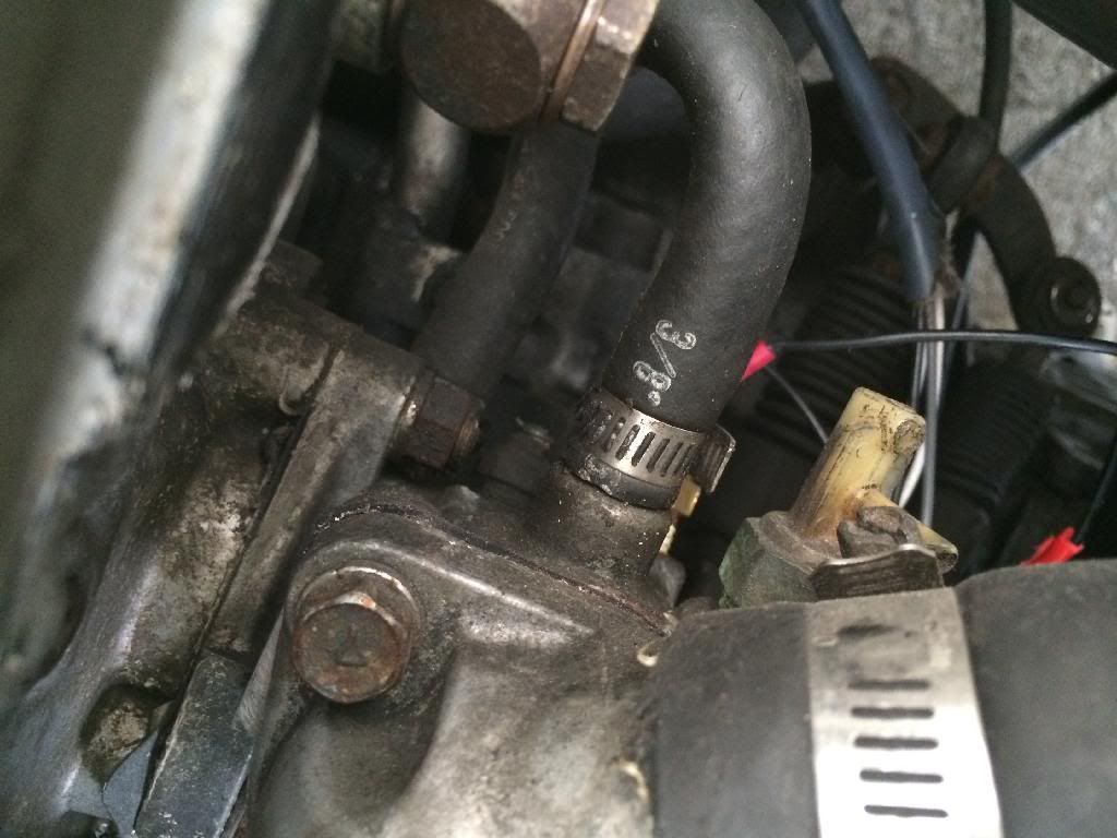

Look closely below, see that single spade male connector. What is this? I have two single male connectors in my Thermostat housing, but cannot find info on this one anywhere. Two temp gauges?
See (below) the other down there (male spade connector broken off). This would be the Coolant Temp Gauge - according to diagrams I've read. So what is the other one?!

It seems weird to me that the injectors would just randomly clog up, after it just ran great the night before I pulled it into the garage. - because the fuel in the tank is bad from sitting and you turning it on and running it stirred everything up and clogged everything.
Look closely below, see that single spade male connector. What is this? I have two single male connectors in my Thermostat housing, but cannot find info on this one anywhere. Two temp gauges? - this is the blue single wire in your cluster.
See (below) the other down there (male spade connector broken off). This would be the Coolant Temp Gauge - according to diagrams I've read. So what is the other one?! - that broken piece is for the dash gauge

i cant tell from the wires, but it looks like the CTS wires are mixed up pretty bad. try switching the yellow/green with the other yellow/green and see if it works. also you might need to swap the connector locations. the wires are to clustered together for me to tell just from the picture. you'd need to separate them and show me the exact two wires going there. also you shouldn't use tape like that. go get wire connectors and wire loom and cap off any wires your not using. also get waterproof female ends to go on the CTS so nothing shorts out. tube of dielectric grease as well.

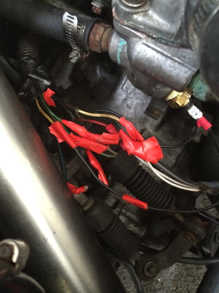

They look messed up because they run through the O2 sensor wiring. This must have happened when I was scrambling to try different wires for the CTS. I did try both Y/G wires, and the way it's setup now, the car actually tries to run.
I used the "twist and tape" method because I was switching the wires around to see if the different Y/G wires would make a difference. Once sorted, they will be properly soldered and heat wrapped.
I will get some better pictures for you right now.

You need to see what is being shown as the coolant temp by the ECU. I believe if it's not hooked up right or not getting proper signal, it will default to some insanely low temperature. Of course, if the temp were actually this low, your car would probably run a little, until it warmed up and got further from the reported temperature.
The blue wire doesn't go to the gauge. It goes to the A/C system. The single spade sensor in the front of the water neck is for your gauge. I dont recall the wire color for that one.
It shouldnt matter how the wires are connected to the ECU CTS, because the sensor simply gives a resistance value between the two contacts.

one y/g goes to the bottom part of the T the other y/g goes to the broken off one next to the CTS. the other Y/G is the dash gauge. the one in the back is the blue wire. its an open circuit till the coolant reaches a certain temp then becomes a ground and turns the fans on. yes its for the a/c, but in my mind having it is also kind of a fail safe for the fan temp sensor in the rad.
yes it matters what wire goes where on the CTS it matters a lot.

Yeah sounds like a wiring in the wrong place. Take off anything that will be on the way of getting to that wiring harness part, (IC pipes, turbo i take pipe, bov) you need to be able to have good access to them wires, get the wiring diagram and cut back all the loom, go threw every wire for the CTS. Pretty sure one is on wrong. I had to do this and its the only way to do it right. When you get the right wire on the right conector mak it with something so you cant connect it wrong in the future.

Not to mention the SAFC zero'd itself out, so I set all the LO base settings to [(450/680) -1 ] 100. I'll deal with this after I get it to start.
I may not get to it today, but I'll rewire everything, mark everything and report back. Hopefully I'll have my logger setup as well.
I just don't get why it would run before and now it won't. Would a bad O2 cause this type of behavior? Or a bad MAFS?

O2 sensor isn't even a relevant thing really until the engine is warmed up. It would have little to no effect on startup.
A bad MAF/wiring can most definitely make the car not run right, but i've been able to start many 4g63 powered vehicles with NO MAF hooked up at all. They generally run and idle like crap, and are hard to keep running, but yeah.. they'll usually start, at least.
An unplugged coolant temp sensor will cause the car to not even start, or to start and run like it's on 2 cylinders (at best). IMO it's an even worse condition than running without a MAF plugged in.

Okay, as soon as I get some spare time, I will pull everything back out and cut back into the harness a bit more, and trace the correct wires, and go from there.
Also, I'll get my logger setup and see what the ECU reads regarding the Coolant Temp Sensor.
I really appreciate the help/responses everyone.
Edit: Just to make it clear, the car DOES start, and with some trying, I was able to back the car out of the garage and park it. It died about 6-7 times and would barely idle long enough for me to move my foot from the brake pedal to the gas. It would not rev freely at all and would barely rev up at all. It was also pouring white smoke out the exhaust.
