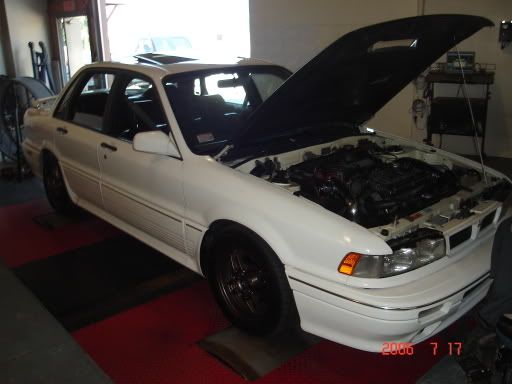

Engine (magnafluxed, bored, balanced and decked [O-ringed]):
- JE 8.5:1 .20 over pistons
- Eagle Rods
- Clevite Bearings
- Kiggly Girdle
- Polished OEM crankshaft
- New Mitsu Oil pump (BSR) /Water pump
- Bushur Damper Crank Pulley
- ARP Mains and ARP L19 Head studs
- SS-O ringed block w/ Felpro Composite Headgasket
- 90 OFH w/ Oil temperature and pressure sensors and Setrab Oil Cooler (8-an)
Head (Ported and Polished)
- Crower 280 cams w/ Fidenza Cam Gears
- Supertech 1mm valves (5 angle job)
- Supertech springs w/ Titanium Retainers and hardened steel keepers
- 1G Lifters w/ Kiggly HLA
- Valve Cover with working PVC valve (lol figured I would add that)
- 880cc Precision Injectors and AEM Fuel rail w/ AFPR
Turbocharger
- Magnus Racing SMIM w/ stock throttle body
- IHI 20G turbocharger w/ ported 2G manifold
- Spearco Intercooler (500hp) w/ 2.5 piping and Synapse BOV
- 3" Bushur Racing Exhaust
Transmission
- Stock rebuilt Turbotrix Transmission w/ 4 Spider CD
- 4 Bolt rear end LSD
- ACT Flywheel and 2600 w/ Street Disc
Parts currently on hold until I finish my supra:
- Carbonetic Triple Plate C/C Clutch
- Holset VGT Turbocharger w/ T3 Manifold and Synapse Wastegate
- TRE stage II transmission w/ 4 Spider CD and Evo I clutch based front LSD
- 1600cc injectors, 8-an fuel lines and Walbro 400lph pump
- 70mm Accufab Throttle Body with Ford IAC
- HKS DLI Type II w/ Honda Coils (not 100% sure on Honda Coils)
- Evo MR Bilstien suspension and brakes
