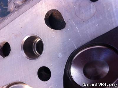

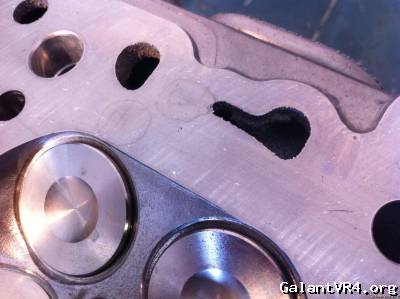

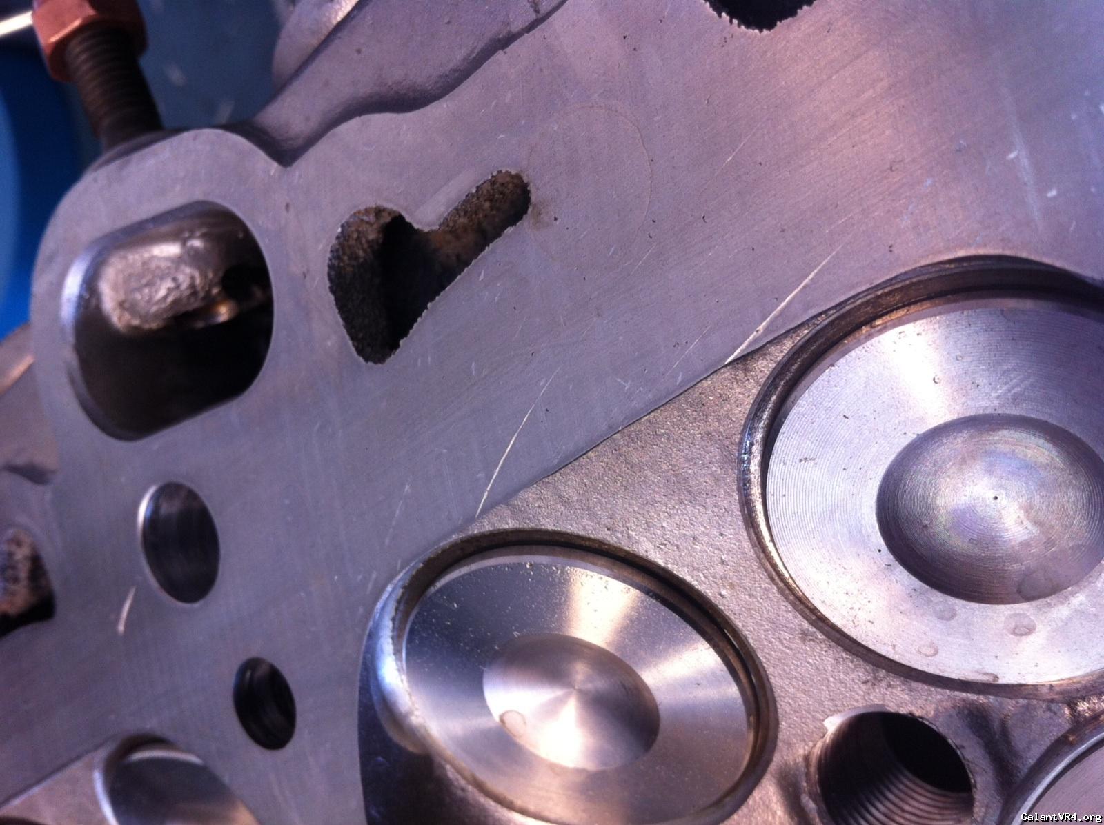

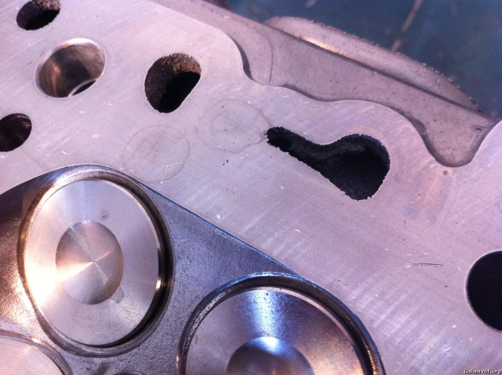

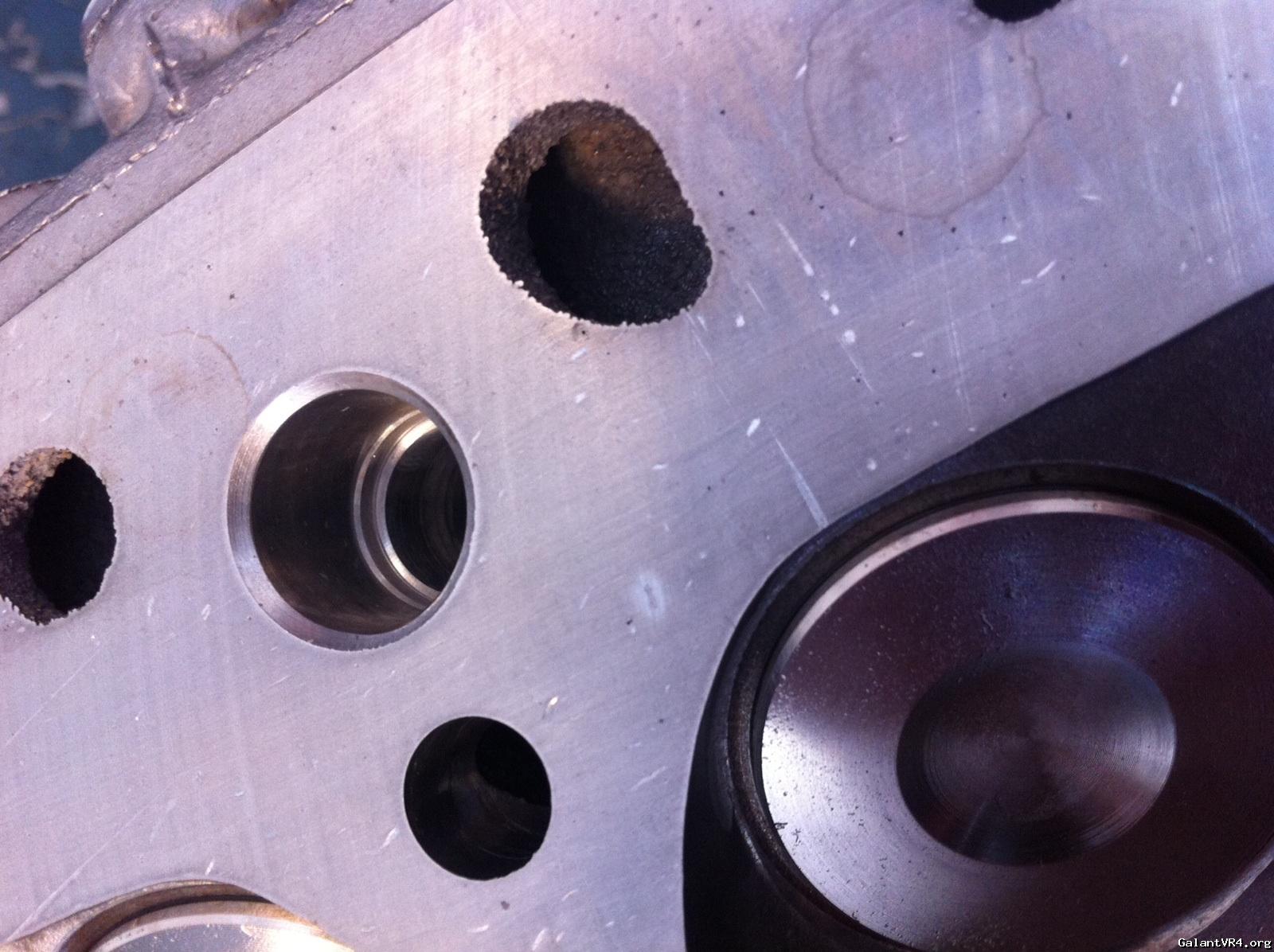

TO add to my story(sitting here with a look of disgust) I got the brand new 1200 head today so I rushed it down to the mechanic. I had to make it quick I was on lunch. So I get a call about a hour later my guy is saying he can't use this head because the surface is really scratched up and there seems to be a wavy pattern across the surface.. I'm so bummed I WAS SUPPOSED TO BE DRIVING IT THIS WEEKEND...
Steve885
Dec 7, 2012
228
Concord ca
These scratches may not look that bad in pics but u can catch your fingernail on them.. My guy is a perfectionist and doesn't want to take the chance on a blown head gasket...
