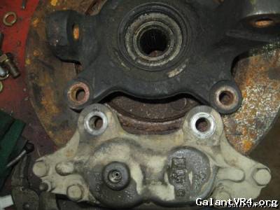

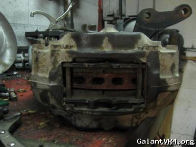

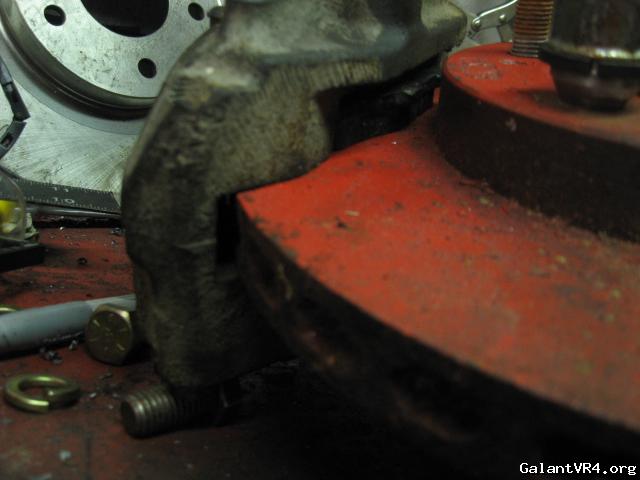

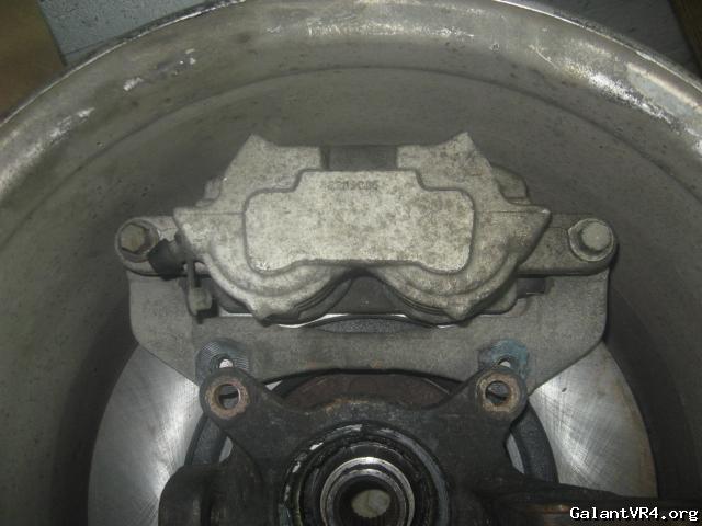

Quick update on the Outlander 294mm rotors which I believe are also the same ones that come on the 08+ Lancers. I went to advance and bought one for a mockup with my Ford PBR twin piston calipers. The good news is that they barely clear the inside of my 16 x 8 oem 3000GT wheels. The bad news is that the bracket on the caliper hits the two mounting points on the knuckle. The only way that I see it working is to clock the caliper at a different angle and trim one of the mounting holes on the knuckle and drill a new one a little closer to the center to allow more clearance. I'll run out and take some pics in a bit, maybe you guys can come up with a better idea for me. I really would like to make this work since I have these perfect calipers just laying around.
89Mirageman
Jul 5, 2006
2,502
Stantonsburg, NC

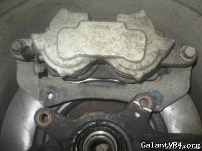

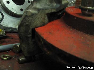

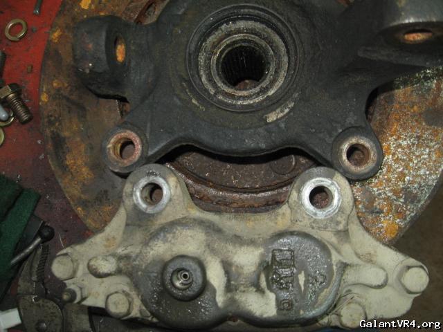

Here are the pics. You can see that the caliper bracket is too big for the 294mm rotor and there is no room to make a mounting bracket.

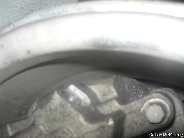

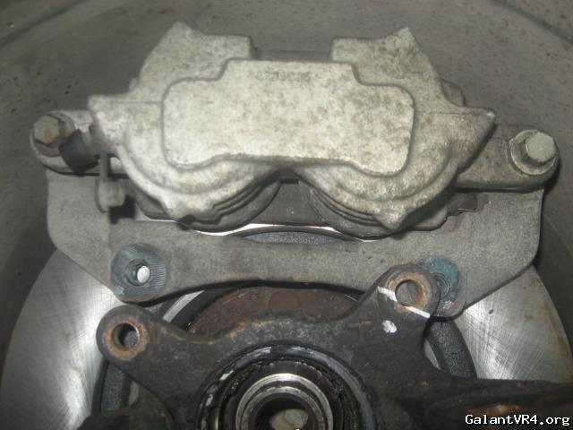

In this pic you can see that I clocked the knuckle a bit and one ear will clear. I was thinking of trimming the other ear on the sharpie line and drilling a new hole where the dot is. Not sure that I like this idea but it should work. Anybody got a better idea?

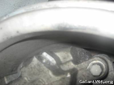

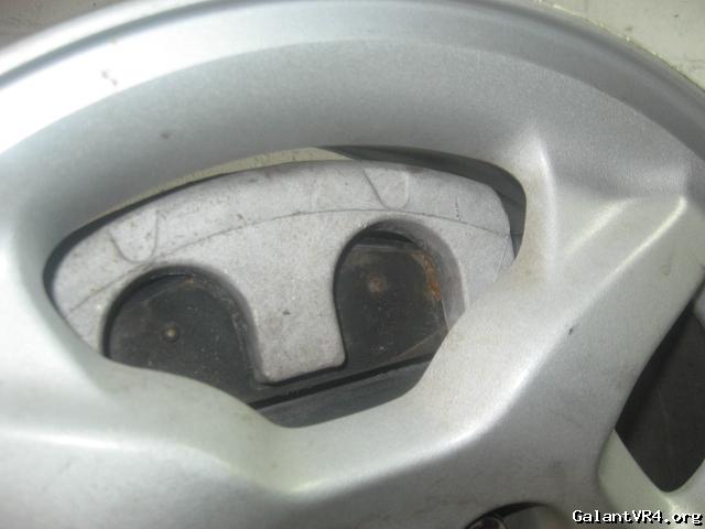

Here are some pics of how close the clearance is on my 16" wheel.

Ok the reason the Cobra rotors work is because of the depth of the hat. Its not that much my it being thinner this moves the caliper and bracket outward and gives space between the ears on the spindle and the ears on the bracket to offset and mount up with the bracket Ron designed. Maybe you can find a rotor the same dia but with a thinner hat and it will work with a stud in one hole and a bolt for the mounting.

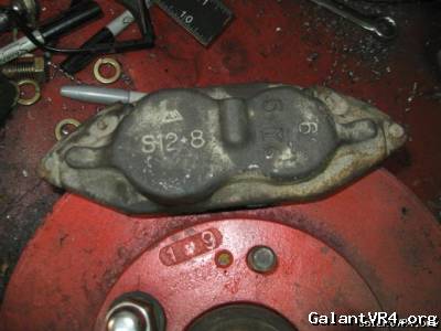

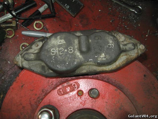

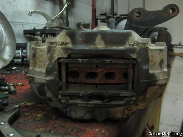

Stumbled across another possible option, I grabbed these 4 piston calipers from an 87 Toyota 4WD pickup. They have two large pistons and two slightly smaller, plus they have the quick change pads. Here they are mocked up with a 276mm rotor from a 92.5-94 AWD DSM. Looks like a simple adapter is all that is needed.

Still haven't messed with them. All you have to do is get a rotor and caliper for mockup, use some mdf board or something to cut a few brackets out of. Get the dimensions right and then transfer it over to mild steel or aluminum plate and you're done.

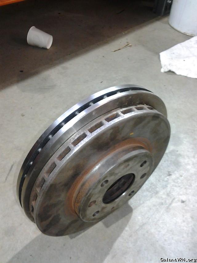

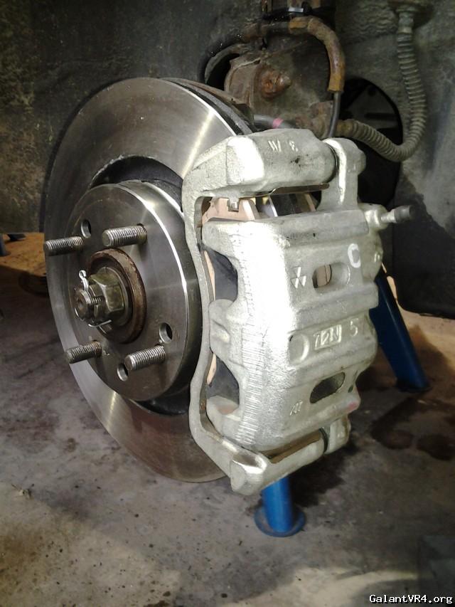

I installed today to my gf:s evo1 "outlander" front brakes.
Drilled 4 * 114.3 offset bolt holes to brake disks and bended little bit brake disk shield. Then it was bolt on!
I havent tried yet those on track. 15" wheels dont fit anymore with those brakes.I think ff you are installing those on galant you need change brakeline fittings to banjo type.
