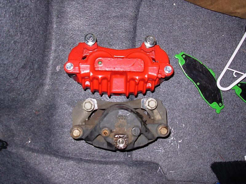

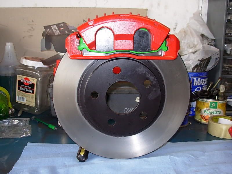

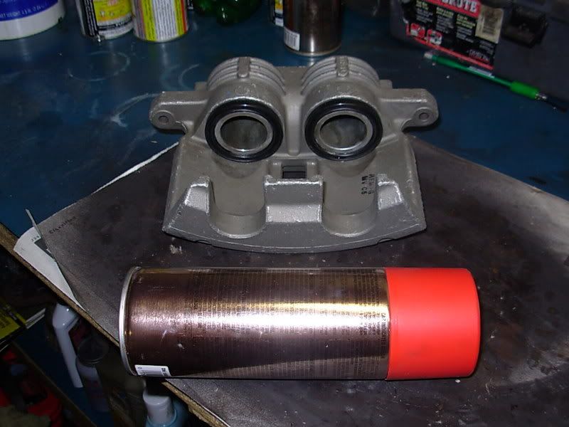

The 04 I guess Mustang I was standing by had PBR aluminum calipers but 11 inch rotors. Car had a new set of pads and new rotors like it was put on and a week later went off an embankment..... Scratch head they look like my LS1 PBR calipers I have for mine. We pulled the stuff then found a cougar and ripped it apart and tried everything. It all bolts up.
We come home and he tries the 12 inch rotors on his with the PBR twin pistons. They work..... So I take one of the calipers over to the shop and compare. Piston DIA is the same in both calipers and almost identical to the LS1 the arch where the rotor lives looks the same. The Mustang has 6 cooling fins where the LS1 have 8. Now the LS1 pistons are spread apart a little more between the two bores and the 3 fingers I call them that hold pressure from the outside pad is a little different look but If your wanting a LS1 and cobra front rotor brake combo instead of anything else might want to walk over in the Ford section at the junkyard and look around.
Not 1000% on these yet but will compare closer tomorrow and dig out my ron's brackets and make sure they bolt up.
Now examples I found on ebay
The GT ones not the ones that say cobra but they may work since there PBR
page down for good pictures
I'm actually going to look at his rear tomorrow we compared the hat height of the fronts to the rears and they are deeper but so is ours. I really wouldn't mind a vented disk in the rear. He's considering putting 13 cobra rotors up front now and thought the 12's might fit in the back. We'll see how that works maybe nothing more than a simple bracket to move his rear calipers up. and to the correct step distance. If I learn anything to better the VR4 I'll add to all this info. Enjoy.

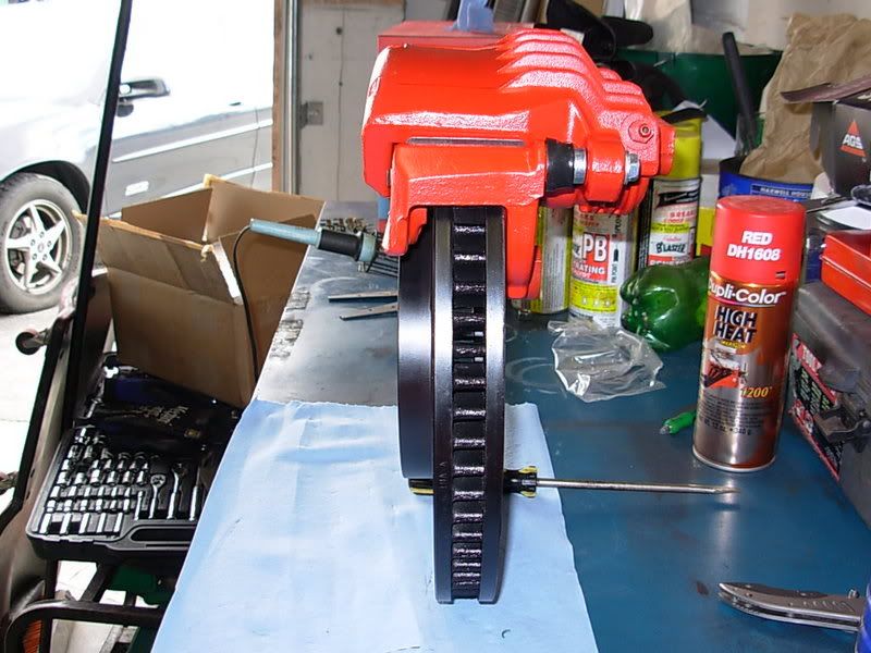

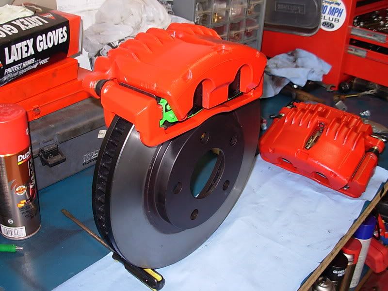

I haven't tried any brake upgrades on my Galant but I did go from stock single piston cast iron calipers and 11 rotors to and F-body setup ( dual piston AL calipers and 12" rotors) on my GTP. It was a direct bolt on for me. I am a huge fan of those calipers as they were super light and the 12" rotor slowed the porker of a car down no problem repeatedly. Plus they can be had CHEAP these days. One thing the F body guys do is get CTSV rotors and calipers because they also bolt right up so if you're going through the trouble of getting F body brackets and want HUGE brakes (I think 14") then this could be another option for you. Oh and I ran EBC Greenstuffs that sucked donkey balls.
Random GTP pics
For size comparison
Oh and I ran DSM wheels and slicks on the GTP so the bolt pattern of that rotor is 5X4.5, maybe a viable option for those that don't mind "just" a 12" rotor.

Curtis, I am pretty sure these are the same calipers that came on the Ford Five Hundred Limiteds. I picked up a pair about a year ago and tried to sell them. I'm currently looking for a rotor that I can cram under my 16 x 8 3000GT wheels and put them on the colt. Wonder if one of those 1 1/16" Galant M/C's will be large enough? Please update this with whatever you come up with.

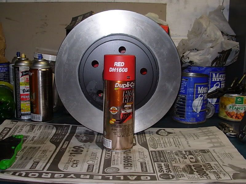

The rear rotors on the vr4 have a hat depth from the surface where the wheels sits to the rotor face of about 40 inches. Hard to tell with wheels on the car perfect and no way to jack it up to much around the car. Anyway the rear on the cougar has a hat depth of 26mm to the same points and are 10 inch in dia with a narrow vent. When you measure from the inside of the vent pretending the vent and the front rotor is gone it ends up being 39/40 by eyeballing. I really think by spreading he pads out all the way and maybe some massaging of the caliper bracket and 4 holes for the studs mill/drilled or opening pthe 5 on 4.45 to 5 on 4.5 the vent rear disks will bolt up fine. He bought rears already new so I'll keep the old ones and can experiment when the time comes.

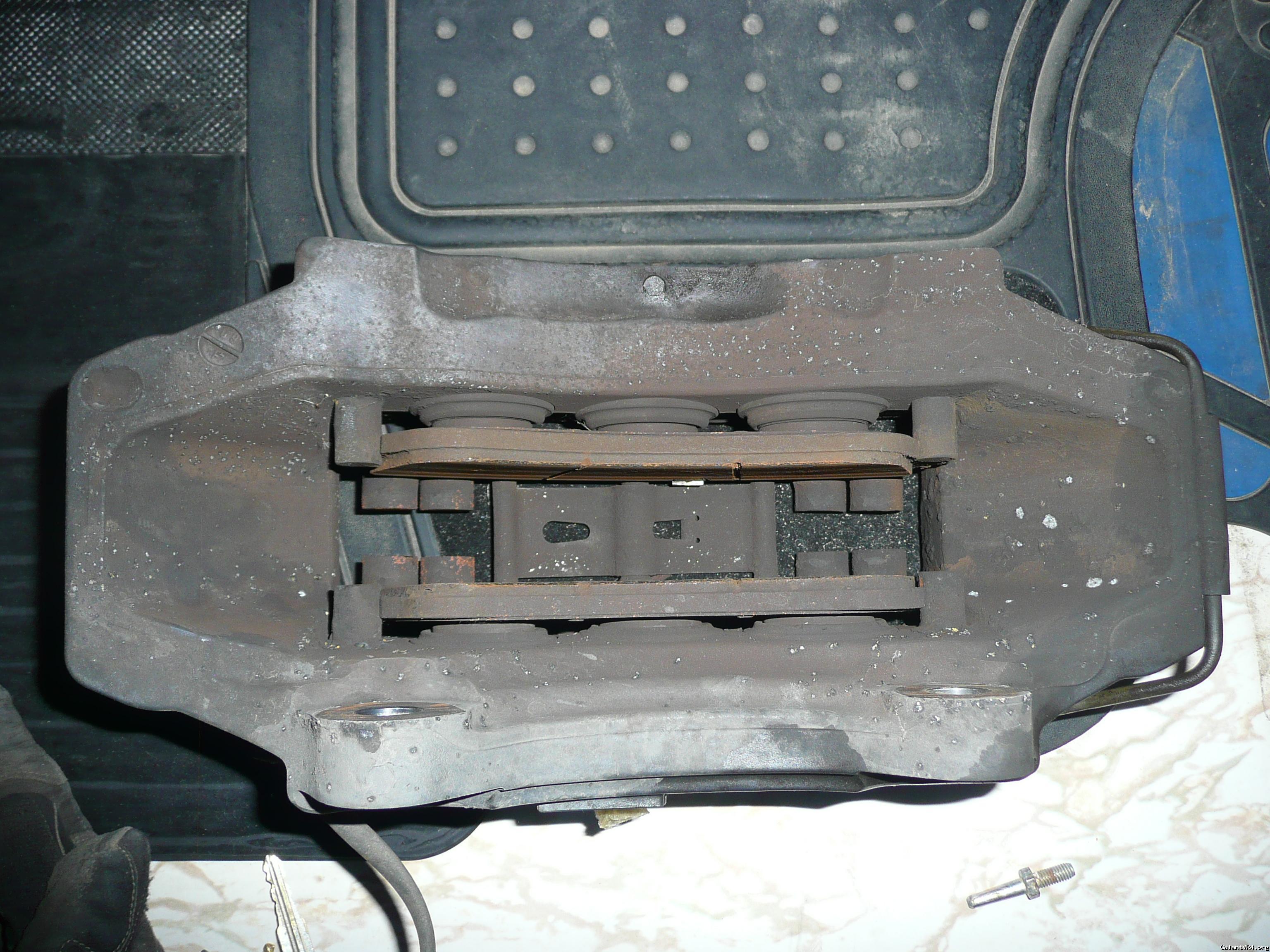

I was working on this awhile back, (before I drug out a different project)

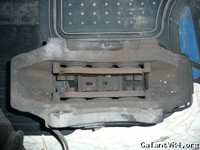

`05 cayenne six pots
( Brembo monoblock six pots, less than ten pounds with pads.)
Mated with audi s8 rotors (they drop right on) and the fronts are done
Using the cheeky/3kgtvr4 trailing arms (with their twin pots and integral drum style e-brakes) for the the rears will round out the package.
You can also use the s-6 wagon vented rotors/4 pots on the rear to step up/match the oversize fronts to get a little of the bias/balance back. ... just gotta make some brackets .... (wanna get right on that? kthx! /ubbthreads/images/graemlins/fawkd.gif )
Mated with your q45 master (good find Curtis!) and you're done

Those Cayenne brakes look like they have tiny pistons. Do you have any info on total piston area? The 3kgt fronts I was playing with last summer look bigger, but it might be a lack of reference in the picture.
toybreaker
iconoclast
Apr 30, 2006
3,581
iirc the six pot's total piston area was only slightly more than the 3kgtvr4 units.
