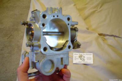

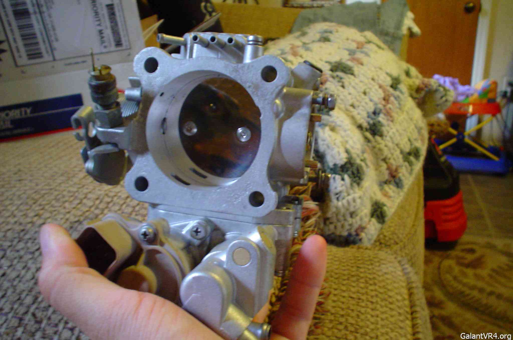

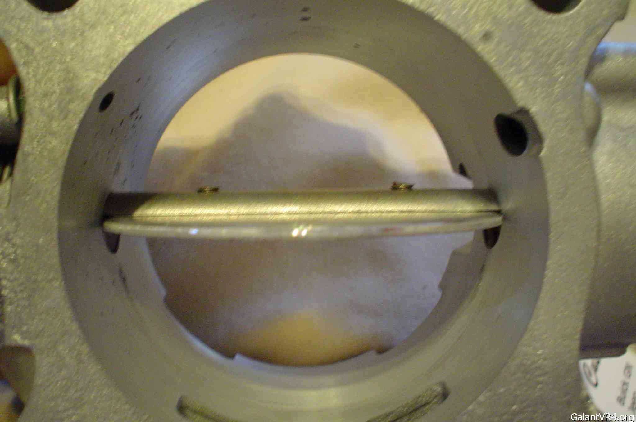

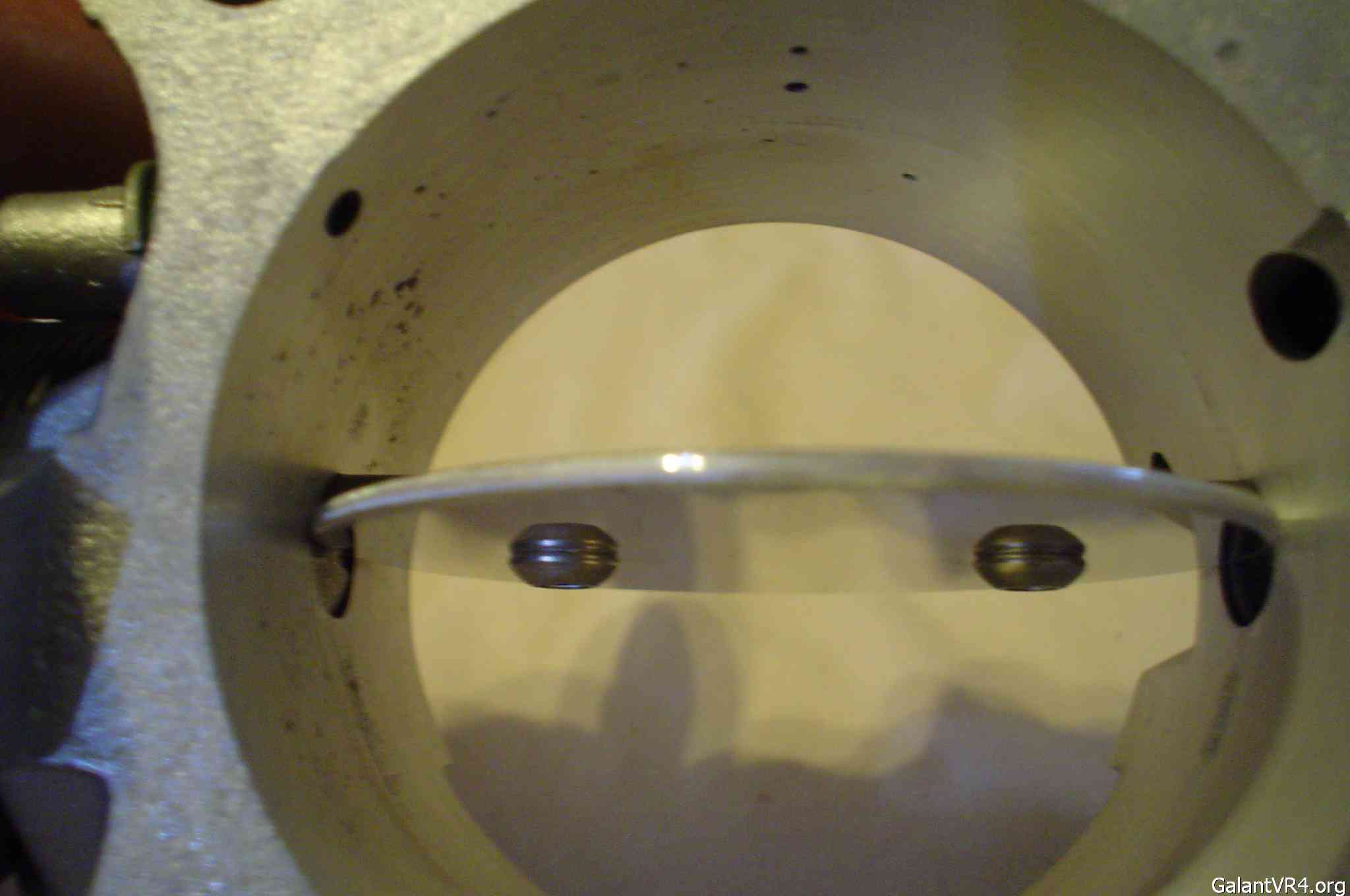

I would like to share with you the experience that I have had with Steve at throttlebodys.com. Well, about a week ago I decide to pressure test my intercooler pipes because of a suspected leak. To my surprise, it would not hold 25 psi for long than about 2 seconds /ubbthreads/images/graemlins/jawdrop.gif. All of the air was leaking straight out the t.b. I got some soapy water in a spray bottle, wet the entire t.b., and filled the pipes back up with air to see exactly where it was leaking from. There were bubbles everywhere!!! Both of the shaft seals were leaking horribly along with the biss o-ring. So I decided to search for a shop that could replace these seals for I good price. I ran across a post by Terry Posten giving throttlebodys.com a good review CLICKY , so I decided to try this place. I shipped my dirty, non functional t.b. out last Thursday and received it back today. I does not even look like the same part. I looks awesome!!! I got it bored to 63mm with the half shaft mod, all of the seals replaced, new biss screw and bead blasted for $125. You cant beat that price, the workmanship is top notch and Steve is a very pleasant guy to do business with. I am very satisfied and would recommend this to anyone that is going to stick with a mitsu t.b., because your old seals are 15+ years old and are probably shot. Take a look at the pics (I wish I would have taken some before shots so that you could see how bad it really looked). Also, if anyone else has had there t.b. serviced by Steve, please add your comments. Thanks.

That looks f***ing AWESOME!!! I'll definitly have to get this done ASAP. Thanks for the information.

Have you noticed a difference since this mod? Do you have a larger TB elbow to match? Is the half shaft really worth it; ie, why did you do it?
Thanks! Looks great!

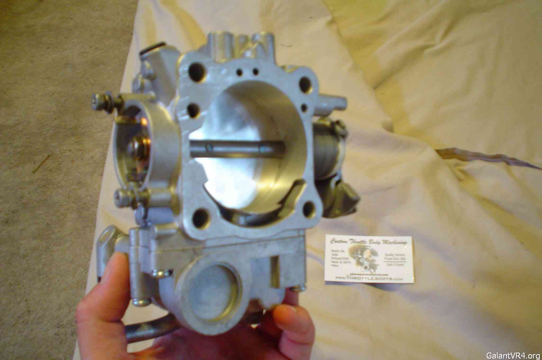

That is exactly how mine looked, except I had him do a n/t throttle body. He really does amazing work for the price of it.

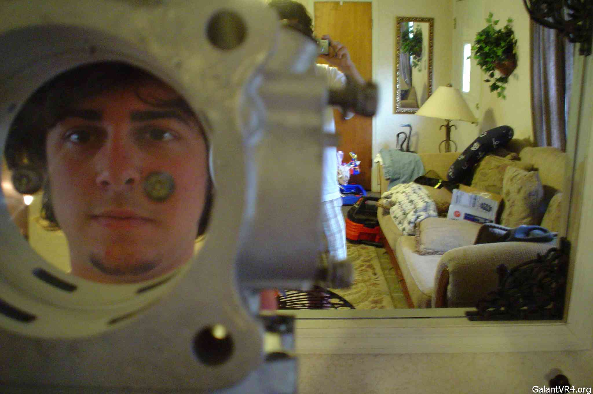

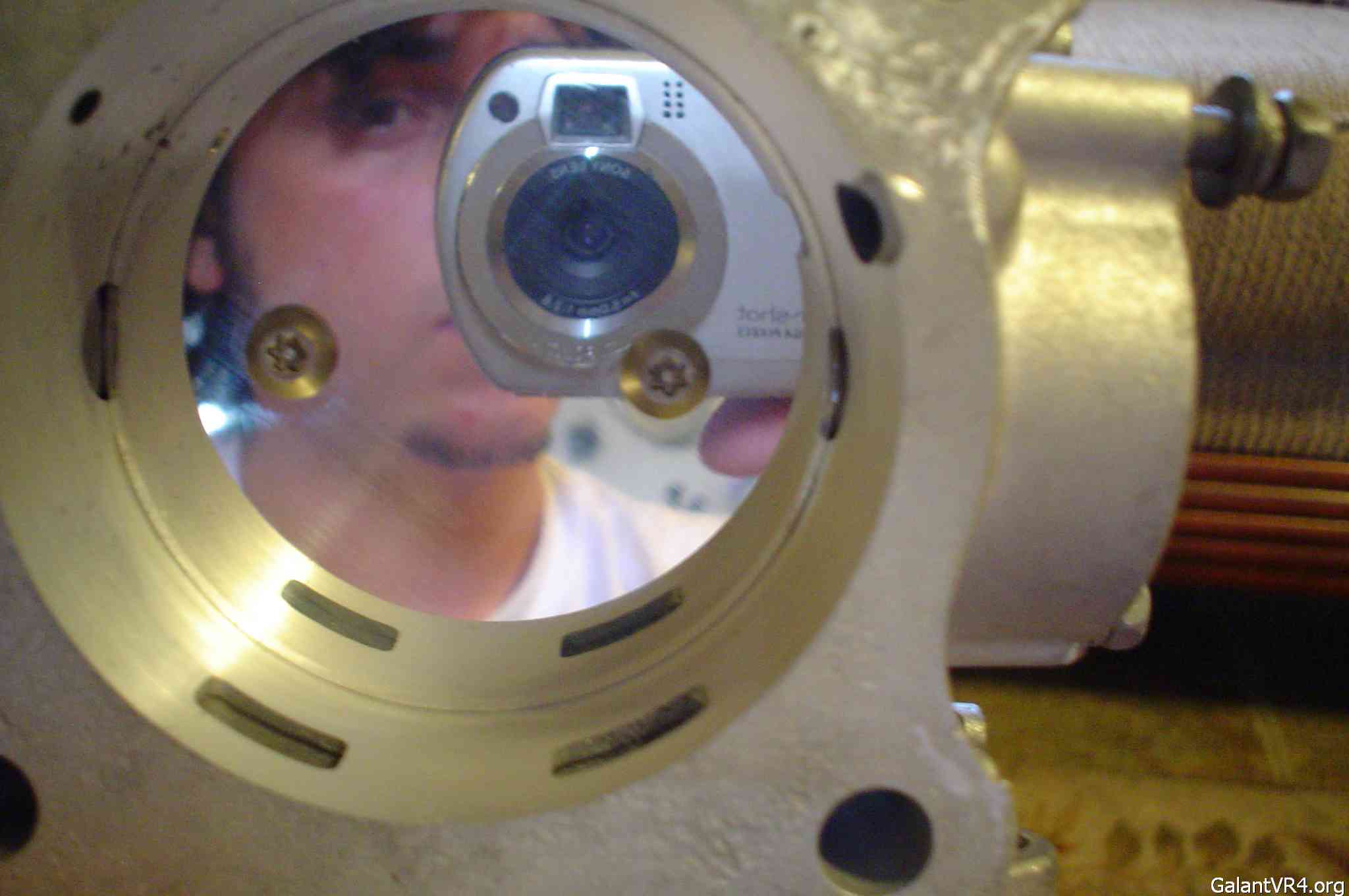

Haha, I was going to ask about getting it bored out, and farther up in the thread I asked it like two years ago. What all does he do to bore it out? Do you get a new 63mm throttle plate to match, or is just the outside tapered down to a stock throttle plate? I've already replaced all my seals, cost me a couple bucks and an hour, but I'd be interested in a bigger throttle if it actually makes a difference.
Terry Posten
Dec 16, 2003
9,009
Davenport, Iowa USA

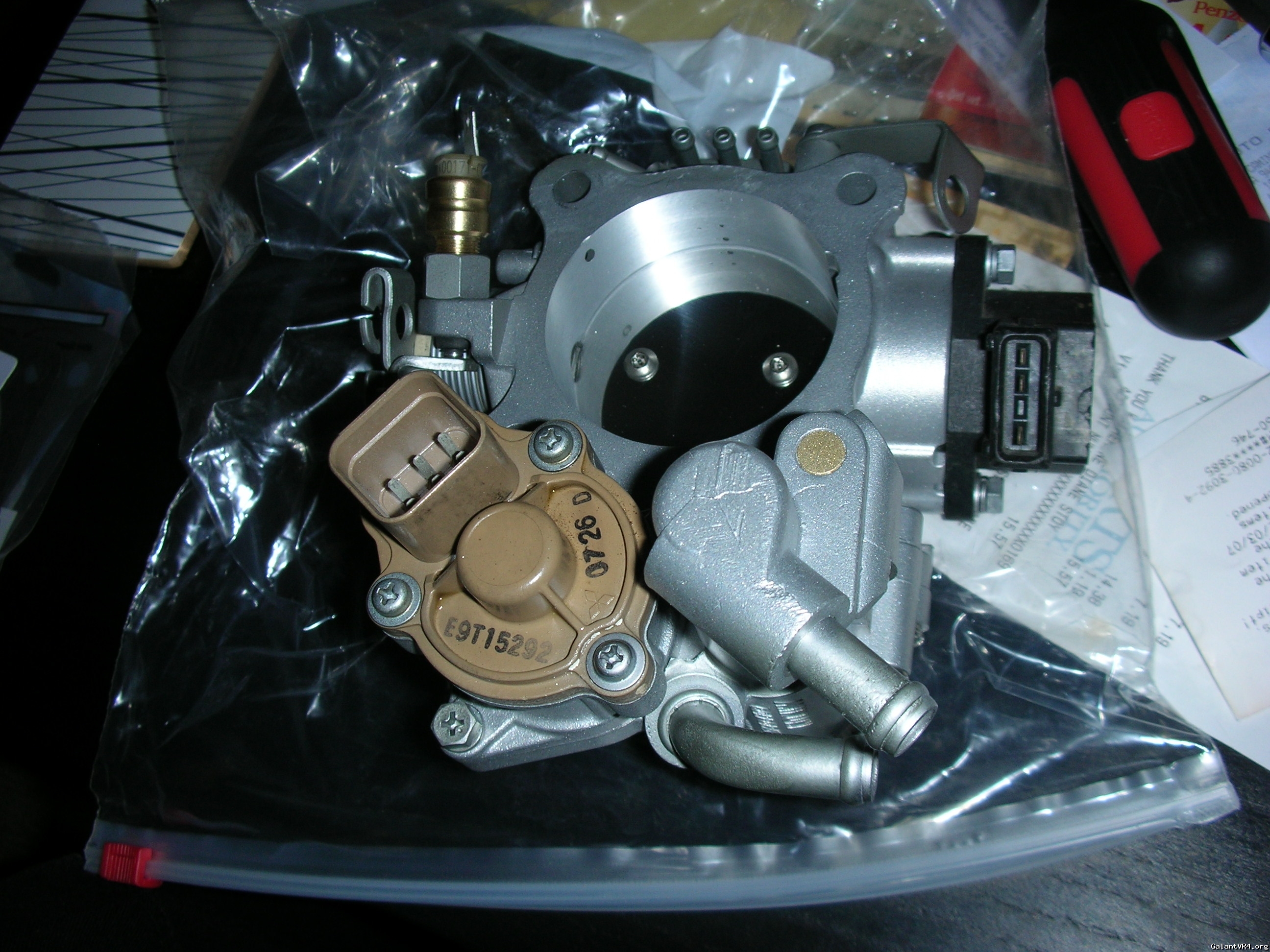

The unit is bored all the way through. The plate is new. So is all the seals and gaskets. He also sets the throttle closed switch.
If you ask, you can also have a FAIV/ISC block-off plate made and sent with it. He even included new stainless screws the correct length for the blockoff.

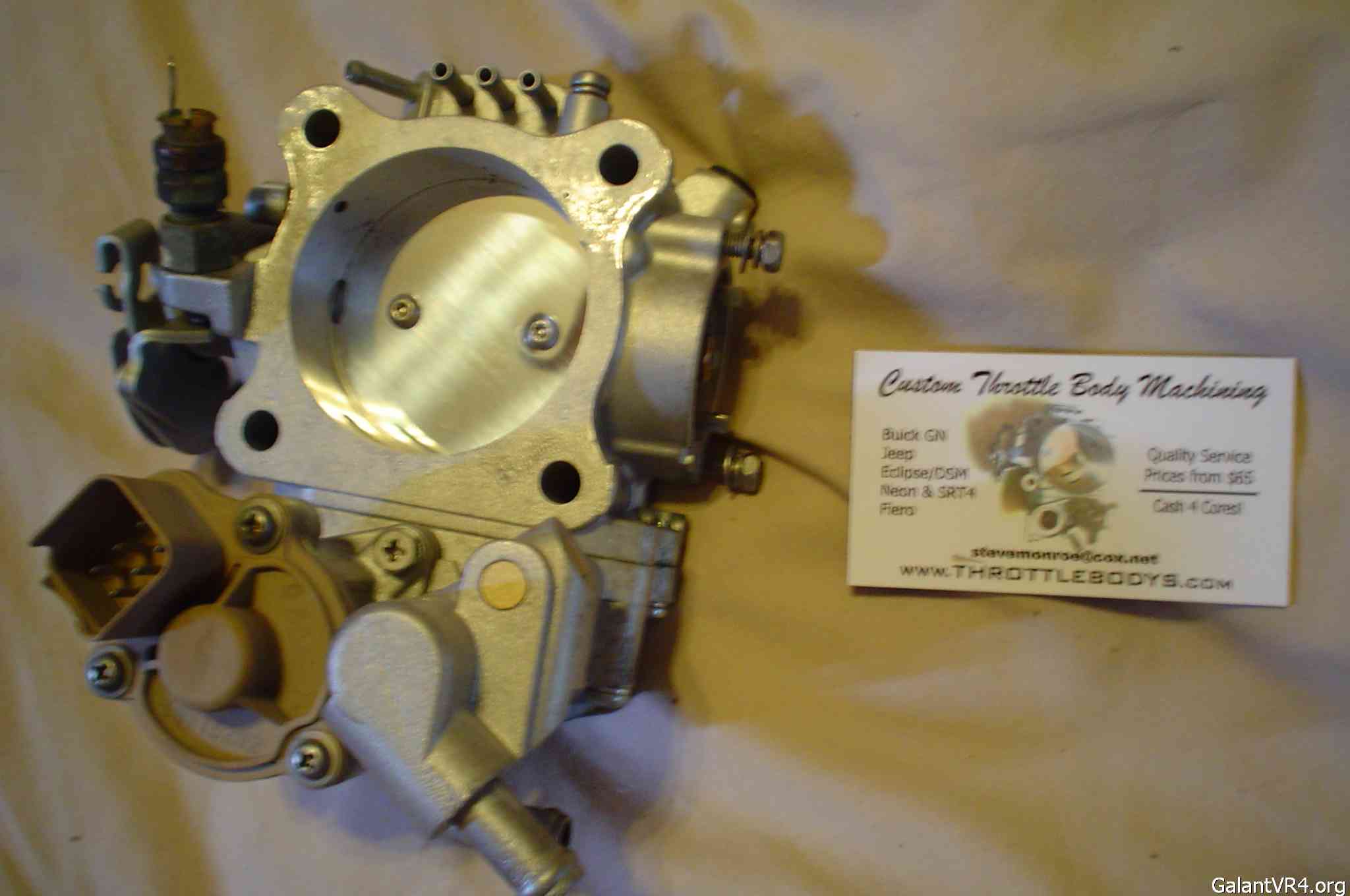

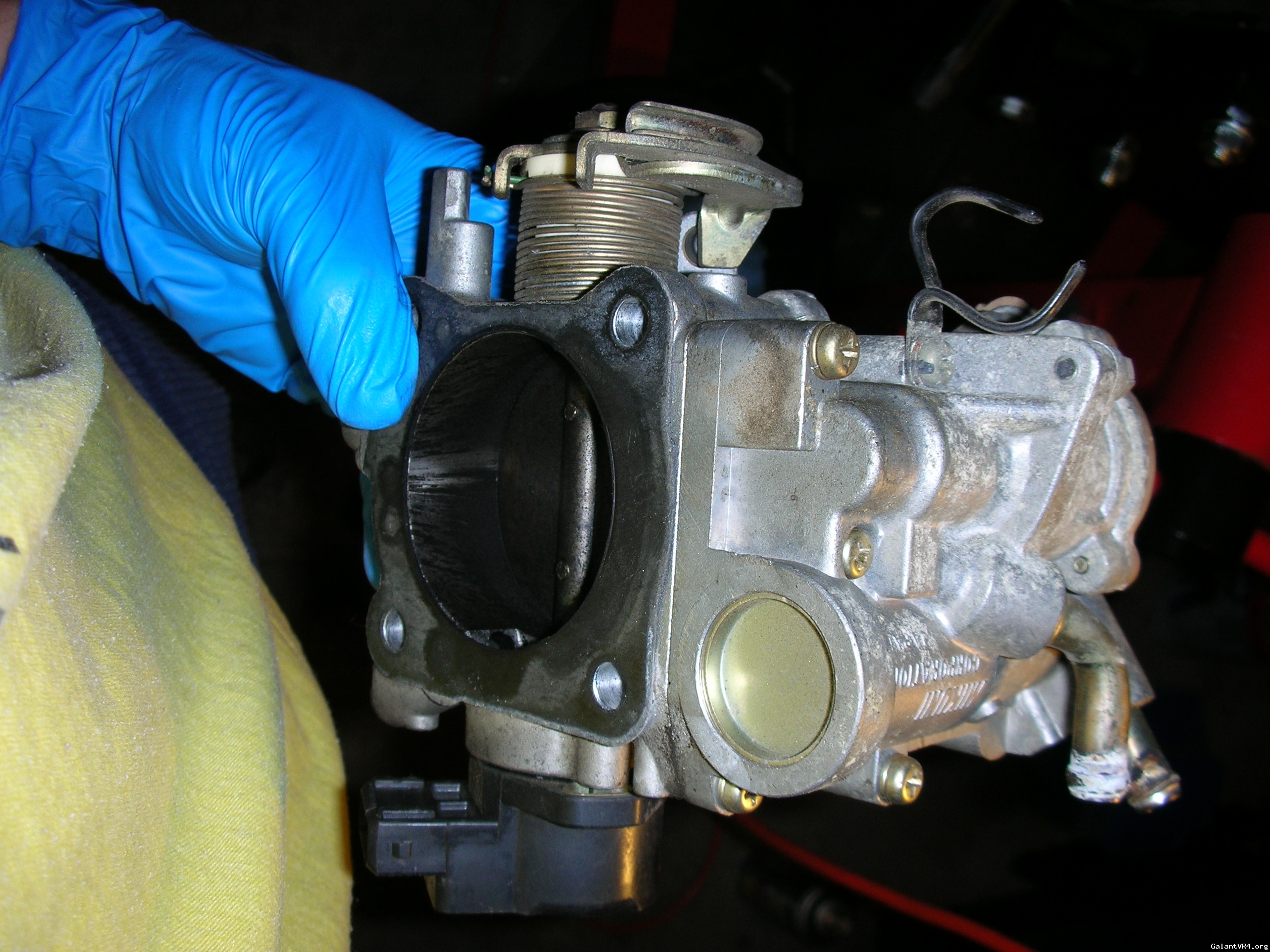

Just sent mine in for servicing - I could barely believe that it was the same one; The "before" picture makes it look a lot better than it was. (It's not a core exchange, a few of the marks I noted before I sent it are still sort of visible) Steve does awesome work!
Before:
After:
