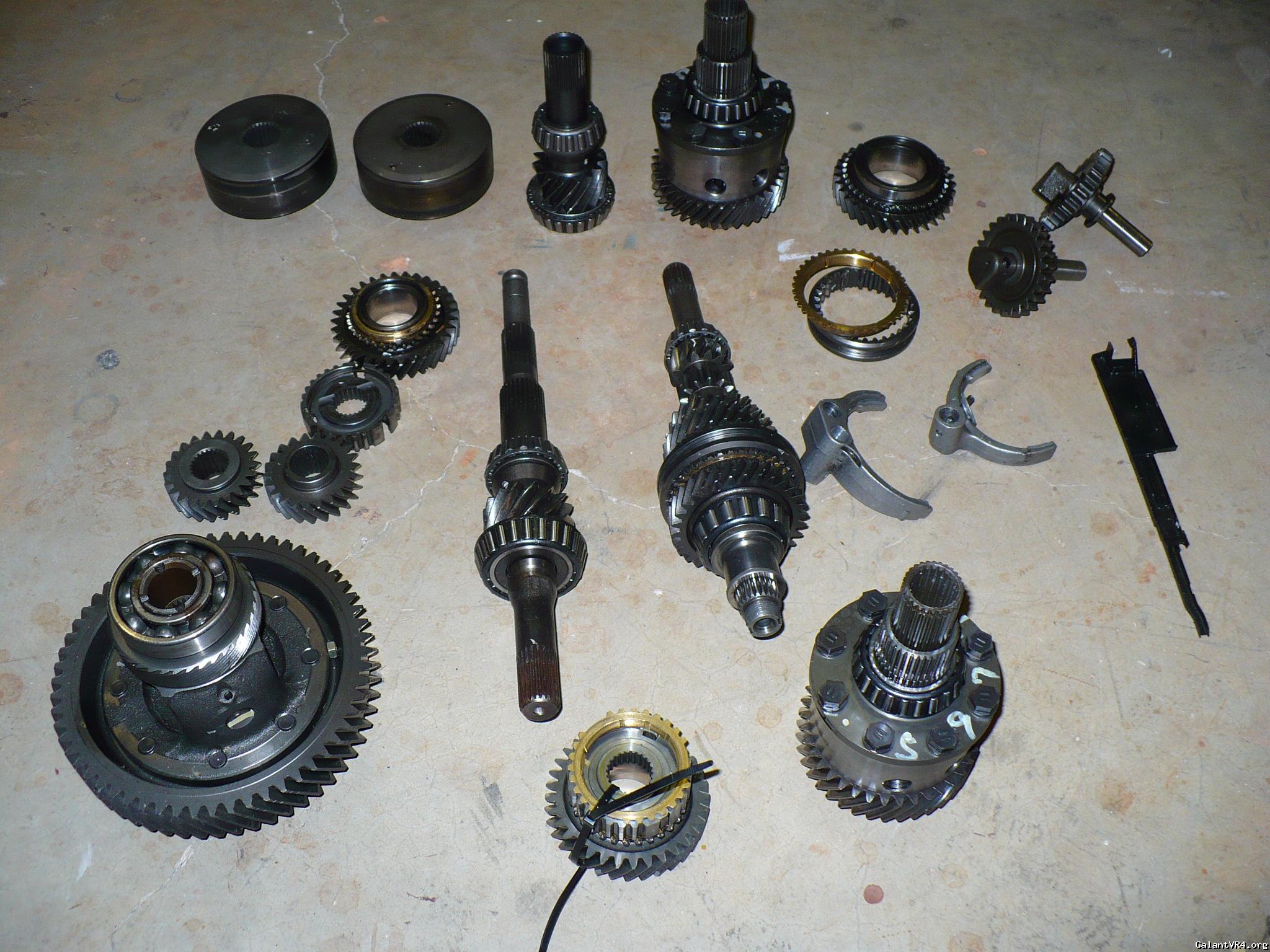

If you need any of these parts let me know thier taking up space. The ziptied set is 2nd (took it out for my dual syncro 2nd)
