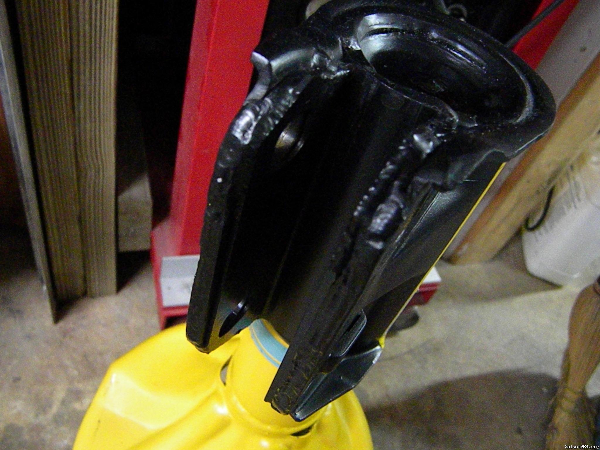

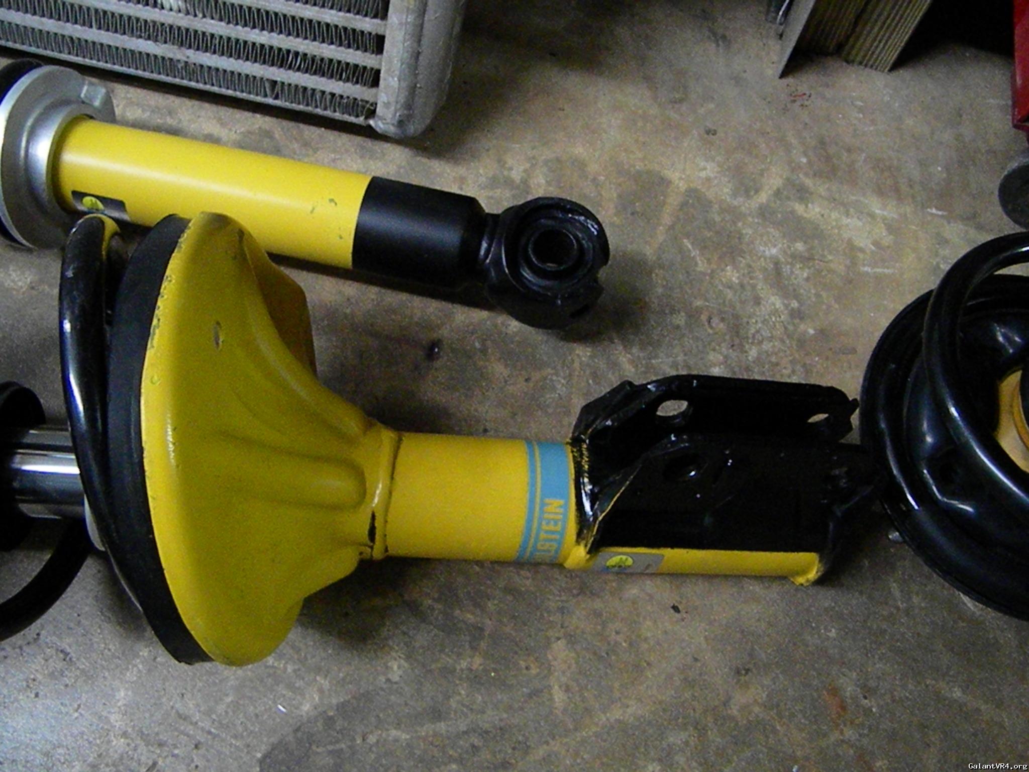

I've got another set of EVO struts (EVO IX FQ360 Bilsteins) that I am going to prepare for use on the GTi. I therefore need a pair of stock rear suspension bushings from a Galant or a 1G to modify the rear EVO struts as per Scott Y's how to in the pics below.
In the second pic you can see the stock bushing on the stock strut at the bottom.

If you don't have a way to cut them any muffler shop will have a chop saw, Just hate to see someone ship a set of struts for 2 small bushings or hopefully 4. If you can cut them just straight through the weld is fine I'll clean off the extra before I weld on. Here's what the last set looked like. I roll the tabs around the bushing as I weld. Extra metal and just added safety.

Bloody Hell I hope mine turn out better than that now you've had some practice!!!
/ubbthreads/images/graemlins/rofl.gif /ubbthreads/images/graemlins/rofl.gif /ubbthreads/images/graemlins/rofl.gif
Show Off!!!
